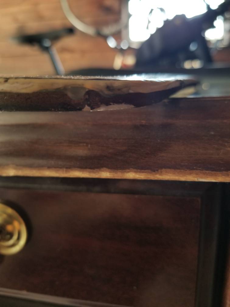

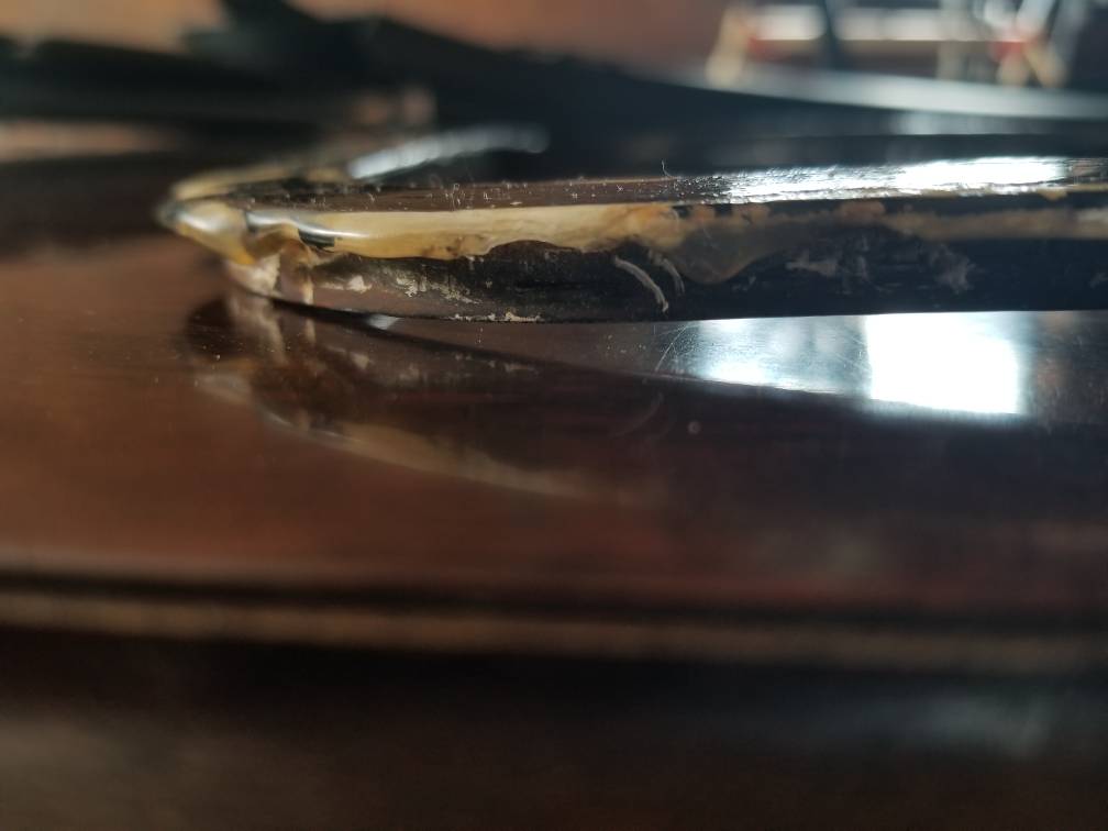

I have my sunroof completely out and have managed to separate the fragile fiberglass trim that sandwiches the glass and the seal. However, through the process of trying to remove the seal, I chipped some of the edges and I would like to repair them, very small sections of the trim are chipped.
I wondering if anyone has any suggestions for what I can use to repair the edges where the trim chipped off. Ive tried using fiberglass resin but its difficult to work with so Im open to other suggestions. Thanks!

I'm gonna sand and repaint the whole trim, I got some SEM black trim paint that I was gonna finish with a couple coats of clear.
Is bondo gonna be good enough to withstand prolonged heat and some stress from holding the seal against the metal bracket? I've never worked with it Sent from my SM-G950U using Tapatalk

Heres 2 problem areas, both are corner pieces. I have some fiberglass resin that I tried dripping down the side but not very effective
![]() ![]() Sent from my SM-G950U using Tapatalk
Skurr Skurr

https://www.summitracing.com/parts/f...BoCBrQQAvD_BwE
Sand that resin shit off... U need to use this shit. Strong as fuk!! Can shape it and mold it with 80 grit, 180, 320, primer it all, 800grit block, primer and paint.. |

The resin will sand off (or break off) pretty easy actually so its not a good solution. I'll take a look at other similar body fill products from what you suggested that I could potentially buy in smaller quantities.
