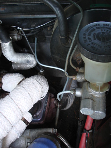

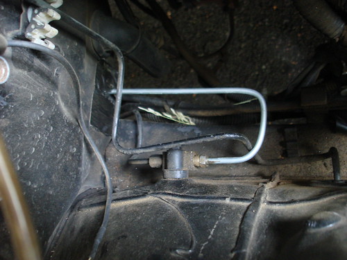

i started with a line from my master cyl through my firewall, then a junctions inside the car.. i want to redo this part with a proper AN setup to bolt onto the fire wall.. but from that junctions to the brake.
then i ran the other side of the brake to my passenger firewall where it enters the engine bay again and routes to the rear brake block bolted to my frame rail..

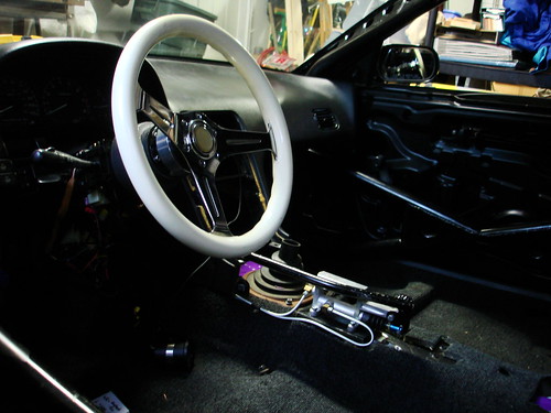

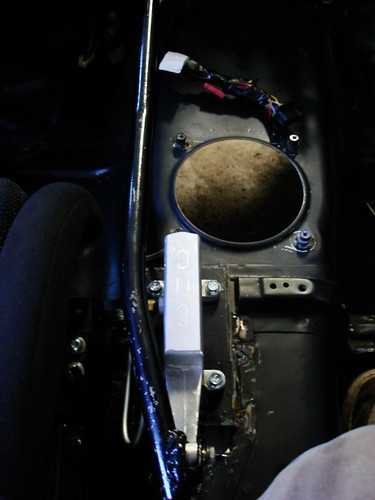

here is the bracket i made and you can see the hardlines going to the brake.
This unit had a slanted handle.. i ordered the straight handle but they sent me the wrong one so on my old car i just made a new handle.
like this:
now i have it replacing the stock location and have made a new handle for it

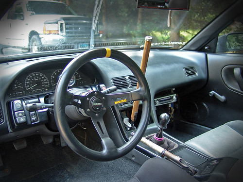

and this season i changed up the handle a bit
so i replaced the whole rear brake hardline from the master to the passenger side of the engine bay.
i like this a lot. locks up the rear nicely with hawk rear pads on stock s13 brakes.

I am throwing around the idea of undoing rear brake line on the brake block in the engine bay and just blocking it off and seeing how my car feels while braking. Then I could just run the rear brakes through the hydraulic hand brake....so if I really really needed all four brakes to stop I can use my hand and foot to do it. My car isn't really a street car and I have Q45 front brakes......I realize this might sound like a dumb idea but its easy to try out.

here is my hydro e brake set up. wilwood prop valve with wilwood cylinder. havent tested it out yet, running d1 PMU pads and stainless lines so i hope it grabs well

correct me if im wrong but that per portioning valve is for front to rear per portioning right? so what good would it do for u to have on with a single line?
wouldnt you need a valve with on line in, then 2 lines out so it per portions pressure going to left and to right, so if your left locks and right doesnt, u move more pressure to right so now both lock.
jw? Thnks

^^It looks like he has it set up so his front brakes are getting 100% pressure from the pedal and that valve will limit the pressure going to the rears. it wont have any affect on the hydro ebrake, when you use it you will be only sending pressure to the rear brakes equal ammounts L to R so they should both lock.

here are some pics of the setup on an s13, it does WORK!!!!
Ignore the "fluid does not come out" once again IGNORE
(the reason it did not work before because I had the wrong fitting. And when I tightened it-it did not let fluid go to te other side . What u need to do I's get a special brake fitting that goes into the brake line. You flare it into the line removing the m10x1.00 metric fitting.( i bought the brake line from Autozone)
Are u running a z32 master cylinder? Also did u remove the Proportioning valve/ fitting in the master cylinder? I am about to do my setup and was told I needed tO drill out the fitting in the master cylinder.
