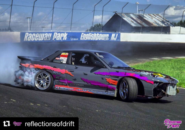

Let me start by saying this IS a drift car. Sees street time but it's mainly just testing.

Picture of my car for shits and giggles.
