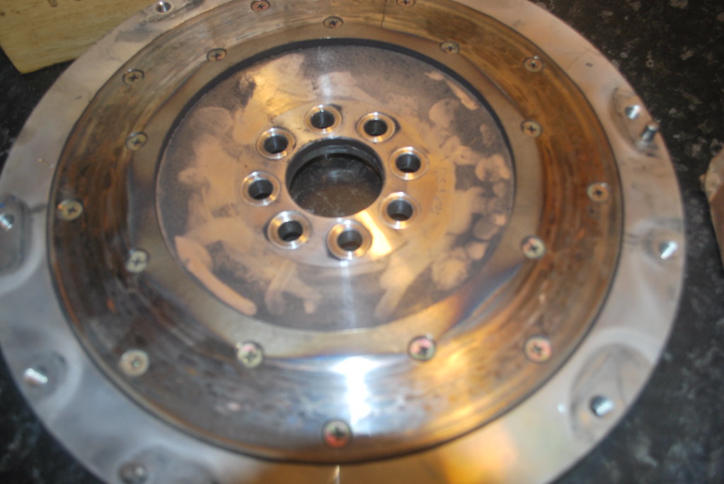

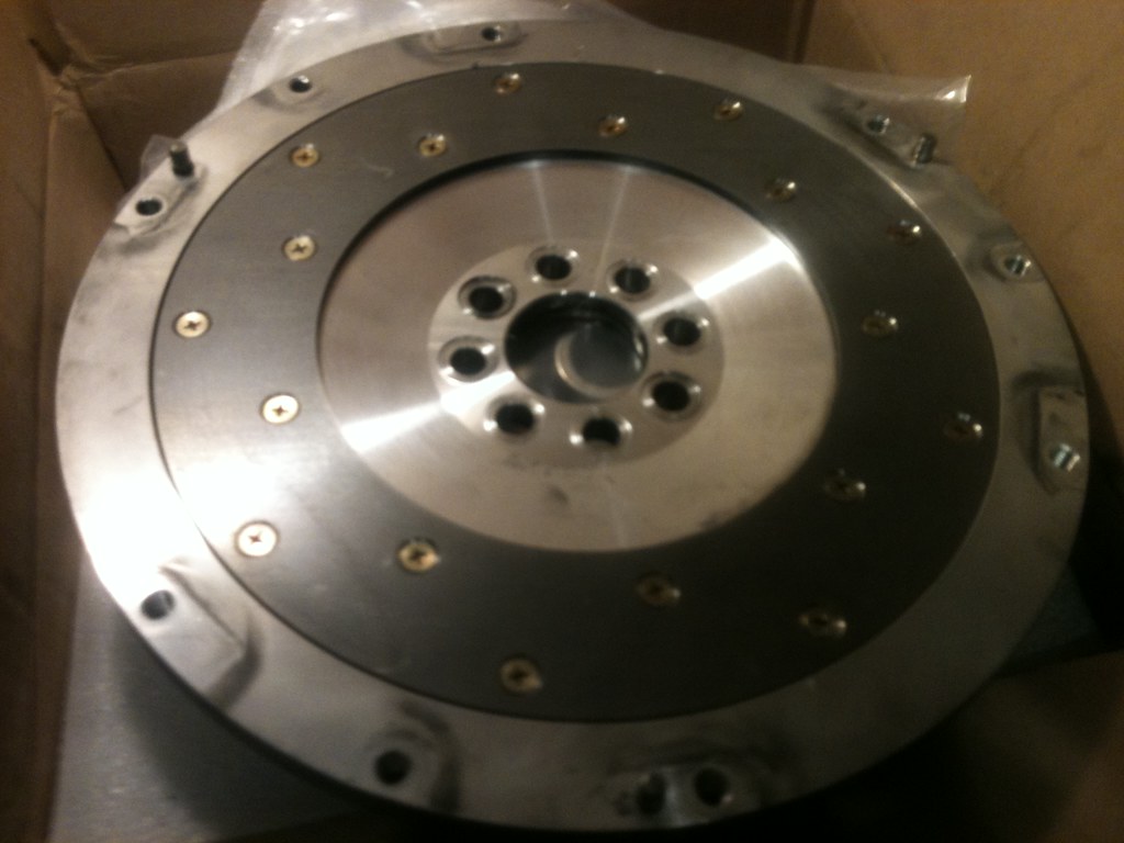

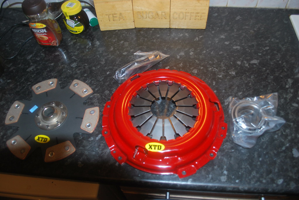

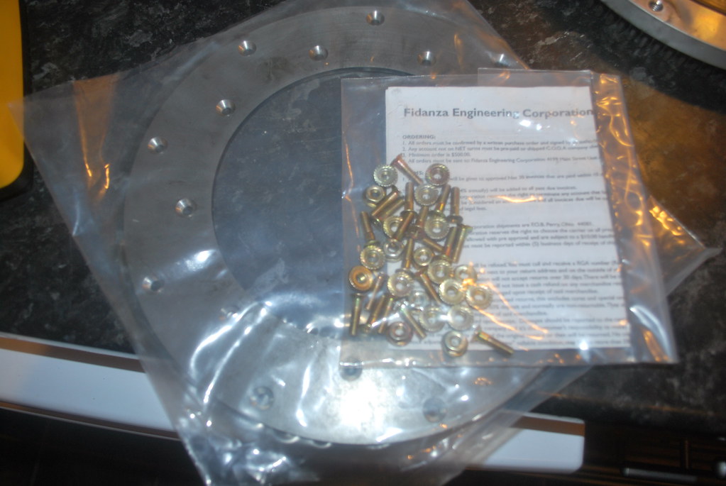

Got the new Fidanza friction plate for my unknown lightened flywheel:
because i didnt know the make of the flywheel i had to make an educated guess at which pcd friction plate to get, luckily i was right!
before:
^it was that fucked even a couple of the screw heads had been worn!
after:
also got clutch kit:

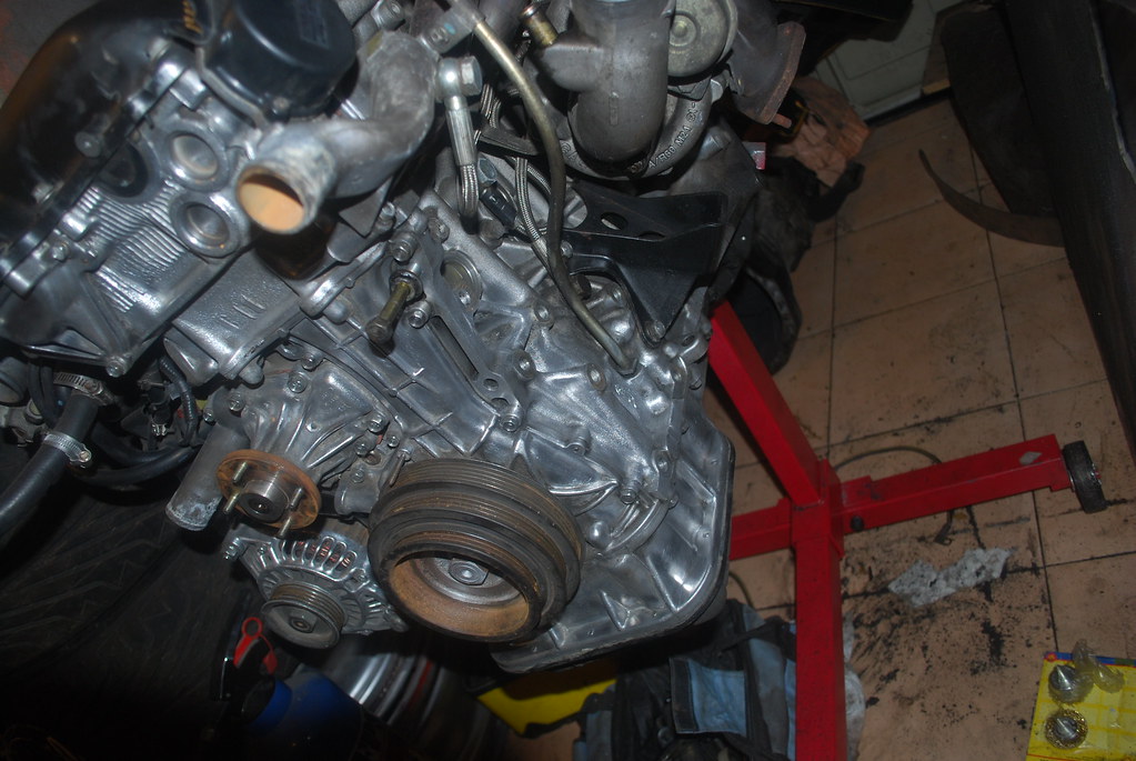

I was going to clean the engine down and spray it with some high temp enamel i ordered, but with my spare time i spent a few hours with a few wire brushes, white spirits, some rag and a tiny screwdriver cleaning it up, im well pleased with the results, i really wish i took a couple of before pics.
Took the alt, power steering pump and belts off to give everything a good going over.

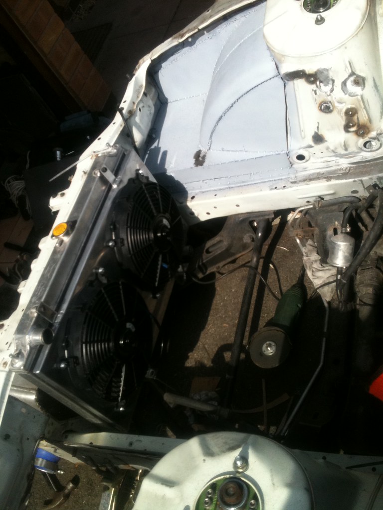

Also my new twin fan+ally shroud setup came, had to throw it in to see:
anyway:

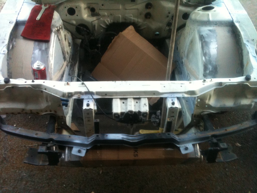

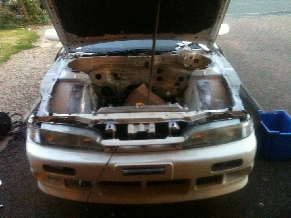

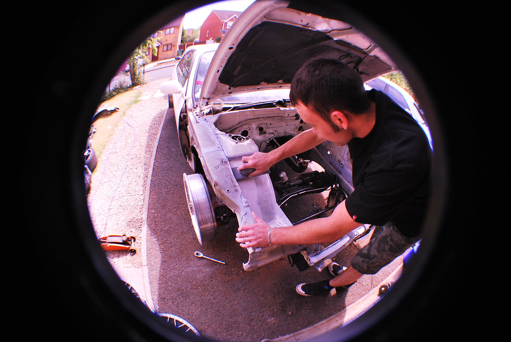

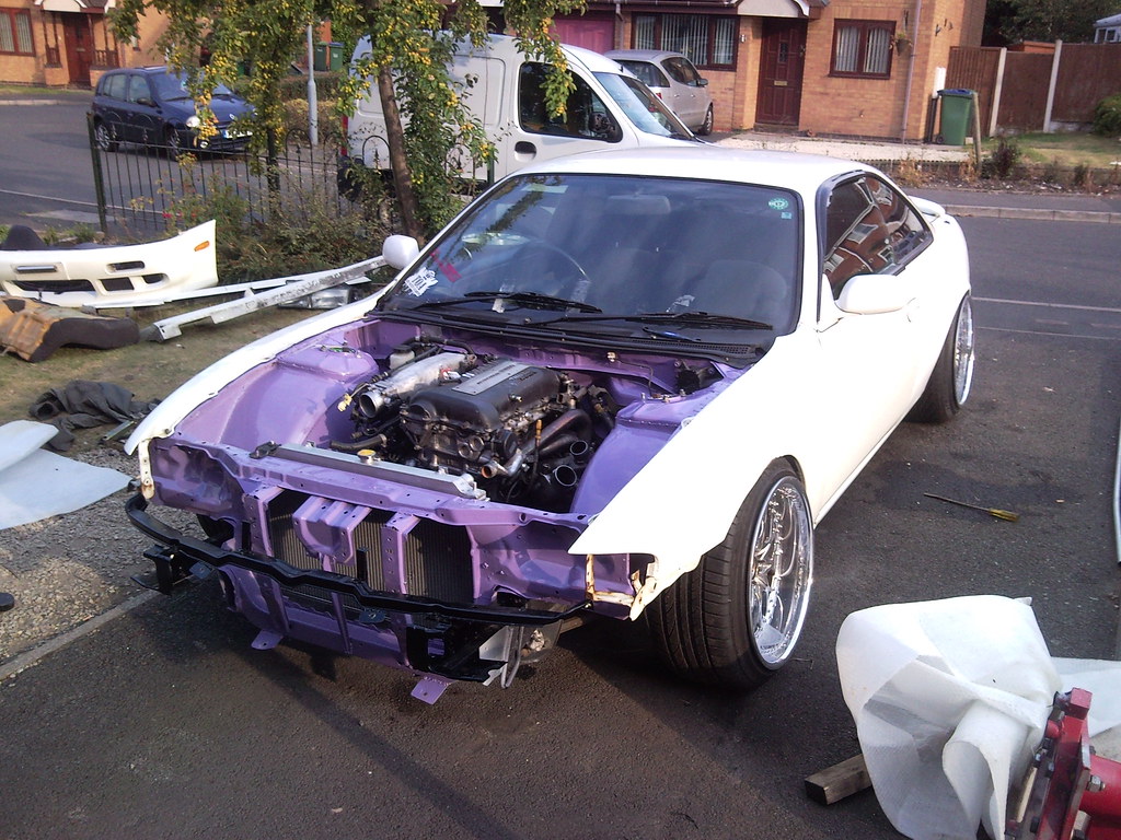

Jay started some filler work and i started work undoing the JDM bodge that some jap dude did to my front end, the vertical supports were cut and bent out, then bolted to a huge tray which my intercooler sat on.
You can kind of see it here:
the middle support had been cut shorter to suit so i welded a new one in (was a chopped up shelf bracket :P ), did the job though, before when i would unbolt or bolt anything that was connected to the slam panel the whole thing was so flimsy it would twist, now its completely solid

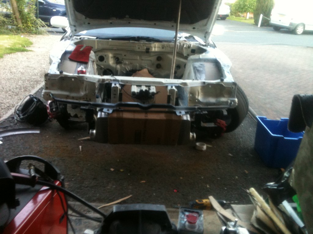

So now the front intercooler bodge was sorted i had to actually fit the intercooler again, made up some brackets, bolted them to the IC then supported it on jacks in the position i wanted and tacked the brackets to the car, then removed it and welded it all up.
I mounted it at as much of an angle as possbile so i had maximum ground clearance:
Put some of the front back together to check alignment, not perfect but good enough for now, il make any changes once its all back together:

Just as i was finishing the welding on the intercooler brackets my welder ran out of gas, so now im stuck without a welder for about a week
in the meantime iv been getting on with bits that needed sorting, i got round to getting the arches/tubs undersealed:
Removed the passenger side driveshaft, when i was taking the diff out i noticed some minor damage from when i dirfed, so i figured i might aswell chuck a new one in while its apart.
Oh yeah, the teg sold so i have most of the money for my lips, in preperation i put the car on stands, while i was doing so it fell off the jack :shock: :roll:
Luckily the only damage was this:

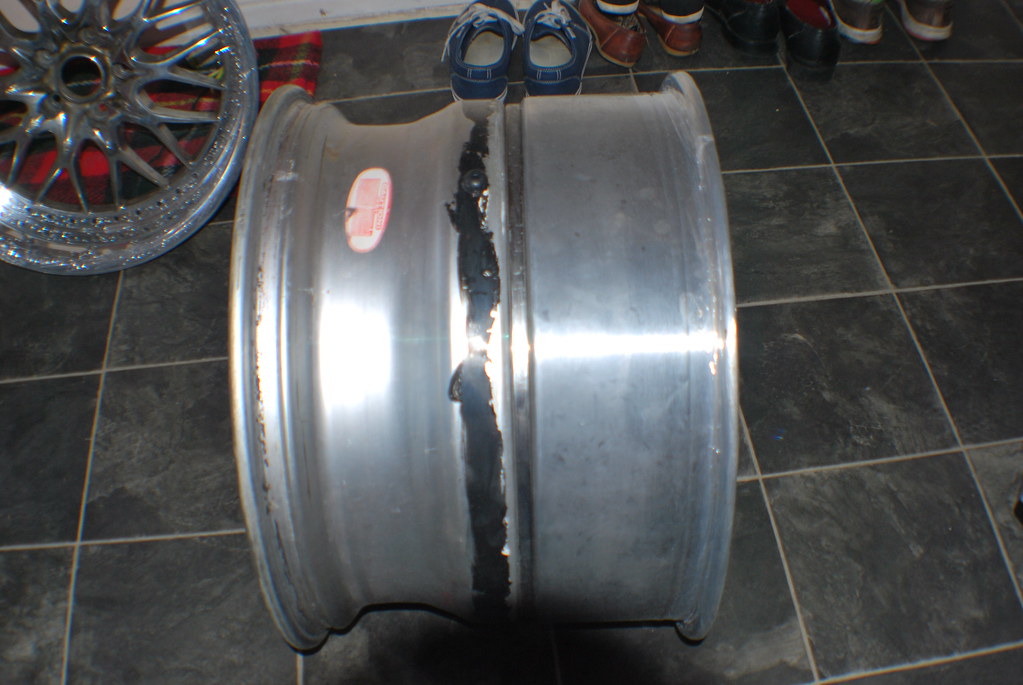

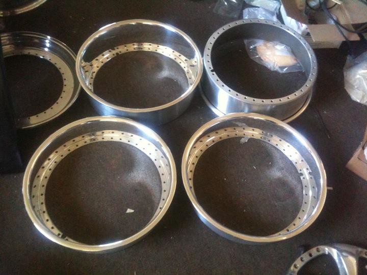

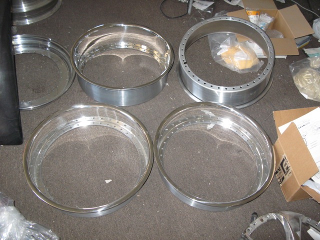

Also managed to get my wheels apart today with the help of tesh.
The nuts and bolts are perfectly fine, so to save money im just going to buy as many as i need (there are a few missing as i brought the wjheels in peices)
Im selling the lips if anyone is interested
Iv been reading about people using coke to clean up rust so i got the mrs to pick up some cheap coke and threw the nuts and bolts in, il let you know how it turns out.

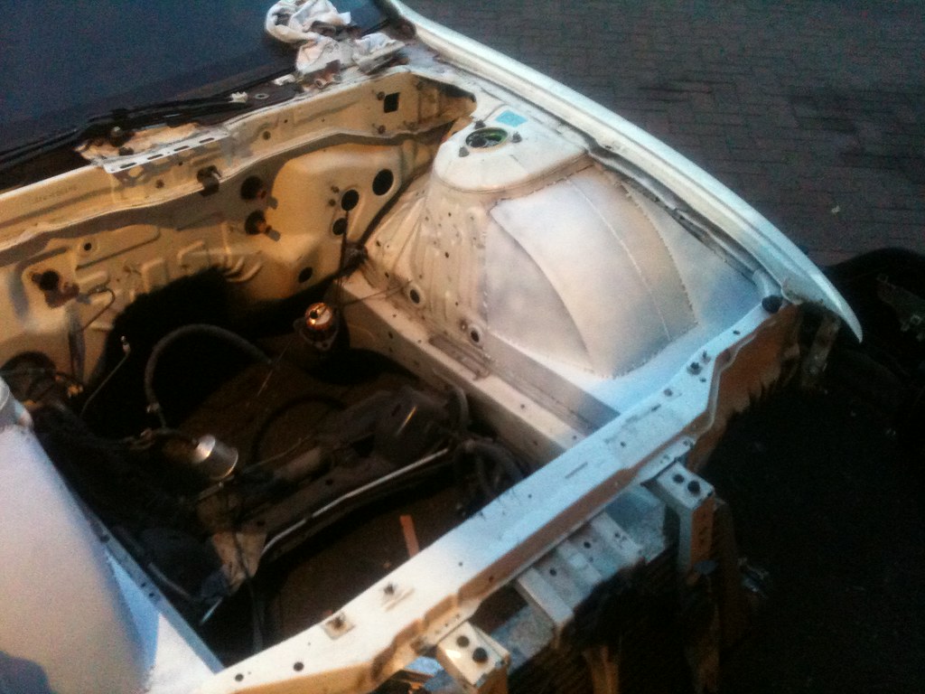

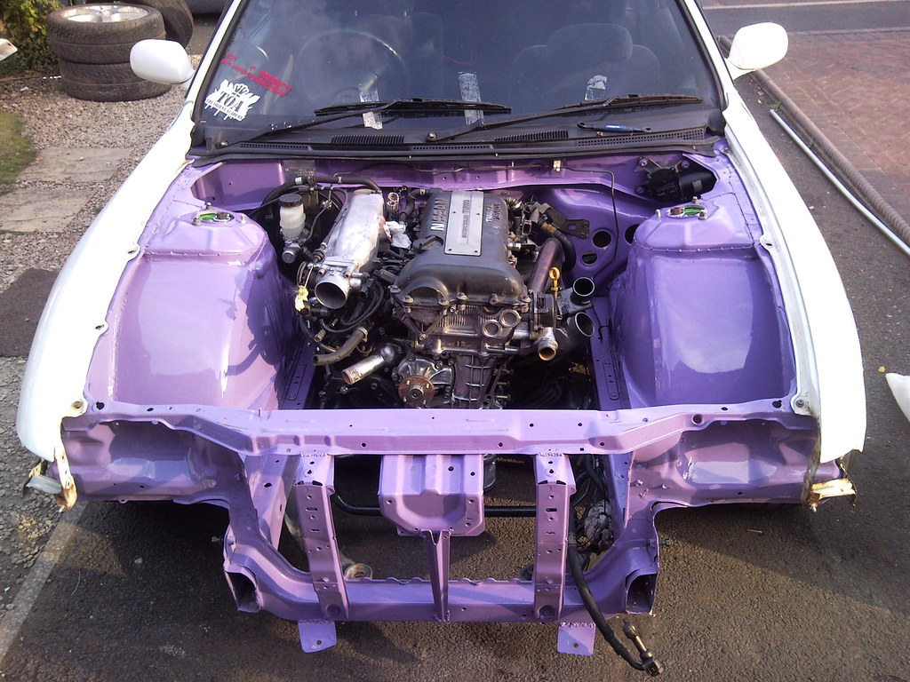

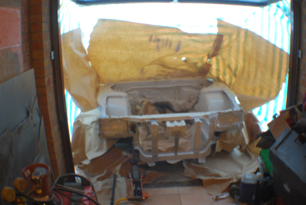

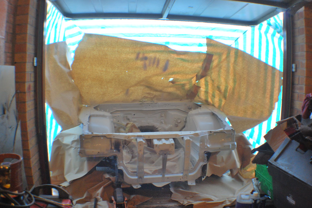

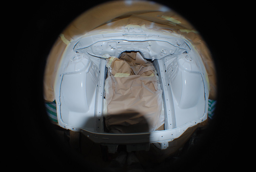

So I got my new gas bottle (thanks duane) and managed to finish the welding in the bay off a couple of days ago.
then today Jay came round and we got the filler work done, its not perfect but its ok for me for the time being, i have to draw the line somewhere or i would be on it forever.

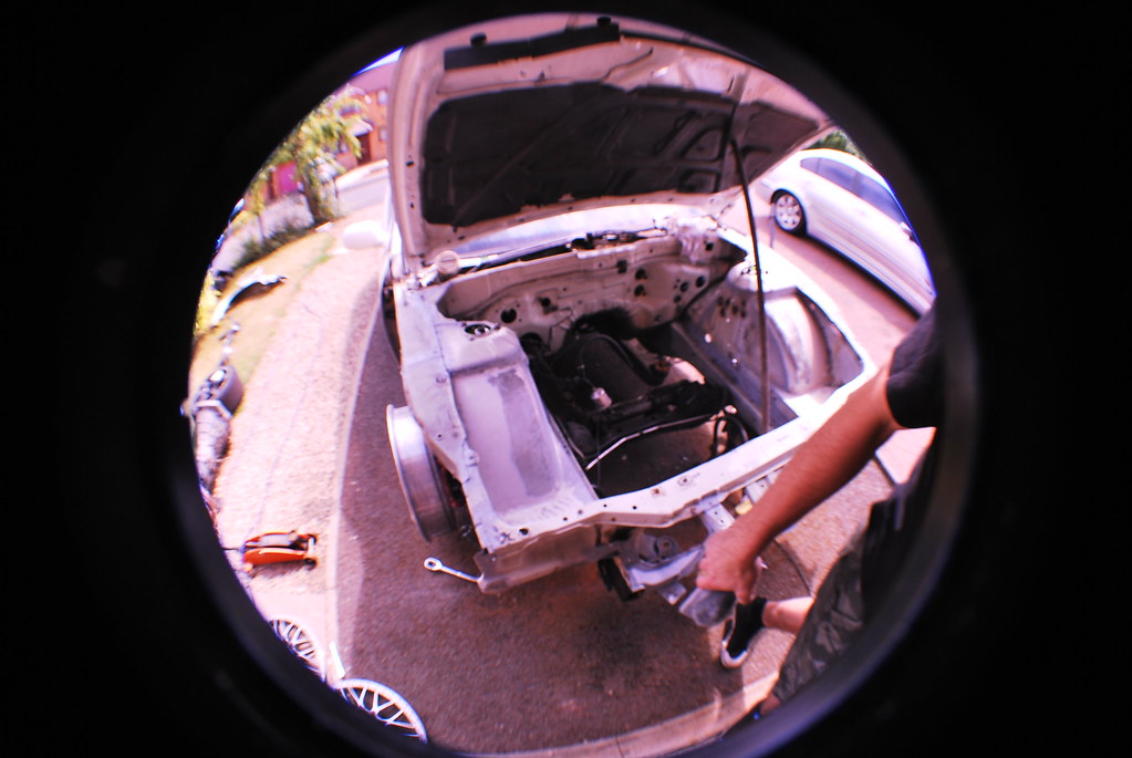

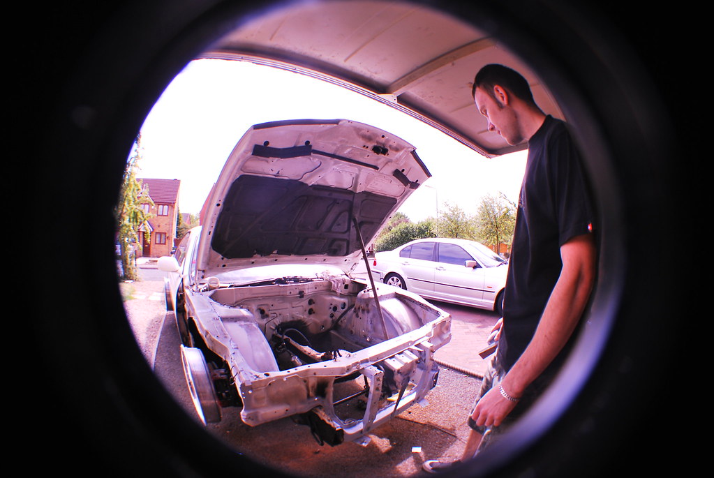

anyway a few pics i snapped while i was standing around, threw a couple lips/faces together to see too

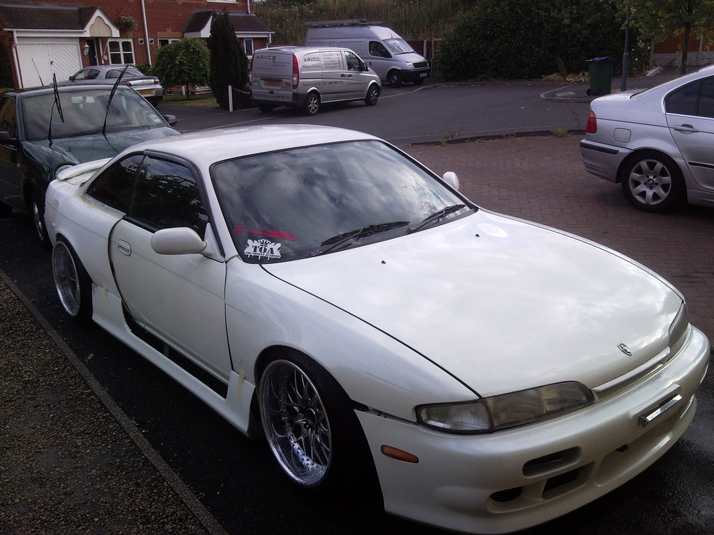

Got some very strange looks off the neighbours today:

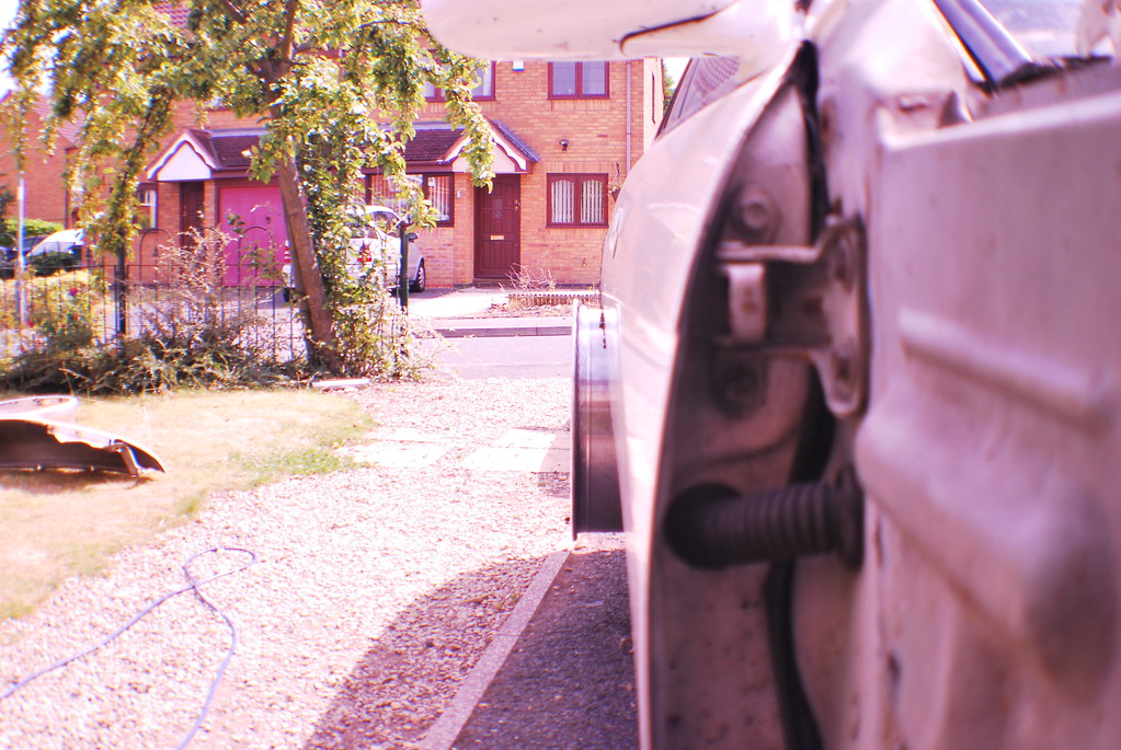

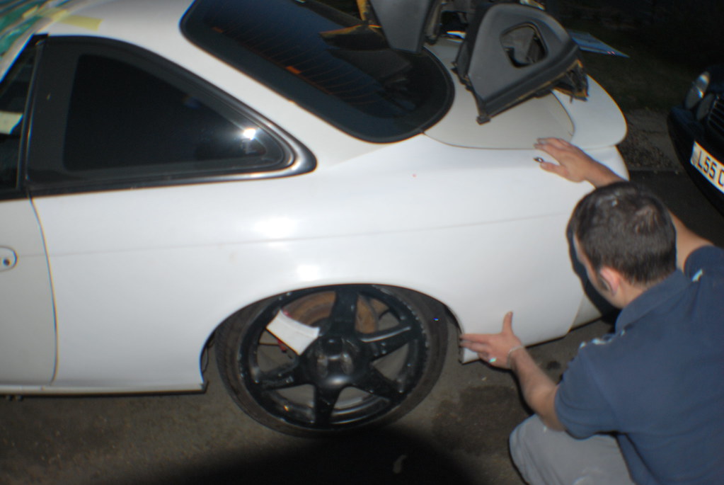

quick snap of the rear quarters held in place, there alot wider than i expected:
bear in mind the tyres rub against the oem arches :shock:

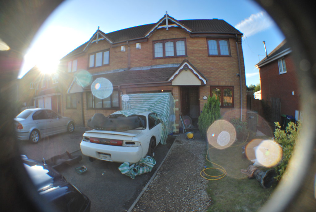

sorry for the lack of updates, iv been busy.

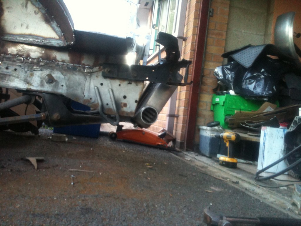

Today i started and finished the passenger side rear arch and fitted the overfender (thanks mark)

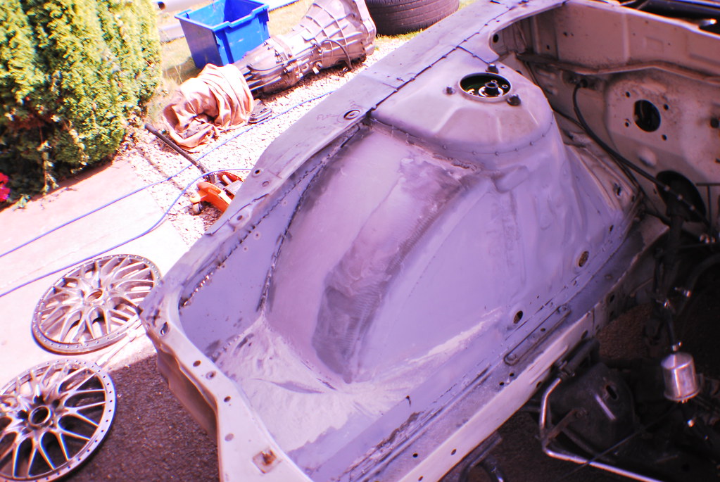

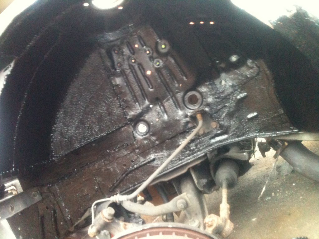

finished patching up the drivers side arch that i started before i even took the engine out, finally! started fitting the drivers side rear over, lining up the fuel cap is a complete bitch!

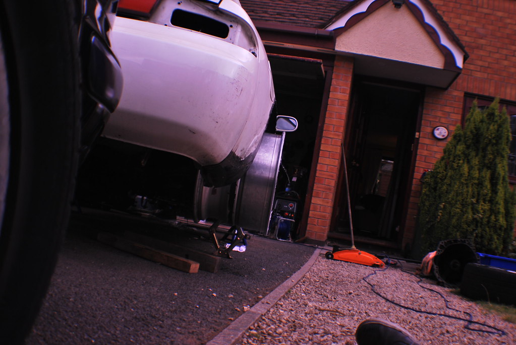

been messing around with the ride height too, i spent aaaaages on the rear trying to get both sides level, still not perfect
snapped a quick on while the back was off the ground:

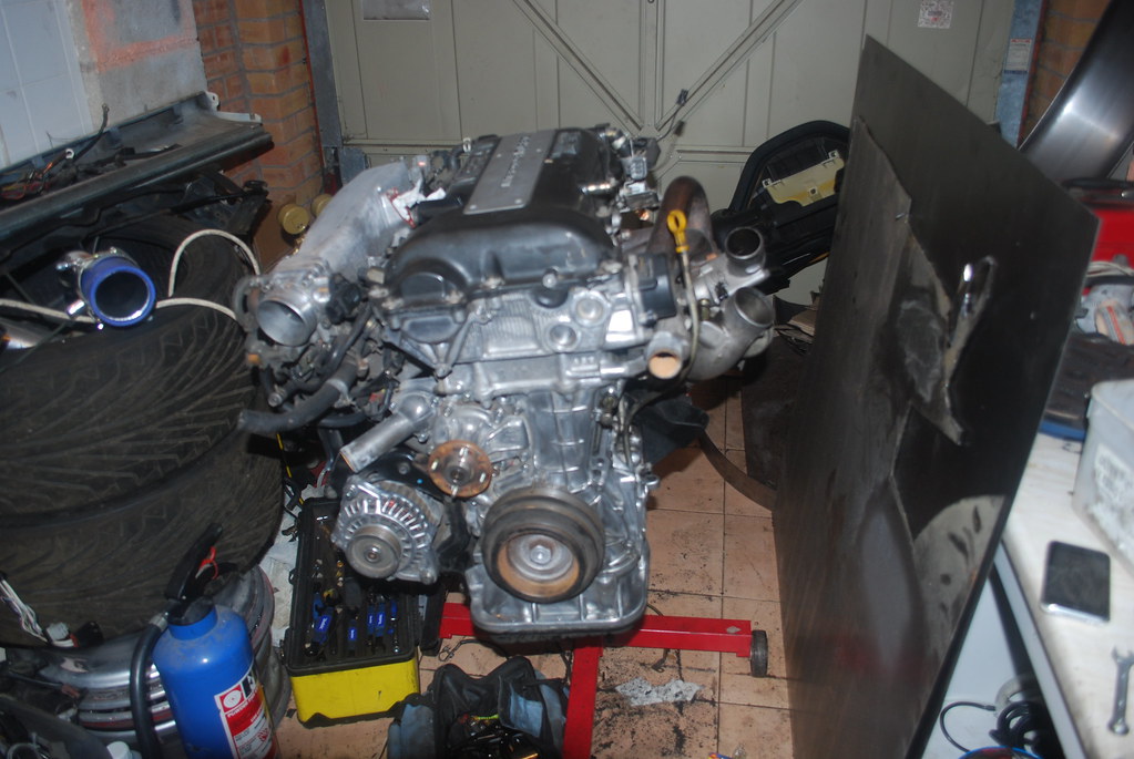

Until i get a new engine start/charge loom i cant actually put the engine back in so im hopefully looking to get one end of the month latest.

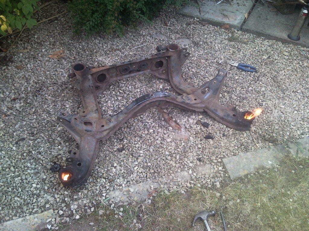

gunna get the new subframe sandblasted, powdercoated and fit new solid ally bushes, but this is all looking to throw off the JAE deadline
