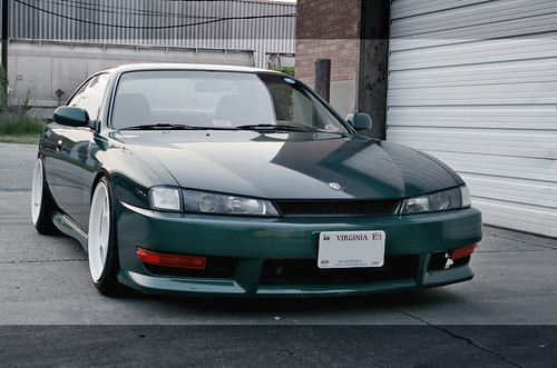

Within a week or so it looked like this:
Then a few months after that I painted the bumpers and picked up some lowering springs/shocks:
I drove around like that for quite some time, I ended up painting those wheels satin black, then traded them for my old 300ZX TT wheels that were satin black. I believe it was about 7-8 months after the above picture that I went to Japan for the first time and bought coilovers, an exhaust, some wheels and other odds and ends (the car was still automatic KA at this point):
Then I sold those wheels after ~6-7 months, did a 5-speed swap with the transmission out of my old S14 (come to think of it I've had something off of my old S14 on this car every step of the way ), and bought the Regamasters:

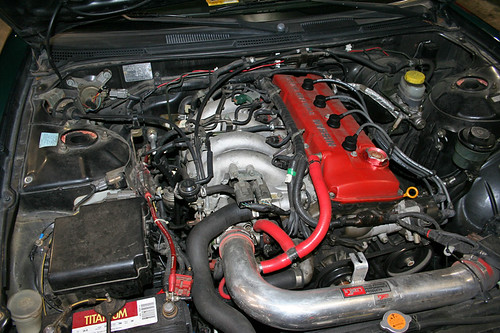

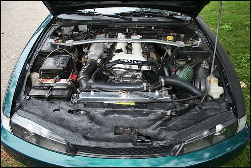

Then I did the SR swap, I'm not sure how long it was after that...I know I did it at the end of May 08:
I've done little stuff to it since the swap, finally painted my rear valances and c-west mini spoiler, some s15 injectors, a tubular manifold, a custom intercooler set up (which used the HKS bypass valve off my old S14), a OS Giken 1.5way, got some Fortune Auto coilovers to replace my JICs....oh, and lets not forget building the RSs, haha.

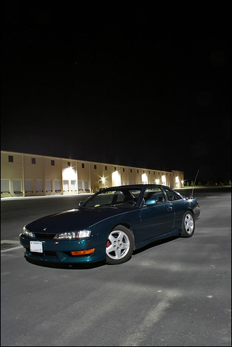

This is how it looked up until a few days ago:

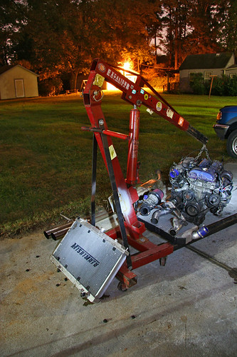

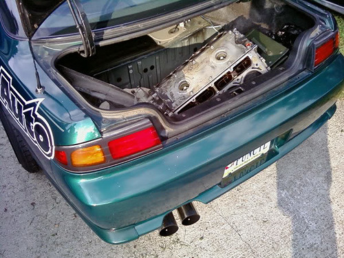

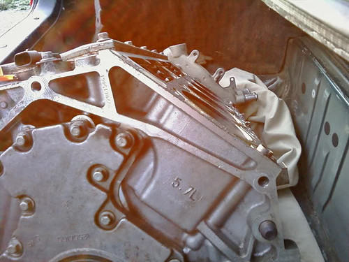

I picked up a LS1 short block a month or so ago and it came with a bunch of extra goodies. I drove it back from Richmond in the trunk of the S14!
I picked up some 5.3 truck heads, an intake with fuel rails and injectors, some LS3 valves, dual springs w/ retainers, and trick flow hardened push rods since those pictures. I am still hunting for a transmission, wiring harness/ecu, throttle body, and a few other bits.

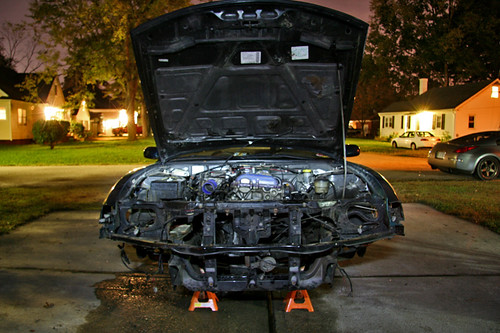

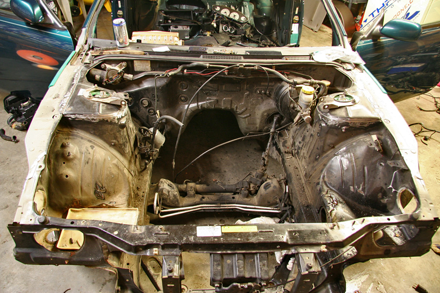

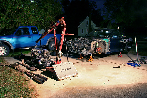

This was the car's state Tuesday:

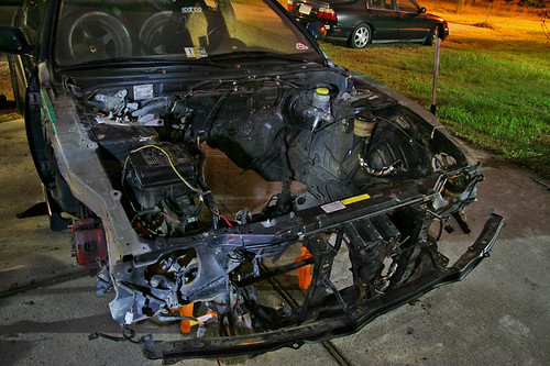

This was the status Wednesday night:

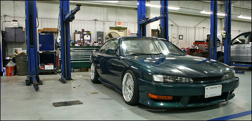

This weekend it is getting towed up to Gloucester where my friend at RE-Spec Garage is going to help me accomplish the next step - cage it, tub it, and a few other things I'll keep as a surprise so you have a reason to keep checking back, haha!

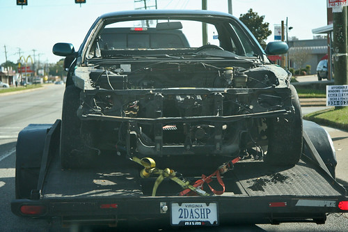

On the way up:
Those straps on the front of the car are pieces of shit and we had to stop on the way and replace them with a much better strap, haha.

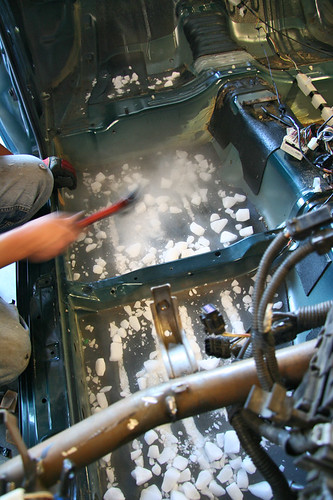

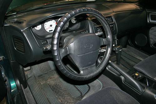

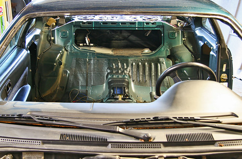

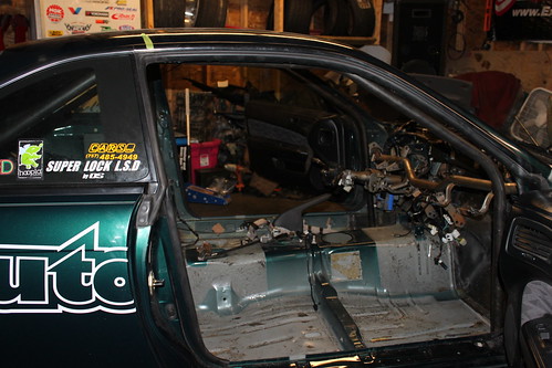

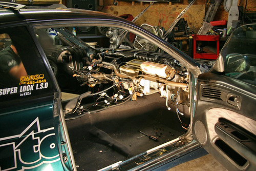

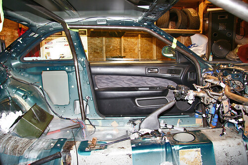

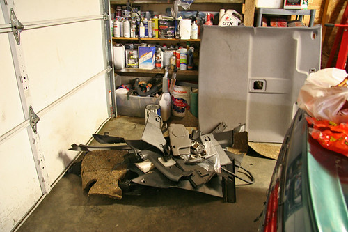

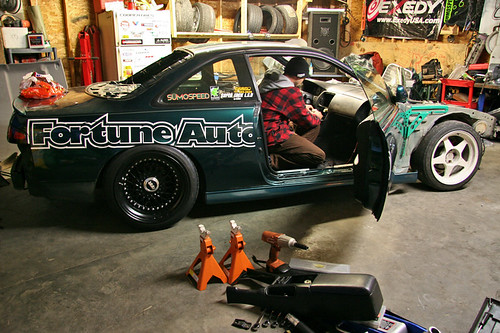

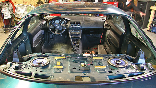

When I got there I finished ripping out the rest of the interior - at this point everyhting was out but the dash/door panels and carpet.

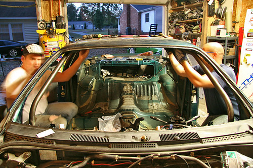

Danny took these shots while Raz and I were dealing with the dash -
The pile of shit from the interior:

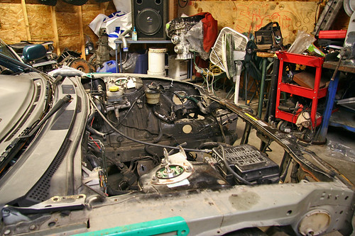

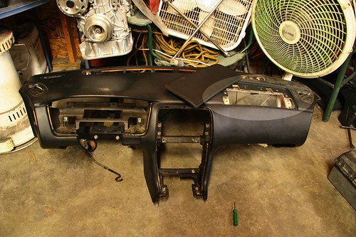

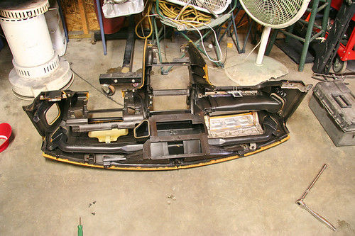

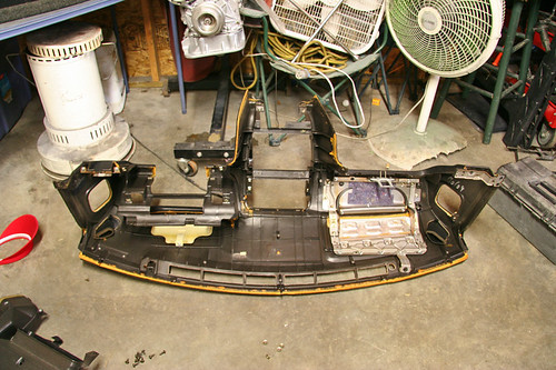

This is what it looks like without the dash:
They shove so much shit in there it isn't funny. I meant to take a picture after I ripped all of the stuff out but it'll have to wait until next weekend now.

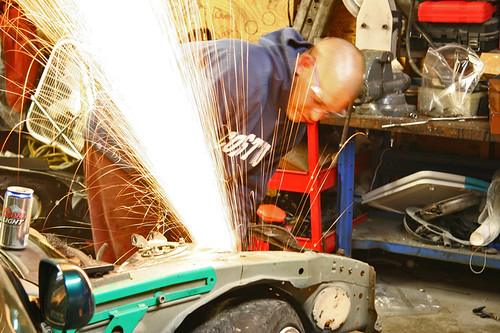

Danny doing work:
Hmm...there's a lot less stuff in here then there was

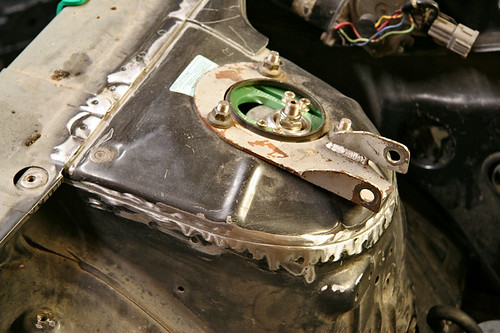

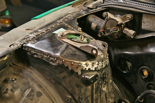

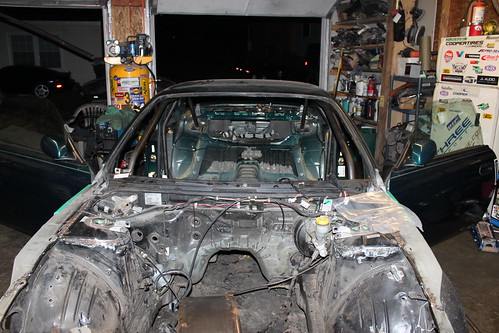

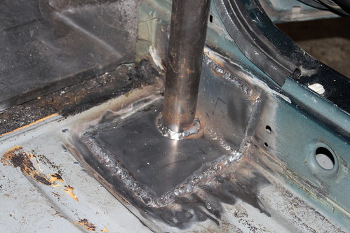

This is what the strut towers look like once the glue shit is removed from all of the seams:
This is what they look like stitch welded:
After the dash was out I noticed all of the shit attached to it would interfere with my wire tuck plans...
I removed it all and it left a whole lot more room available.
This little removable cover will make a perfectly accessible fuse box

While Eric and I works on that (and 'dry ice bombs') Danny and Raz were working on bending the bars for the cage.

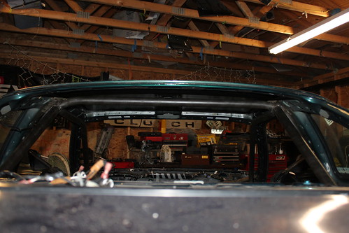

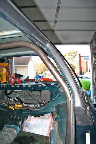

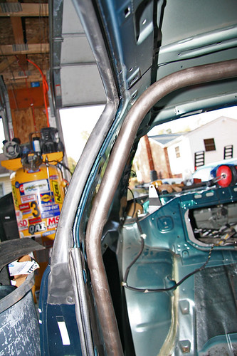

The main hoop came out super fucking tight, just like we wanted it (we're using 1.5" 0.125 tubing). A few spots on the inside of the car were hammered in to fit it, but it fits like a glove! Obviously, it is just sitting there in these pictures so it will not look 100% right in some of the pictures.
The front hoops fit as tight as possible as well:
I have to bring my seat up there before we can do the door bars. I am trying to figure out what to do in order to keep my door panels. The panels are thick as fuck, and I am willing to cut them, but I would prefer for the cutting to occur under the elbow rest area...I'm not too sure if that will be possible.

Yes, they are through dash bars. But where the are only requires a small amount of the dash to be cut, and it really will not be noticeable. It is almost directly where the defogging vents are, so you just cut the 1" of material behind those so the dash can still be removed if need be.

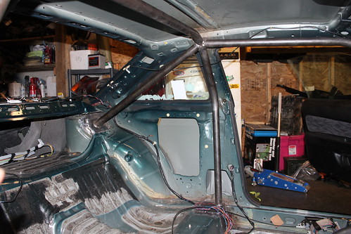

My friend got some more work done on the cage and sent me these pictures.
We are going to work on the door bars this weekend when I bring my seat up there.

cage..
nice cage fitment... I know it takes a little time to get it right but when you aren't hitting your head on it all the time you will be glad you did it hah
