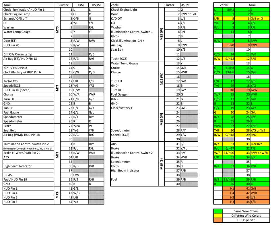

I started pulling apart the JDM Kouki dash harness and after comparing it with the zenki harness I have decided to pull the wires out of the JDM harness and splice them into the zenki. The main reason for this was because the zenki harness has cruise control, illumination dimmer, and OBD port built into it, while the JDM harness has none of these. I will also be taking the Digital climate control, triple-din gauge, and defrost mirrors portion of the harness out so it's going to take some time. Since I'll be splicing the Kouki harness into the Zenki one I made an Excel sheet showing the pin diagram for the JDM Kouki cluster, the USDM Zenki cluster, and what gets spliced together. ![]() If anyone else is out there and wants to put the Kouki HUD in their Zenki all you need is the Kouki HUD cluster with Plugs and the HUD unit with it's plug. There are probably other Nissan cars that use the same plugs in case you can't find them. And the fun begins!

Because of this it took much more time, but for the HUD it's just a few simple splices to wires that already run to the cluster so it's not that big of a deal. If your doing the Kouki HUD and cluster there is already a simple splicing diagram for you and the Zenki version that DFWZenki wrote should help. Another word of advice the wire colors from the HUD pretty much splice into the same wire colors from the cluster, minus one of the blacks which is actually for the dimming function. Also if your looking for the DCC plug head to the junk yard and you will find many Maxima, Alitima, J30, Q45s, etc.. that will have it. I cant remember off the top of my head which car had it but I'm thinking it was an older Q45. I still need to fit the HUD trim to my dash but got caught up replacing a friends Alternator (x3) the last few days (F.U. Autozone!) but plan to tackle this tomorrow!

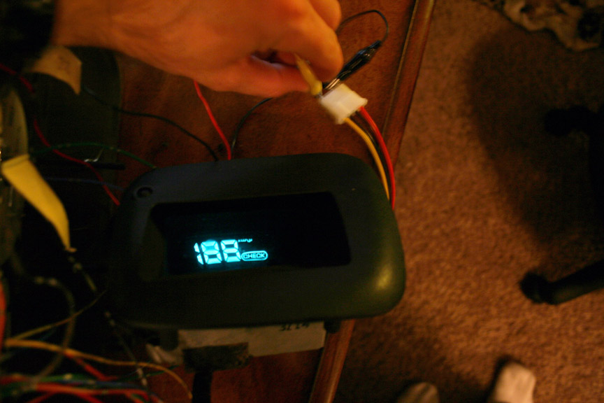

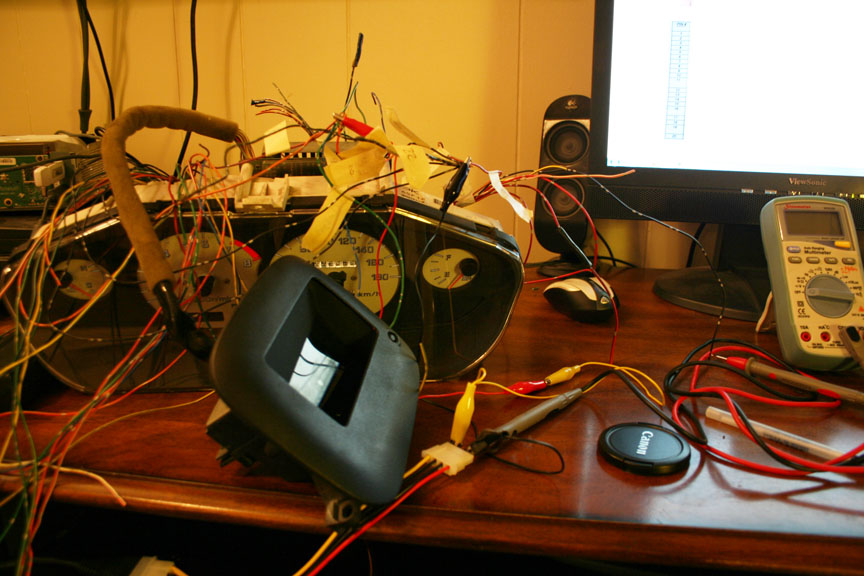

Now that the Kouki version has been up and running good in my car I decided to start playing around with the Zenki version tonight.
Although I'm not actually hooking this up into my car I have been attempting to bench test it to see if I can get it to work. ![]() ...I need a better work space ![]() After going over DFWZenki pin diagram I hooked up all of the grounds and power wires to a 12v computer power supply and all I noticed was 2 very small bits of light coming off of the HUD display and nothing else. That is, until I unplugged the power I noticed the display flash on for a split second. ![]() Does anyone know what might be causing this? Do I have to have it hooked up completely with the various speed/tach/etc sensors and computer, or could it be just a simple ground/power wire misplaced. I know its not the HUD unit itself, I tried 2 different clusters and 2 different HUD units.
