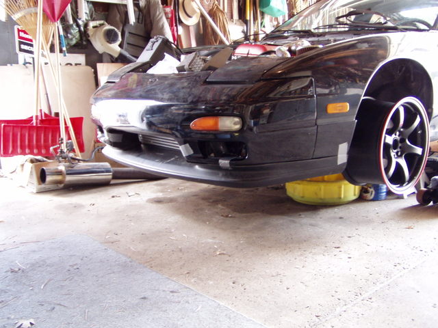

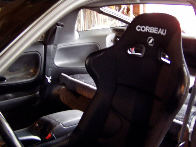

Finally, some current pics. Havent had much time to work this week as I have been spending a lot of time with the lady. Going to work on it tomorrow night though!

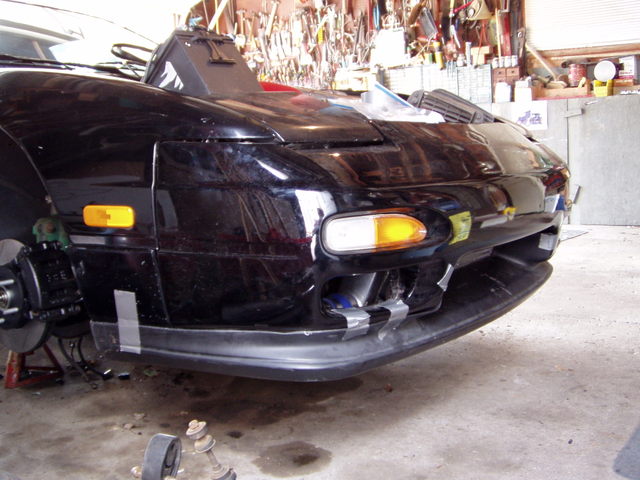

Bumper mocked up, going to fit lip when I can borrow a sawzall:
Corbeau FX1 Pro with Nagisa Low Rail:

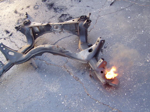

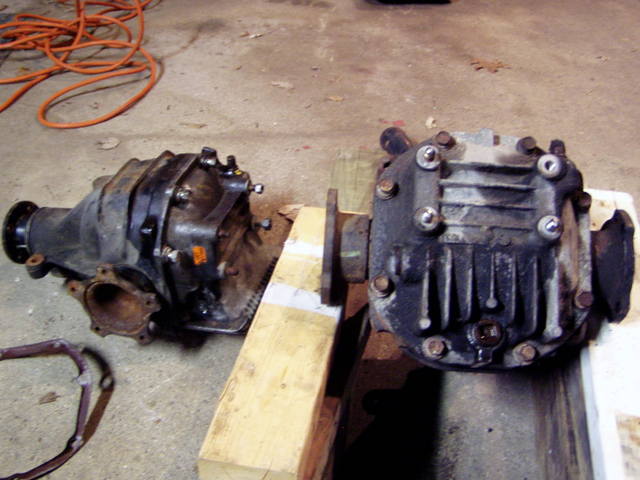

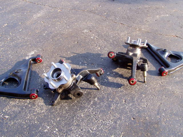

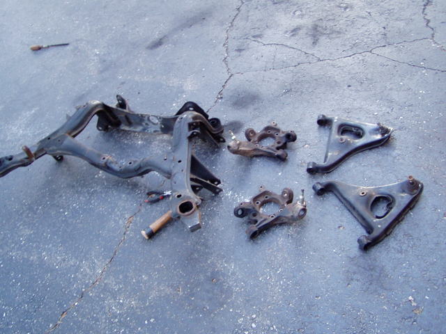

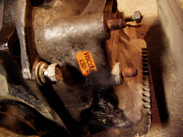

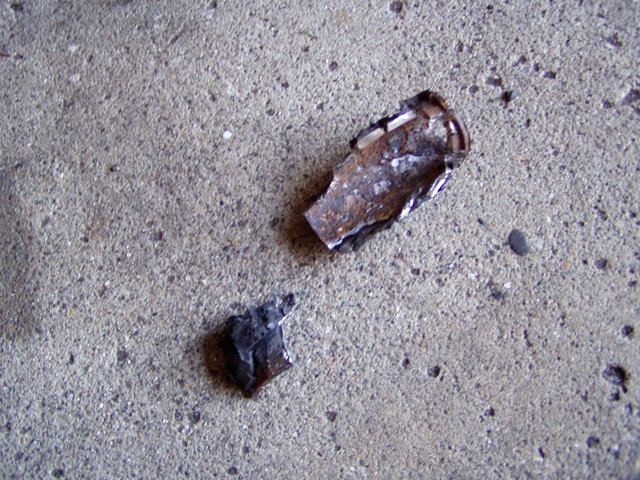

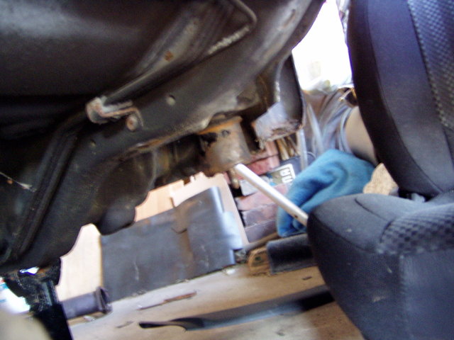

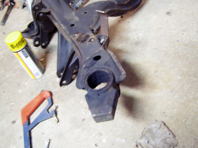

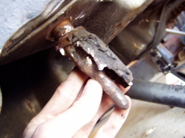

Here is some crap I did tonight... drained both diffs and pulled the covers (pretty sure I need to use the open diff cover to run the vlsd, but I am not positive.) I also had the kind of fun but very smelly task of burning the bushings from my subframe, arms, and spindles. Tomorrow I have to cut out all of the metal inserts and prep everything for paint, maybe spray some if we get time.
fire!!!:
All Burned out (subframe not completely yet):
Diffs drained:
ZOMG VLSD:
A bushing burned out... need to cut out the metal sleeves still:
Spray-bombed hatch, needs clear and wetsanding still... if I feel it is worth it, haha:

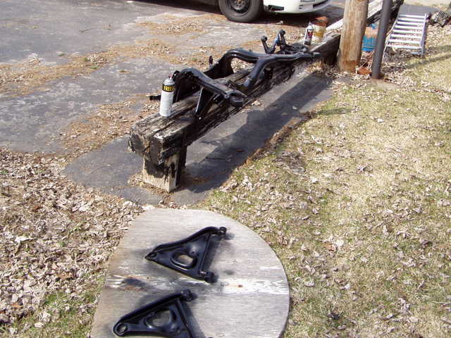

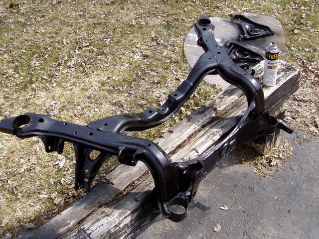

Unfortunately, my subframe bushings do not fit they are too small and fall out of the subframe. I guess when people say that they fit s14 and s13, that might not be true. I am ordering some SPL aluminum ones tonight, so hopefully it wont take long and we can get this party started!

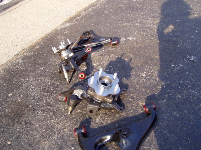

Here are some pics from today- I got all of the other bushings pressed in and repainted the spindles, arms, and subframe. I also clear coated the hatch, just needs some wetsanding action. I also mocked up the front lip, just need to bolt the bumper on and mount it for real. It is coming along quickly and smoothly now!!
Painting shtuff...
Subframe:
Lip w/ duct tape mod:

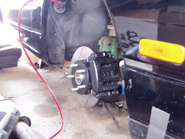

Another brake pic:
Bushings pressed in and repainted, 5 lug:
More soon, tires will be here this week and the subframe bushings should be in within a week.

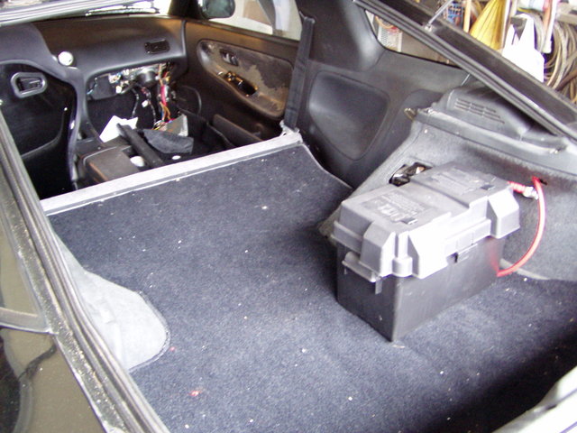

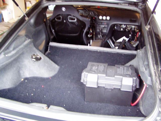

Interior is pretty much in, just need to wrap the glove box and door panels:
w00t for canadian seatbelt swaps... aside from needing a headliner. The battery box is not mounted yet, but I think it will stay in that general area. Subframe bushings arrive friday, should make good progress this weekend.
I'm told I need a shinier battery box :lol:

Well I managed to get one of the stubborn subframe inserts off tonight. It twas a great victory after about 12 dremel cutting bits :lol:
Can't believe how corroded these were... would not budge for anything. The funny thing is the two rear bushings slid right off effortlessly.
The other side, which needs to come off next:
Going to get the other one removed friday, just in time for the subframe bushings to arrive. Should be a good weekend I hope!
