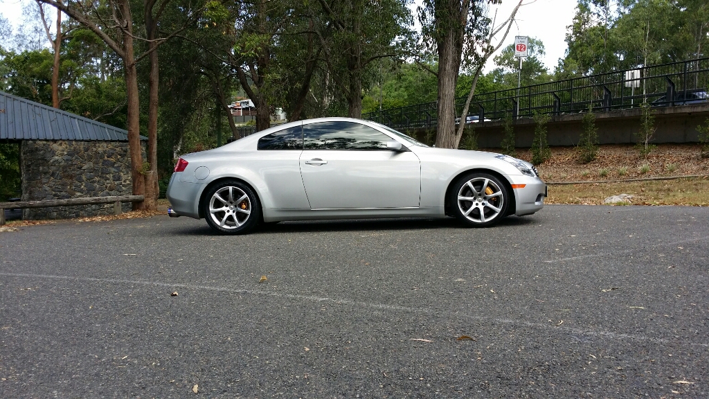

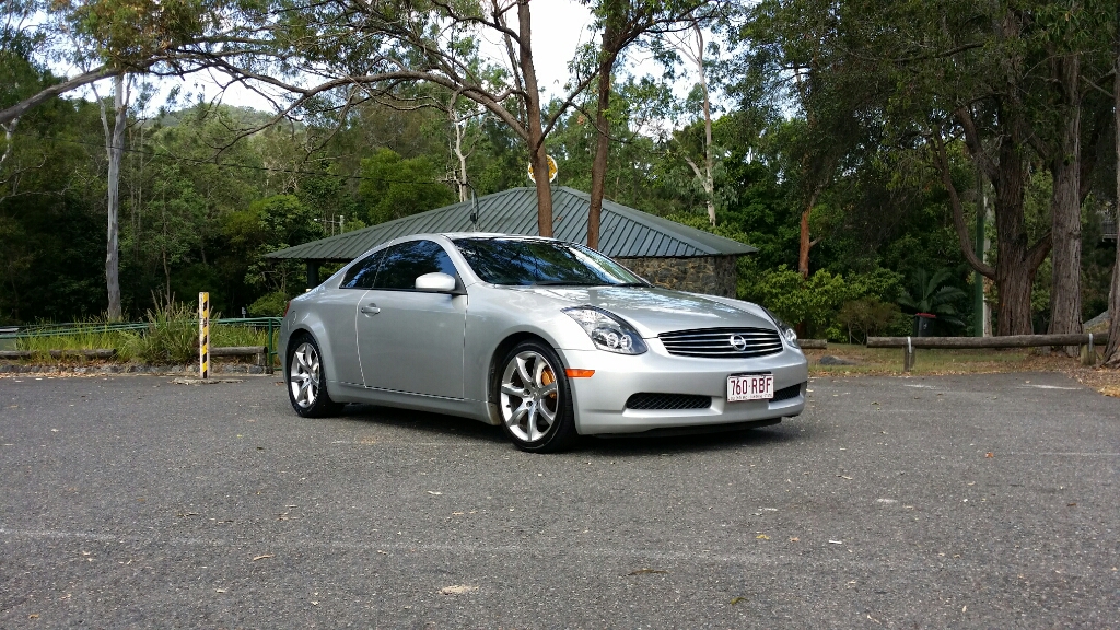

So I’ve been thinking about treating myself to a new cheap interesting daily for a while but couldn’t commit until it could be garaged. Both of my project cars live in our dual car garage – my current daily (shit ute) and nopics 4wd live outside which is not an ideal situation given Queensland Australia summer storms (hail etc).
So finally, after 8 years of procrastination over a few weekends I knocked up a garage under our rear deck. Had a 33qsm slab poured, $25ea garage doors from gumtree, builders 2nds windows & colorbond plus a few hundred bucks at Bunnings on a door & framing materials. I’ve sealed inside with a corrugated iron under roof into its own drain. All weatherproof.
Still needs a weekends work fitting trim pieces and bit more colorbond but good enough to now put use.
Toys now live there freeing up main garage. Needs another 30sqm of concrete leading into but it’ll be fine for a while. Anyway enough on that.
So onto the car. Plan was to flick soul destroying shit ute which Wife basically refuses to drive (2001 Isuzu dual cab manual 4wd v6 petrol/LPG) for hopefully around the 3.5k mark and top up 5k from savings. Wasn’t prepared to spend any more given reality is this car will often be used for train station / day-care pickup/dropoff and shopping centre run – basically no point in getting anything to good.
Decided fairly early on into the piece that the car couldn’t be turbo (ie, I would frig with it 110% and ruin its daily place in the fleet), must have 4 seats, a boot, 4 or 6-cyl – no V8s (no v8 rego) & no euro because want some form of reliability .
So started my gumtree search at 2000 and newer and $5000 upwards. V35 Skylines came up pretty quick. Decent size car inside, decent boot with lay flat back seat, 3.5L VQ35 engine of which I’m familiar with and passed the ‘interesting’ test. Also amazingly cheap to insure (?!)
Lowballed a few guys to around my budget and ended up lining up a 2004 base spec auto. Loosely negotiated a price and went and took a look at the car. Of course the owner (or owners brother who I was actually dealing with apparently) forgot to mention the paint scuff on the front – conveniently missing from the photos as well. That and a few cracks on the dash we arrived at a new figure of $8,000 with one week to do the deal. $100 down and I was on my way.
Typical smokers teeth headlights, reasonable body with a few minor(ish) dents and scratches, all wheels gutter rashed (sigh). That said it was 100% standard with genuine very low KMs which kept me interested. After all daily.
Few days away from pickup wife who works in insurance was asked by her employer if she could head to Sydney Aust for a month to assist with setting up an assessment centre for the recent hail storm – given wife ran a similar operation up this way a few years ago after a similar storm and did a great job she was basically hand-picked to make it happen - I now needed to pickup the car earlier.
Contacted owner (or owners brother) for an earlier pickup before wife left – owners brother wouldn’t budge from a Saturday pickup as from what I could gather the car was his daily driver until it was sold. Started to get cold feet given I wasn’t dealing with the actual owner of the vehicle, was being driven every day to god knows where, owner wasn’t 100% up front with condition and I expected issues with transfer given the owners brother and owner were incredibly unorganised (RWC yet to be organised) – I wasn’t making 2 x trips to pickup the car with a 4yo by my side so backed out of the deal and forfeited my deposit.
So started scouring gumtree again and cast the net a bit wider and ended up finding a car I’d looked at weeks ago. 5 week old ad & 250km from Brisbane so well and truly outside of most search criteria by this point. I’d actually connected with the owner on FB weeks ago when I was originally asking him some questions about it. At that time the car wasn’t what I wanted (lightly modified not standard) but given the bloke seemed like a genuine kinda guy I looked at it again in a bit more detail. Taking a leap of faith we negotiated a price I set off to buy my new daily sign unseen.
Wife in Sydney, in-laws organised to pickup kidlet from school I set off on Friday afternoon up north to pickup new daily.
….mentioned to my manager when I left the office on Friday that I could be late on Monday if the car ended up being a shitbox – long walk home.
A movie, some TV and dinner in the club car later I was met at the station by new daily and owner. Old mate was curious if someone was actually going to get off the train as it has seemingly all taken place so quickly. Quick look over the car at the station and It was better than I had expected which was refreshing. Deal was done and dropped now ex owner back to his house, which frustratingly for him was 200 odd meters from where the bitumen ended on his road. He could never keep it clean.
Car performed flawlessly on the way home. Saturday was spent giving the car a deep clean (found 100 yen) removing years of dust and dirt. Gave the car a quick polish - car was in much better condition again than I had expected.
Specs wise:
2003 V35 Nissan Skyline 350GT – Track spec.
6 speed manual
LSD
Brembo brakes
18” Factory wheels
Factory Nissan alarm & folding mirror options
Cloth interior - mint condition
New BC coilovers
New front end bushes
New HD exedy clutch & non dual mass flywheel.
New tint all round
New aftermarket headlights – RHD lights. Actually suit the car well.
Pioneer double din stereo (Bluetooth hands free and all the bits and pieces)
Invidia Gemini exhaust and cats (undecided if this will stay on but much quieter than I had expected - barely notice it already)
New windscreen installed & new tyres fitted the day I picked it up.
Safety certificate and 5 months rego.
Also received the stock suspension and exhaust.
On the road feels much quicker than I had expected, apparently in the spec it is it should do a high 13 @ 102ish. Feels about that quick but whatever. Compared to the standard auto version I was looking at I can’t believe it’s the same engine/car.
Car came with full Jap Nissan service history / documentation until the year it was imported. Was a Nagoya car so given Brembos, manual, LSD & region most probably an enthusiasts car
As for the folding somehow amazingly I still stayed within my budget - $500 more than the standard one above thanks to stale ad and too far from Brisbane. Incredible amount of car for the money.
So plan from here? - Plan is no plan, nice daily with comfortable seats that wife will actually drive and isn’t soul destroying for me. Cheap interesting lowly deprecating daily success
