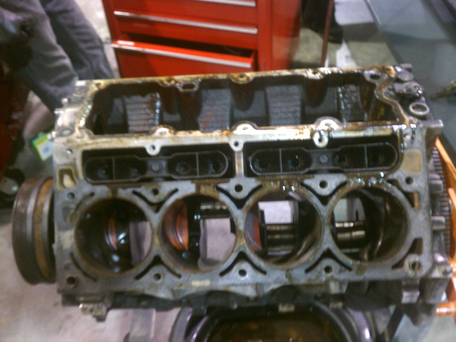

after some major R & D, i decided to rebuild the block and strengthen the bottom end

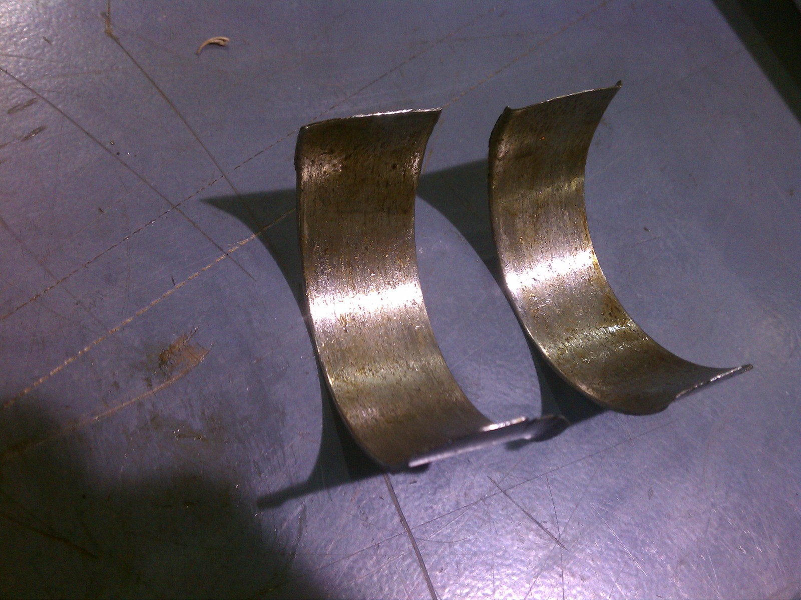

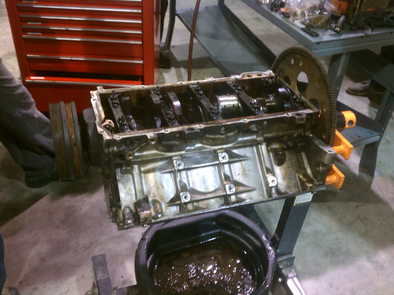

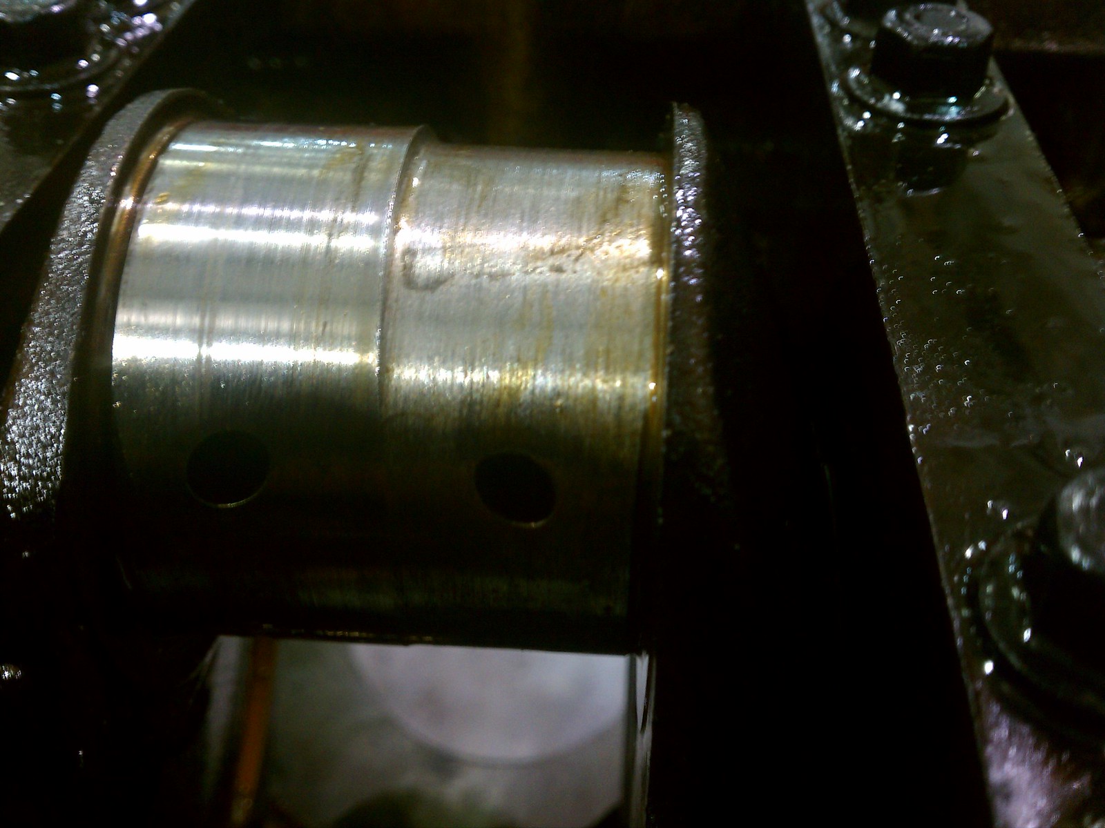

In response to the reply above, I took the shortblock to school and disasembled the bottom end and was very dissapointed
#6 rod connecting rod bearing took a dump, must have had an oiling issue and over reved it

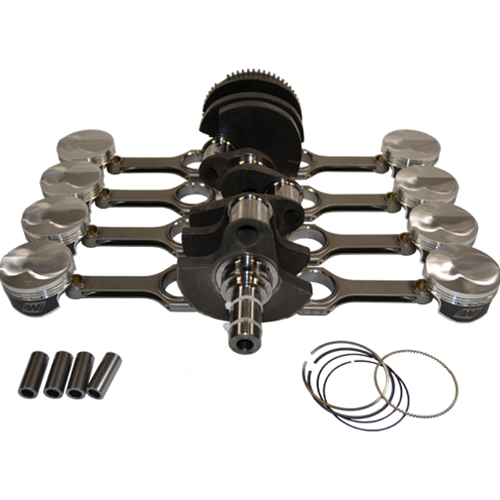

So after all this and 30 minutes of being pissed off, I decided to build an LS7 and stroke the shit out of the motor. Im leaning towardsa texas speed 7.0 kit, with that in mind I want to get atleast 427 Cubic Inches out of her. The motor almost weighs as much as the stock KA24de
I decided on this Rotating assembly
Texas Speed & Performance rotating assemblies offer the best durability with the best pricing available! Our 438 and 441 C.I.D. LS7/LSx rotating assemblies come standard with your choice of a forged Callies Compstar 4.10" or 4.125" stroke crankshaft, Texas Speed & Performance H-Beam 6.125" connecting rods with ARP 8740 rod bolts, and Mahle-8cc flat-top pistons, wrist pins, and plasma moly piston ring set. Callies offers both a 4.10" and 4.125" stroke crankshaft, which we have listed. All of the piston sets listed will work with either stroke crankshaft; The 4.10" stroke crankshaft will require a slightly shorter block deck height vs. the 4.125" in order to achieve a "zero deck" setup.

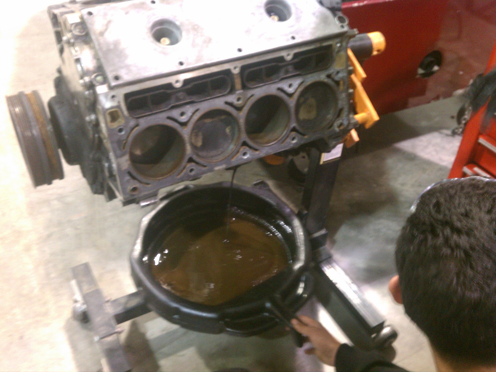

I finally got a chance to measure the pistons and it looks like they are at 3.90 inches, so I'm debating to go bigger pistons, seeing the conditon of the oil the engine had blew a head gasket. So most likely I will be boring the cylinders out.
