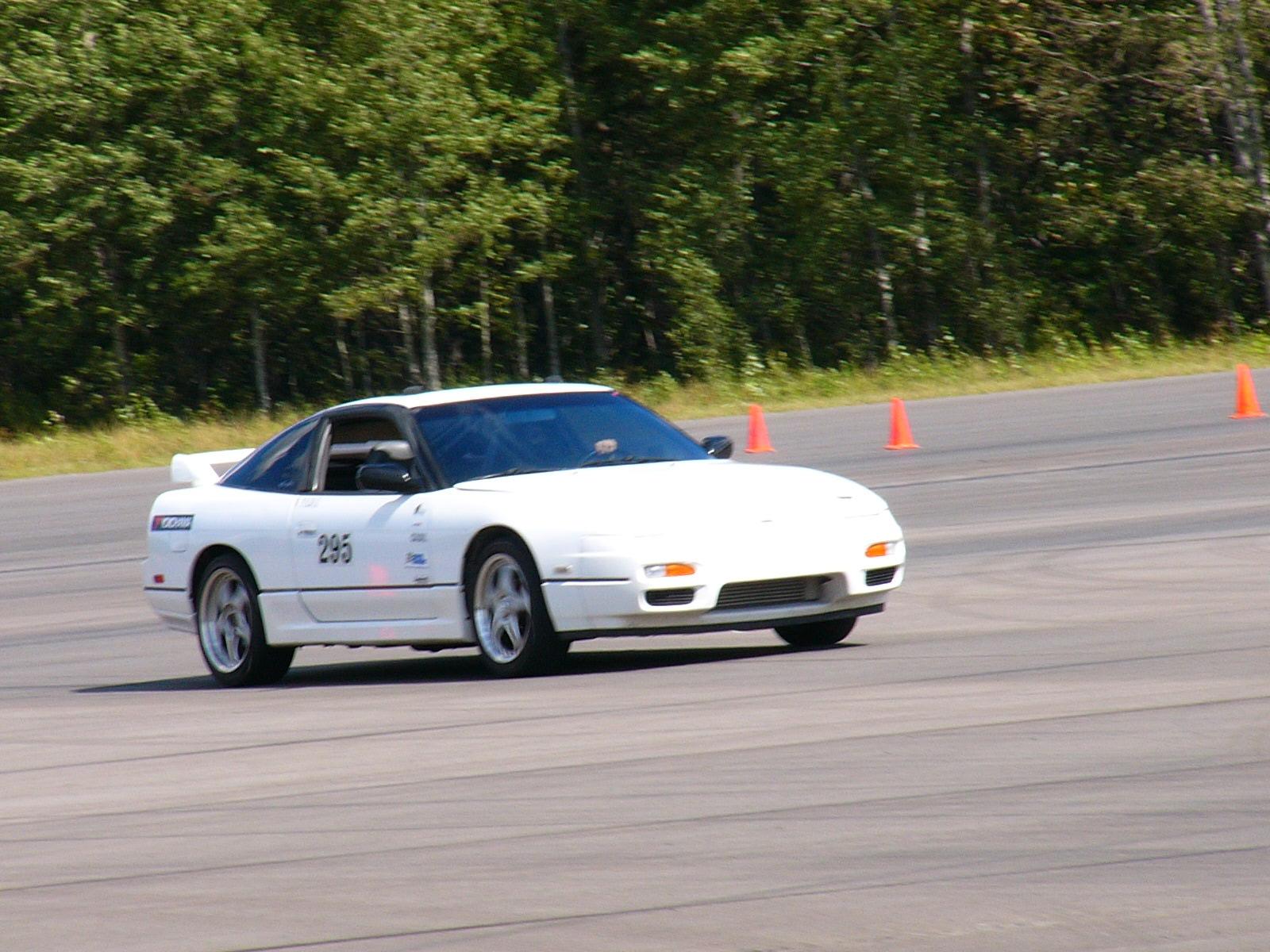

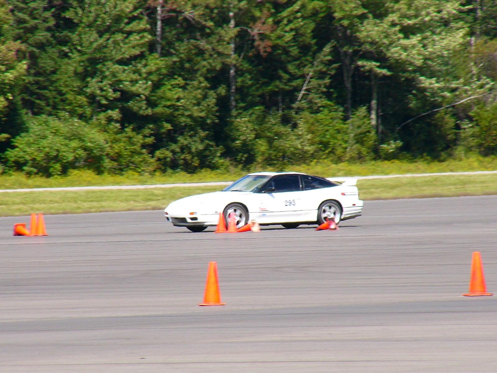

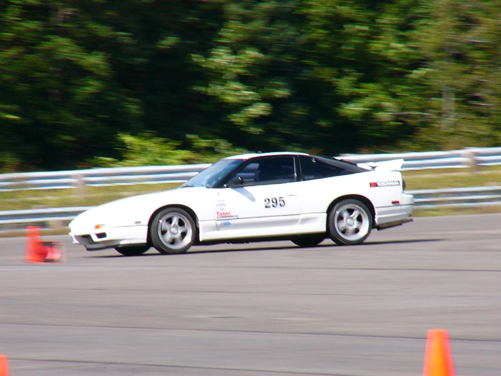

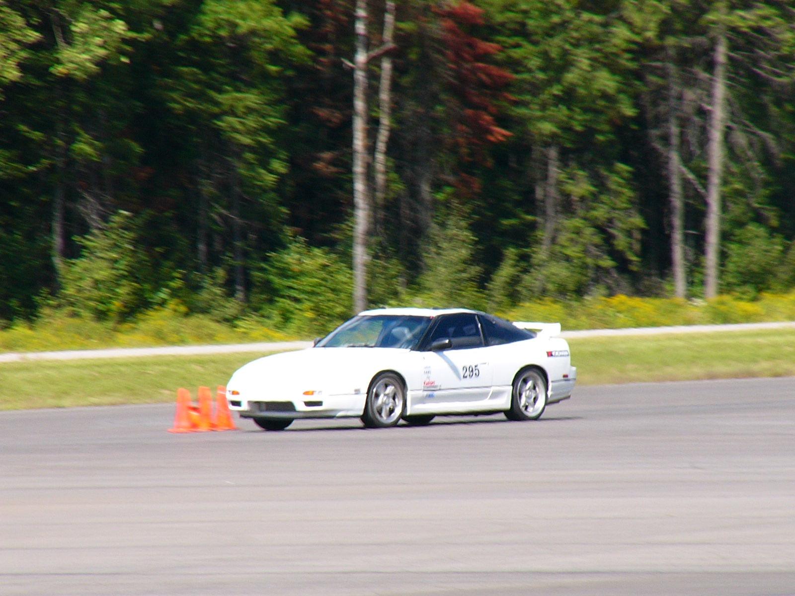

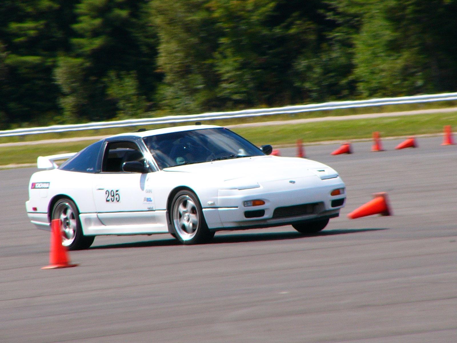

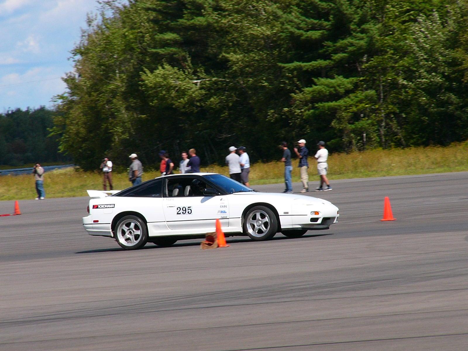

Well... I can't be competitive in the SM class with Bridgestone Bald Potenzas. Last weekend, we had a rapid course. The kind of course that you hit 65-70mph (120kph) with no really tight turns. The kind of course you'd need power AND grip. I had the power, but I had no grip. On a 50 second course, I'm 3.5 seconds back of the leader.
Next year, I'm getting some R's... Here's a few pics: ![]() ![]() ![]() ![]() ![]() ![]()

The potenza's didn't like the yoko sticker and were treating you like a traiter. Maybe you should run yoko's if you are going to have a yoko sticker :-) I don't see Ferrari wearing yoko stickers and they seem to win on "bald" potenza's. looks pretty good though, no tires off the ground not gripping or anything. how much boost did you run in the event?

Oh... Maybe that's why...
![]() Actually, the Yoko sticker is there because they sponsor all our events in the area and it is "polite" to them that we shove some stickers on the car for pictures... Next year, I'll probably run A032R for Auto-X and ES100 for street.As for boost, I was running 10 psi. Had so many problems with the car that weekend. First, I came there with a faulty hydrolic clutch system. Clutch was soft, hard, stuck to the floor. I took out the damper box the day before and bleed the system. Nothing changed. I order a new slave cylinder from Nissan, hopefully that will fix the problem. So my 1rst run was screwed up. I was fighting with my car. In between my 1rst and 2nd pass, my e-fan broke. So I ran my 3 last runs with no e-fan. Managed to get better times, but it kept bothering me. I also believe I'm scared of my car. Too much power, little grip, very nervous engine. I can't seem to be able to floor the pedal on straights and to take the corners more agressively. I brake early, accelerate late... I hope I'm going to shake that off next year because it annoys me a lot.

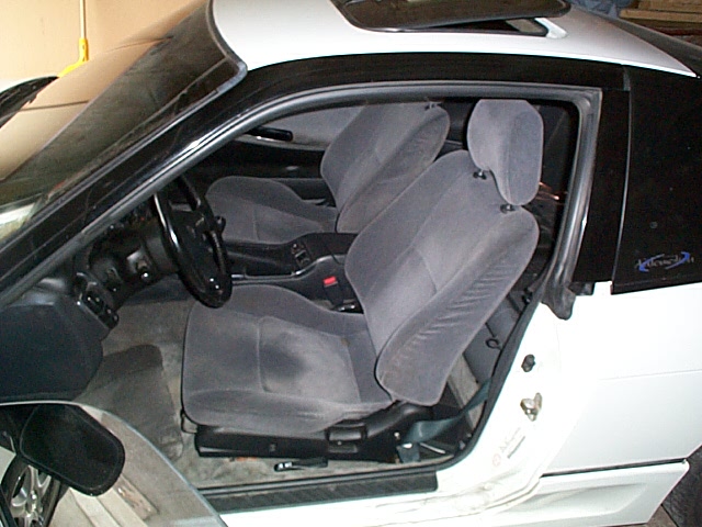

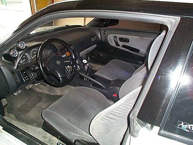

I followed your advice and got some s14 seats.. I can't believe what a difference only the seats make.. Can't wait for my harness to come in! ![]() ![]()

They made a big difference for me too.. they have much better side bolstering.
just a heads up, but you loose about 1-2" of leg room with the s14 seats as long as the lapbelt at the right rear corner of the seat is there. The s14 seats hit it.. the s13 didn't. You have to install the manual seat belts (s14 or Canadian s13) to gain the space back. probably not an issue for you, but it is one I thing I plan to do.. I'm 6'4" though.. so leg room is a comodity EDIT: Nevermind.. I just noticed you already have Manual belts.. DAM CANADIANS!! lol ![]()
