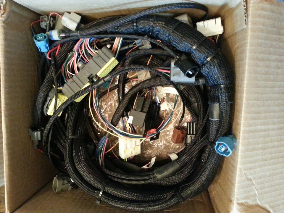

Small update for now, got the wiring specialties harness the other day, haven't quite had time to install it but the list of "to do" is growing look for more updates soon!

Wiring specialities refused to make a harness for me. I have bought from them before but yuriy said they couldn't make an auto 2jz vvti harness for s13

I'm the automatic test mule. they haven't done an auto JZ harness, this is the first. not sure they have done much for the VVTi stuff yet so that could be another factor.

Auto harnesses will be available one day. Nick is helping us with testing.
Let us know how it goes.
