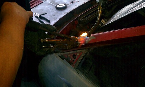

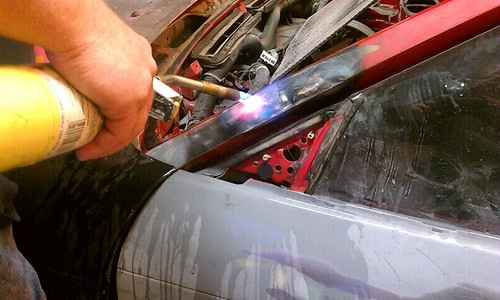

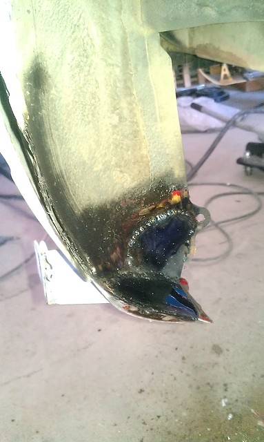

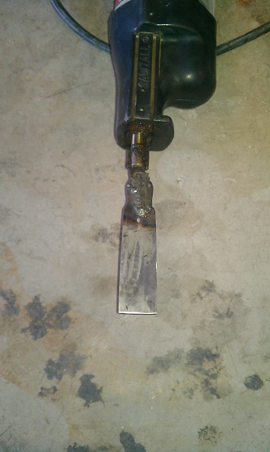

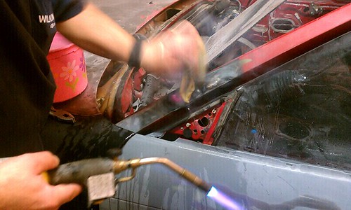

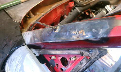

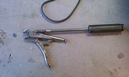

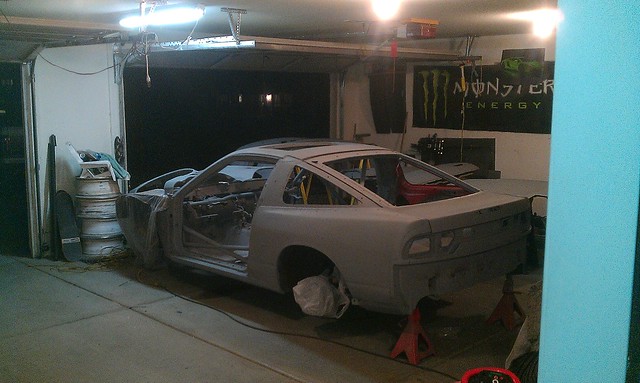

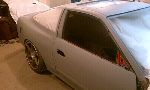

Made some progress the last week. Had a buddy come help out with the pillar dent.
we used this dent puller by welding a tab on and heating up the area and pulling
and then once we got it close we just did a heat and shrink. Got the metal red hot then hit it with a cold rag.
so after all that it took very little filler for how bad it was. this is what we ended up with.

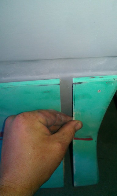

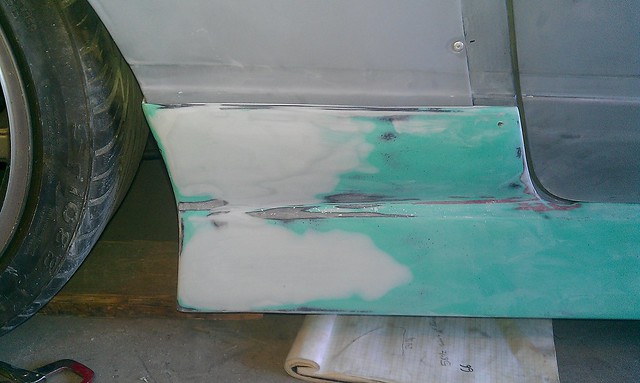

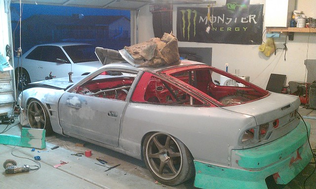

We also got the rear fenders mounted finally. Also test fitted the fronts and body kit. still have some tweaking to do on that.
And got some primer on from the doors back.

3/22/2012 Update
Well It’s been a long year since we have started this build. We have learned a lot and done some things twice and fucked something’s up in the last year. But it feels so good to be on the tail end of this build and ready for Vegas FD.
Anyway on to the update.

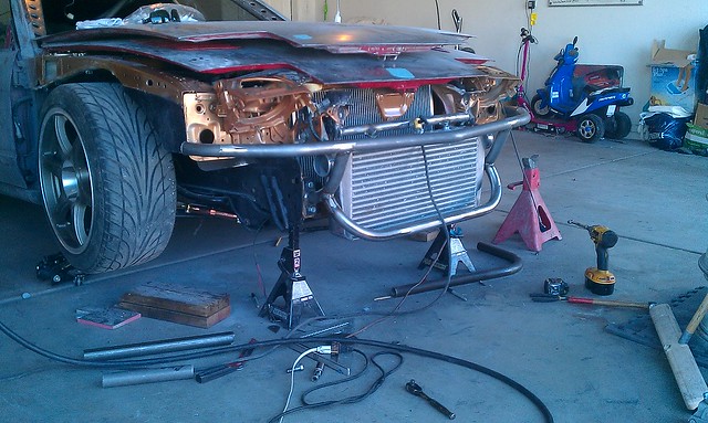

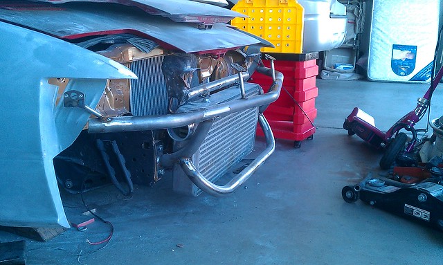

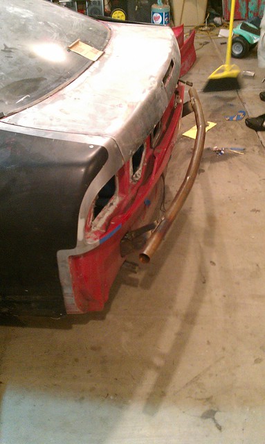

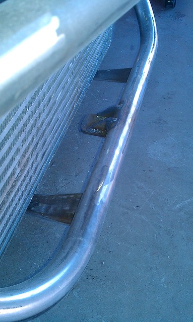

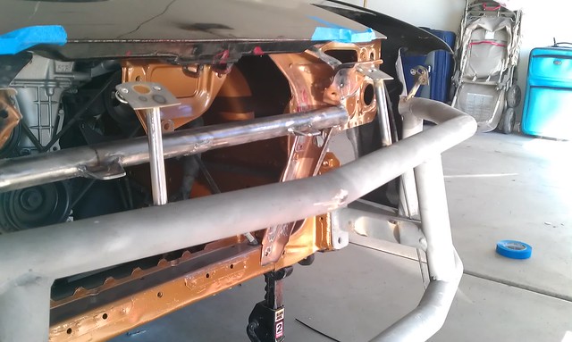

Rear bash bar

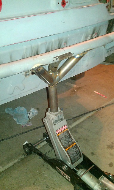

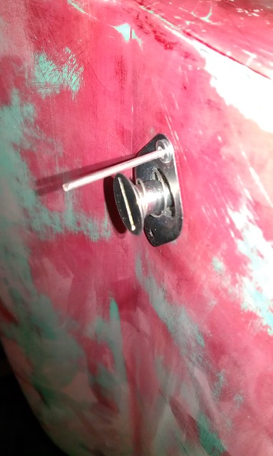

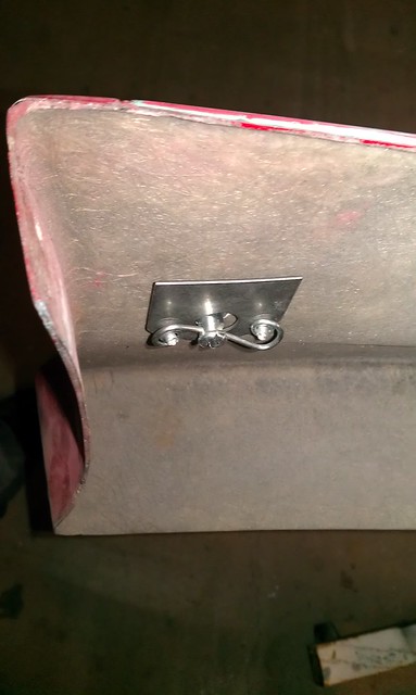

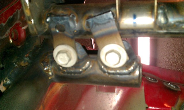

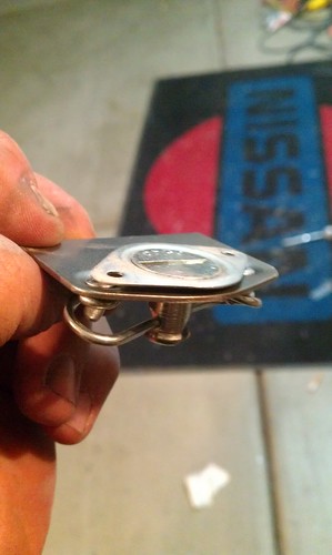

We decided to run a self-ejecting D-Zus on the front and rear bumper so we can remove them with ease.

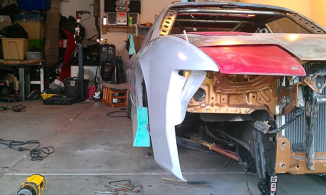

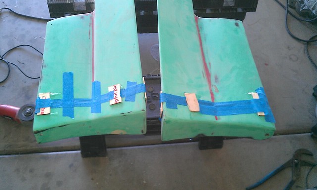

After the D-zus were mounted we started to heat gun the shitty extreme dimensions fenders. The rears fit of but the fronts were just pure junk. So those fenders are in the trash. Have no real pics of how bad the fronts were. so while waiting for the new sex fenders from frsports we did other things.

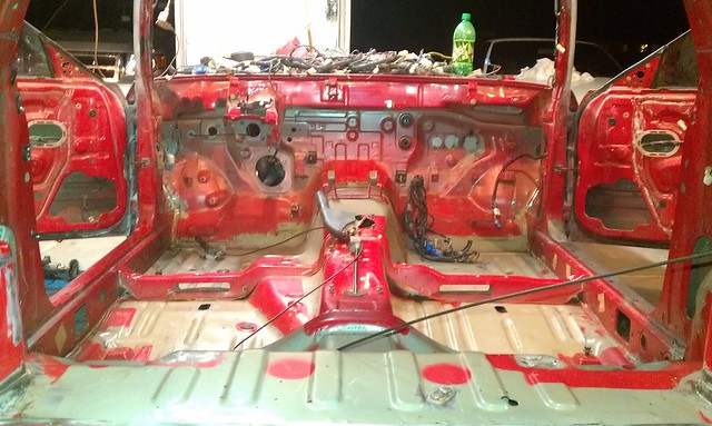

Started off by removing all the sound deadening bull shit to prep for the cage.

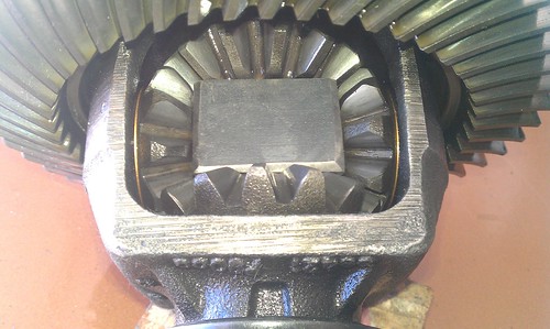

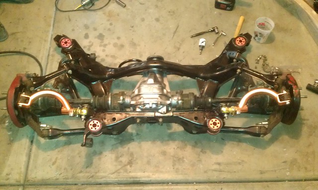

Then decided to remove the rear subframe to weld the diff and clean it up.
no pics of it welded we all know how they look

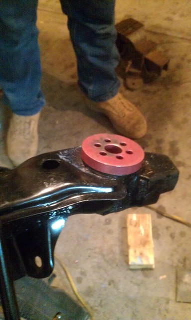

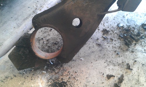

We then decided to upgrade to some Stance Sub frame solid bushing.
so we burned the old ones out while they were on order from frsports.

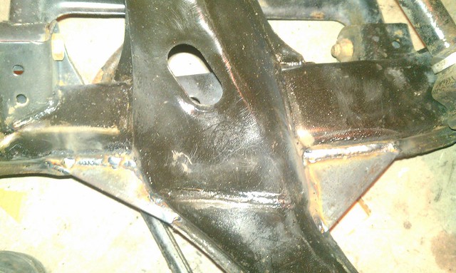

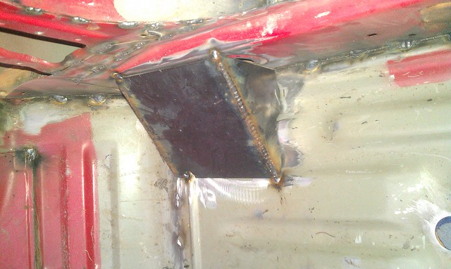

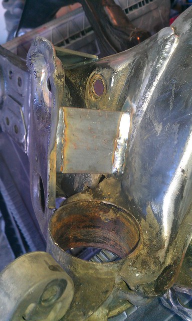

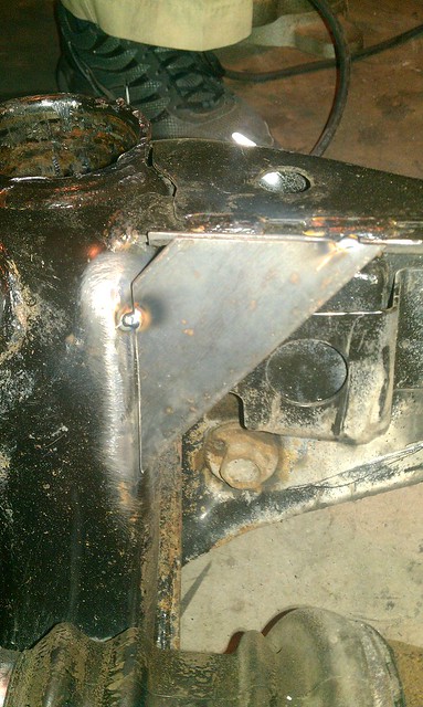

While waiting for the bushing me friend bought a welder and and talked me into doing gussets and boxing the ruca mounts.

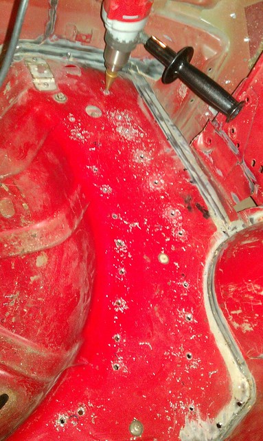

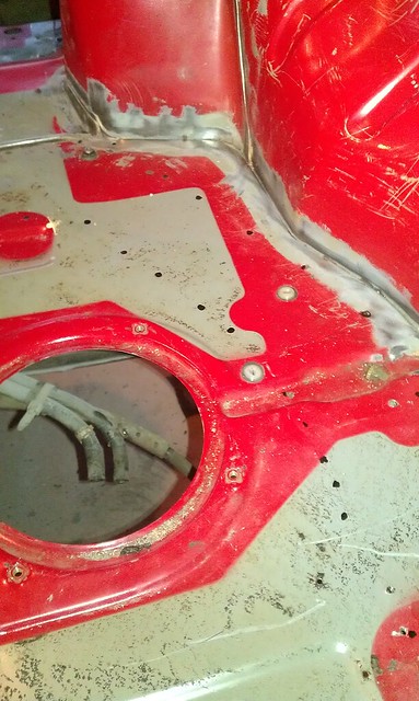

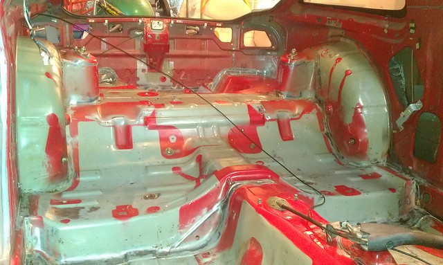

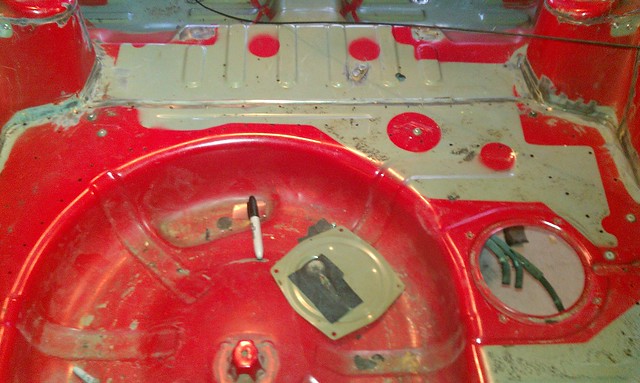

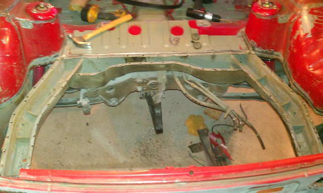

Still waiting for the bushings he talked me into removing the spare tire trunk pan and doing some bracing and a nice bead rolled floor pan.
started by marking all the spot welds
then went to town on drilling them out
floor pan out
Bracing we put in

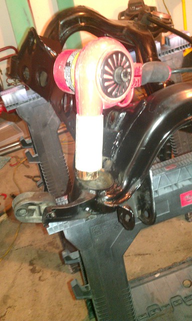

then the bushings came in. Thank you frsports of being such a kick ass company and hooking it up.

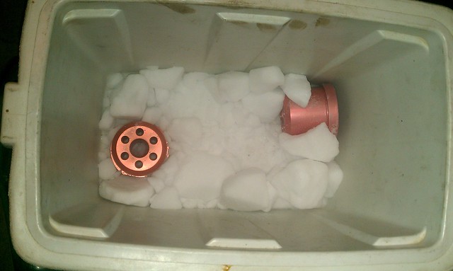

Dry Ice getting the bushings cold for install
Our only way to heat up the subframe for easy bushing install
bushings installed

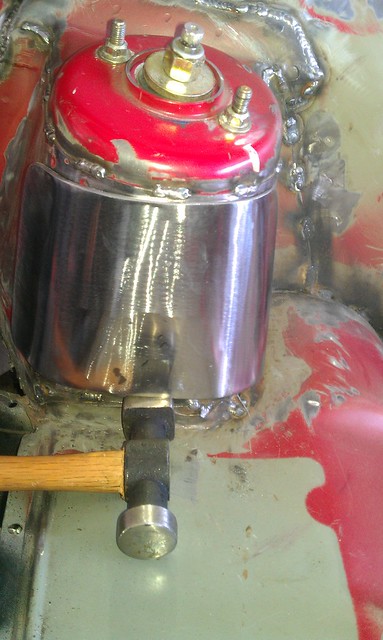

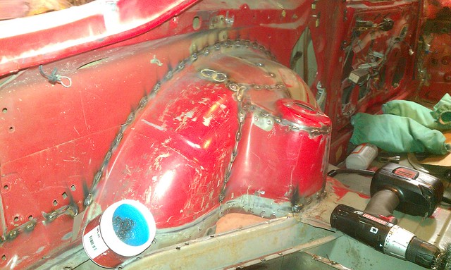

The subframe back together with some PBM RUCAS

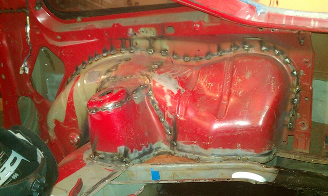

after the install of the subframe we went to stitch welding the chassis

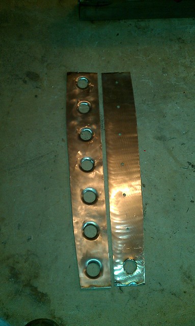

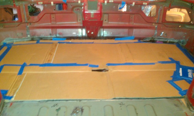

Then bought the metal for the new trunk floor pan. 20g Cold rolled.

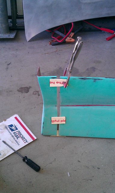

Our pattern for the new piece

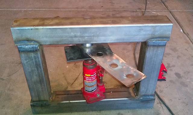

then we cut it out of the 20g and took it to a friend to have it bead rolled
So from this
To this sex
( this is also going to help for a good mounting spot for the 16gal fuel cell )

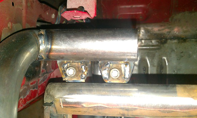

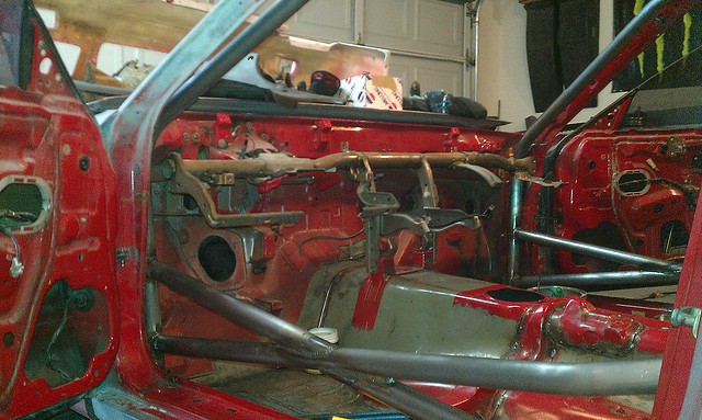

After the install of that we Made the 3 1/2 hour drive to frsports to pick up some new parts. Unwrapping will come and be posted.. Got some free shirts plus a bad ass hour of bullshitting with a couple of frsports sales guy while we wrapped this for the 3 1/2 hour trip back to Havasu.

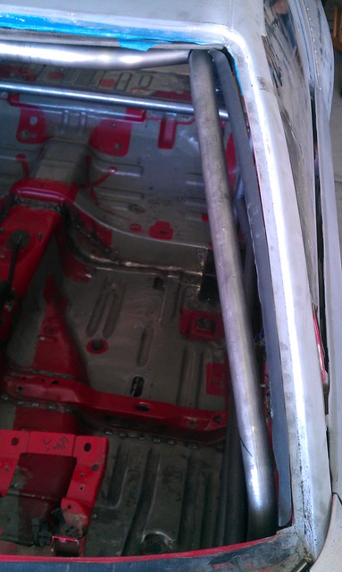

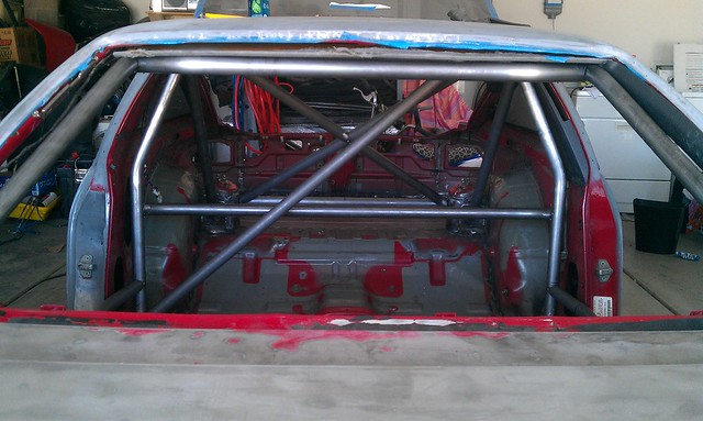

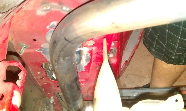

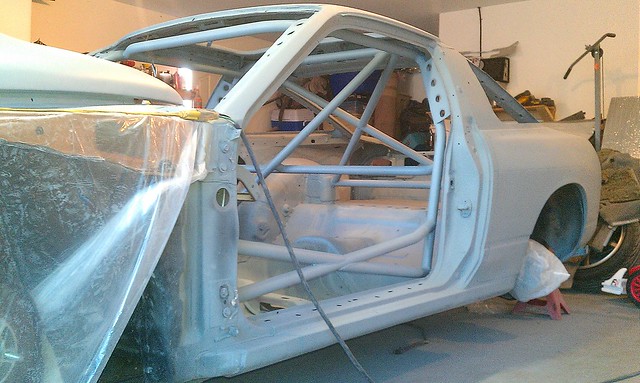

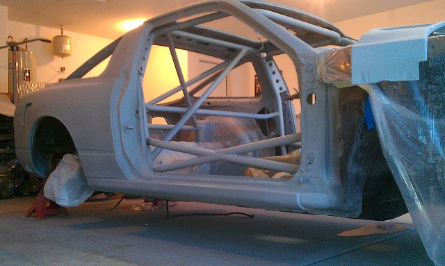

Once we got back from Fr we started the cage a couple days later.

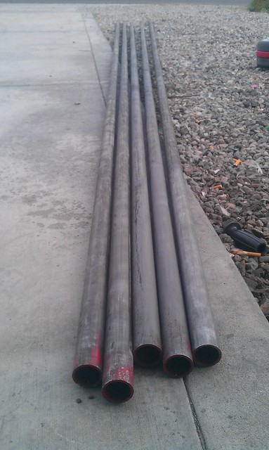

Got this delivered to the house for freeeeeee 90ft of 1.5'' .120 wall DOM.
The whole goal behind the cage was to make it to where we could run all the panels from the rear struts forward. Just for more of a daily driver feel.

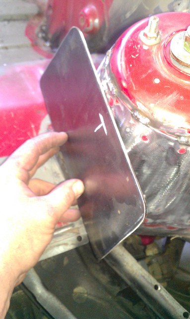

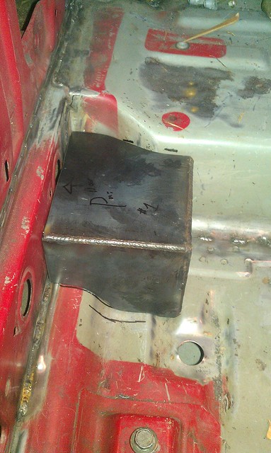

Started off by make the strut tower mounts. 2hours of bending and banging to get them where we liked..
Once they were welded in we started bending and mounting tubing.

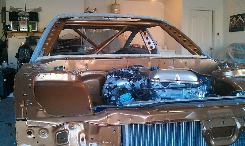

Once we had most all the tubed mocked up we started to make the boxes for the cage floor mounts.
tdaffern is offline   Reply With Quote
Old 03-23-2012, 12:42 AM   #69
tdaffern
tdaffern's Avatar
Join Date: Aug 2010
Location: Lake Havasu City
Posts: 699
tdaffern is an unknown quantity at this point
3/22/2012 update #2

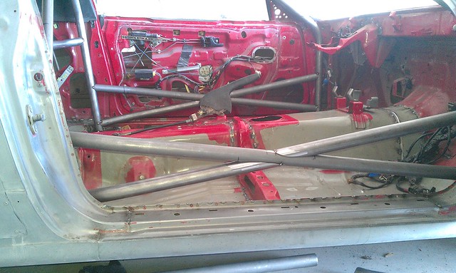

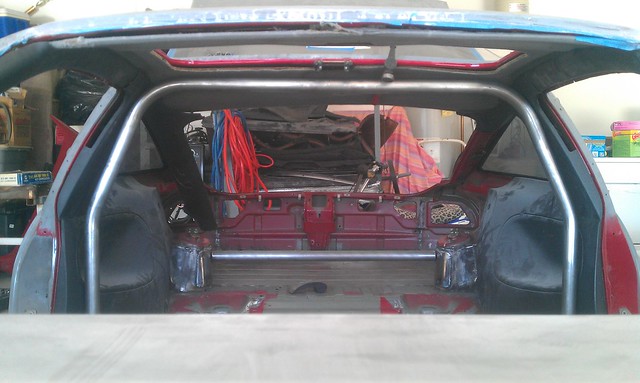

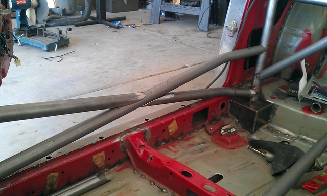

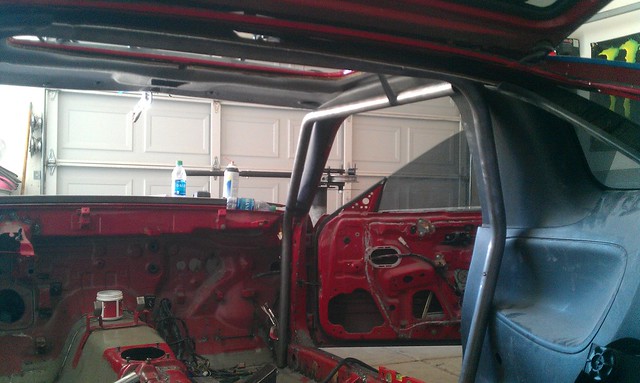

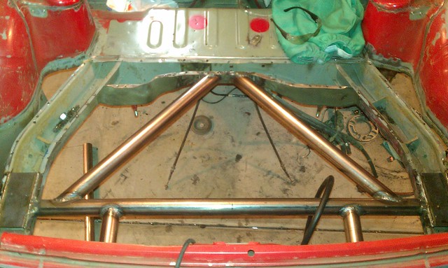

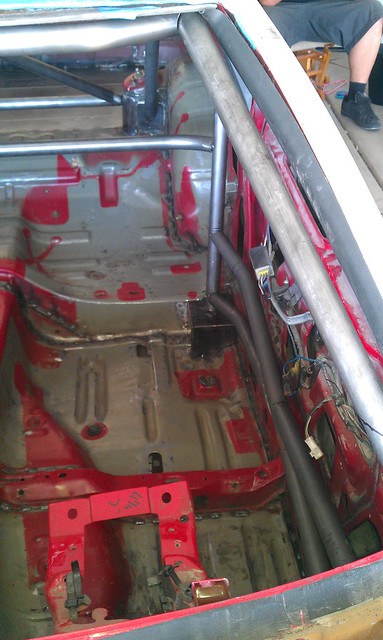

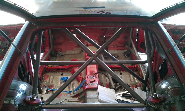

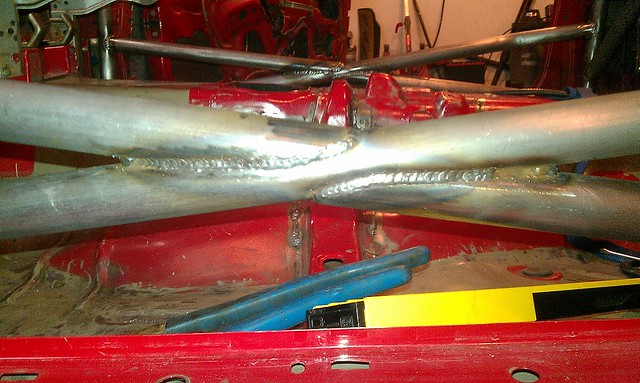

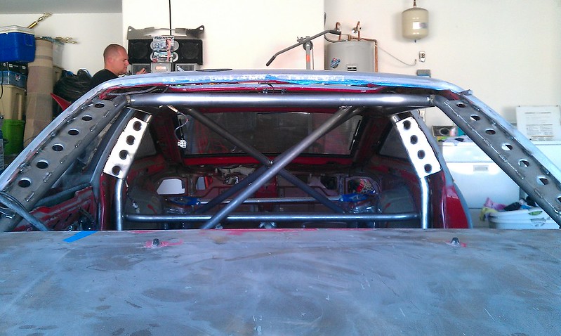

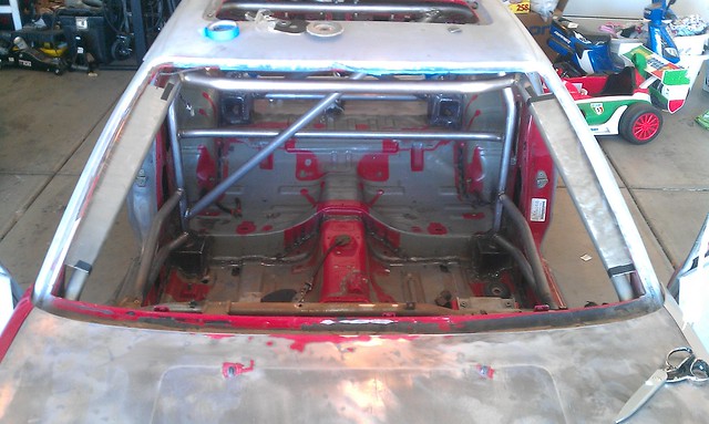

Once the floor mounts were made and tacked in we started to run all the Tubing
The door bars have an out kick because were big guys and want the extra room

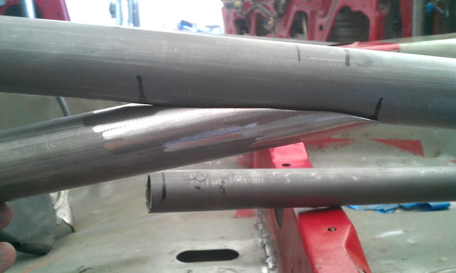

door bar hand cut fish mouth lol

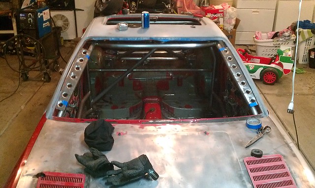

The cage is now fully welded in i don’t have very many pics but I will post some ASAP

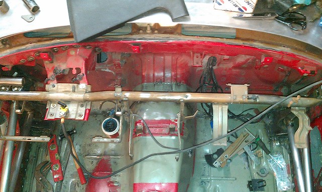

Mounted the dash bar.

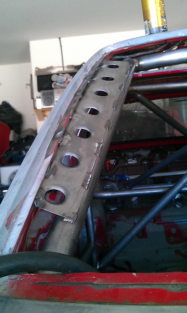

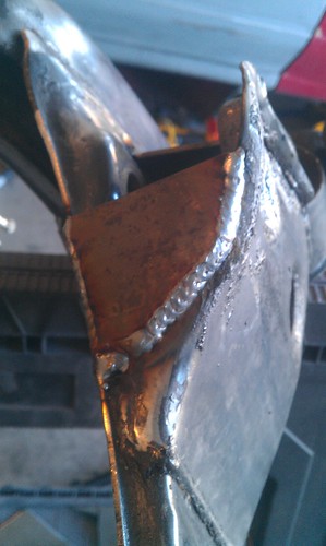

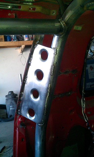

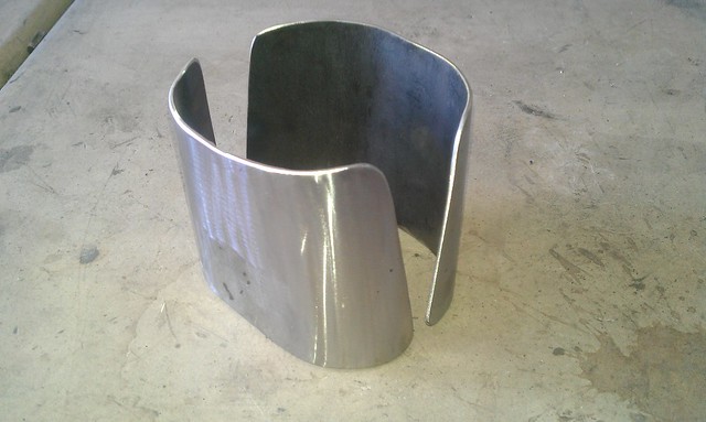

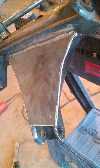

Then I got a 1'' dimple die from friend and made the Cage Gussets
I work with what I got.. My little Gusset machine lol
Welded in

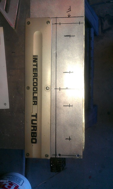

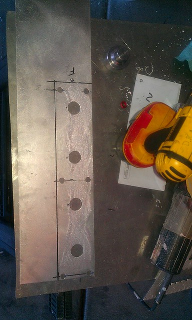

Then I made this in 20 min just playing around
But what do you guys think we should run
Option #1
Or Option #2

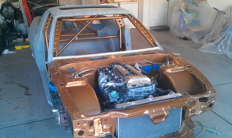

As we left it tonight

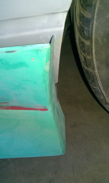

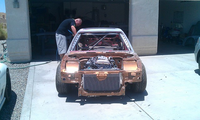

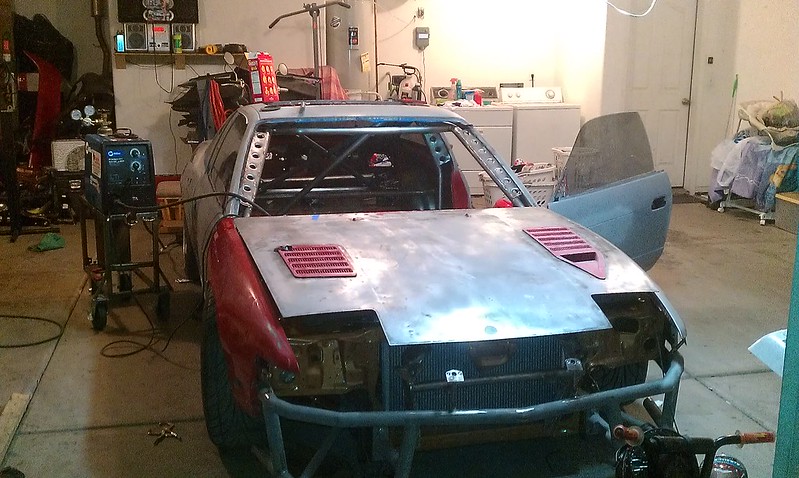

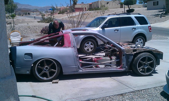

Thanks man. Its really hard to be patient when i havent driven the car in over a year, but it will be worth it in the end.

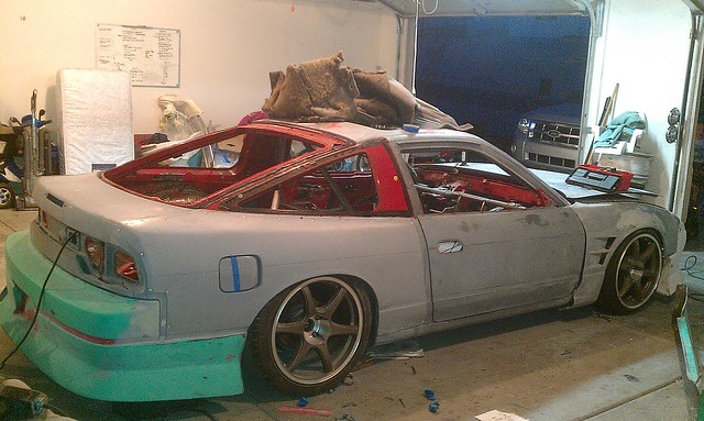

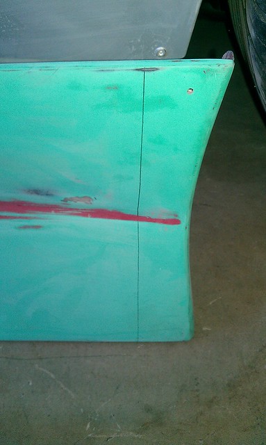

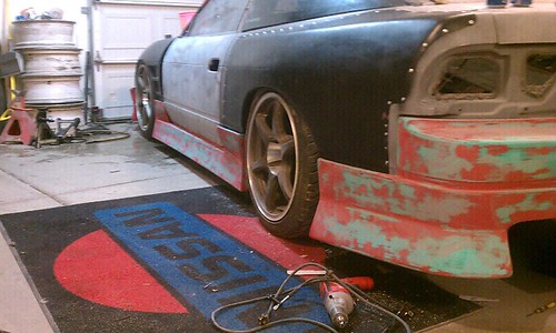

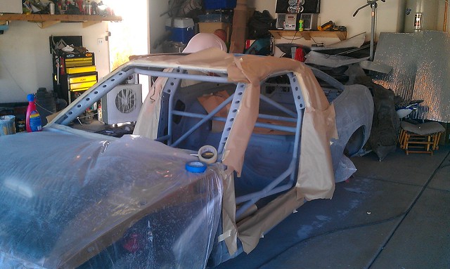

update for today:

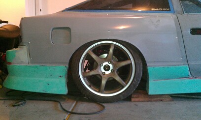

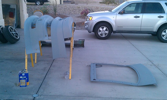

Got the new over fenders mounted. Origins look so much better and fit fantastic, hardly any sanding needed to get them to fit.
Aslo started getting the fronts mounted up. Just a few more tweaks.
This weekend should be able to finish that up, start a new bash bar,and get everything mocked up. Hopefully finish that up and all the body work within the next few weeks. Then PAINT!

Update for 3/29-6/16
After we got the rear Origin 50mm overs mounted we worked on mounting the 40mm fronts noticed some minor waviness on the fenders so it was fill time and more sanding.

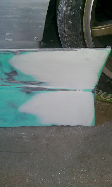

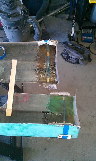

Once the fenders were on we tired to mount the side skirts. But for some reason with the 40mm fronts and the 50mm rears the skirts were 7/8'' short so it was time to extend the skirts.
my cut line
where i cut the skirt you can see the gap i had to fill
i cut down a paint stick and uses some 60second epoxy and gued the paint stick where i wanted the skirt to be held together.
After the epoxy was set up enough i used some blue tape to keep the fuberglass resin where i wanted it.
I then took some 10 oz fiberglass cloth and put the strength back into the skirt for filling the gap Got two layers of cloth.
I then took the paint sticks off sanded away the epoxy and filled the gap on the other side with light weight filler.
all better .. fit like a glove now
after this was done we decided to go back to body work got alot of the dents we missed fixed the front fenders and block sanded the car again
We also decided to build a new front bash bar. The other one looked like a foot ball mask. The front bash bar now has a center jack point and mounts the fmic to it and the bumper supports. We olse decided to flip the fmic upside down for shorter fmic tubes and ease of install.
Finished bash bar.. We also had to re mount the self ejecting dzus fastener back plates for the front bumper.
Center jack point and lower fmic mounts
We also decided to put a center jack point on the rear bash bar.
After that we took all the windows out for paint. We were trying to use a torch and heat up a putty knife but that was a no go. I remembered this tool the window guy had when he came to remover the windshield so i made my own. 1'' putty knife welded to a sawzall blade and holly fuck did it work just keep it lubed with some water. Had all the windows out in 15-30min
all the windows out
We were doing some cutting on the rear of the oem fenders to make the 50mm overs for better and found some rust so it har do me patched.
In the last week plus we have been sanding - filling - sanding and painting. As of now that car is fully primed and ready for paint. The cage has been painted and we are letting it set up for a couple days because we want the cage copper and the car silve so its got to be taped off.

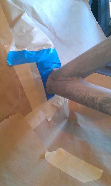

the car up and fully primered
taped of the car for over spray when painting the cage
The cage all painted up and ready to rock.
We decided to use a 16oz aluminum BudLight bottle for a radiator catch tank because this build is powered by budlight .
Budlight Can + -4 bulkhead + -4 90deg an =
In the last 3 months there has been alot of work but alot of down time to. I know i have missed some thing in this update but if i remember i will put them in.
