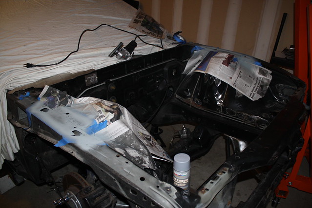

Unfortunately I haven't gotten a ton done on the car lately due to conflicting schedules with my welder and just being busy with life in general. Here's a small update anyway though:

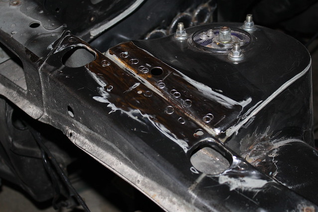

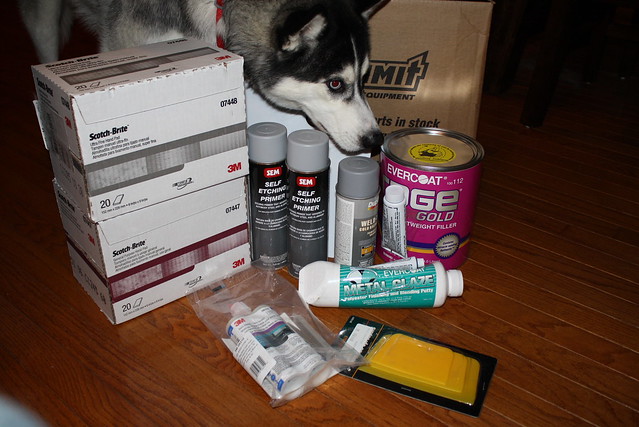

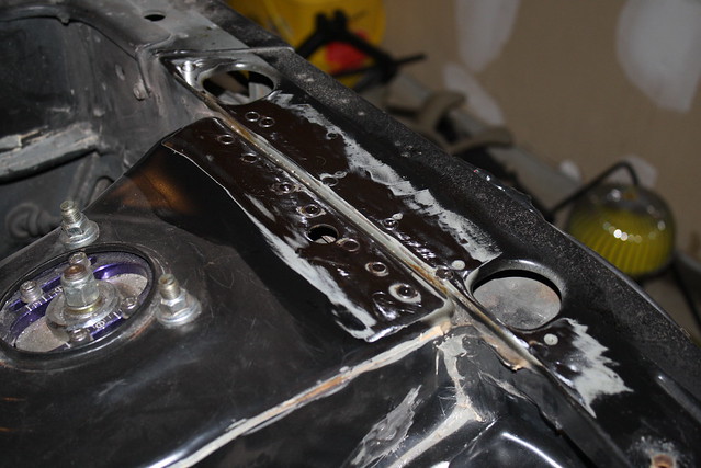

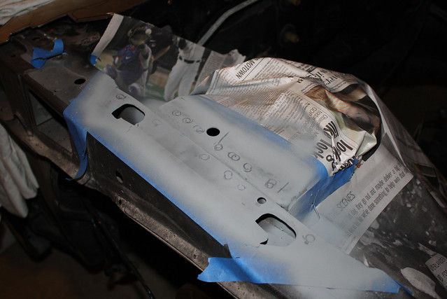

Supplies from Summit arrived for prepping the bay for paint. Thanks to Toby for all of the advice on materials and the process: ![]() Strut tower area braces removed, rust cleaned up. Circles are from where I got a little too rowdy with the spot weld removal bit: ![]() ![]() Primed with DupliColor weld through primer. I am in the process of making new braces out of 18 GA steel that will be welded in place next week: ![]() ![]() That's where it sits right now. My welder-bro can't make it out again for about a week, so I am going to try to start on the filler in the areas that are welded up and ground down a couple of nights this week if I get a chance. I've got a cold starting up and a busy weekend away from home, but hopefully I will make some progress this week anyway. |

Here is a list of prep supplies for the bay: Evercoat Rage Gold Evercoat Metal Glaze SEM Etching Primer DupliColor Weld Through Primer 3M Gray and Red scuff pads 3M Bare Metal Seam Sealer I bought all of those items from Summit at Toby's recommendation. I'll post up about the process as I go along. Right now, all I have only really used is the weld through primer on the strut towers and the red pad to scuff the bay down before starting on using any of the filler. I've still got some welding and grinding to finish next week before I really dive into these supplies. |

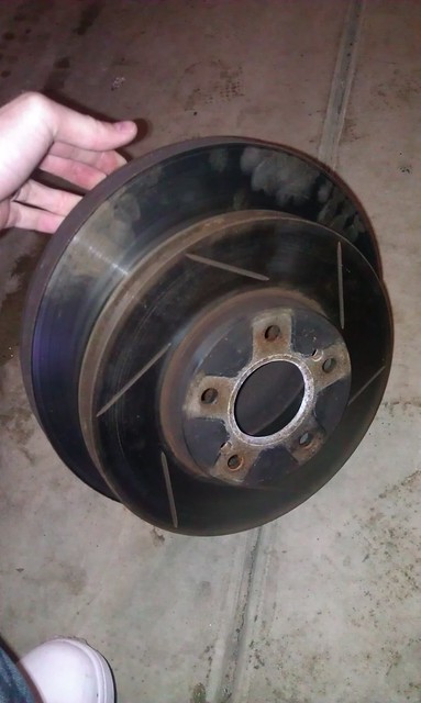

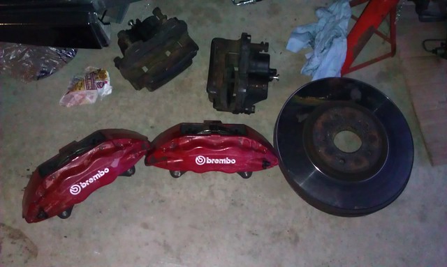

I picked up part of my new brake setup for this year from a local dude this weekend- Evo 8 Brembo front calipers, pads, and rotors. It's pretty crazy how much bigger they are than the Q45 brakes, which were bigger than the stock brakes. I am stoked to get these on the car! I grabbed some crappy cell pics before I left for work this morning: ![]() Evo 8 rotors vs. Q45 rotors: ![]() I ordered the bracket kit to install them today, so I can test fit them when the brackets and hardware arrive. Before everything is finalized, I will install slotted rotors and some new pads, replace the seals in the calipers, and have the calipers painted or powdercoated. Not sure about color yet, but I will probably just go with gloss black. As you guys probably know, I am running OEM rear brakes with Brembo blank rotors and Hawk HPS pads at the moment. I'm going to convert those to Z32 rears, so I need to start sourcing all the parts for that- if you have any of the Z32 stuff for sale, shoot me a PM! My friend Mike is coming over tomorrow night to finish up all of the welding for me, so it will be awesome to have that portion of the bay completed. From there it will be all filler and body work to get it ready for paint. |

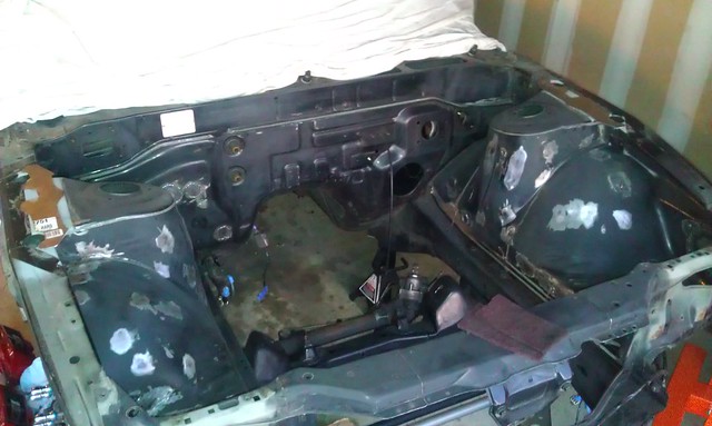

Quick cell shot on the way to work this morning. The bay is almost totally scuffed, and I finished shaping the strut tower pieces last night. Welding and grinding will be completed tonight! ![]() |
