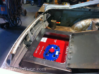

I did some things.
Fuel cell install. Apparently these plastic cells are tapered. So brackets will be underneath. Using cardboard is fun! Going to be making a box so i don't have to build a whole fire wall. ![]() Got the idea from the DIY autotune land speed car! I have been toying with some ideas for a hydro. This car is strictly a drift car never sees the street or any other kind of event. So Instead of having a separate caliper i am going to unhook the rear brakes from the system and install them into a hydro handle. While im doing that i am going to be doing a brake booster delete, upgraded master, and upgrading to z32/r32 front brakes. I have a few people saying this should work pretty well. While drifting if I am left braking, having the rear brakes doing anything is just going to be holding me back a tiny bit. So i am curious to see how well this works. If not what i do is totally reversible. Last edited by shoguner; 02-18-2015 at 11:49 AM.. |
