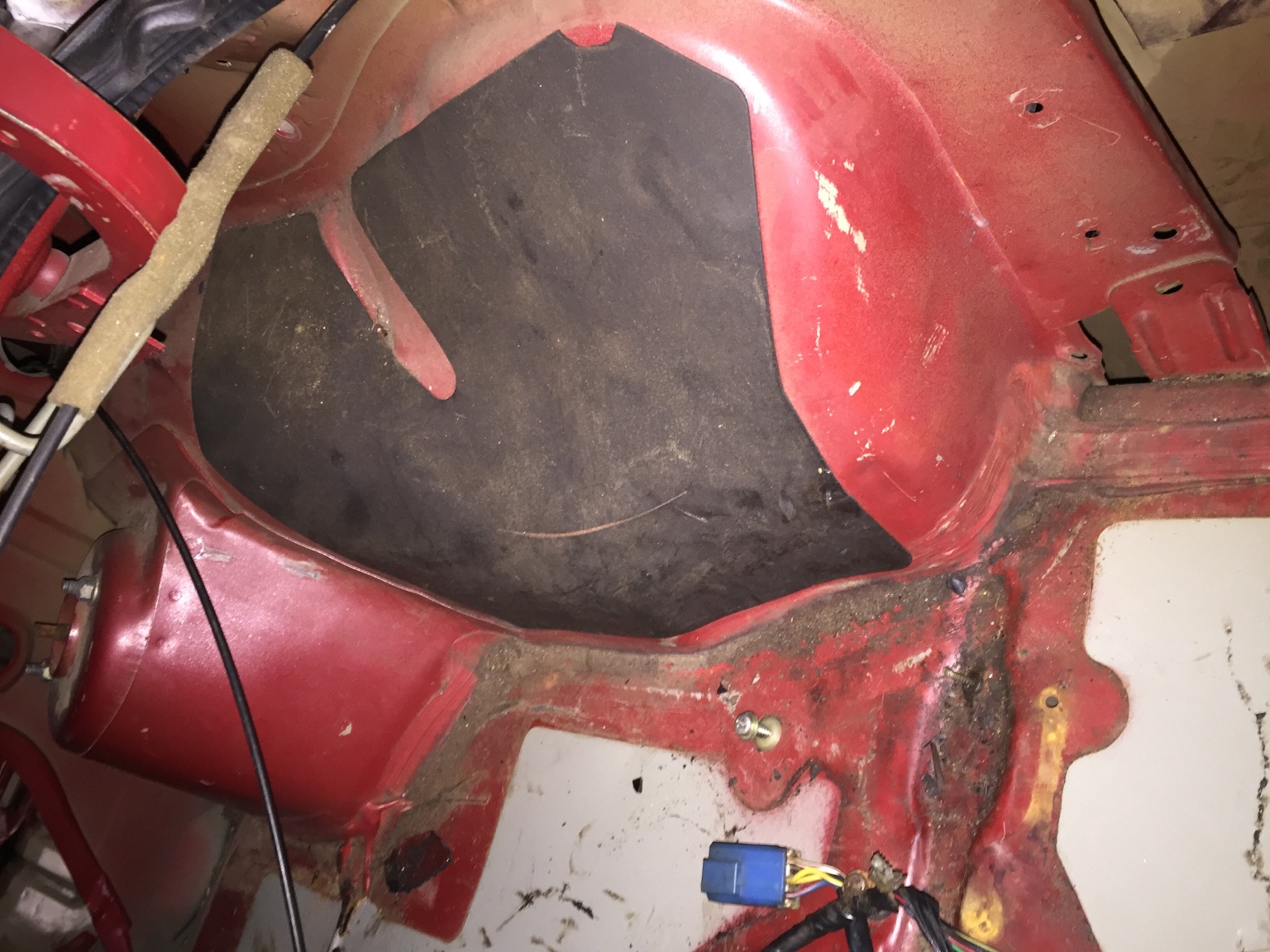

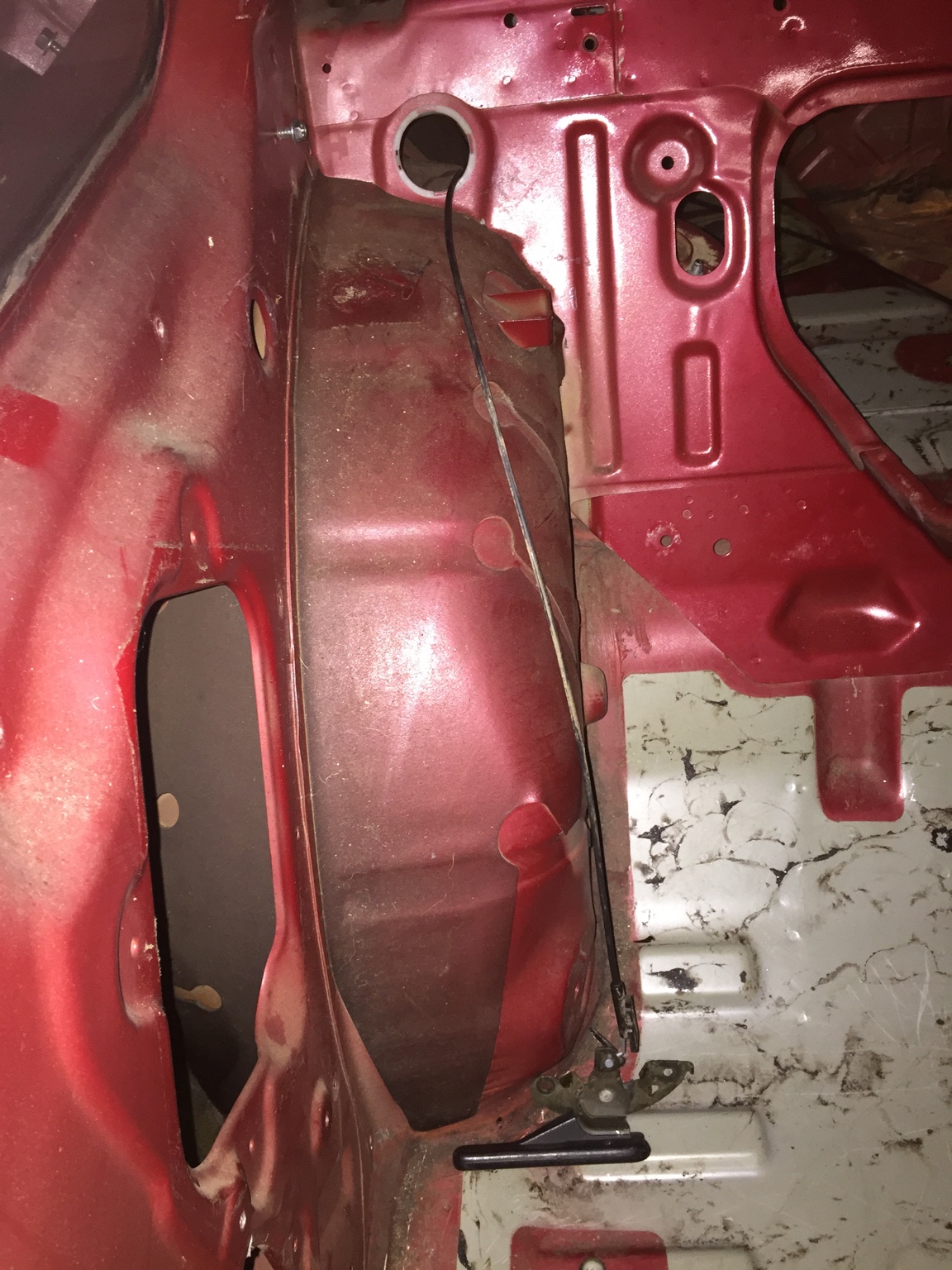

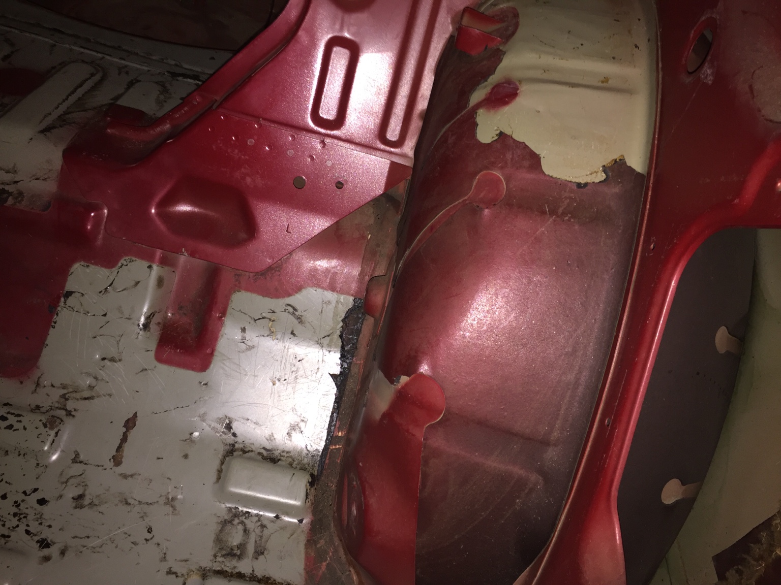

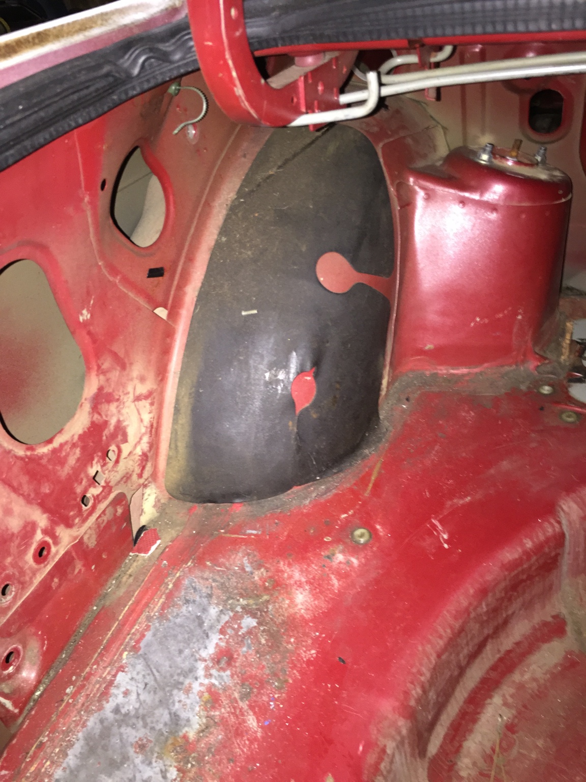

Question for those of you who have removed your sound deadening with dry ice; how did you guys get the rear sound deadening on the wheel arches? Could use some tips on that, that's the last of the deadening I need to remove. Here's some pics for reference. Thanks in advance!

Heat gun and a putty knife

Dry ice in a block form...
bag it and then break it down to pellets or chunks with a hammer... prop that bag on to any non flat surfaces

You don't absolutely NEED dry ice, just makes it easier. Grab a beefy flat head/cold chisel and a hammer and just go to town. Have fun! Hahah
