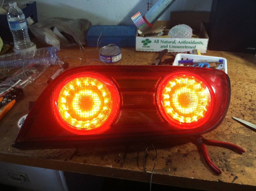

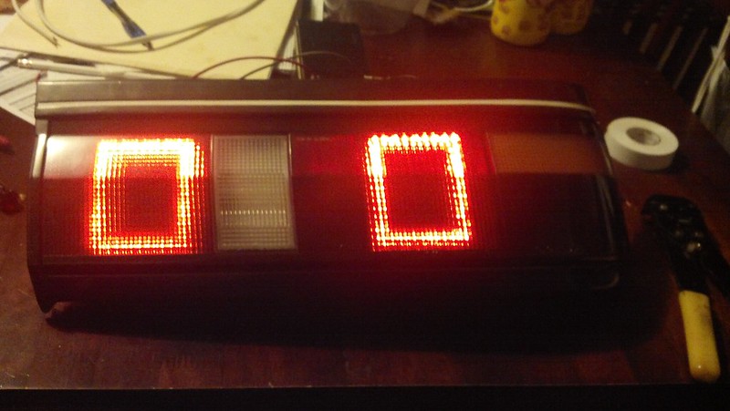

figured I share a few projects that I've been working on for some friends and customers.

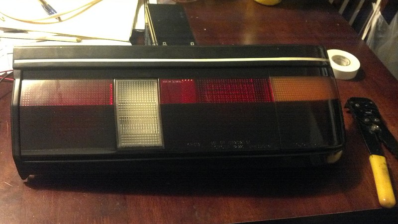

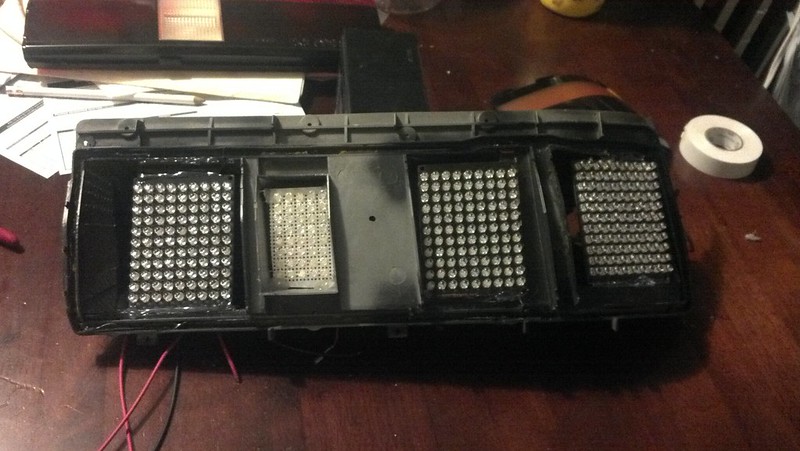

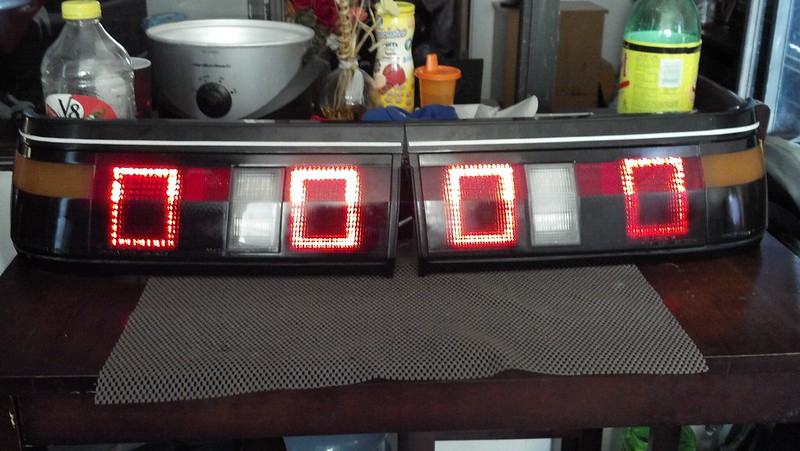

Currently have these underway.
size reference
also just finished these for a customer
SOLO8 parts

it's quite similar to playing the game when making the boards.

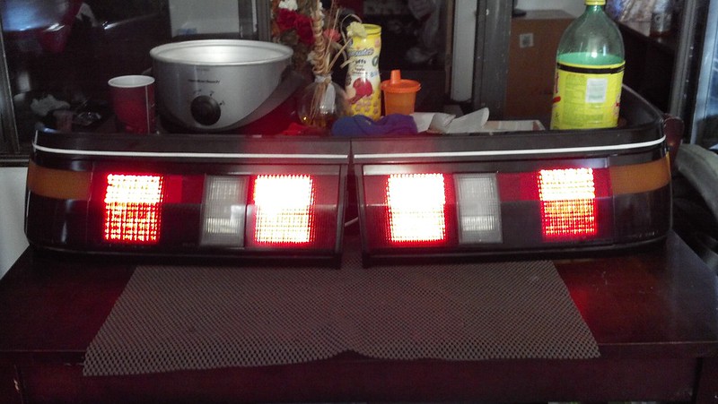

Here's an update with some s13 related content.
Completed these the other day for a customer in Hawaii.
Then finished these up recently as well for teddys13 and installed the LEDs personally. I was already planning a trip to go down anyways, so it couldn't have worked out any better.
apparently the stars are too bright. so I'll dim the LEDs a bit when I head back sometime in July.
but I think it's safe to say these are the first "japan style" s-chassis LED taillights in socal?
: DD

what do you use for the board it doesn't look like pcb or perforated board
you use white leds for everything right
also how are you getting the dual brightness function pwm? or resistors

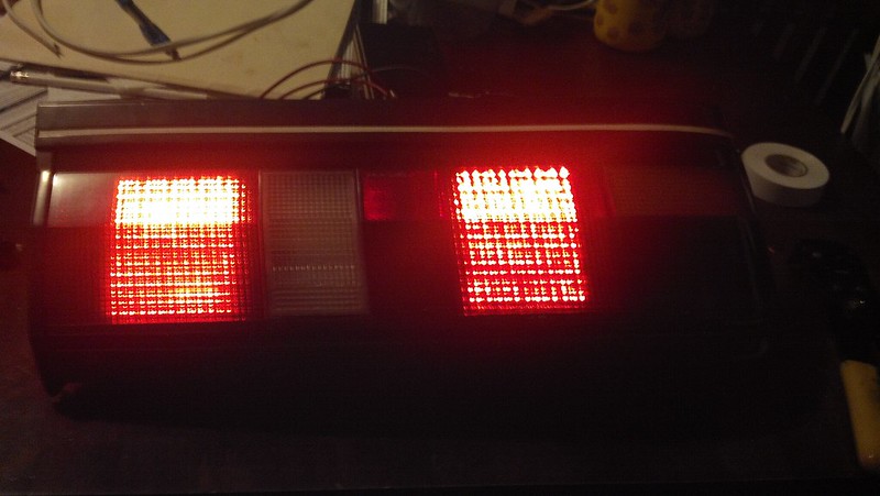

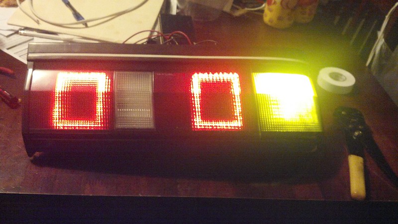

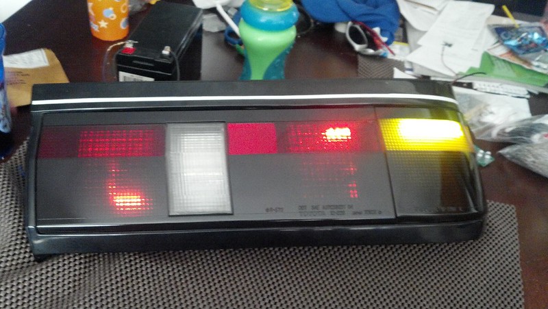

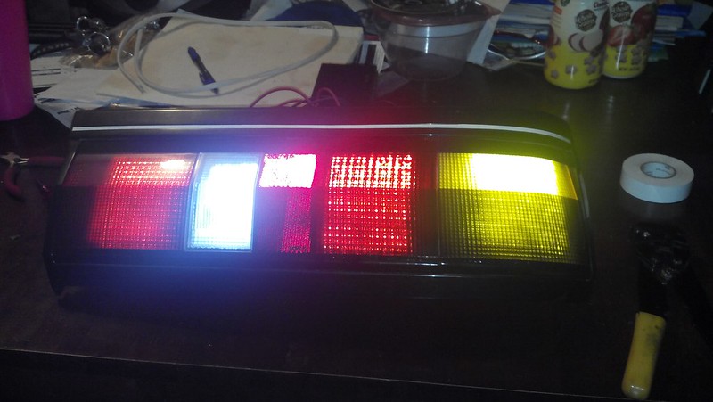

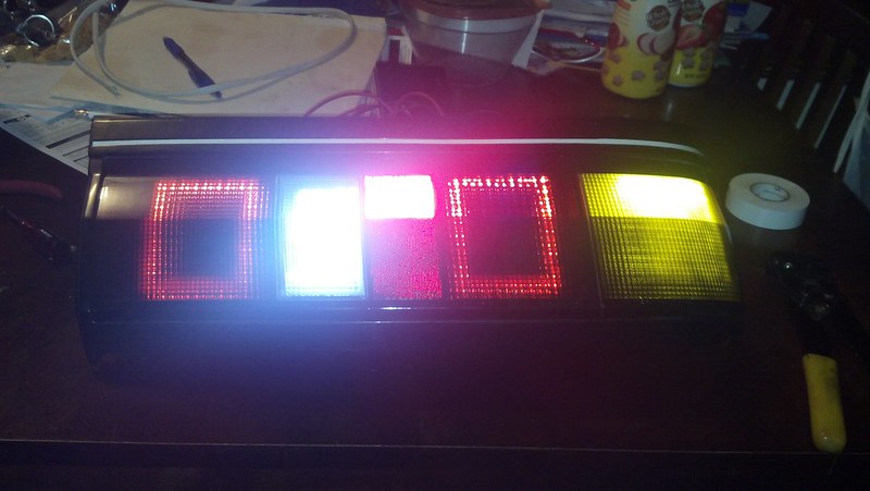

ok so im having issues with my lights, this is my first attempt at this and its not working right. when i connect them to a batterie direct they work fine, but when i hook them up to the car the dont light up right.
ok so this was my first attempt at retro fitting led's to my tail lights, so im not very knolegable to this, but i can tell you all the info i do know. im using 20000 mcd led's with 470 ohm 1/4 watt resistors. each board of my tail lights and signal have 99 led's. tails have about 16 rows of leds in series of 4 with 470 resistors after the positive leads, which are all tied in with a power wire running to it.
its like the power coming from the stock harness isnt enough. im not having any issues with the reverse light or the running lights which are the outer ring of each brake light. i was able get the same effect when i added a resistor after the batterie, looks like this when its in the car.
what size resistors are you using? hopfully an led expert will see this soon and shed some light on the situation. i do appreciate your input though, because i cant find any usefull info in the net in regaurds to my issue.
and here is how they look when connected direct to a batterie.
didnt come out exactly how i wanted with the tint
driving lights
brake lights
all on
all on with driving lights only
driving lights with signal
any help will be greatly appreciated.....

Check voltage out tail outlet. It probably flutctuates.
Car Off 12v-ish maybe even high 11v.
Car running 12-14.7v
Your statements don't make sense.
I assume these led's are the "Suberbrights".
Which checking ebay means 3.2v min 3.4v max voltage need.
assume 3.3x4 = 13.2v
This means you need that voltage to get them to light up without a resistor.
4 led's in series with a forward voltage of 3.3v(@ 20ma) and a 470 resistor means you need a minimum input voltage of 22v to overcome the 470ohm resistor. Are you sure you didn't mean 47 ohms?
This website will help you figure out led needs.
LED series parallel array wizard
I'm using voltage regulators to clean up the input voltage. I run series led's around 9.8v.
I also use Superflux LED's which run a lower voltage, last longer, and have a higher ma threshhold(can run up to 70ma).
Here's a pic of my setup.
4 superflux led's in series with a 15ohm resistor at the end of each. Running vregs around 9.8v

thank you sir for your input and help. the resistors are 470 ohm like these ( 1000 Resistors 470 Ohm for 12v led 1/4W 5% Carbon Film | eBay ) so what advice can you give me to achieve the correct voltage put of the factory harness?
