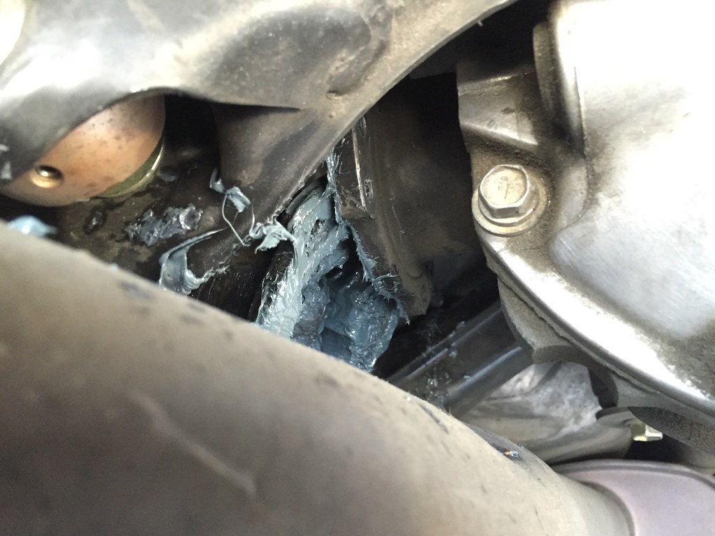

Damn I am running those shitty maverick motorsports adapters. Kept breaking axles in the rear since I am running the pbm drop knuckle and rlca combo. Ran oem axles with gktech axle spacers which did not work. Figured I needed some longer axles and some with the better Rzeppa design so I went with the 350z axles + maverick motorsports adapters. I have not put too many miles on this setup so I can really give much feedback but for the few times I have driven/drifted on them they seemed to hold up okay. Only time will tell I guess.
Blew out a brand new oreilly reman axle with gktech 15mm spacer after 100 miles and some drifting. My ride height + 18x12.5 wheels dont help either..
