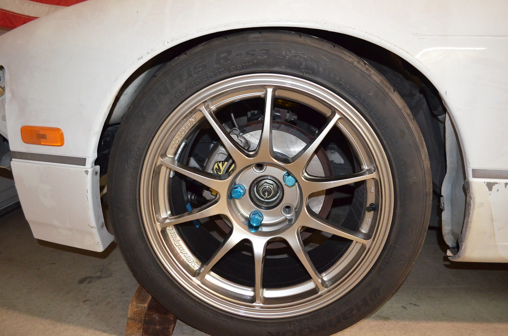

Brought the car home this week to do some mechanical work and get the ride height/alignment dialed in before we start making the body fit the wheels/tires. I'm about a 1/2" too low in the rear, as I want the ride height to be about where the front is currently. After cambering the rear (maybe too much as I'm looking for 2* in the rear) it doesn't look like much work will have to be done. This makes me happy as I am trying to keep the body as stock looking as possible. I am running 17x9 +25 w/ 255/40's and a 5mm spacer up front. I am way to close to the coil and may have to go to an affective offset of +15 in the front.
DSC_0023 by randalllee06, on Flickr DSC_0022 by randalllee06, on Flickr DSC_0018 by randalllee06, on Flickr DSC_0017 by randalllee06, on FlickrI gotta do something about these brakes...... lol DSC_0024 by randalllee06, on Flickr |

Thanks guys. I am currently running the RS-3's on my Evo (DD 100 miles a day with some autox and track days). I've only put 1000 miles on the street and 1 autox, but so far so good. A friend of mine claims he got 30k miles and 10 autox's on a set he had on his FR-S. We shall see. Eventually I'll buy a Wilwood setup (low cost pads, and lots of pads to choose from), or put an AP Racing or Wilwood setup on my evo and throw the Evo's Brembo's on this. I am hesitant to upgrade to big brakes with stock power due to the added weight. With the current pad/rotor combination it should be perfect for autox, as I wont be getting too much heat into them, but will lack on open track with lots of hard braking lap after lap. I will be running some ducting and try to use the stock brakes as long as possible. |

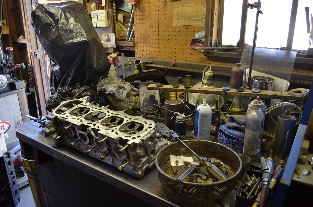

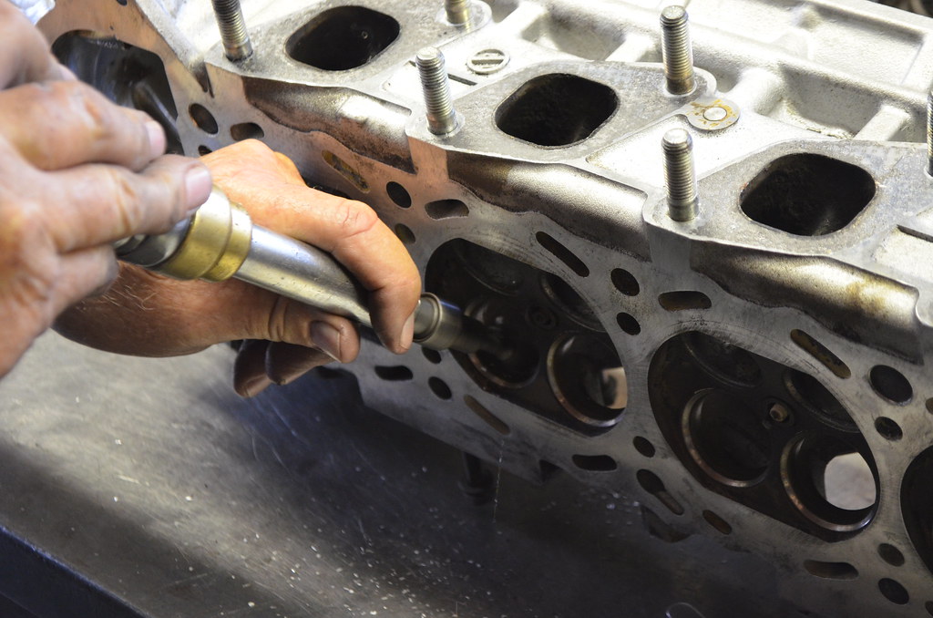

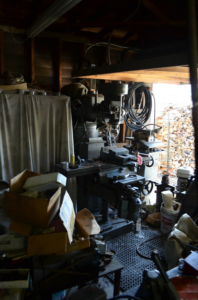

One of my main goals with this project has been to do as much as I can personally, and it has turned into an amazing learning experience.

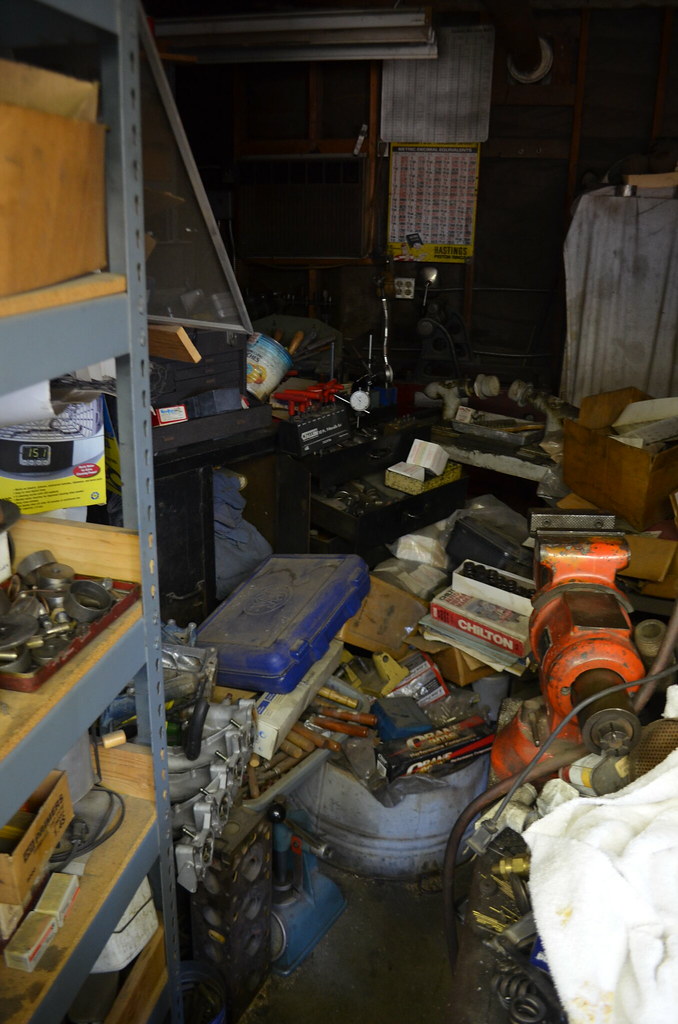

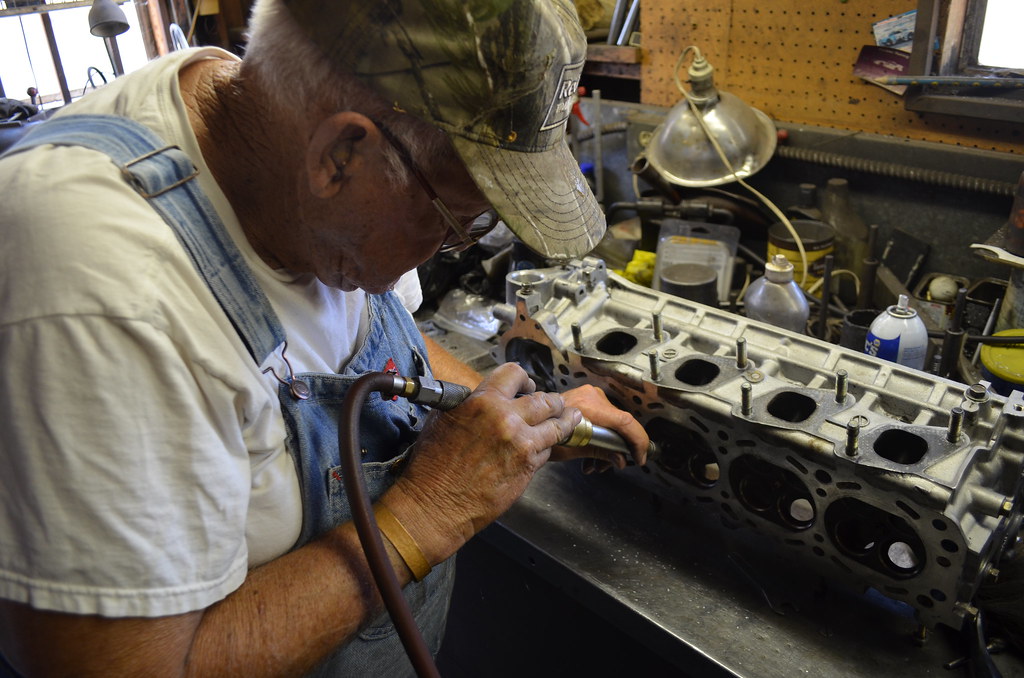

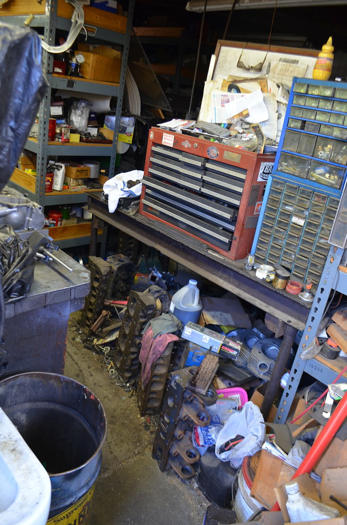

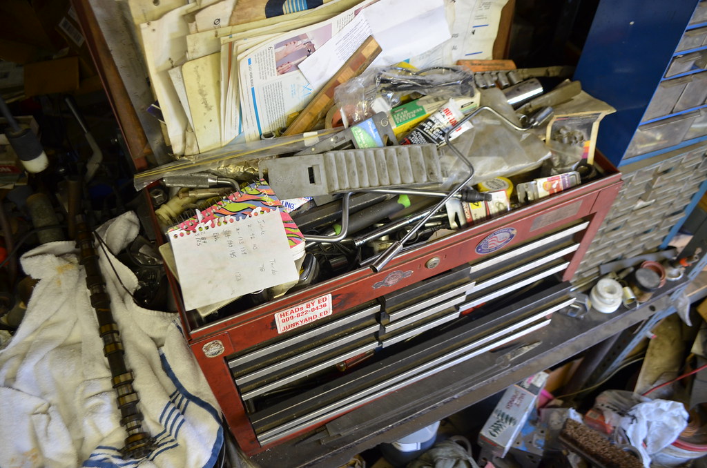

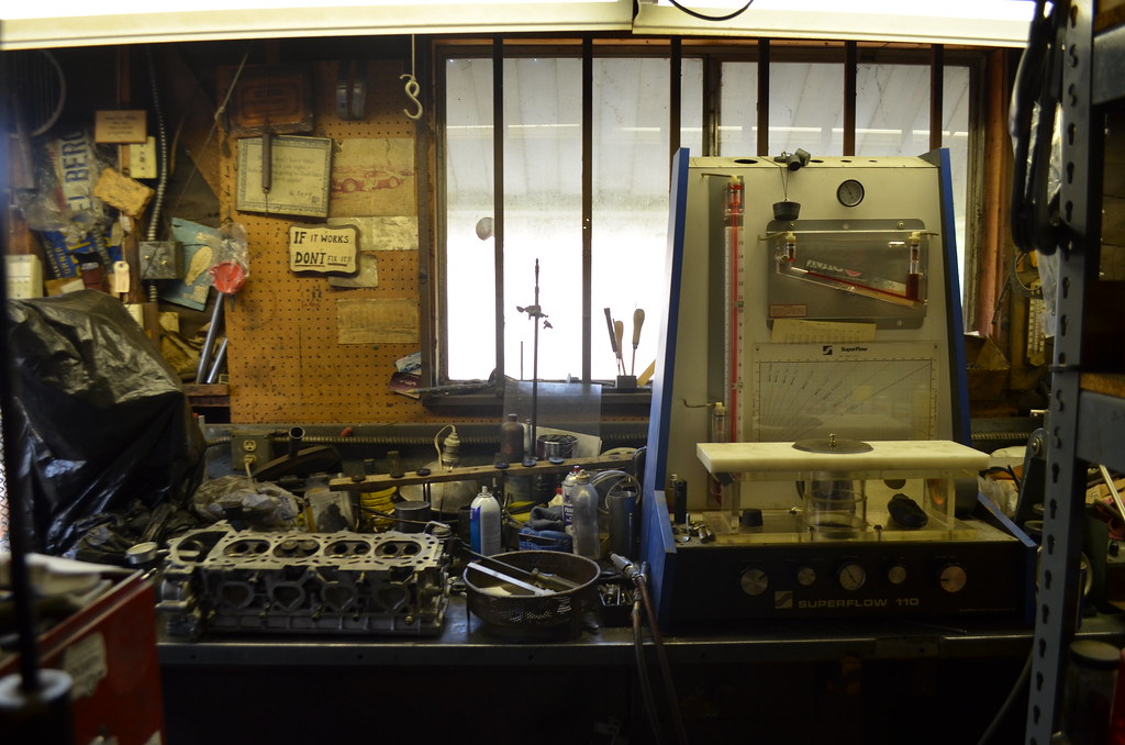

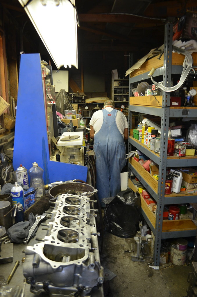

I was looking for someone to do some portwork, and a friend introduced me to an older gentleman who has been building heads for ~40yrs. After speaking with him a few times I came to the realization that he didn't want to just build my head, he wanted to teach me to do it myself. I'm extremely grateful to be able to learn from someone with so much knowledge! It's disappointing that so much of this knowledge will be gone when he's gone. I wish I could just plug a usb into his brain and download it all!Today we finally got into the actual portwork ![]() I am including some pictures of his shop ( a two car garage with walking room only) because it is filled with all sorts of treasure. Entering the shop. DSC_0058 by randalllee06, on FlickrYou can see he takes things pretty seriously. DSC_0064 by randalllee06, on FlickrHe's back in the corner working on the lathe. DSC_0057 by randalllee06, on FlickrHeads, cams, and valvetrain components everywhere! DSC_0059 by randalllee06, on FlickrHighly organized tool box. He knows exactly where everything is though, no joke. DSC_0060 by randalllee06, on FlickrThe mill DSC_0062 by randalllee06, on FlickrBlack magic happening. DSC_0061 by randalllee06, on Flickr DSC_0056 by randalllee06, on Flickr DSC_0065 by randalllee06, on Flickr DSC_0066 by randalllee06, on Flickr |

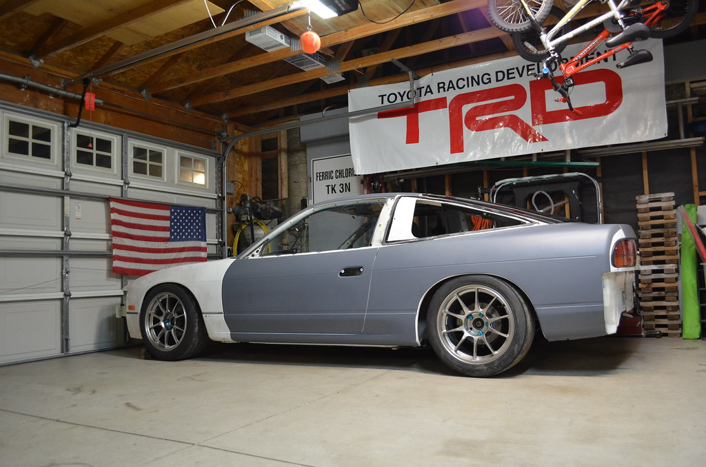

What's up everyone! I've been MIA for a while due to new outlet platforms, new kids, different house, life life life, but I'm back, checking in to let you all know that this build hasn't died!

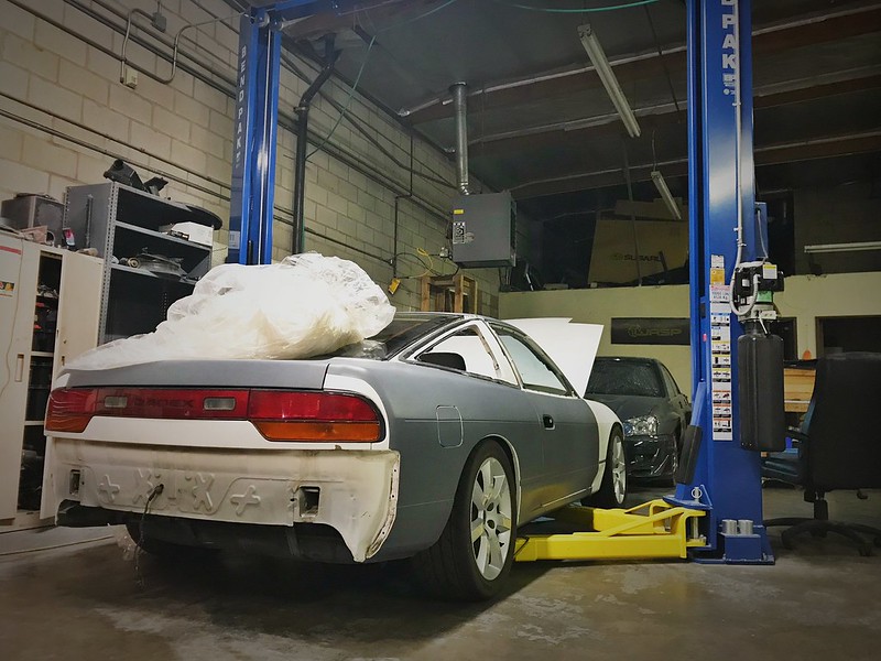

The car hasn't progressed much, mostly sat around and collected dust, but I want to finish her as much today, as the day I purchased her. I have been a little distracted with a track ready Civic sedan (pictured below) I purchased as a seat time car, but am ready to move on full blast with the 240 now. The car has returned to the bodyshop to have the bodywork completed, engine bay, and jambs painted for now. I also sold the TC105's and purchased a set of 350z 17x8 rears. The 255's are a little big for these, so I'll be switching to a set of 235's. Current goal is to "just get it on the road" and enjoy it. As I type this I realize how much I've missed the forums. The other outlets are fun, but there is something satisfying about reading through a build thread. (Reading CamryOnBronze recent blog post's has helped me realize this). Looking forward to hanging out on here again. Anyway, here is the current state of my junk. ![]() Untitled by lees_garage, on Flickr Untitled by lees_garage, on Flickr Untitled by lees_garage, on Flickr Untitled by lees_garage, on Flickr |
