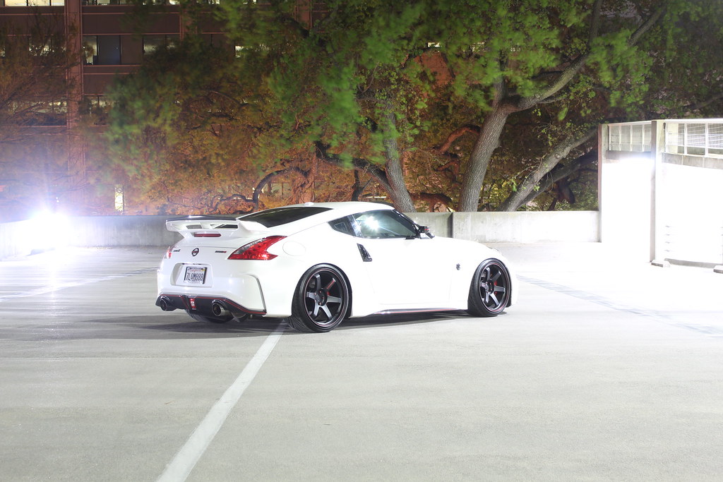

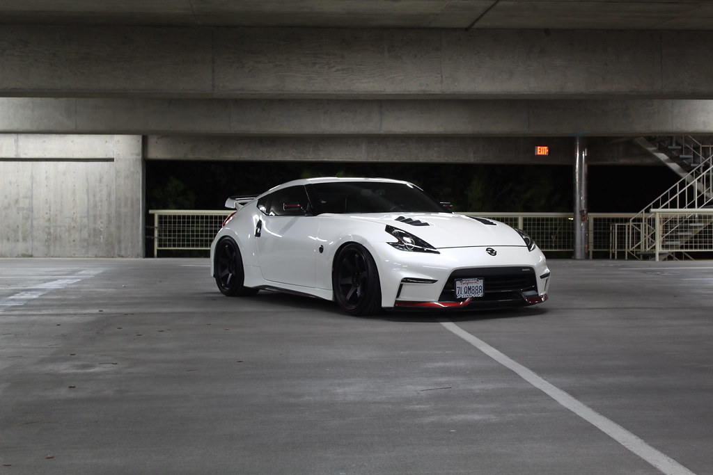

I have no advice for you, but welcome back. I haven’t seen you pop up in awhile.
Always fond of Zilvia, glad it's still going strong but i sold my S14. I loved that car but it was so old and small things kept cropping up.
I bought an IS300 for daily and a 370Z nismo for weekend. the Z is pretty easy to modify and thus far it's been reliable even with bolt ons and full suspension
The interior headspace is the only flaw thus far in whats otherwise been an enjoyable ownership experience
this is me now:
