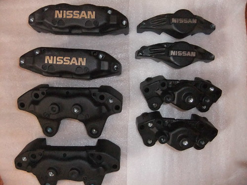

ok so first a story.
I had my 26mm aluminum front calipers powdercoated. Than I rebuilt them with the rebuild kit from PDM. while I was rebuilding them I noticed a bunch of glass bead in the piston cups ( which would lead to that the brake oil lines were not taped or the tape failed during the cleaning process. ) no big deal right ? take the 4 bolts off each caliper, pop out the piston's, and wash them down with compressed air and a lot of brake cleaner. simple plan.
problem. 2 bolts ( the inner 2 of the 4 ) snapped inside on one caliper.
I went to nissan today to get replacement bolts ( I was prepared for dry insertion btw ) and they said that the caliper's are never supposed to be taken apart and now both caliper's are fucked.
any truth to this ? or is there a place or nissan dealership that can help me get the 2 bolts I need to put my caliper back into 1 peice ?
thanks for any help, if theyre fucked theyre fucked just say so.

Nissan is correct in saying they're not supposed to be taken apart... for the most part
the bolts you can buy from anywhere

They're not supposed to be taken apart because they never made replacement o-rings for the fluid passages between the two halves. Z1motorsports has these o-rings for when you want to put the calipers back together.
