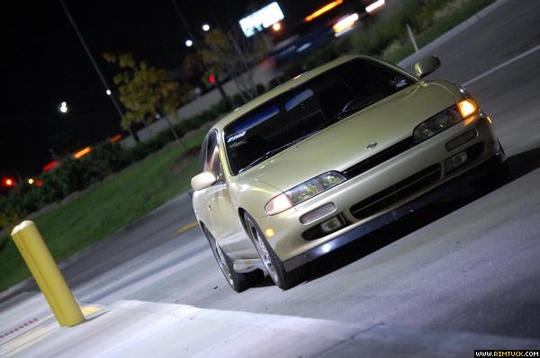

Originally Posted by zooopreme View Post
@hellion240Sx- Go with the 16's and run 205's with the tires please, 15's on a S14 look awkward & they will fit but you will need a roll at least.
This is a 17X8.0 +30...do the math with a 0.
yeah 0 offset = molestation
I have seen pics of an s14 kouki on some xxrs that were 15s I liked the look. But I want to fit some 225 on there. I want the wider footprint. hard to find the pics i saw. I tried. Even googled. This was a loooong time ago mind you :/ I tried looking for something with a higher (gasp I know) offset but I really can't find anything i like.... without spending $1000 on rims alone. I have lost my 240 ways... been dabbling in the miata realm And I know 15x7 won't fit the 225s. All the 15x8s are crazy low offsets. I was at one point okay with rolling fenders, but I have changed my mind. might just throw some tires on the stock mesh 15s :/
