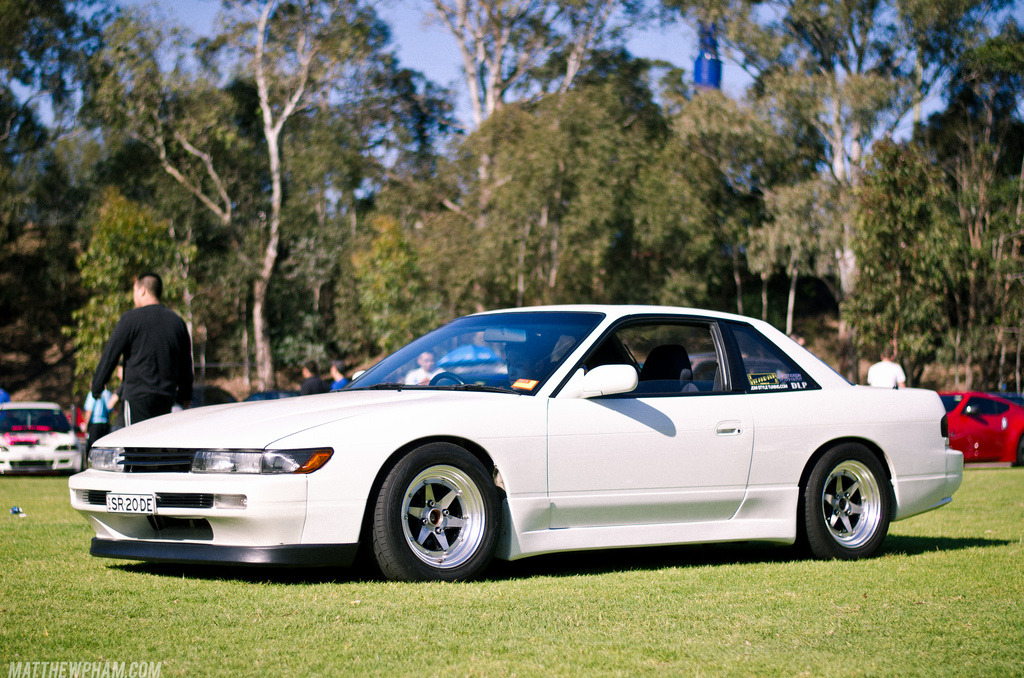

Can anyone tell me the wheel and tire sizes on this car is?
