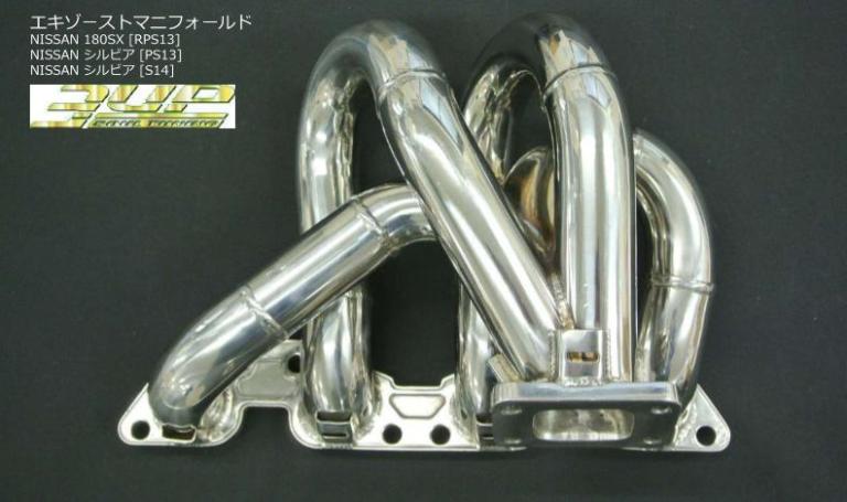

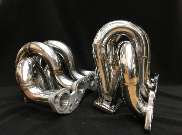

Silk Road x 3UP Collab long runner stock location manifold. I got one a few weeks ago, hopefully it sounds rowdy.
Made with custom 3mm wall thickness, drawn stainless piping. Literally material that can't be bought they have it made specifically for this manifold lol. Compared to rolled 1.5mm piping of other "popular" manifold brands this is going to be much stronger. I'd still make sure you have good mounts, hardware, and a flex section on the downpipe. Beware it does not clear the valve cover "T" on the s13 sr unless you modify it. http://www.e-3up.com/archives/1843 http://silkroad-jp.com/wpblog/2018/07/27/sr20manifold/ ![]() Comparison to the traditional style. ![]() ![]() Last edited by TheRealSy90; 07-24-2020 at 07:16 PM.. |

Yes that is the reason they dont offer for s13 but it does work if you modify the T. If you click around on their blog there are a couple posts that show how they modified it. It is stock turbo location, bottom mount t2. Prices may vary a bit depending on who you source it through, and your shipping method of choice. I dont like waiting so I paid for 2 day DHL shipping. I paid under 50,000yen for the manifold itself before any shipping and broker commission. Quotes vary so Im not going to give my exact cost. Sent from my iPhone using Tapatalk |
