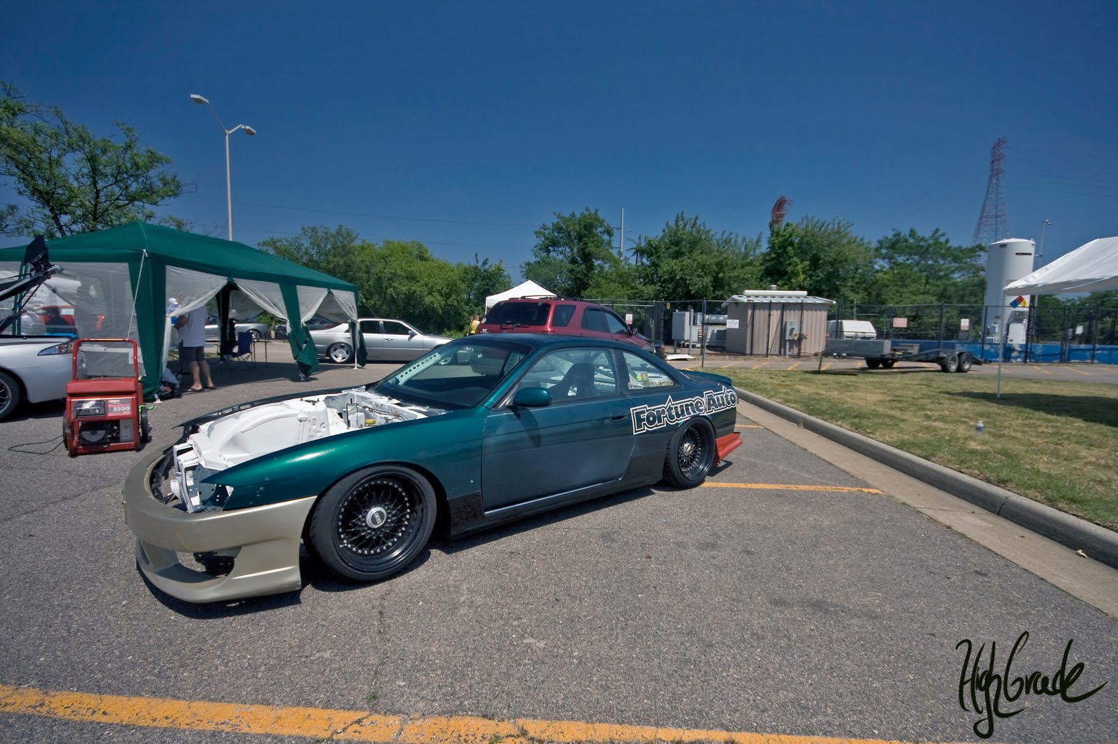

Some pictures other people took of the car at the Sumospeed Spring Meet this past Saturday...I rolled the car up there with the help of my friend and his trailer. My side skirts and rear valances showed up in the mail the day before, so I was excited I could at least kind of see what it'll all look like. I had sold my OEM aero because I was going to run a kit, but I like OEM stuff too much, and the GP Sports bumper flows with it all awesomely.

knoop, whys the cop scratchin his butt in the 2nd pic.
when is the good stuff going to happen @ sage so i can come check it out.
Old 05-18-2010, 10:38 AM   #319
tricky_ab
tricky_ab's Avatar
Okay so I'm not the only one who had noticed this...
