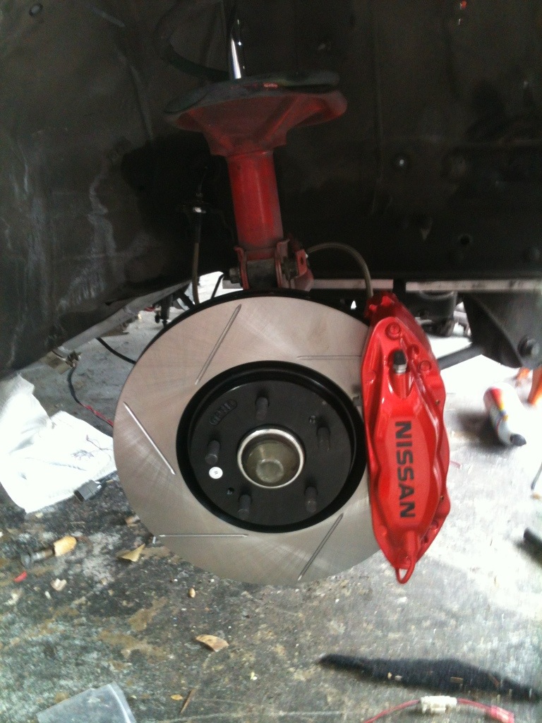

Originally Posted by merijndj View Post
350Z Brembo front brakes on Nissan S13/S14/S15/Z32/R32/R33/R34
Part list:
350Z Brembo front discs, calipers and pads
Z32 conversion brake lines
14mm blacksmith drill (blacksmith drills have a smaller shaft to allow them in normal drills)
4x M14x1.5 bolts, 40mm length, grade 12.9 (but 10.9 is also applicable)
Masking tape
Angled grinder and grinding disc
Bleeder tool or someone to push the pedal for you
Technical information:
Watch the orientation of the anti-squeel plates.
Disc: 324x30mm 9.10kg
Brembo caliper piston: 2x38mm / 2x44mm 4.45kg (3.45kg w/o pads)
Total weight for discs + calipers + pads is 27.1kg.
(Wich is 0.6kg heavier then my Z32 front brake setup - 280x30mm disc and cast iron calipers).
Technical information for the rear 350Z Brembo brakes:
Disc: 322x22mm 8kg
Brembo caliper piston: 2x40mm 2.45kg (1.95kg w/o pads)
<SNIP>

Just bought the set of 2005 V35 Coupe calipers, rotors, and pads for $260 from my local junk yard (Pricey IMO. Was hoping to pay well under $200 until they opened with $390). I chose this for the sake of pedal feel (twin pots vs. 4 pot), rotor size (320mm) and wheel clearance - I like my low disk wheels and care little for pretty calipers. (I care more for rotor size!)
Hoping to install within a month, when I have a free weekend...
Quick deets, will try to get pics up later.
Rotors
Diameter: 320mm
Thickness: 28mm (min: 26mm)
Weight: 21.5lb/ea
Calipers
Twin pot/two piston
Weight: 15.5lb/ea (no pads)
OEM Pads: Hitachi HP66H
As far as I can tell/read, I will only need to worry about the bolt size (14mm on caliper, 12mm on S13 knuckle). I picked up a set of K-craft thread adapters (a whopping $45 - ridiculous!! but seemed better than the alternatives), although I'm not sure they will work until they arrive. Failing those, I am torn between drilling out the knuckles and helicoil-ing (or welding/rethreading) the calipers... Will let you know how this goes.
adey is offline   Reply With Quote

Just FYI - the Kouki CPV35 two-piston (twin pot) caliper and rotor conversion is complete, and was a success. Basically the same modifications had to be done to the knuckle and dust shield as for the Brembo kit, including shortening of the bolts and drilling of the knuckle brake bolt holes.
Note, the 320mm rotors are rather hard to source, but are the same as:
KV36 sedan, Z33 late, V35 late, Y50 Fuga. K-craft make a nice set of slotted versions for about 290USD, which I aim to buy after these OEMs get eaten up.
Enjoy!
