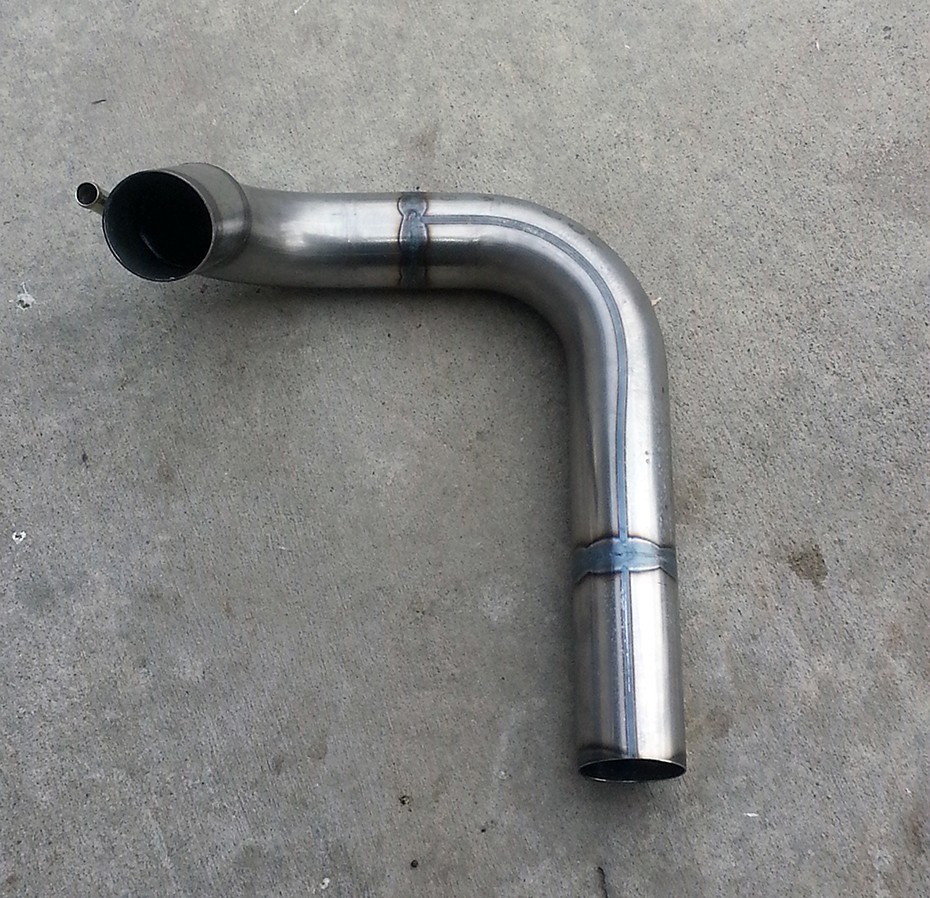

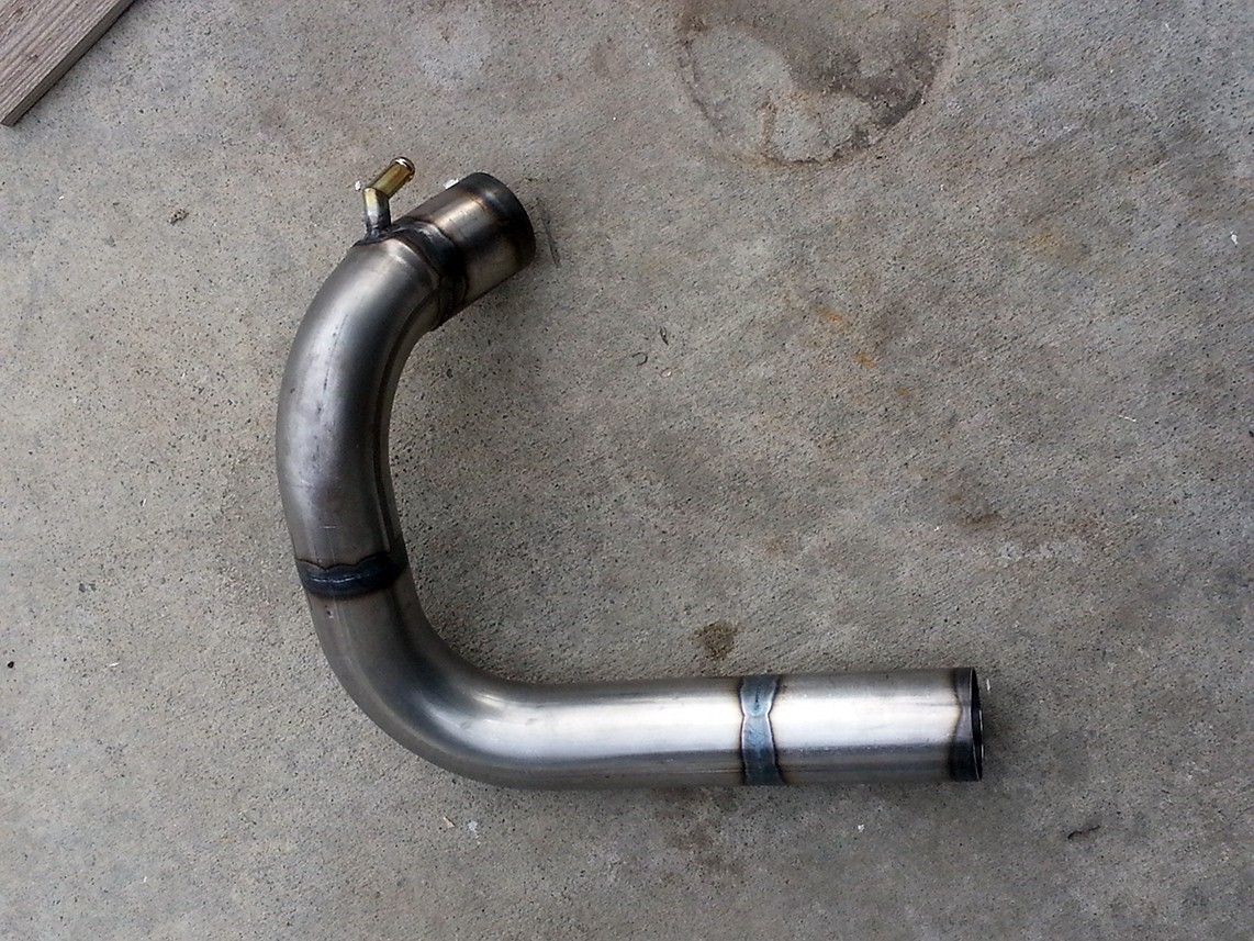

Originally Posted by kouki_mobster View Post
From what I understand for JWT you do not need to retune if you add cams, intake manifold, P&P, or if you change turbos. Thats a plus if you decide to add parts later on. As for Enthalpy, you get a tune to the exact specs. If you change anything, you'll have to get it retuned.
Aside from the idle aspects of them, the same can be said for both ECU's. The joys of a MAF car is that they adapt to many different setups, so long as the car retains the same injectors, timing, compression, and MAF as the tune is setup for.
I love these sleeper setups. We just sent another manifold out today for someone utilizing the Mazworx flange and an SR20 manifold. Slick pieces, just time consuming to make right.z
Edit: Here are pics of one from a while back that we also did an external wastegate setup on. Obviously for sleeper-cell KA-T guys you won't want that, but for those who can be 'sorta' sleeper...it's a nice choice. MVS V band is even more slick

Originally Posted by codyace View Post
Sorry for late response to this, didn't see the updates!
Shoot me a PM for pricing, all situations are different in regard to what they need (coating, if they need external gate, if they are purchasing the flange, etc etc).
Most setups are around 150 dollars though. We charge shop time with this job as to to it right and have it look great requires specific detail rather than just mudding in the two parts as they dont' line up exactly 100%.
could the waste gate flange be welded on the back of the manifold near the firewall or on the side by the strut tower? So the heat shield can stay on.

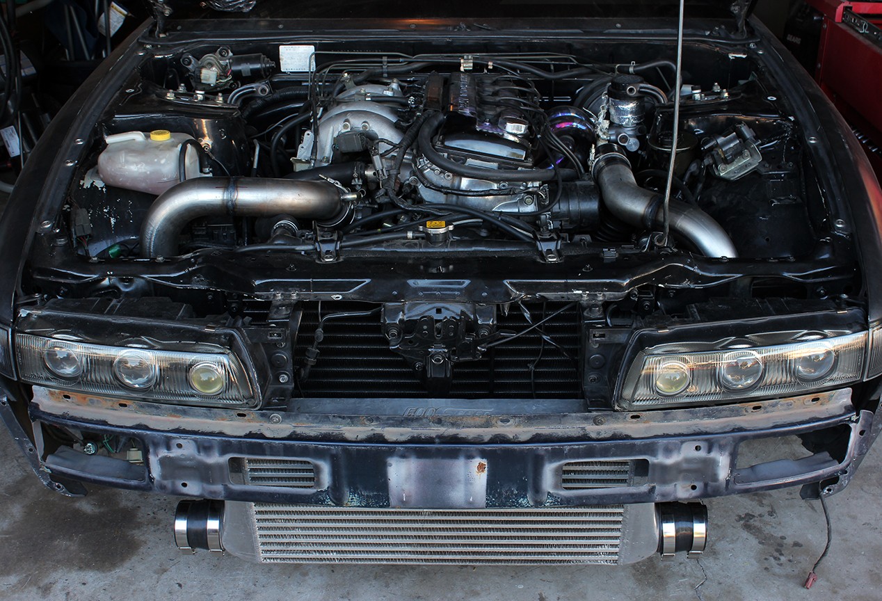

I don't have my S13 KA24DET anymore but I still got love for them! lol
Doing some FMIC and piping work for one of my friends today, its not quite sleeper but its KA-T
