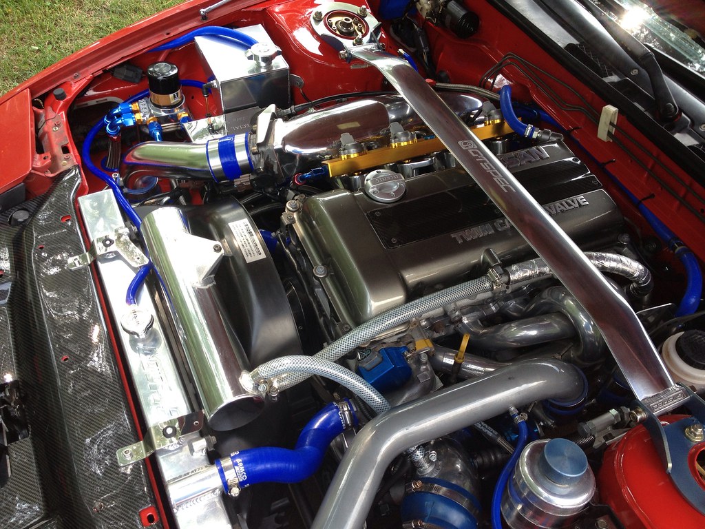

S13 SR? How is your PCV system hooked up? Can you take pictures of your line routing. You can always do an s13.4 valve cover

This is almost exactly how I did it. instead of the hose to the breather it is just a breather. with the opposite side routing back to the crank case.

Second- the S13 SR PCV system by default NEEDS the OEM oil/air separator or an aftermarket air/oil separator to operate properly (little ugly black can between valve cover tee fitting & crankcase drain). If you have the crankcase venting installed without it, the IC basically becomes a giant catch can. This is why the little filter on the front of the tee became soaked with oil (fire hazard btw if it drops onto the exhaust manifold)... and why there was a bunch of oil in your IC (in addition to not seating the rings in the upper rpm range)
The setup om3ga posted is 'okay' but it doesn't ensure that there is always vacuum inside the crankcase/valve cover; essentially robbing himself of performance. He'd be much better off losing that little filter & running a tube from his catch can to the turbine inlet piping... However, if you notice, he did the S13/S14 hybrid valve cover, which is awesome; and the design that Nissan SHOULD have went with for S13's in the first place for this very reason.
On the intake side of the engine, the PCV valve is open at idle/cruise providing the vacuum to the crankcase. Under boost, the PCV valve slams shut- and the turbo provides the vacuum... If there isn't an oil/air separator between the tee and the crankcase; or a catch can between the tee and the turbine inlet- A lot oil will be sucked thru the turbine.
My setup is similar to om3ga's, but ensures there is always vacuum to the crankcase-
Given the physics of what I just explained above, I have to empty out the catch can once in a while because I removed the OEM oil/air separator... But better to empty a catch can than to have to empty an FMIC lol...
Other than reintroducing an oil/air separator, the only way to fix it is to do an S13/S14 hybrid valve cover like om3ga posted (but with tube hooked up to inlet for vacuum under boost), or do like post #144 on page 5 of this thread . Since I have no desire for a slanted valve cover, I bought a brand new valve cover and intend to mod it as shown in the post I cited.
