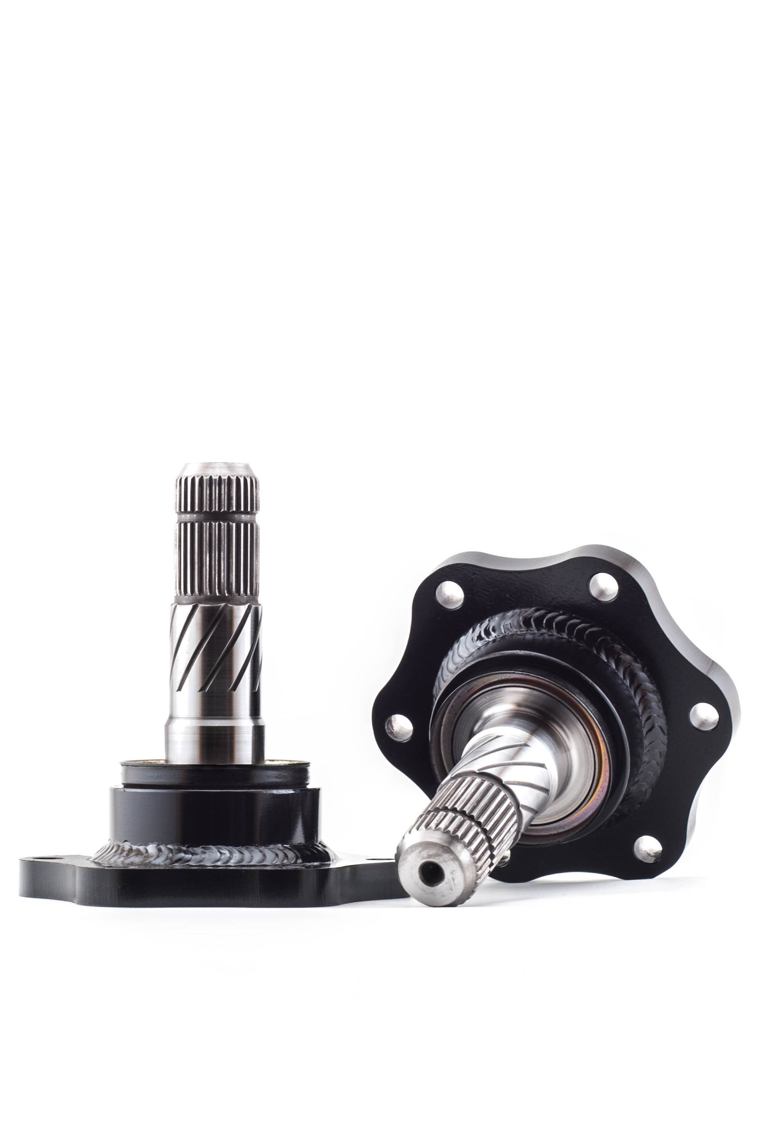

So with this info, if I'm running an S14 subframe at a pretty close to stock ride height with the Maverick dual caliper plates (space the bearings off the uprights 8mm) I shouldn't need the spacers that get sandwiched between the axles and diff stubs? Because I am waiting on them to be back in stock but I'd also like to throw this rear end back together...

Would it be better to just have Villains make you a new set of stubs that are 10-15mm longer by the axle flange? Then you wouldn't need that spacer at the hub spline.

That's what this was supposed to mean, but I didn't articulate very well haha
#281 |
This was essentially why I asked. I'm on the driftworks geomaster rear knuckles and I love the correction on the arms but I'm worried about compatibility issues when running the villains stubs because these knuckles do push the hub out just a bit, like deolio described. I'd like to avoid using the spacers but that may be the way to go unless they'd like to extend the stub a bit, but I'm not sure if that's possible granted they probably have a jig for this - let's see what they say

Z33/34 diff is an R230, so yes, it should be physically stronger. Unfortunately it's up in the air whether or not the output shafts are stronger, as there's not a lot of people making enough power to actually break them.
Z33 axles are definitely stronger and Z34 even more so as they're 30 (IIRC) spline at the hub side. Technically the strongest Nissan diff you can put in your car is a Z32 TT diff (R230) which has 32 spline outputs, and then DSS will modify them with 300M shafts. Not really sure how you'd break that this side of a Formula D car... |

Got it, thank you for clearing that up. I am already at the R200 early Q45 3.54 gearing using the z32TT hubs, one z32TT axle and one q45 axle. I?ve been told to change to a z33 but wanted to see the gains. The ratio is fine for me with the LS/T56 but I?m open to ideas. Especially with Z32TT axles being scarce and pricey. I have one spare ready to go I got here recently but once that one goes I?ll be concerned haha.
