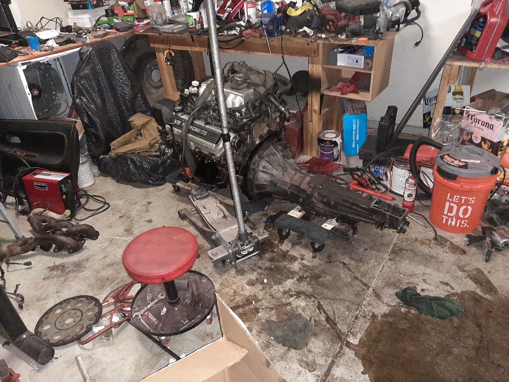

Posts: 58
Mated to the trans and ready to drop into the car.
![]() Sent from my SM-A505U1 using Tapatalk

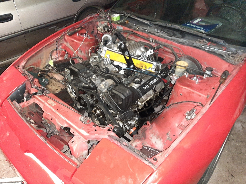

Posts: 46
im still at it, never give up! hard work got in the way and school is done for me for now.
taking the engine out to recheck some things, also to replace the mounts, i got better ones that allow stock trans position, clears exhaust and you can use oem driveshaft. my major worry is when i did the timing belt replacement i replaced the seals, my crank seal is black and ive been seeing the brown ones used on other builds, so i wonder if i used the wrong seal thats what toyota lexas dealership gave me btw. things like that worry me lol |
