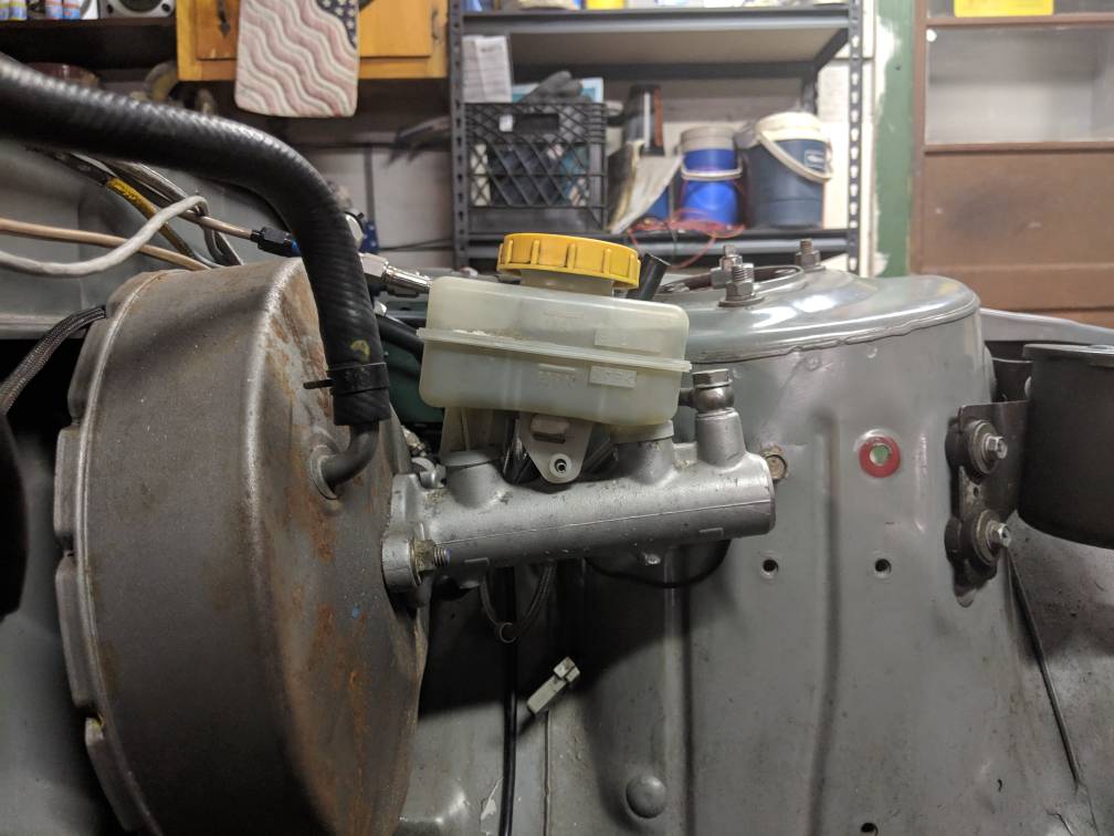

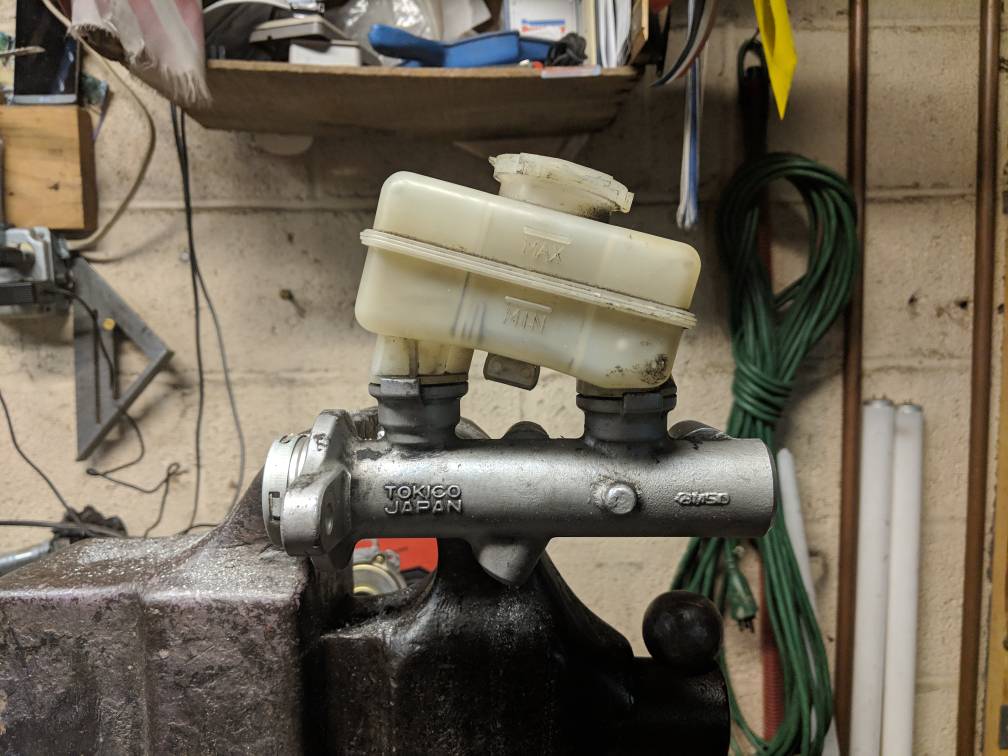

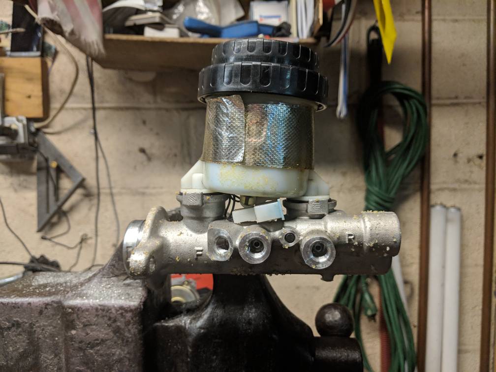

So because these 4-channel systems use EBD - Electronic Brake Distribution cycles solenoids pertaining to the rear circuit in the ABS modulator in closed loop control to proportion the rear circuit, you don't want mechanical proportioning devices in your system at all.
All Nissan BMC's of the S-chassis era that are worth using have built in proportioning valves. Hoping that I could get away with using my Z32 BMC, I removed the internal prop valve and tested to see if rear proportioning would be removed. Surprisingly, nothing changed. I checked this by measuring caliper clamping force, not pressure, with these nifty scales:
Front:
Rear:
Someone in that NRR thread I shared in my previous post ended up using a 2001 Pathfinder BMC that doesn't have internal proportioning. It also has oddball output locations on the top of the MC and the other on the driver side/left side, which is nice for people wanting to keep their lines away from turbo/exhaust heat. The inclination of the reservoir is also greater than the Z32.
2001 pathfinder BMC (pictures from "Scores240" on NRR):
Here's a Z32 BMC for reference to show you the difference in the reservoir inclination:
Because I don't care for the specialized outputs of the pathfinder and want to keep the same sizing as what's in the car now (17/16"), I'm eyeing the Z33 BMC. The inclination on the Z33 looks the same as the pathfinder. BTW, it seems that Nissan has been using 80mm as their standard for BMC hole mounting through at least Z33:
Just eyeing the pictures, the center-center spacing of the reservoir inlet ports looks the same as the Z32. The height offset between the ports also looks the same. I wouldn't be surprised if the Z32 reservoir could just pop right in the Z33/pathfinder. I do like the reservoir and cap better that's on the Z33/pathfinder though. The Z32 always leaks some during races. I just don't like that inclination when mounted in an S.

So, I was about to change out my MC for the Z33 unit, but that is no longer necessary. I hope that keeping the Z32 BMC with the internal prop valve is a decent fail-safe in case the ABS faults as I'll still have proportioning in that case.

I don't know if you've considered it, but theres also a 1" pathfinder master cylinder that has the lines attached to the other side (further away from the engine, less exposure to heat) but obv you'll either have to bend new lines or switch to stainless braided lines

I did not know about that pathfinder one. I just knew about the one that I shared above that has 1 outlet coming out of the top and the other coming out of the left side. It says in the description of that link that it will interfere with the S14 strut tower. I guess it would require some "massaging" to get it to fit on my car. I've decided to stick with the Z32 for the time being out of simplicity. I still have to make new lines for the ABS system no matter what.
