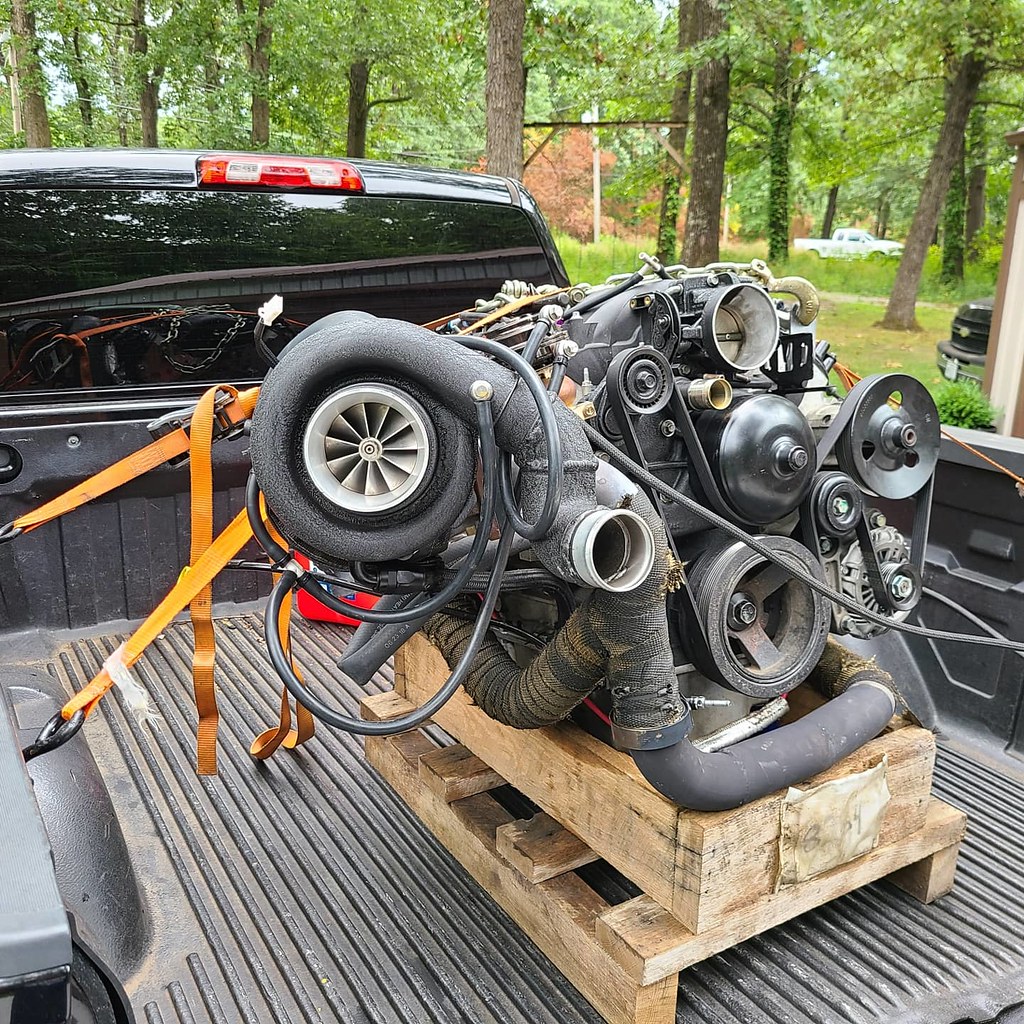

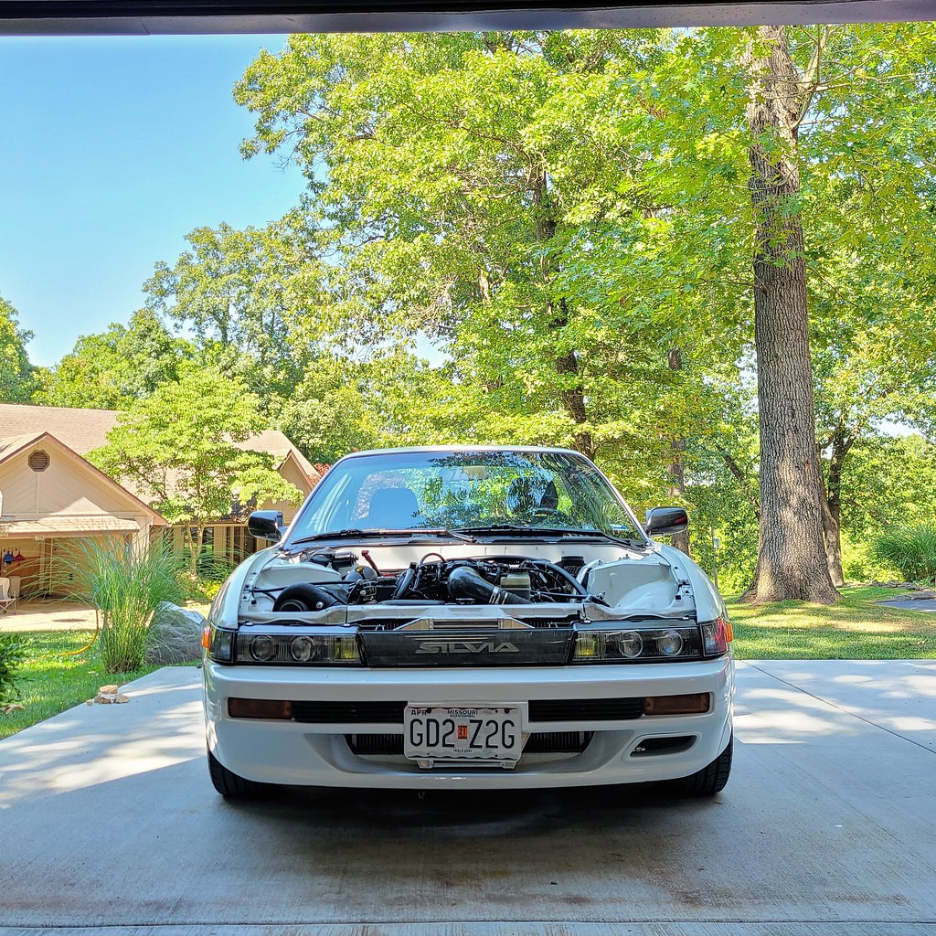

Here's my 91 S13 that I've been working on for many years, it's finally to a point where I can get it out and have fun with it!
Silvia, built 5.3 turbo, 4l80e, [email protected]

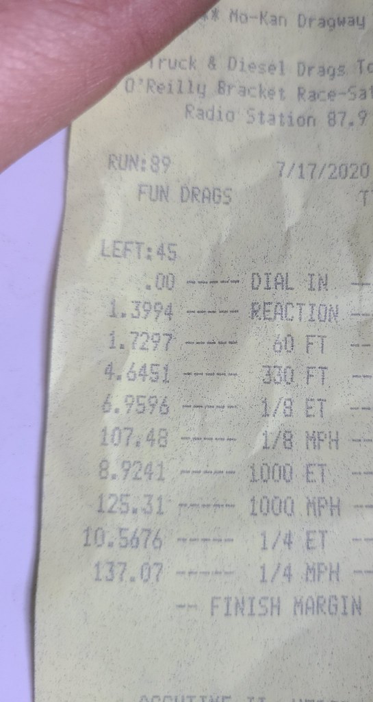

Seems like you have some dialing in to do. What trans?
Trapping 137 you should be in the 10.2/10.3 range.

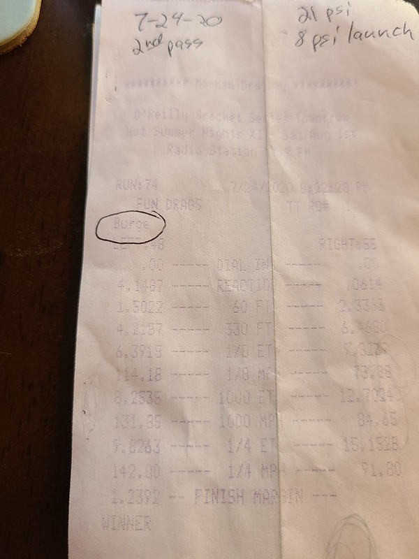

20200725_161635 by Fred Burge, on Flickr
20200928_151503 by Fred Burge, on Flickr

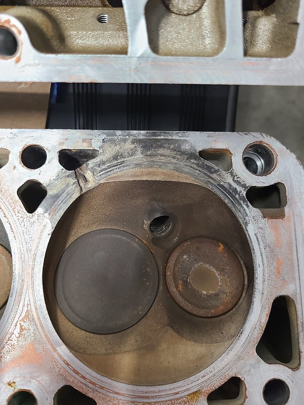

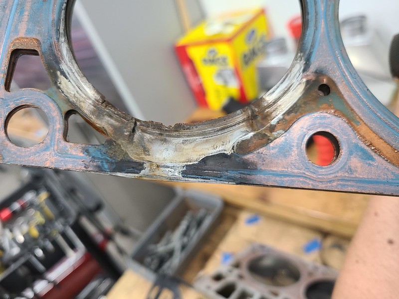

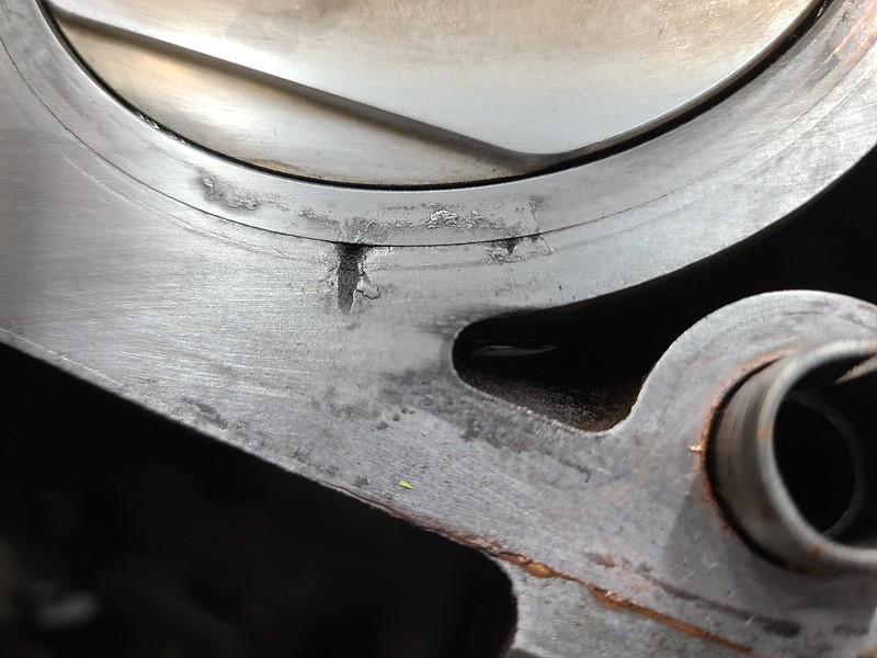

Made some progress at the track! I never even planned to run a 9, planned to run a 10 and that's as far as I figured I'd ever go but man she was running good and boom, [email protected]!
Unfortunately I also lifted a head and torched the gasket and the block and head so I had to tear it all apart to fix that.
20200726_171404 by Fred Burge, on Flickr
20200727_165120 by Fred Burge, on Flickr
20200726_175955 by Fred Burge, on Flickr
But now it's on head studs and LS9 oem gaskets and all back together. I also got told by track officials not to come back without a full cage so that really cut my racing season short lol. Now I gotta put a game plan together for a cage...but first I want some good street driving before it gets too cold for the year!
Built 4l80e with Circle D 3200rpm stall converter

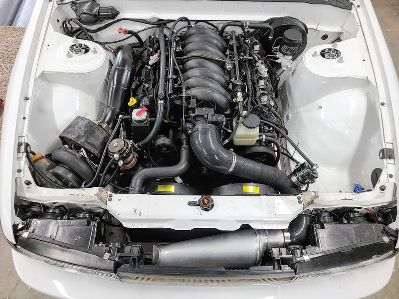

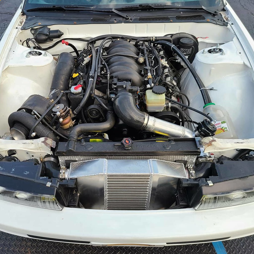

Current pic with new intercooler set up. Thinking about building a 1 piece cooling panel to cover up that whole area. Also after disassembling and painting my alternator it now won't charge doh! Guess I painted some areas that need to be grounded?
IMG_20200927_155635_988 by Fred Burge, on Flickr

So, pulled alternator, stripped all paint off of all points that contact the block or the bracket, reassembled and still no charge. Had it tested at Autozone and it was just bad for who knows what reason. So warranty got me a new one and now that's all behind me.
But then...
The rear mains seal started puking VR1 all over the ground every time I fired her up - doh!
So Sunday I pulled the trans and replaced the seal and all's good again. 5 hours flat to pull trans, fix seal, eat lunch and reassemble everything - decent
Now it's finally time again to go to Mexico and log some hard pulls to see if my dual Walbro 450 fuel pump set up is working. Also to log IATs and see if this Bell Intercooler core is working. I had them spec it for 800hp at 20psi on a V8 but it's tiny - 16x8x3.5". Seems way too small but I spoke to the engineer guy there twice and he assured me that's the right size fore the job. I do need to build some ducting for it also so that it has the best chance possible of working so that's probably next up.
