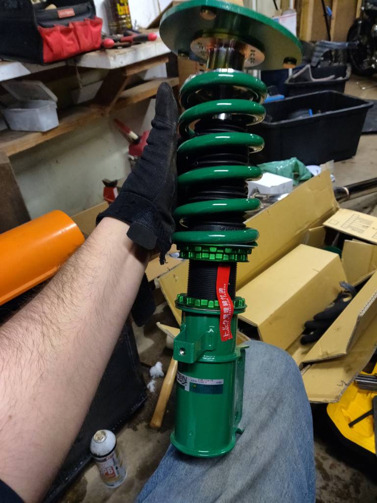

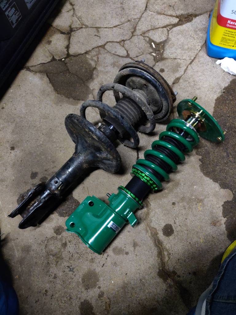

Postman got a work out.
![]() ![]() Yeah garage is filthy, haven't used this one in 5 years. Tein Flex Z are certainly not saving me any weight. I think they are heavier then thr stock setup. Build quality is sharp. Hopefully they ride nice. ![]() ![]() Also, free gift!! I just noticed I have aftermarket SMIC. Derpa Derrrrp ![]() ![]() Sent from my ONEPLUS A6013 using Tapatalk |

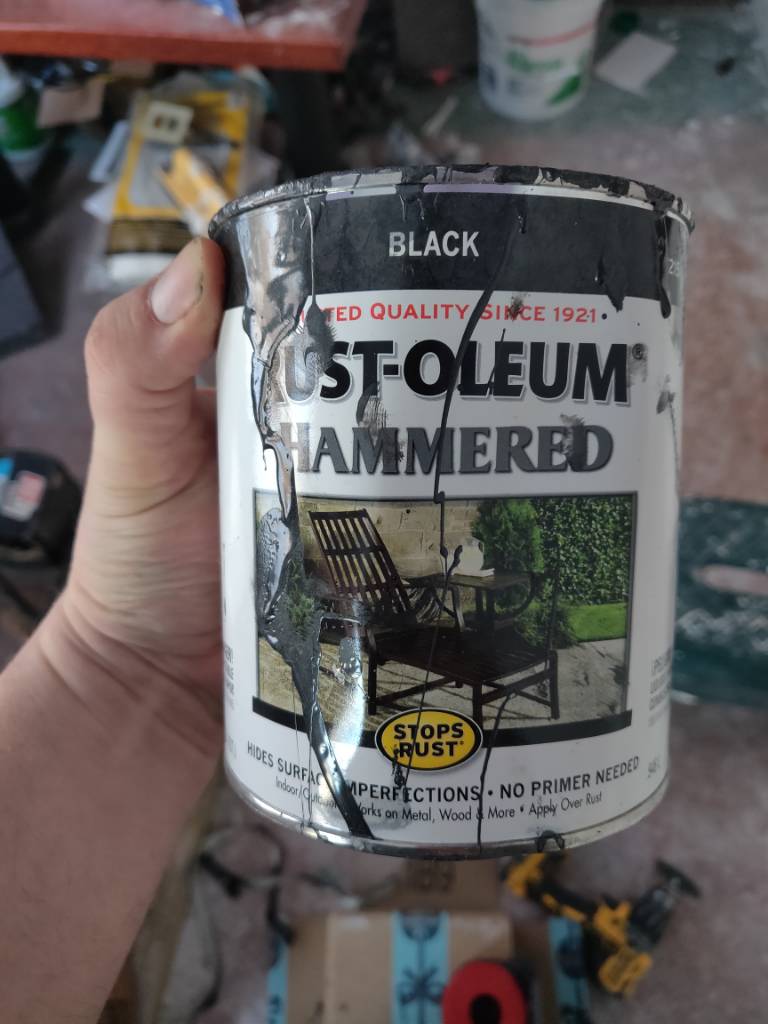

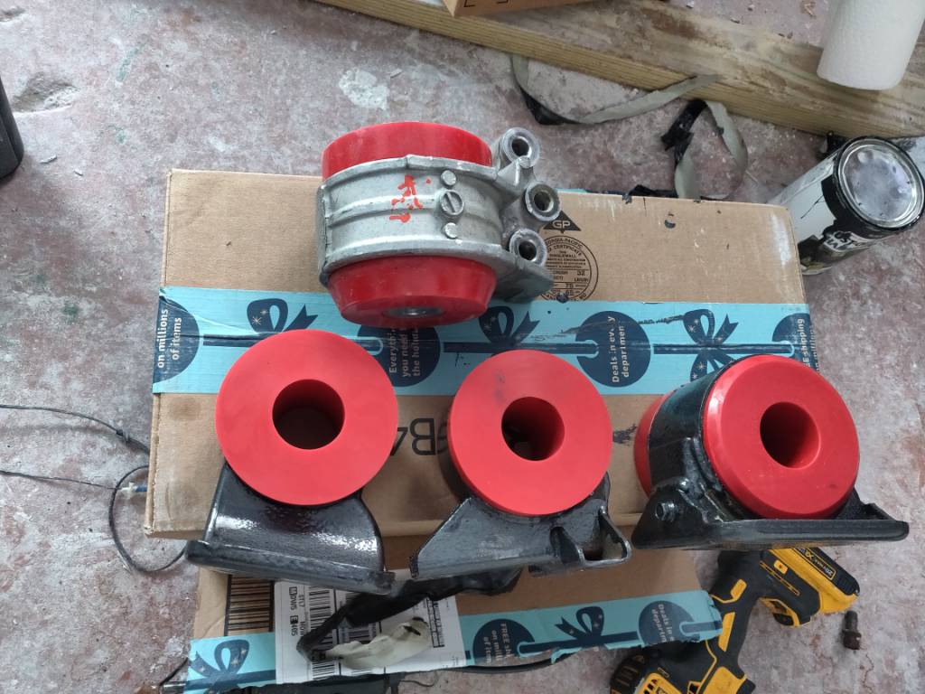

Circling back. Mounts are pressed in. I just left them outside for a few days (~10 degrees) I then used a dremil to grind one edge of the mount to a round smooth surface and cleaned them good. Applied lithium grease to the inside and lip of the mount. Then placed the bushing on it, stepped on the bushing and "pop".
Easy. Also cleaned up some rust and used. My favorite chassis paint. Rustoleom Hammer Coat brush on. It's cheap, locally available and sticks to anything. You can apply it inside like today, since it's not a spray. It will dry even in cooler Temps (~65) but it does take a long time to dry. Great for diff housings and other items that you want to clean up but don't want to sand blast and what not. ![]() ![]() Sent from my ONEPLUS A6013 using Tapatalk |

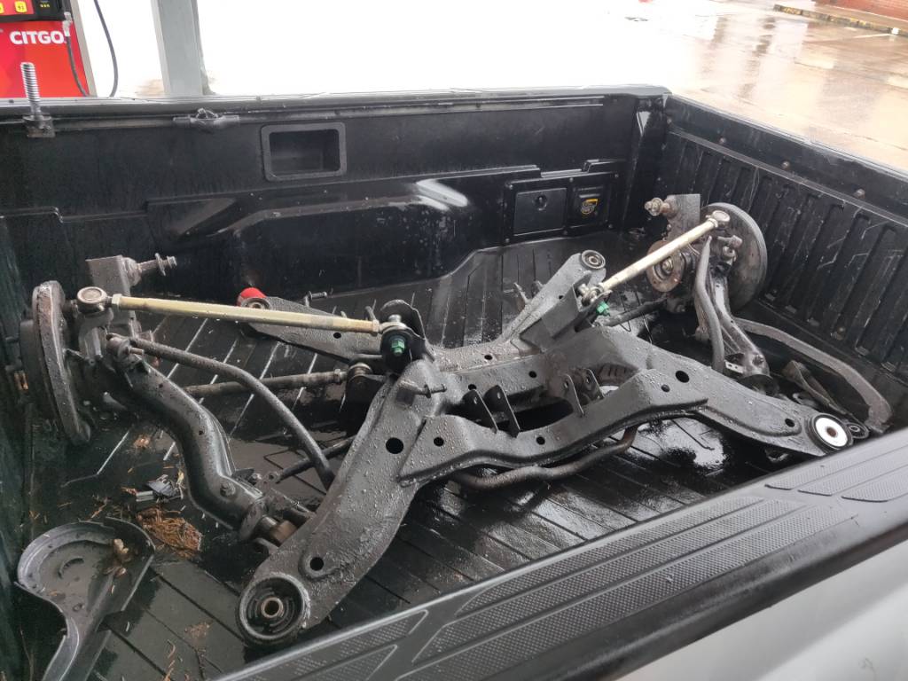

Spent a few hours messing with wiring. Picked up a subframe with custom arms last week. Save me some money and time.
![]() Got the flywheel cleaned up. Really only thing I Need now is some hub bolts. |

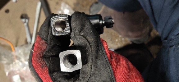

Tie Rod end, Taiwan and I'm guessing China. The Chinese unit is greasable, but the stud is significantly smaller. Rubber boot is also trash.
Ended up going with the seal end links. Paint and machine work also look better. Taiwan top, China bottom ![]() Chinese nut and stud are smaller. Sent from my ONEPLUS A6013 using Tapatalk Last edited by Corbic; 01-03-2020 at 08:34 AM.. |
