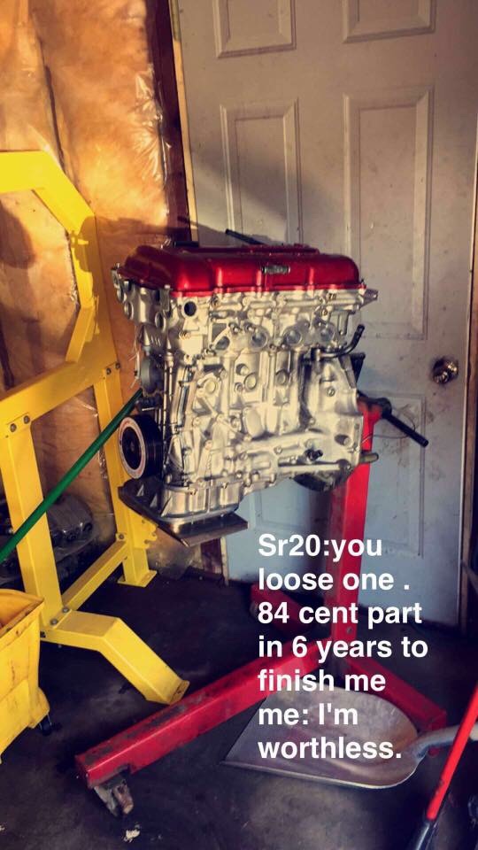

Alright I've got an issue finally got the bottom end built top ends on everything going awesome
Till I wanna put the cam in and I'm missing a valve shim. I'm running a tomei pon cam been thinking about running dual guides but didn't have the cash...well now I might as well sense one of them ran away...my question to you is what sizes should I order?? Also running hydro lifters
