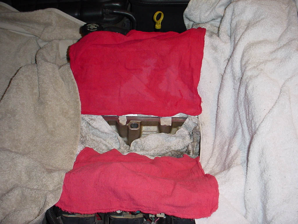

Start of by removing the old LS1 PCV system, I forgot to take pics of this stage, just thought it was straight forward enough. Next prep your area for cutting. Make sure you cover everything you can, use towels, blue painter tape every thing so no shavings get in the engine.
Here is a better pic of the prep area taken from LS1Howto.com

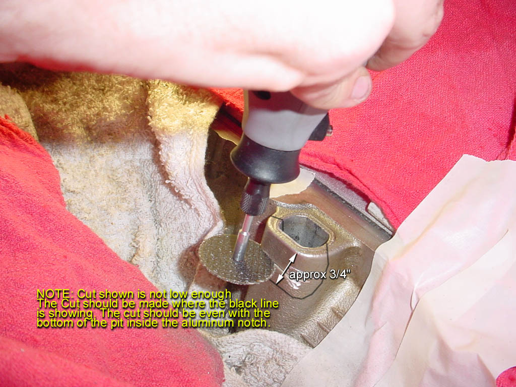

This is the piece that we are going to trim down. We need to chop the wall off this block all the way down so that its even with the bottom of the pit. It may help for you to mark a line on the aluminum about 3/4" down so you know where to cut
Here is a better pic of the target area, pic taken once again from LS1howto.com
Okay cut made. I just used my high power electric cutting wheel to cut this off.
Another pic of the cut
Once you done cutting the piece off make sure you clean the area very well before installing the new LS6 PCV system. The new unit should just drop right into place. Torque all 10 bolts to 18 lb/ft. Next, hand thread in both knock sensors until they bottom out. Torque these to 11 lb/ft. Reconnect both wiring plugs, and slide the plastic connectors back in place.
Now there is more to the install but I have no need for it since I am going to route my PCV system to a Catch can later.
So there you have it nice and quick and easy..
