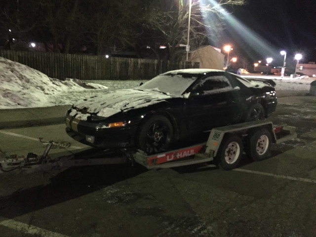

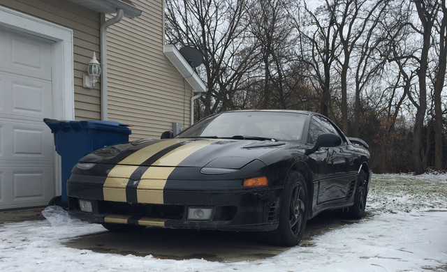

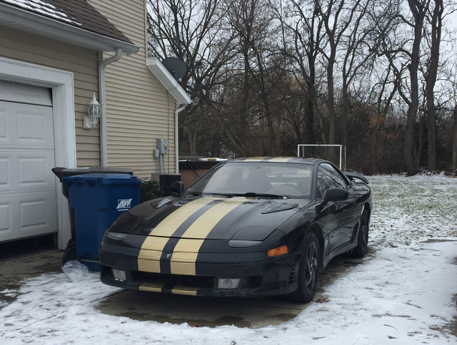

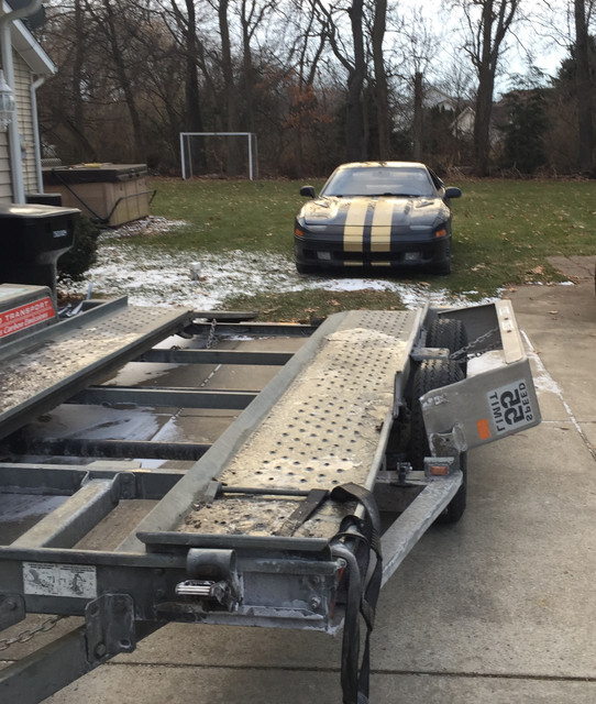

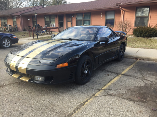

As it sat.

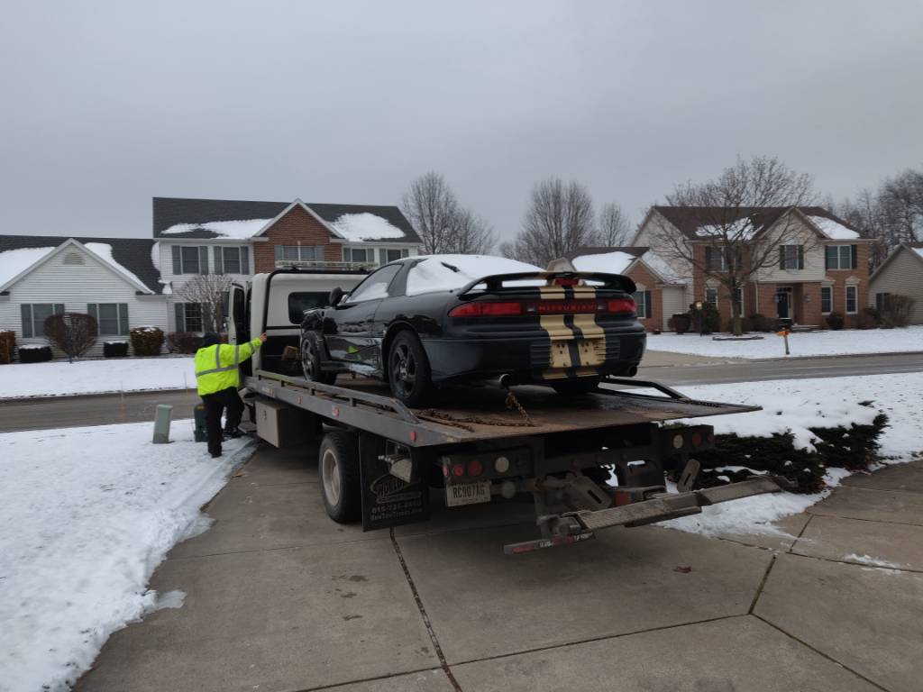

Sadly the next day it was a snow storm when I returned to claim my prize, and while trying to load the trailer, the motor locked up. Thankfully a few brutes in the apartment complex helped shove the 4,000lb Siberian Whale up on the trailer. сука блять
Once home, I had to shove it off the trailer - exciting. It did not roll back as far as I had feared.
SIX GEE SEVEN TWO NO SHIT!
Duke and I already imaging tearing up the summer nights in our new Poorari.

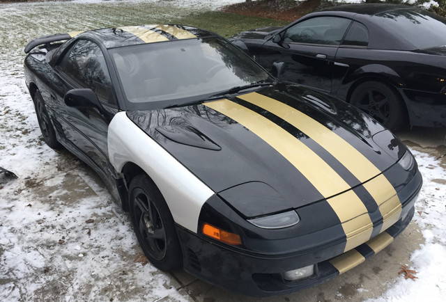

Even with the awful race stripes and DSM Eagle wheels it's not a bad looker.

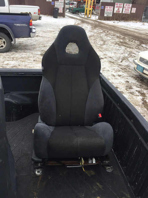

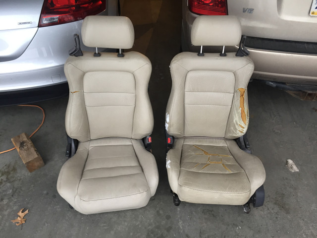

Stock Seats are FUCKING HEAVY and these are not even powered.

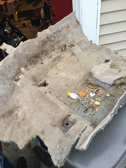

Interior was disgusting. Found $8 in change however.
Grabbed some 4th Gen Eclipse seats for $50. They look nice but the seats move you out to the side. It's hard to explain. I'll take some more detail photos when I get the interior back together.

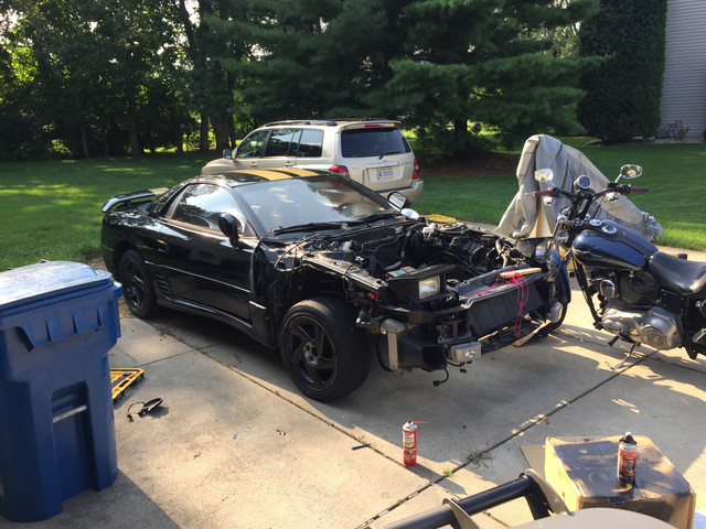

Car had a dented fender - replaced that with one the previous owner gave me.

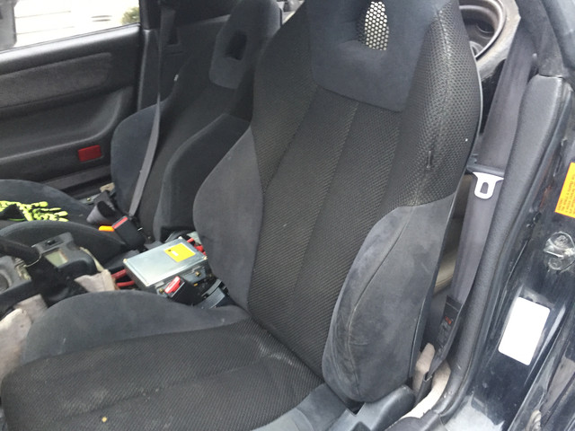

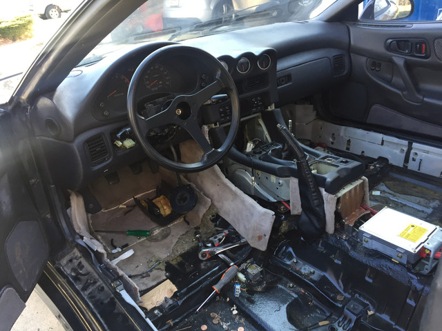

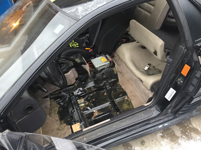

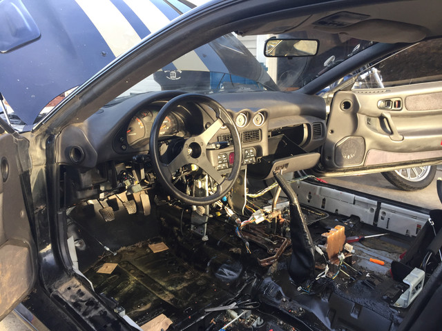

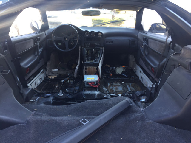

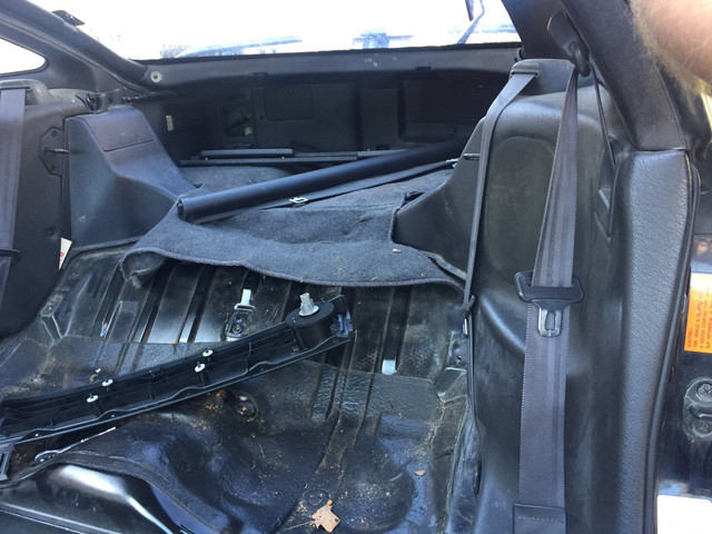

Continued Stripping the interior. The plan is to build a car inspired by the Porsche 911 RS or Honda Integra/NSX Type-R. Minimalistic interior, weight savings but still making it an enjoyable street car.
Lots of guys in the Z16A community argue against weight savings. They feel the car is a "GT Touring Car" and to leave all the creature comforts along. I plan to delete just about everything. The Electronic Suspension, the Active Aero, the Airbags, ABS, so forth. Not just delete them, but remove the wiring, brackets and all.

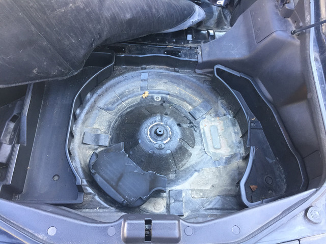

Rear seats are a great example, Yes, the cushions only weight maybe 20lbs, but toss in the buckles, belts, mounts, and brackets and your well over 50lbs.
All this, gone - I may even cut out the pan and rivet in a sheet of aluminum like many DSM guys.
Up front, installed my RAID steering wheel. Authentic Italian unit with a very strong Porsche historical connection. You can still find some NOS on eBay every now and then.

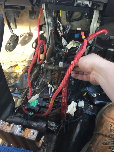

SRS Wiring, it's all coming out.
This picture earlier, that silver box is the SRS module, not the ECU and it's not light.
I really like the dash design.

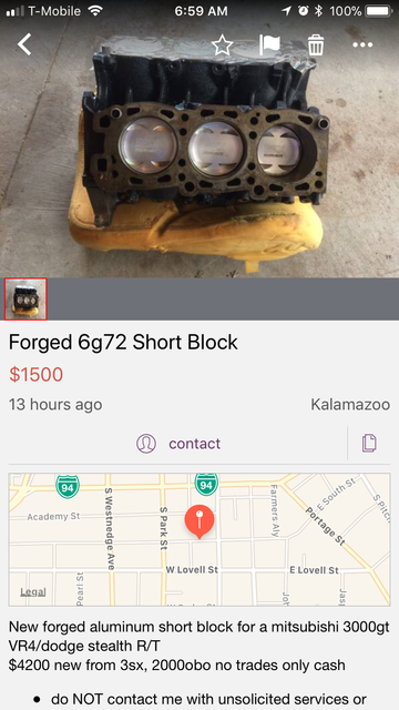

So this guy was selling what he claimed was a 3SX forged Short Block.
6G72s have two blocks - a 2-bolt, and in 1993 they went to a 4-Bolt block. Also in 1992 they went to a Forged Crank.
3SX built using new 4-bolt blocks with OEM Forged Cranks, they then had Ross Pistons and H-beam rods. Retail was like $4k for a short block.
After some back and forth, he agrees to $900. I go up there, and while the engine does have H-beams and Pistons, it's a 2-bolt block, and won't turn. The hone was shit and the block was a filthy pile of shit. So I passed. Waste of Time.

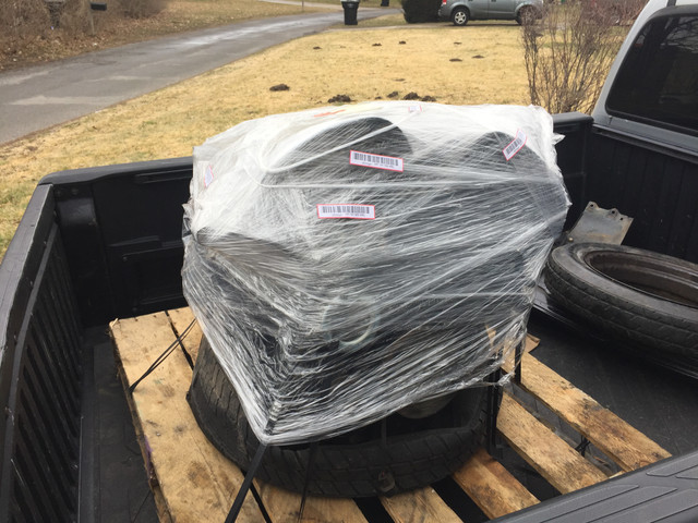

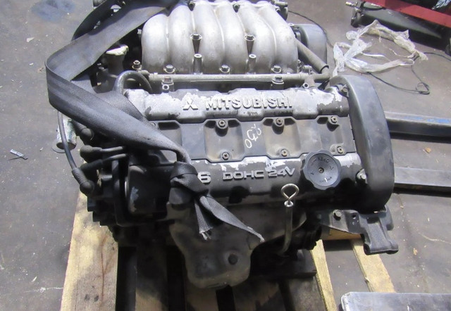

Ended up buying a used N/A engine from Alabama. I had thought about buying a JDM motor, but complete engine sets are ~$3-4k, granted that includes transmission and transfercase. However, I'd still want to rebuild it and that would be another $500-$1000 and the whole point of this car is a cheap project.
This was like $650 shipped.
Seller was great as they held it for a week as I was traveling for work. When I returned, it took just a few days to receive it.
Engine was used but in good shape.

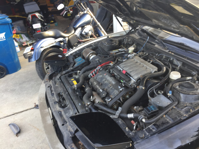

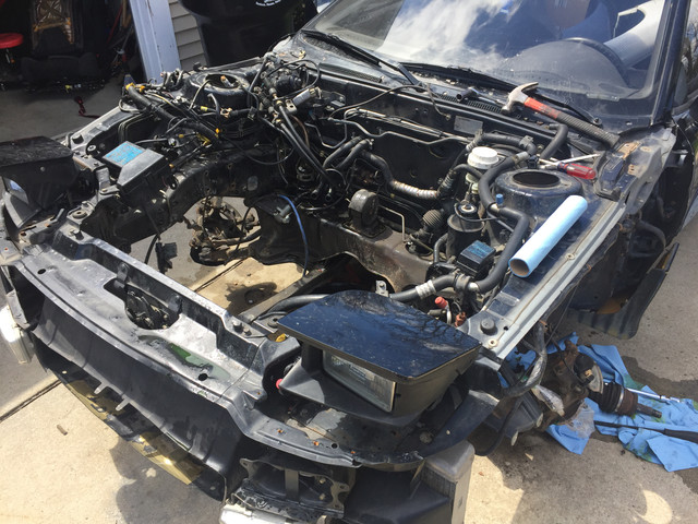

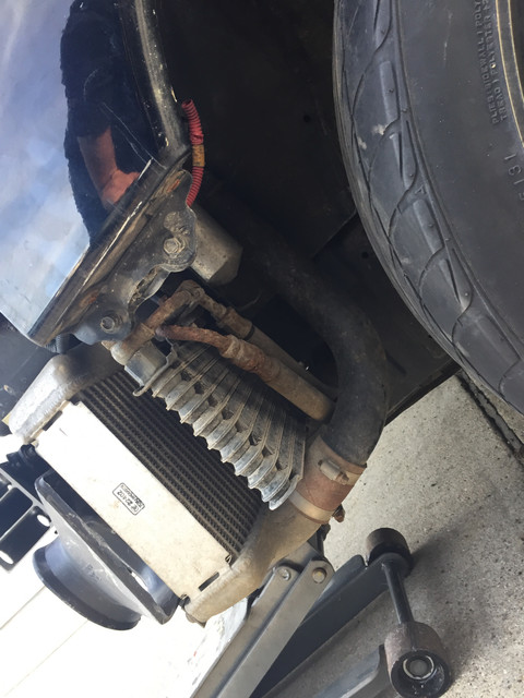

Oil Cooler will need replaced. I'm undecided on FMIC or just new piping for the SMIC.
Duke's proud of his Stupper-Vising.

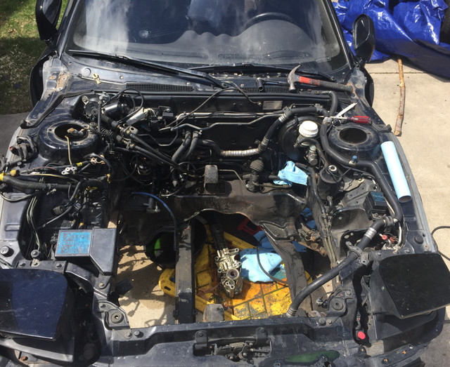

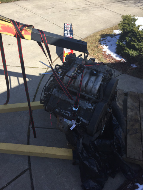

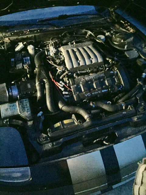

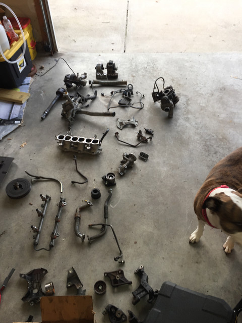

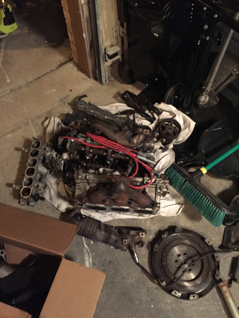

Pulled the engine in a few hours. These cars are not as bad as people make them out to be. It's no '72 Chevy Half-Ton, but it's much easier then a 300ZX or anything European.
I'm keeping the A/C intact since the awesome digital climate controls work. I'll upload a video.

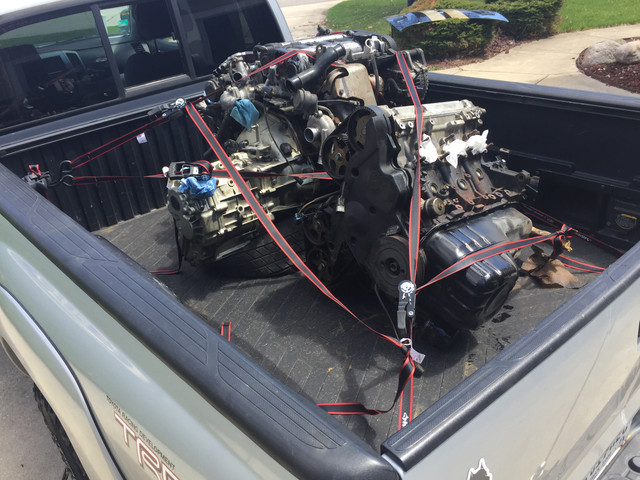

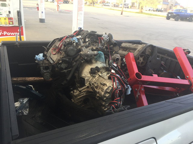

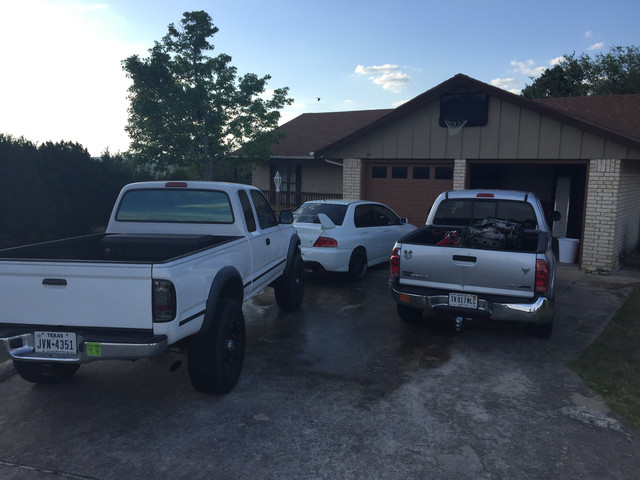

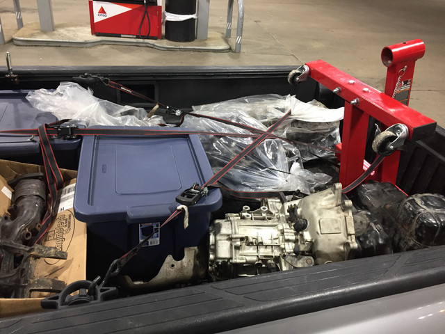

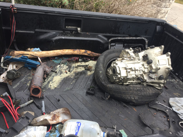

Packed up the Turbo Engine and N/A engine. Headed down to Texas to visit my bro, Da Shelba. Tacoma was totally maxed out and not enjoying it.
But I made it.

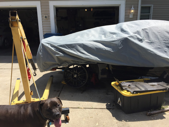

One complication was Jason forgot to mention his lack of Cherry Picker, so I had to strip the engines in the truck bed so I could unload them.
Luckily the neighbors decided to give a hand... by standing around watching.

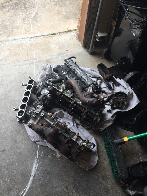

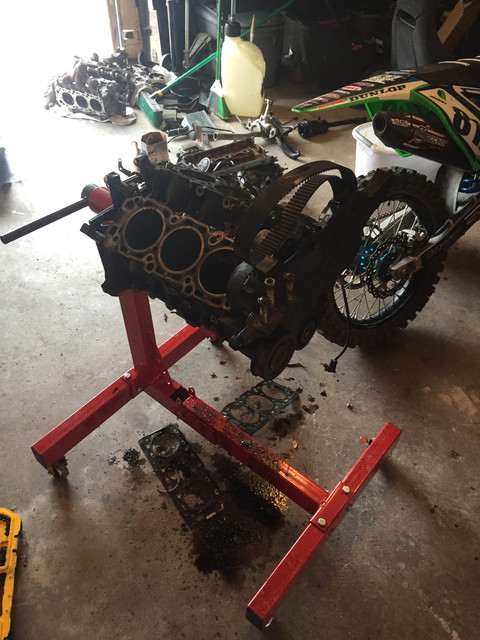

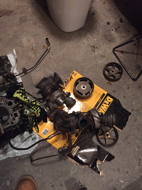

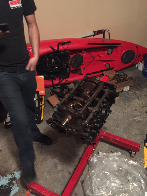

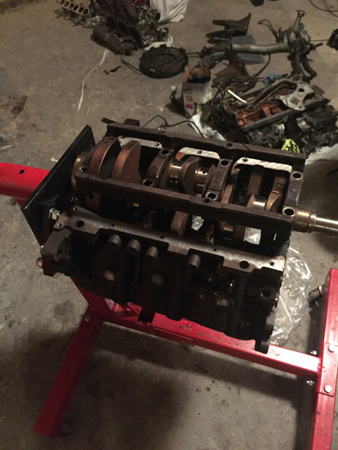

Turbo Strip down.

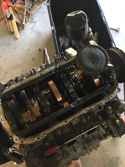

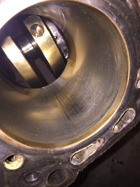

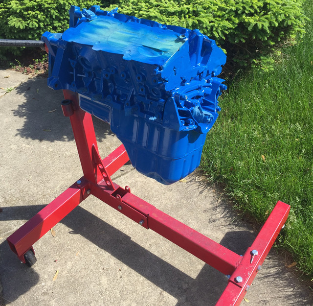

Block had been previously, and most likely incorrectly rebuilt. Bores had a ton of scoring. Block needed to be bored over.
Without time and on a budget, we decided to just use the N/A block. Which kinda sucked only because it turns out the N/A blocks are all 2-bolts, only the later Turbo Blocks are 4-bolt. Despite this, the 2-bolt blocks are known to make 1000whp. They have huge girdles. My goal is not to use the "Best of the Best" but to just build a simple 350whp fun street car. I have to keep reminding myself.

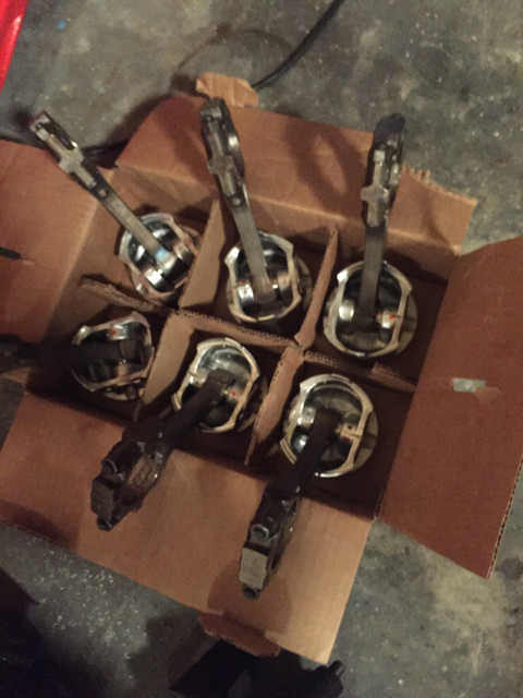

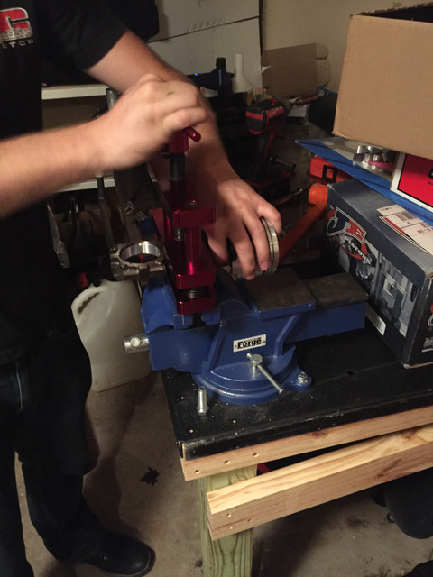

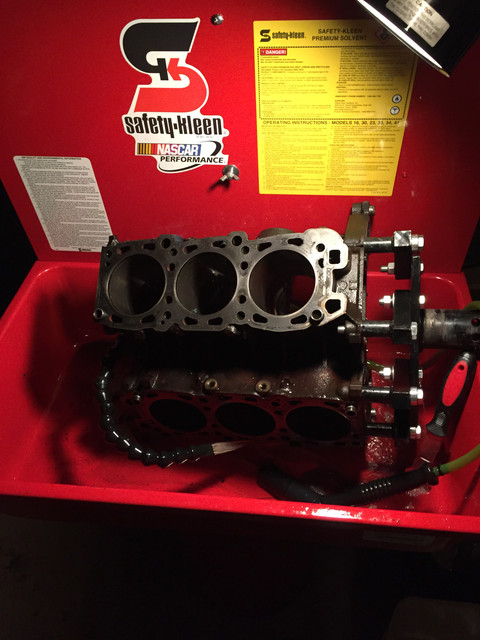

Another snafu was the pistons are press fit and not floating pins.

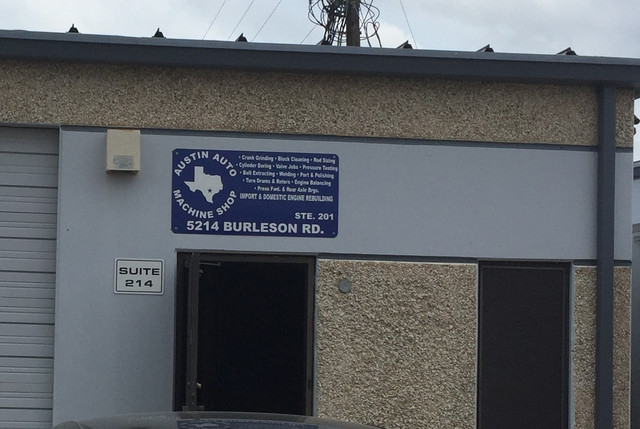

Luckily I found a local shop within an hours drive that could turn it around for the next day.
Into the cleaning tank the block goes -
Fancy Rod Vise to check clearances
God damn mess.

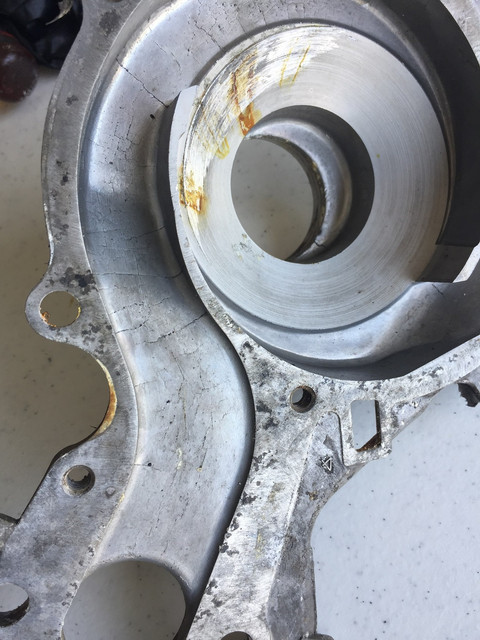

So with all the complications and delays, ended up blue printing and assembly the short block (I'll post numbers later). Packed everything up and headed back to Indiana.
Once Home, I started laying everything out to reassemble.

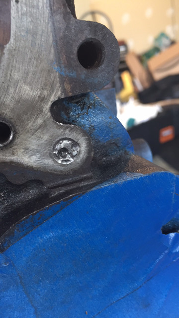

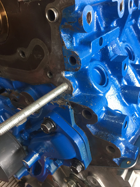

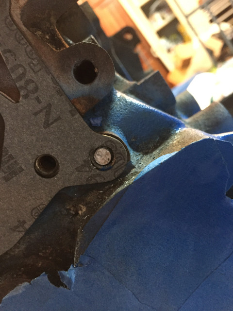

Of course one of the oil pump bolts bound up and snapped. So i tried to use an easy-out to get it out, and of course that snapped too. Well an easy-out is hardened steel, so I ended up having grind that bitch out. First time ever Jalopnik had anything of value to contribute.
https://jalopnik.com/heres-how-you-r...fro-1746998630
Ended up over grinding and going into the water jacket. Made a stud, JB-Welded it and life goes on. Engine got painted Ford Blue. I plan to paint the heads and valve covers too. I like that painted hot-rod engine look. Let it sit outside all day in the heat to get a nice sun bake and give the paint time to out gas.

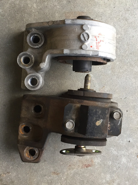

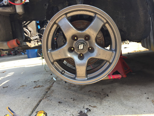

First, I found a Sebring with a 6G72 using a similar looking upper engine mount. Only it was aluminum. So for $5 I gave it a shot. It's identical and weights a good 7lbs less.

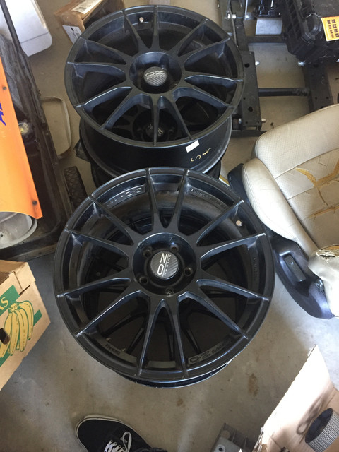

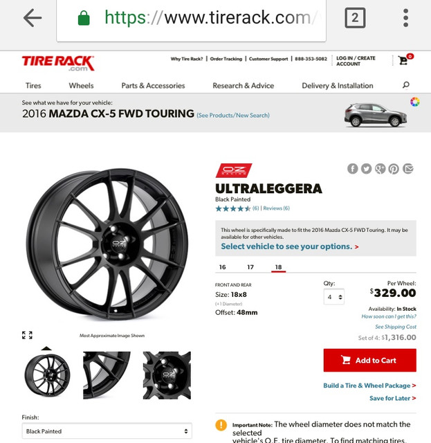

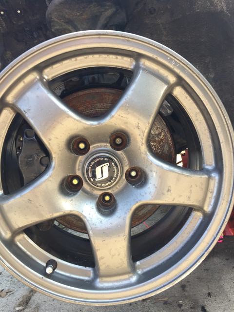

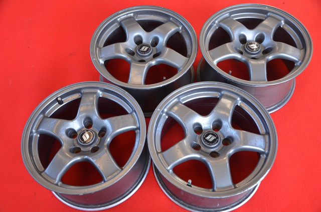

I also scored a set of mint OZ Ultraleggeras in 18x8 5x114.3 for.... $200!!
Only downside is I was planning on going with something like an R32 OEM wheel. I want that chunky tire 80's supercar / 90's import look.

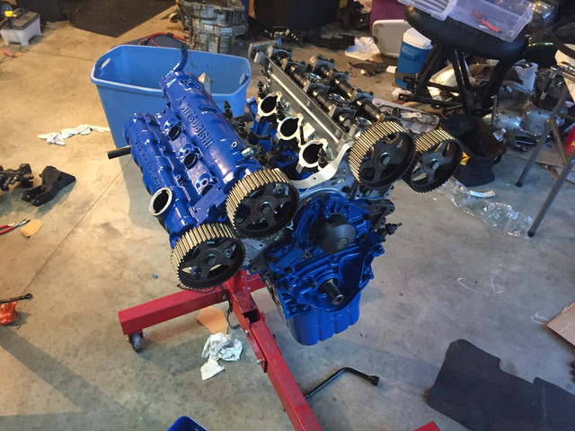

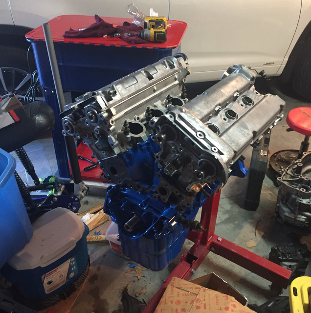

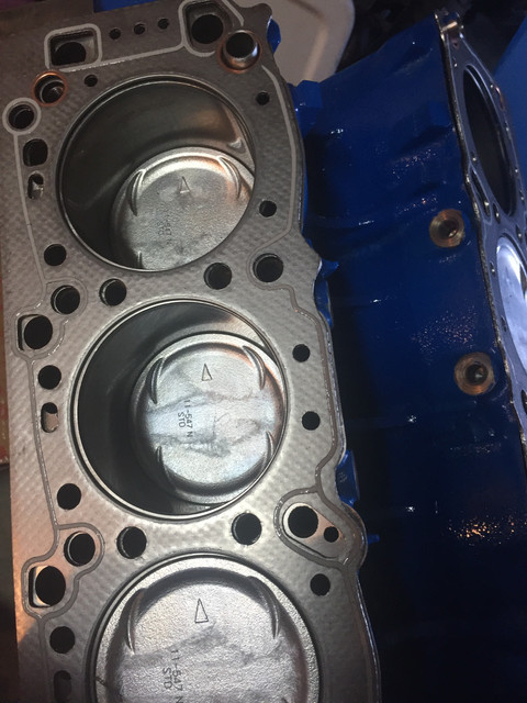

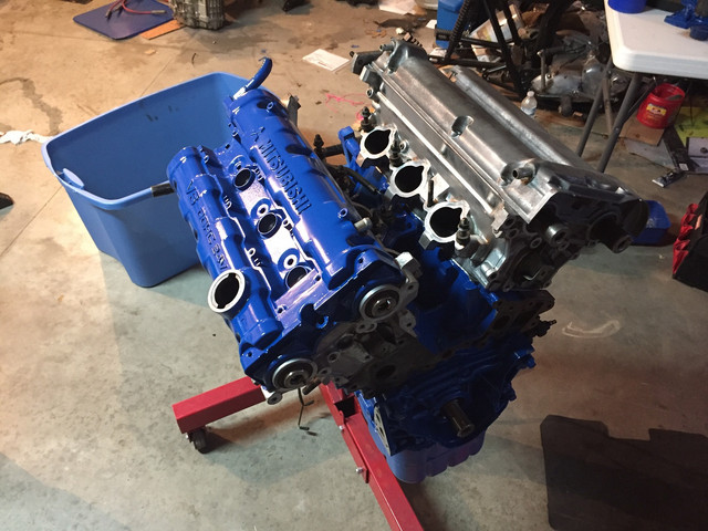

Heads are cleaned up and reassembled. Unfortunately, the head-gaskets that came in my rebuild kit are composite. Ordered some FelPro MLS gaskets. Should be here next week.
Weather is nice this weekend. So I may drop the Cobra's gas tank to eliminate PPRV from pumps, or work on the interior of the GTO.

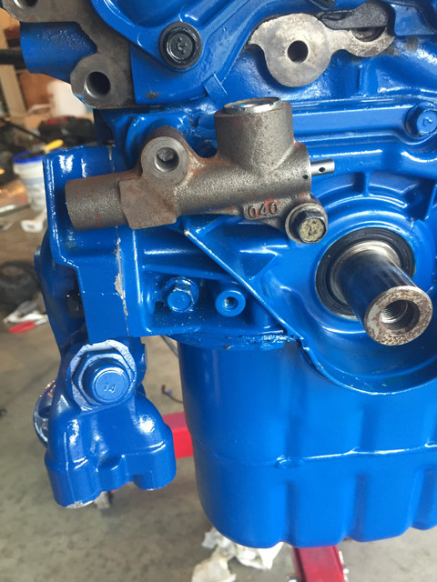

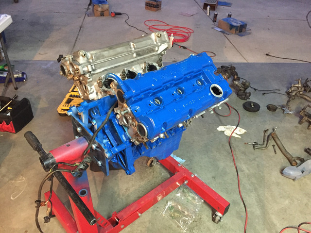

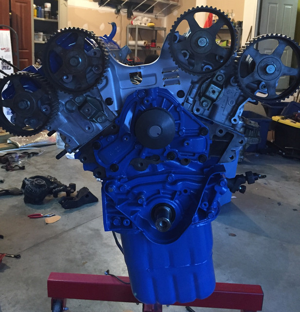

So normally this is where most would be parting out or just vanishing into the darkness. However, I'm still at it!

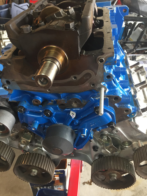

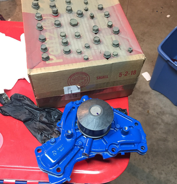

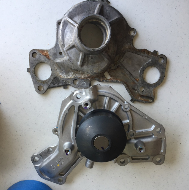

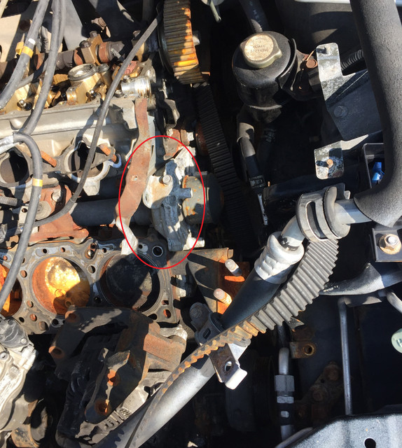

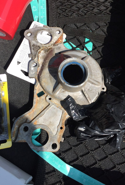

Needed to find a rear housing for the water pump since I tossed BOTH of mine away not realizing I needed to re-use it. Luckily the junk yard had a pile of crap 3GT.
Also had to buy some head-bolt washers since I tossed those as well - which need to be re-used.

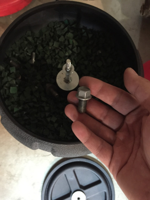

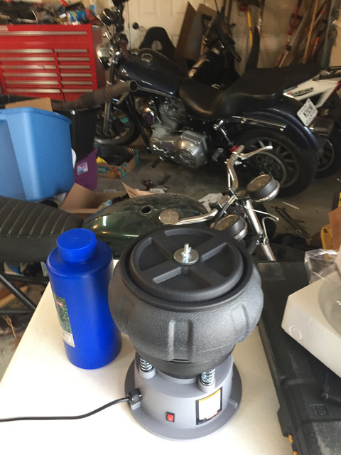

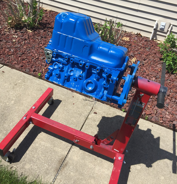

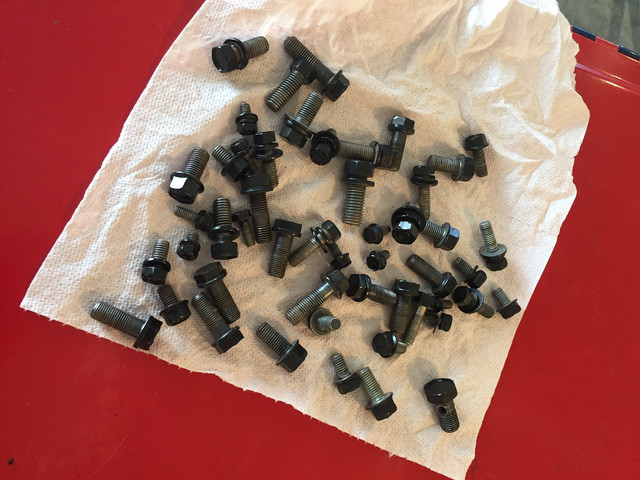

Also bought a parts tumbler, works great, cleaning up all the ancient hardware.
Engine is starting to look like an engine again.

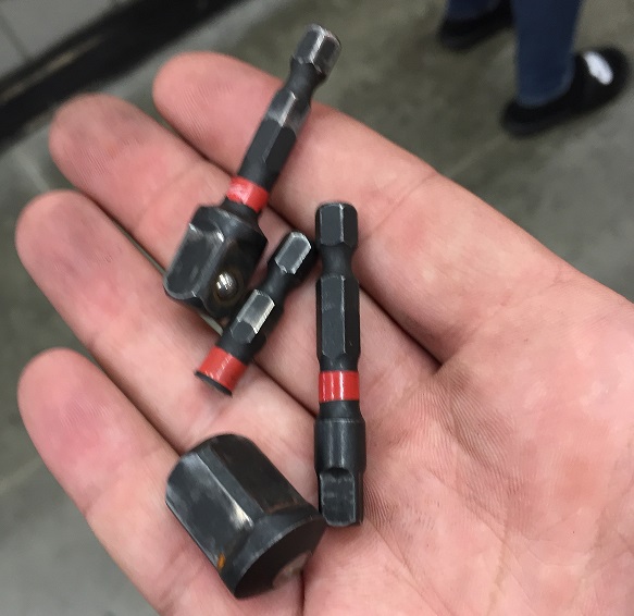

Also, ALSO! Fuck Milwaukee Tools. A lot of my friends are all about that, and while I'm DeWalt for the power tools (American Company, Assembled in America), I did by the MT key set at Home Depot - of course a month into owning it the 1/2" just pops in half.
Had this been Craftsman or Pittsburgh (Harbor Freight); I could have walked right in the store and they'd have given me a new set. However, HD said they don't do that and I have to email MT and file their warranty claim to get it replaced under the Life Time replacement. F-THAT. That's the same BS that Lowes does with Kobalt. Harbor Freight all the way from now on. Waste of time and money.

Pump pulled, cleaned up and painted. No idea why I'm painting half of this stuff, you'll never see it once installed.
Fasteners are coming out nice. Lots of prep but the paint is holding up under torque procedures.
ERMMMYYYGAWWD - It's looking like an engine again!!

Whelp was all pumped to get this engine done tonight...
But remember that damn bolt that broke, then the extractor broke, then I ground out to much and punched into a water line... then JB Welded a Stud in..
Whep I needed that hole for the belt tensioner.
Now to start that all over again.

Visually, not a lot of progress made this weekend. However I actually did get a bunch done - including work on the Dyna.
Got that stupid stud all squared away... again.

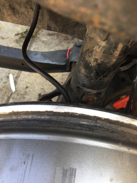

My GT-R wheels arrived over the course of several days last week. Each in it's own box. USPS thought it was really funny. I had pretty much forgot I ordered them. Overall good condition for the price, but will need to be refinished. I'm open to suggestions on shops/places to get them done at in the tri-state area.
I had also worried that they would not fit. Did a lot of research on spacing, caliper sizes, etc. It pays to be a Gen 1 with the "Smaller" brakes.
Science Bitch!
Although I'm going to get extended lugs and some small spacers

Also got the poor man's GTR to the old garage. So much Nostalgia. Built the 240 here 12 years ago.
Hmmmm $85 to rent a trailer, $60 to hire a tow and not have to fuck with it.
Grabbed a legit jack finally. So smooth.
Up in the air. Kinda farting around today not sure with what to start on. So much to do.
Sent from my ONEPLUS A6013 using Tapatalk
