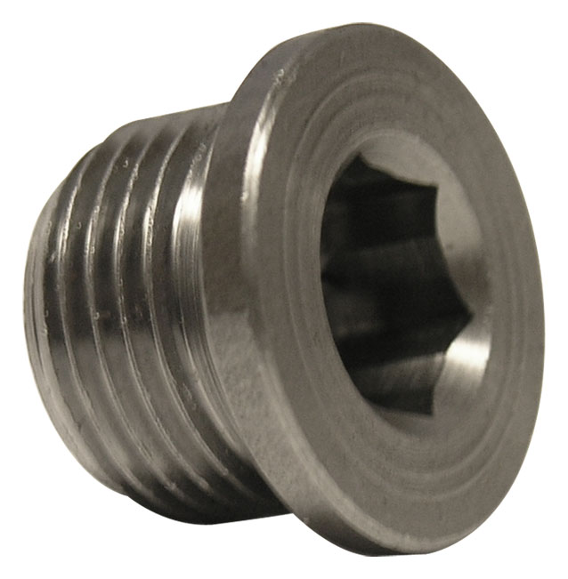

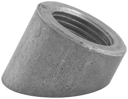

What I went with was a 45* mild steel bung so when I weld it on it will be at the perfect angle I need so I don't get oil buildup from a low spot in the return line; Wouldn't want to starve the motor of its precious oil! Also, mild steel M18x1.5 (mm) o2 plug (bung plug) and M18x1.5 to -10AN fitting. This all but cost me $18.
