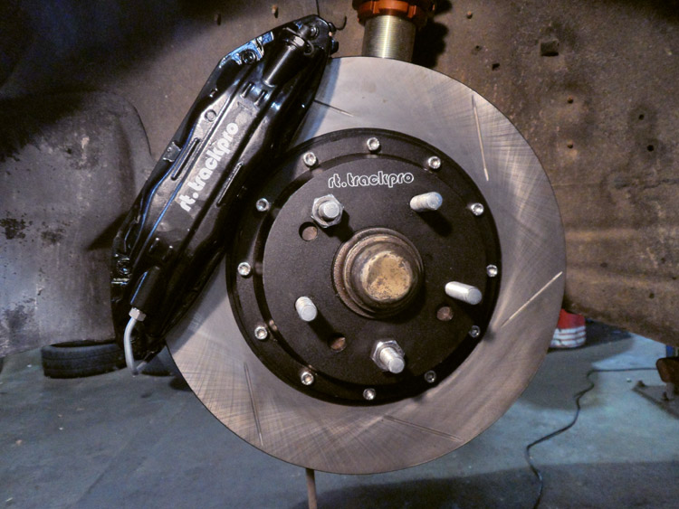

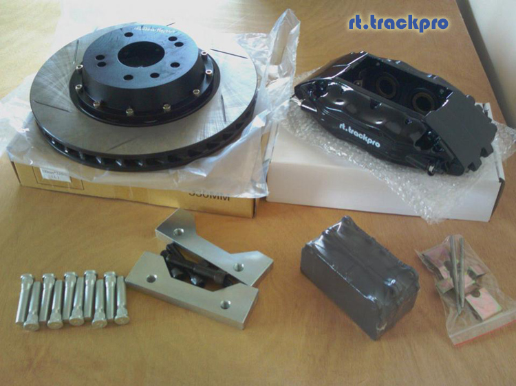

Front 13" 2-piece BBK

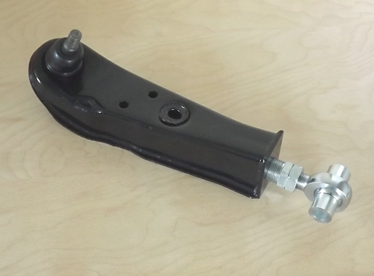

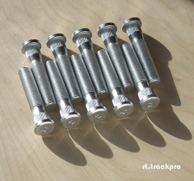

Extended 60mm wheel studs

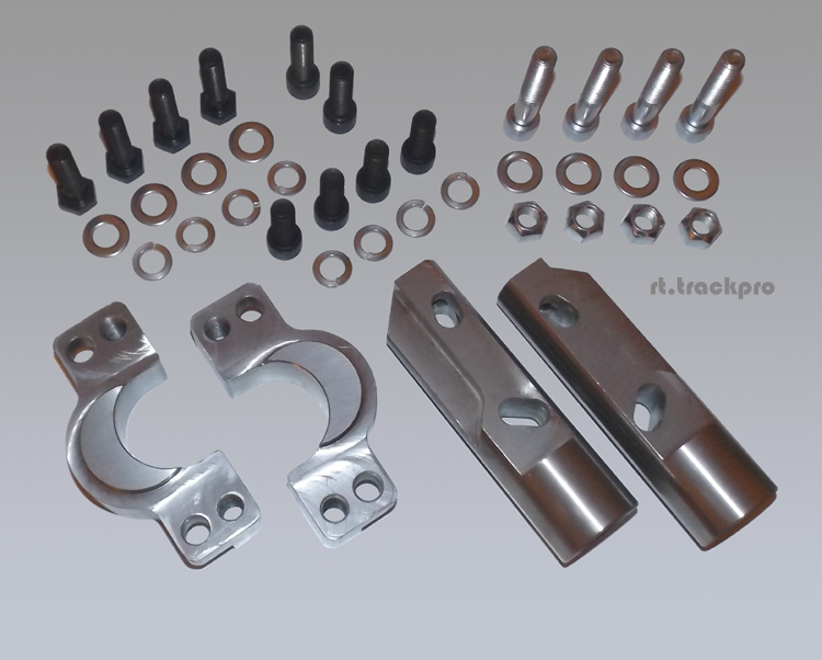

Negative camber roll center adjusters
S13 coilover adapters
Front bumper brackets (preparing last batch)
You'll also find someone making quicker ratio steering knuckles
Oddly he didn't mention a vg33 swap from a pathfinder/quest, since it's pretty much bolt-on using z31 accessories
