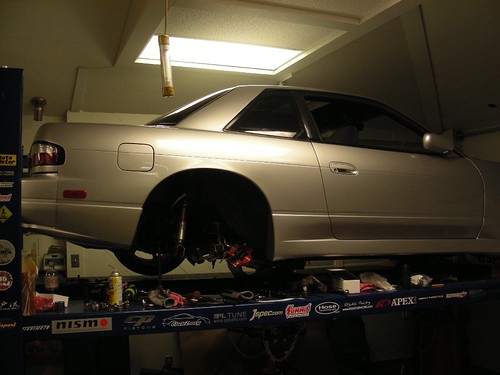

Ok, I got a little more done today. I am trying to get the rear diff and rear suspension set up so once I drop the motor and tranny in I can just hook up the driveshaft.

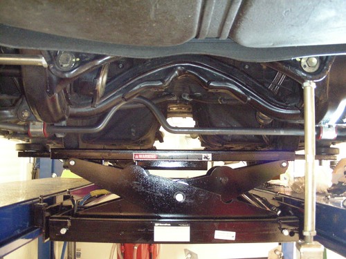

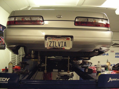

Here is the car with the rear end lifted off the lift. I ended up getting an attachment for the lift, so I can do suspension work on it.

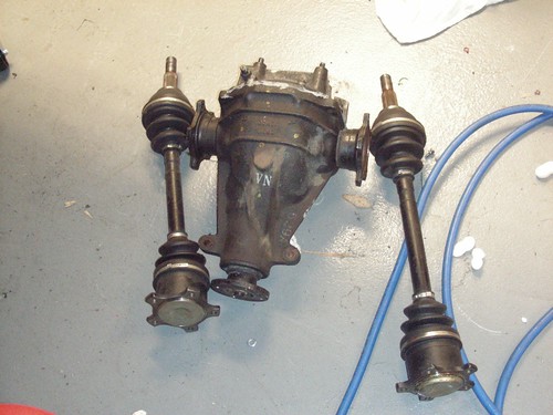

Passenger side removed. I forgot that I need new hubs to fit the larger TTZ and Q45 axles. Luckily I still have the Q45 subframe so I will pull the hubs off of that and install them in original S13 uprights.
Diff and both axles removed
Except for the rear diff cover, I guess I won't be needing this VLSD with 4.60 gears in it anymore.

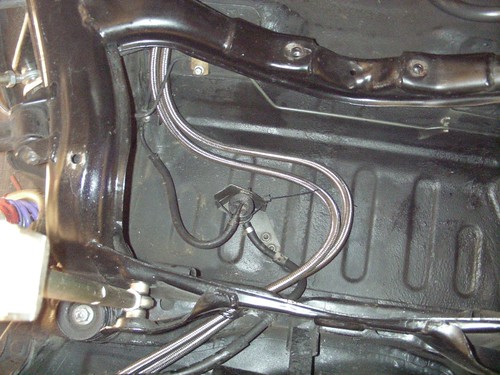

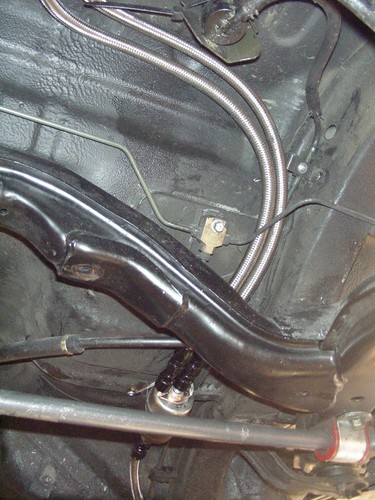

Preliminary layout of the fuel lines and filter/FPR set up from Fueled Racing. I need to ultimately tie down the lines and make sure there is no rubbing with the other lines and other parts.

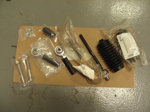

Just received my SPL tie rod ends and also new TTZ front tie rods.

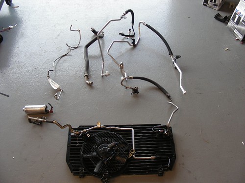

I am hopefully sending out all my Nissan and CTS-V AC fittings to Fueled Racing next week so they can fab up my lines. They said it a short 2 - 3 day turn around.

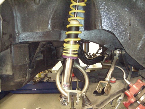

I knew that in order to go to the KW coilovers, I would have to go back to the stock rear knuckles as I had called KW and they would not make a special set of their 240SX rears with the Z32 fork mounts.
I mentioned earlier that I did not realize was that my existing 5 bolt rear hubs would not fit with the Q45 and TTZ rear axles that I need for the Q45 rear diff. Ok no problem as I still had the Q45 rear subframe with the rear knuckles and hubs. I figured since they are using the same size axles, that the knuckles and thus the hub bearings would be the same. Since I had to pull the hubs off of the Q45, I figured I would install some new Z32 TT rear bearings that I have had sitting in my garage for ages. Luckily I checked first and found out that the OD of the Z32 TT don't fit into the Q45 knuckle. The knuckles look identical to each other and both use the same size axles, but the hub bearings are definitely different sizes. In the end, I just installed the Q45 hubs into the stock S13 knuckles with no issues. I just hope the Q45 bearings don't fail in the near future.

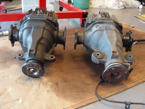

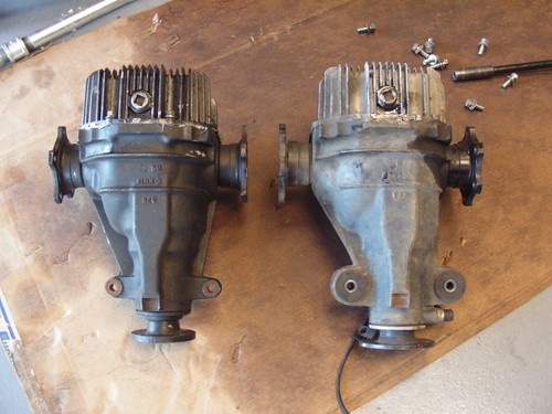

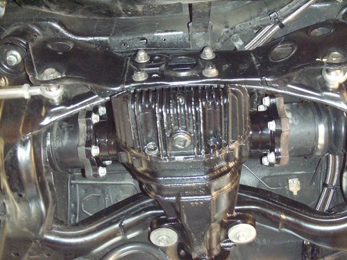

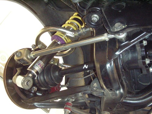

Just a quick update as I finally finished off the rear suspension and Q45 diff swap.
Side by side comparison of the 240SX diff on the left and the Q45 on the right.
The front yoke is much larger on the Q45 on the right. The guys at Fueled Racing have a driveshaft for nearly any configuration, so it took only a few days to get the driveshaft. In this case it is a Q45 diff with ABS connecting to a T56 Magnum tranny.

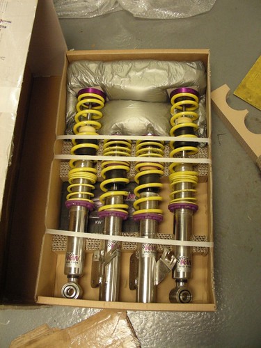

Nice packaging from KW
In progress shot
Finished
Q45 diff and axles installed. If you do this conversion, make sure you get the bolts for the 6 bolt axles. Unlike the different 240SX configurations that use nuts and bolts to connect the axles to the stub axles in the diff, the 6 bolt axles are actually threaded so you need the bolts that come with the axles to bolt them to the stub axles.

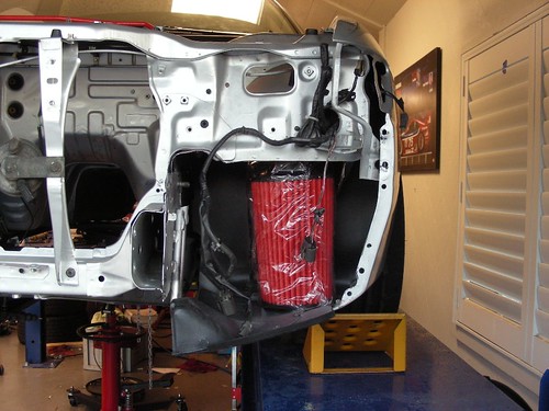

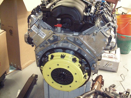

I wanted to see if I can mount the air filter in the same place that I had my air filter for my SR20 mounted. The stock E-ROD filter is big, but it looks like it will fit.

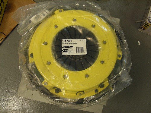

Next step is to install the ACT twin disk clutch and the starter. I think I am going to attach the bell housing and drop it from the top and then install the transmission separately from the bottom. We'll see when we get there.

If you Are trying to pass smog it can be a little tricky with what you use as an intake. it has to be carb legal
Actually, that is the air filter I am suppose to use as it is part of the E-ROD engine assembly kit and was the filter that GM used when they passed certification for CARB. That is the beauty and convenience of the EROD package. It comes with the engine, intake, cats, exhaust manifolds, wiring harness, ECU and EVAP box
Actually, when I went to the Ref he said he didnt care about the air filter at all and I could have left my K&N one on (I swapped the GM filter on) but I think each case will always be different.

I wasn't stating the air filter itself, I was just wonder about intake piping you where going to use to locate air filter in that location. From what I understand ref looks at intake system after the MAF sensor.
Ok, good point especially since the EROD comes with no piping for an intake. I never actually thought about it as I was just going to use some 4" piping to run the filter to that location. From everything I've read about the referee certification process it seems so random and dependent on the particular referee. Sometimes i think the entire smog laws in Calif are random.

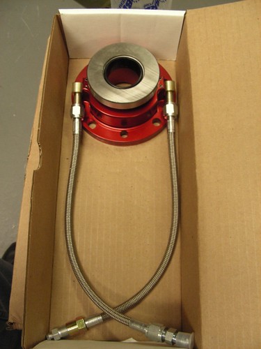

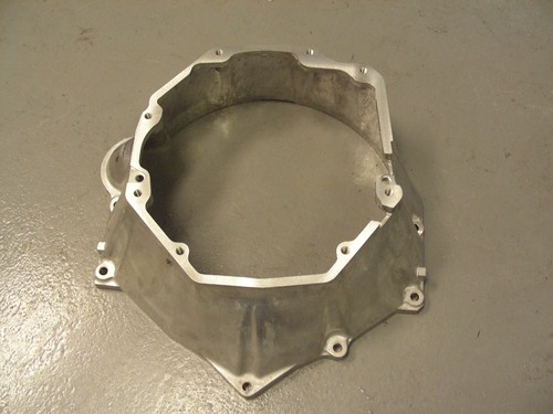

Got a little done today.
Got this installed.
Didn't have time to install this bell housing
Received some goodies from UPS yesterday
Got these brand new bricks for a fair price from someone here on Zilvia

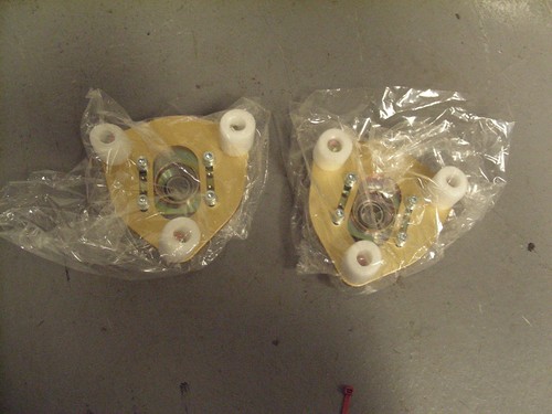

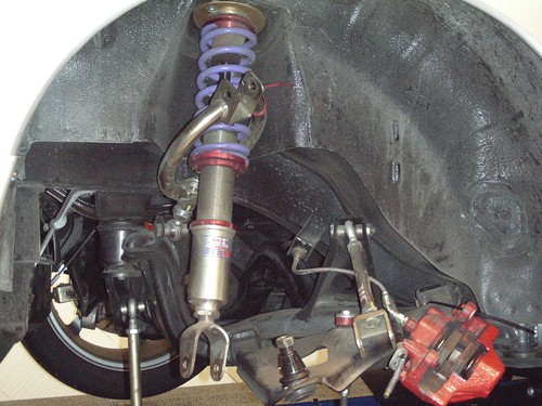

Tein pillow mounts for the front KW coilovers
91 Z32 TT, 92 Z32 TT, 90 240 LSX in progress, 09 GT-R, 18 Honda Ridgeline

You will like that clutch. Did you go with two street disks on it?
Posted from Zilvia.net App for Android
Yep, twin disk street setup that is suppose to hold up to 800 ft-lbs of torque, which is way more than I will be producing.
Turbozx is offline   Reply With Quote

Thats good. When I bought mine at first I had one street and one race disk. After a couple of months of daily driving I pulled the motor for a rear main seal and the race disk significantly ate away the metal surfaces and put deep grooves in the pressure and midplate. I sent it back to get rebuilt and change to two street disks. I did a drift event after installing the street disks then checked them after the event. The white letters printed on the clutch disk where still there and showed no signs of slipping. I have 380 tq and 420 hp.
Good choice on these, They last forever! Awesome build! Keep it up. Subscribed!

I did a junkyard run this morning and was able to find a 137K 90 hatchback that took a big hit to the right front corner. I was only looking for AC lines, but ended up taking some clean interior items like the gauge cluster and surrounding trim, the glovebox and the carpet.
I now have all the fittings I need to send to Fueled Racing to assemble my AC lines. In this picture, you can also see the new CTSV AC hoses that I bought to sacrifice the connectors.
I also received my McLeod hydraulic throwout bearing for the drivetrain
I am planning to take the crossmember off tomorrow and put together the engine, tranny and crossmember to install from the bottom.
