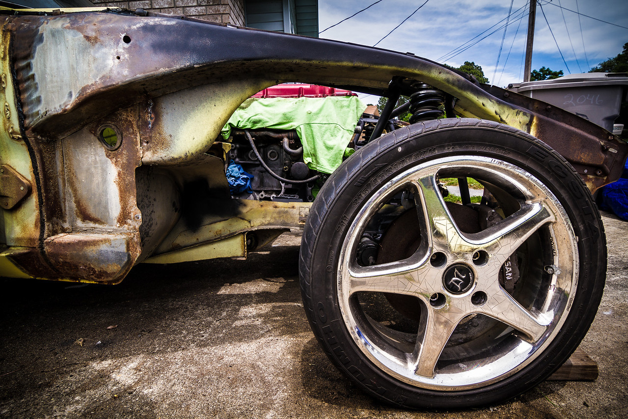

Ya looking good, haven't seen much of lengthening the wheel base before, sub'd for updates!!

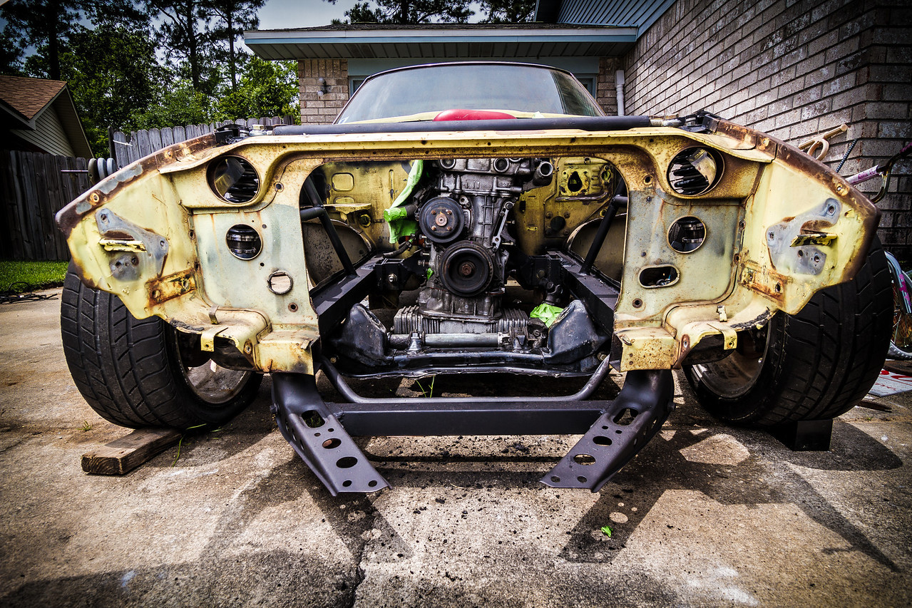

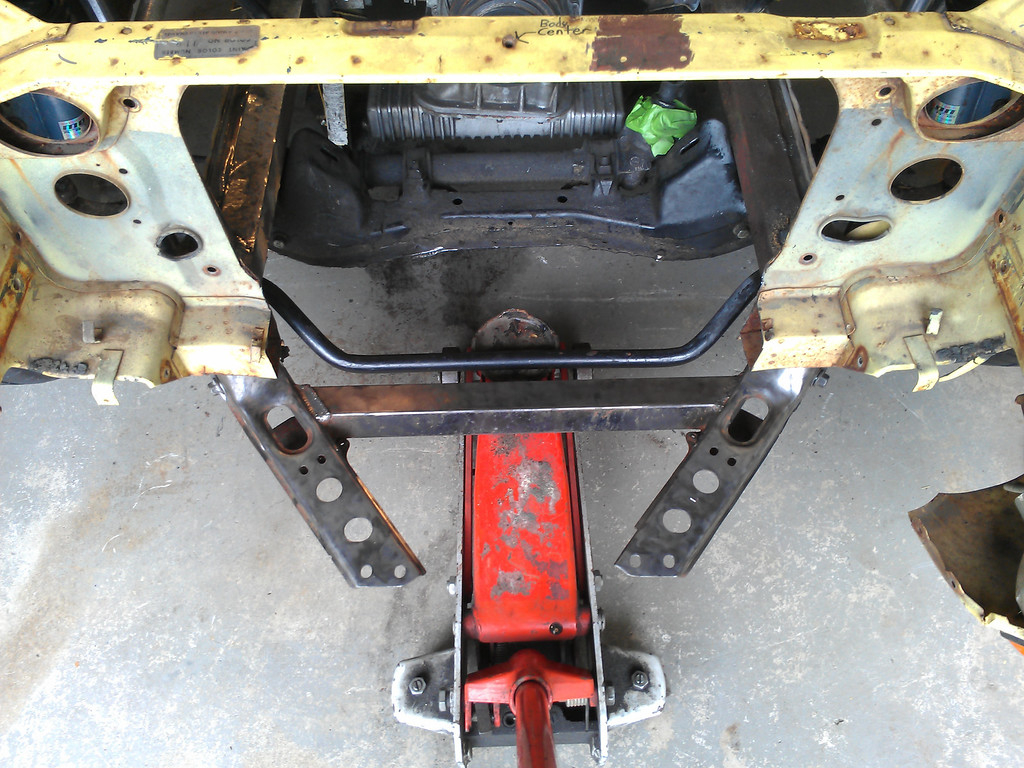

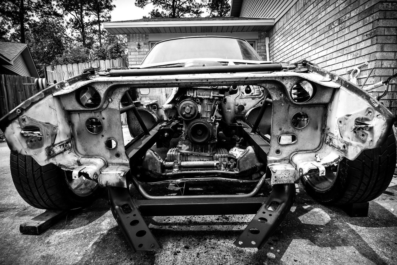

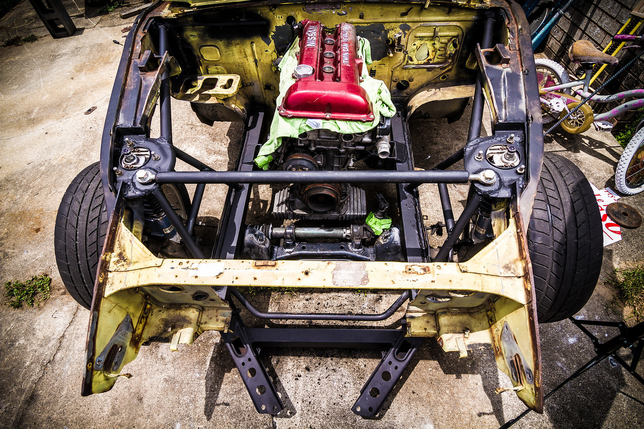

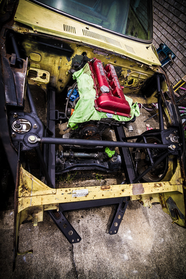

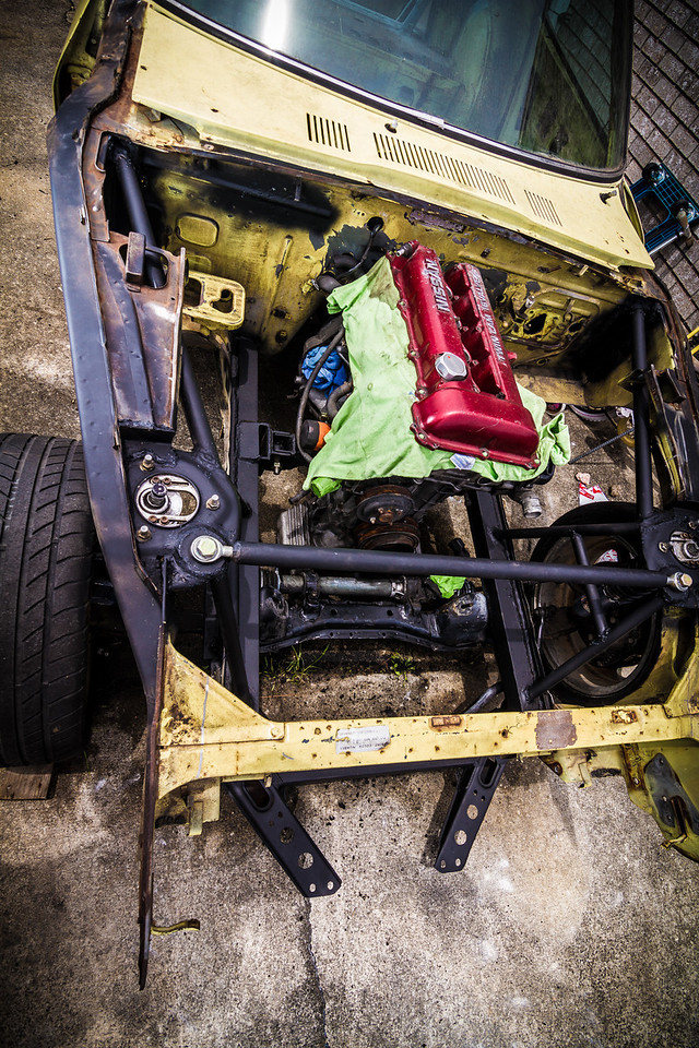

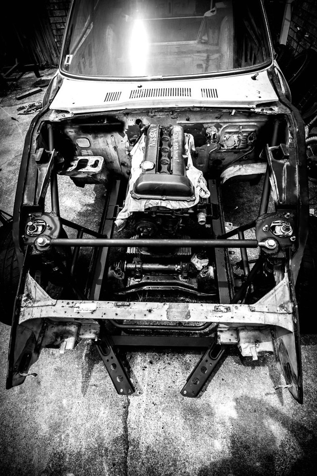

The reason for lengthening the wheelbase came about because using the S13 crossmember with the SR would not work with the stock strut mounting locations. The datsun has a front steer setup whereas the S13 has a rear steer. Nothing would work. The only option was to move the mounting location for the struts forward and out of the way. This ended up being about 7.5" forward and me making my own strut towers and solid motor mounts. The engine is sitting well behind the front axle line, so this should make for something interesting to slide.

Ya that's some awesome fab work you've done

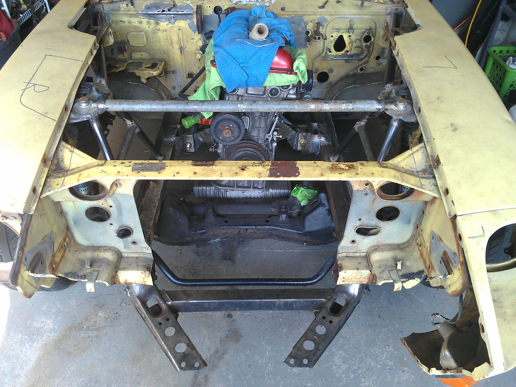

Interested to see how this turns out. Looks like a lot of hard work has gone into it.
What are your plans for the front end panels? Looks like you just moved everything forward but I assume it wont stay like that.

The fenders are pretty much where they need to be. I plan on cutting off the already formed and shaped back end of the fender, moving that piece back to match the contour of the door and whatnot. Then there will be a gap and I plan on just welding in a strip of sheet metal and shape it to fit. Once all the paint & body work is finished, it should look like one piece.

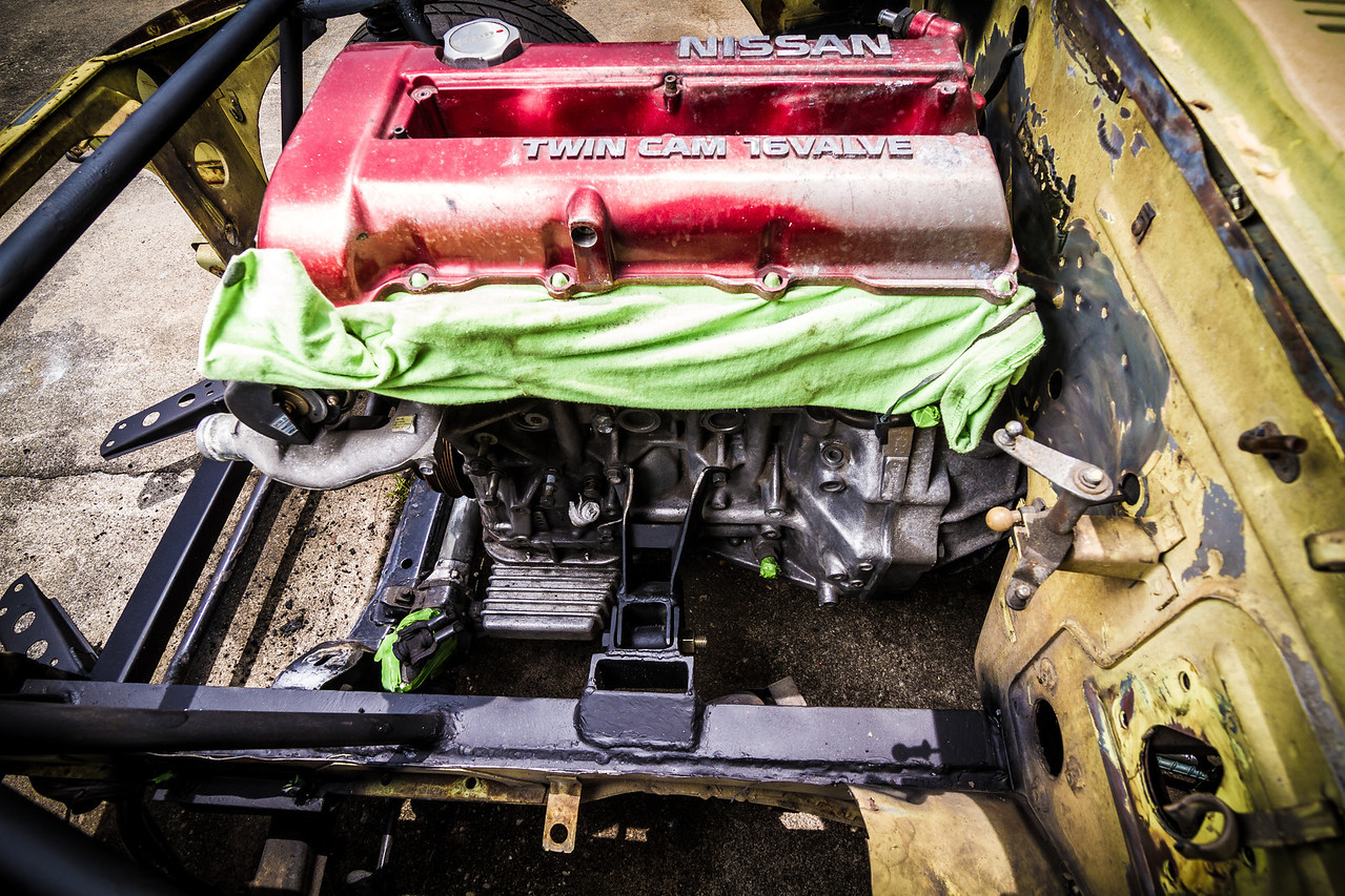

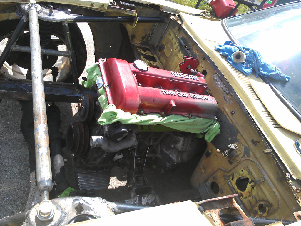

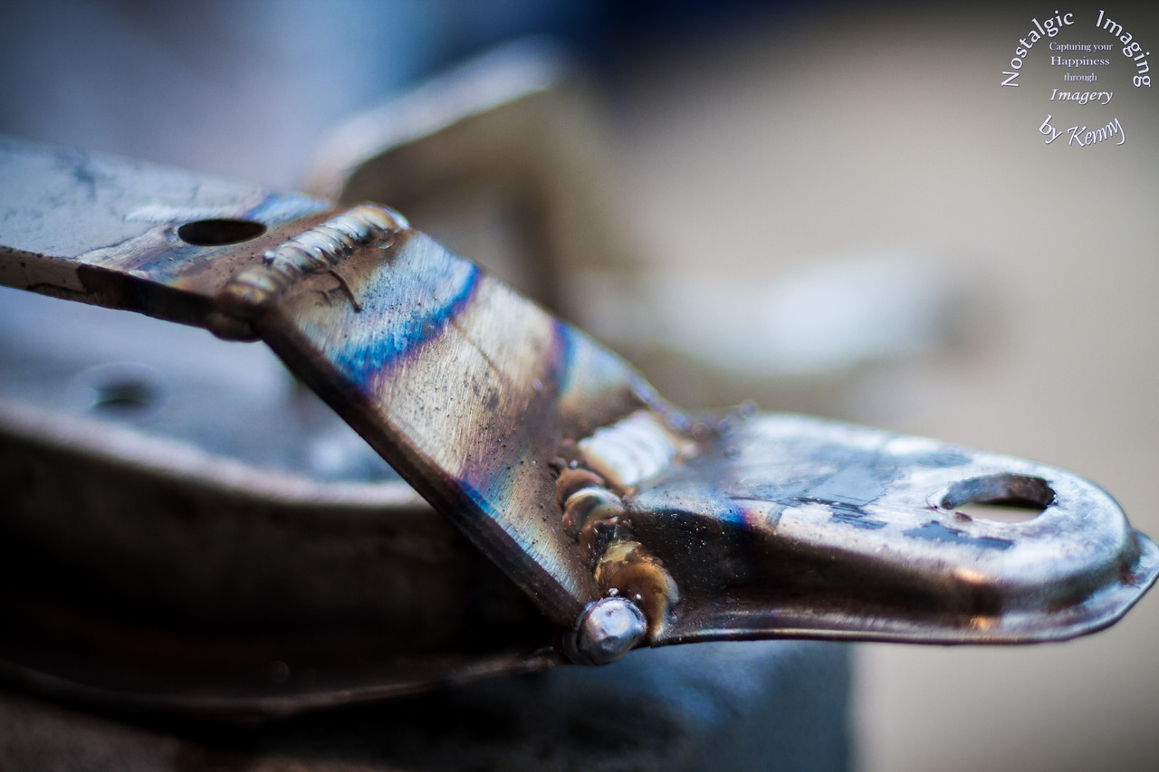

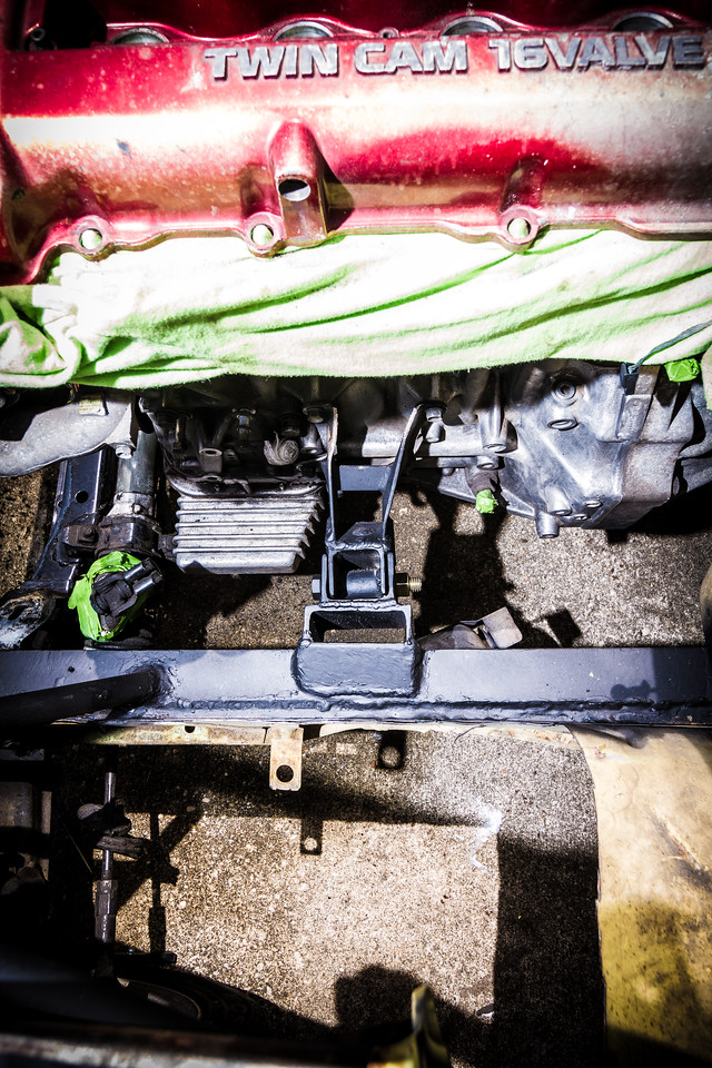

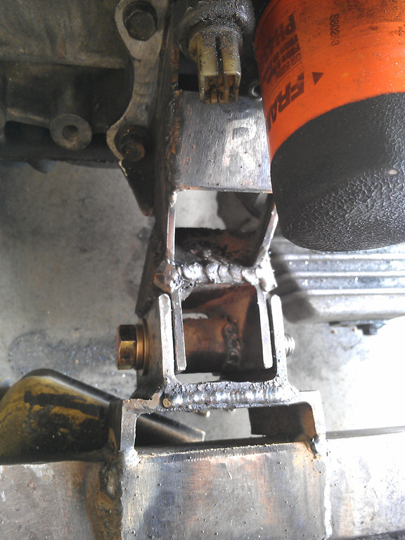

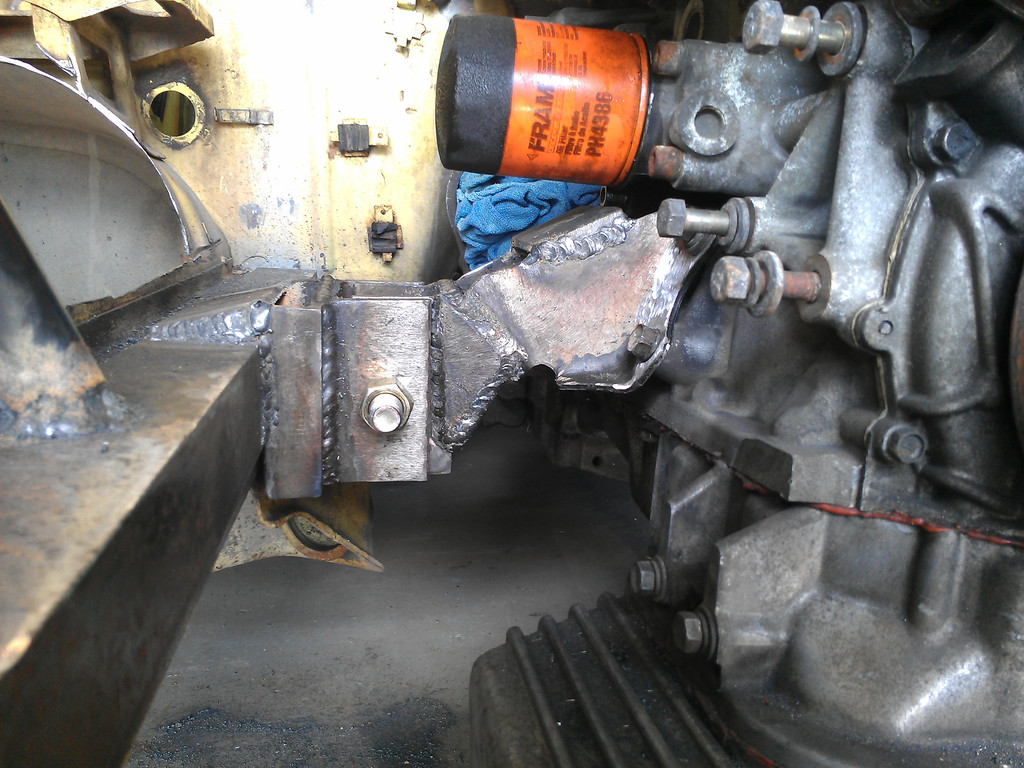

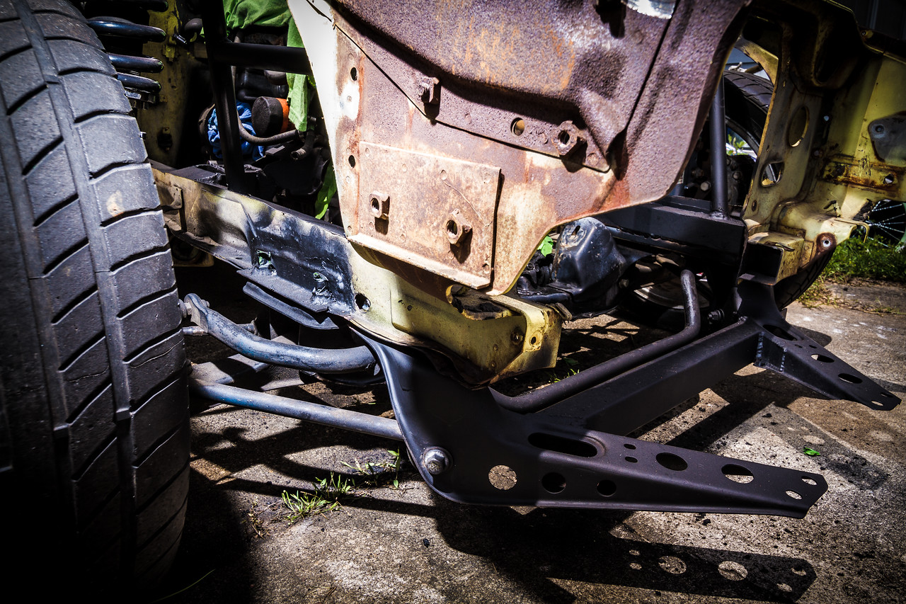

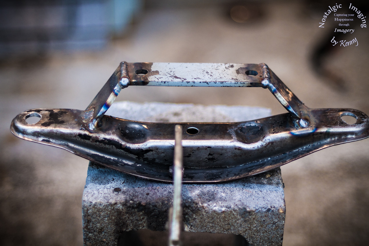

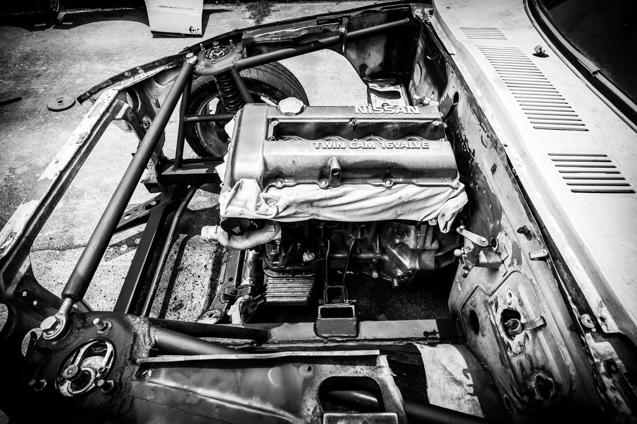

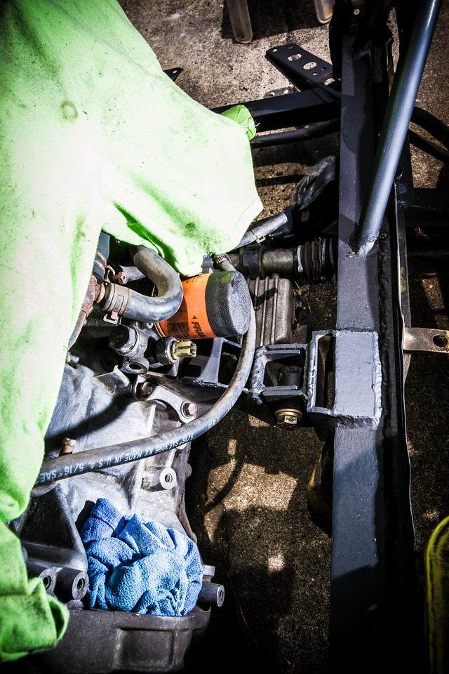

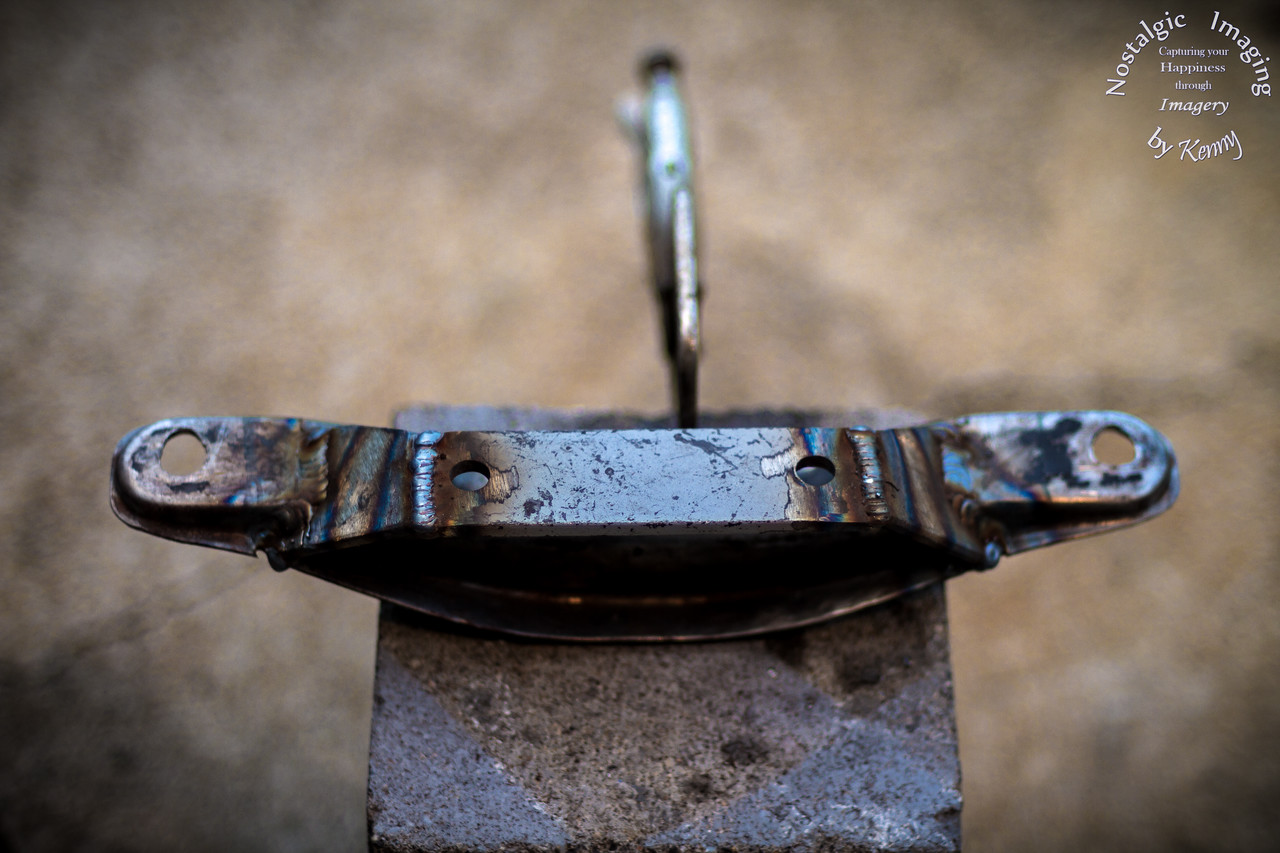

Here is a photo of the motor mounts I made a while back.
https://www.facebook.com/ProjectSR71
http://www.nostalgicimaging.com/

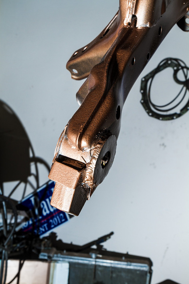

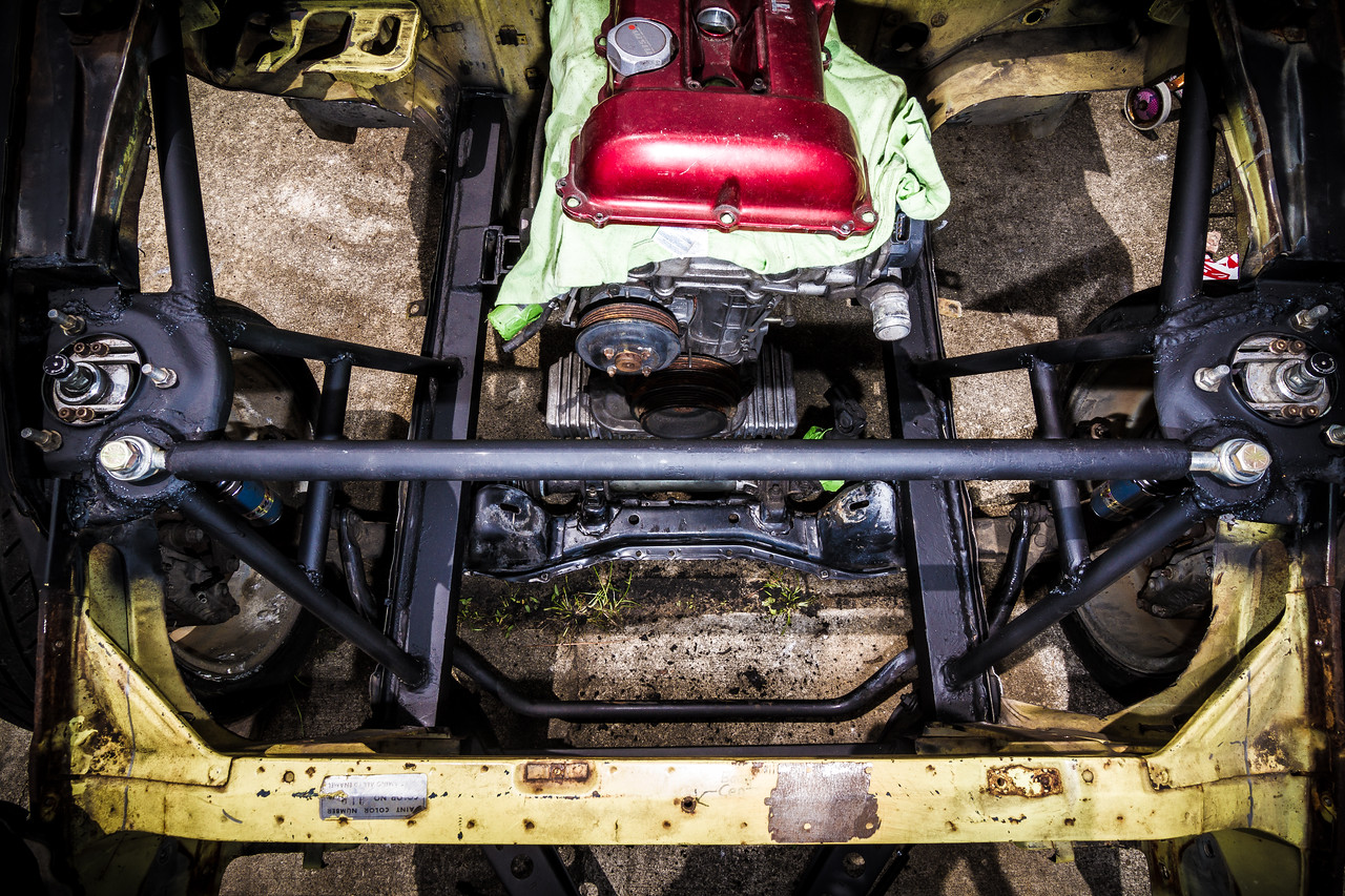

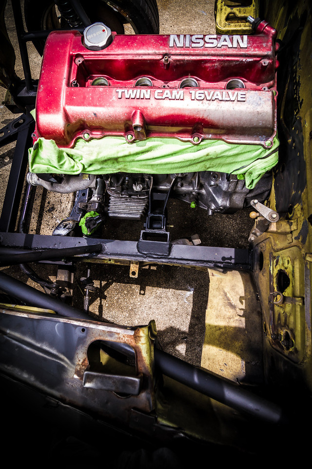

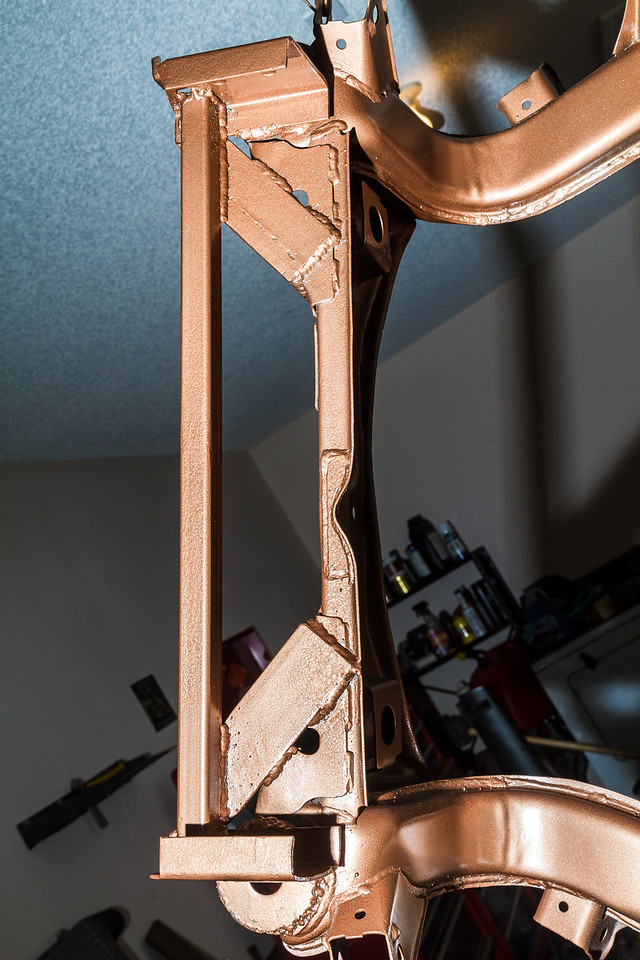

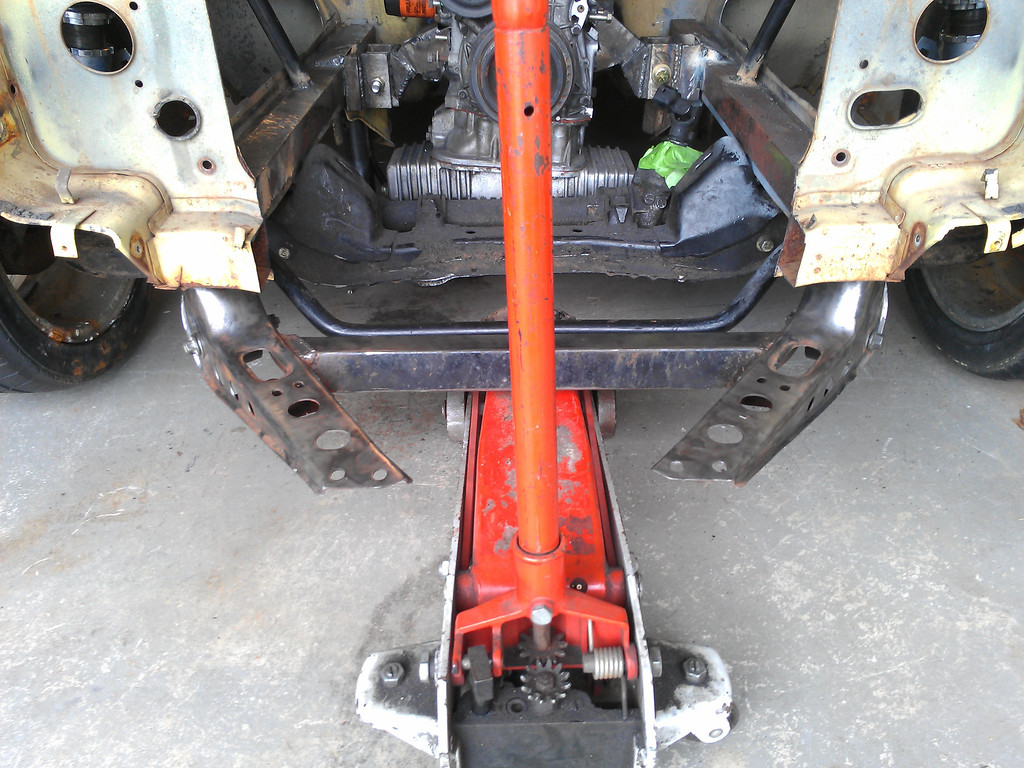

Another one:
and how the subframe is mounted.

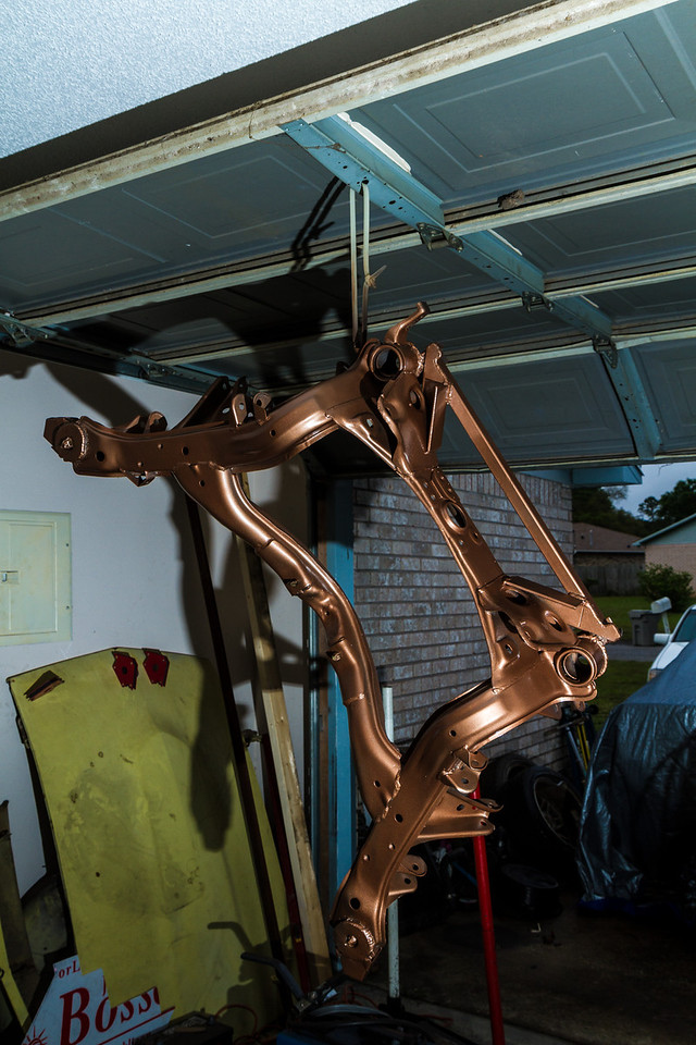

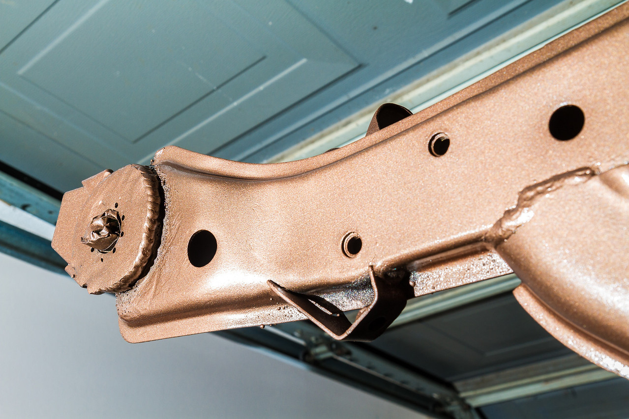

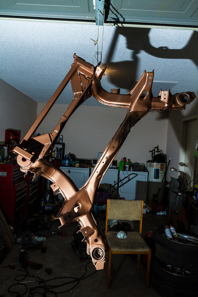

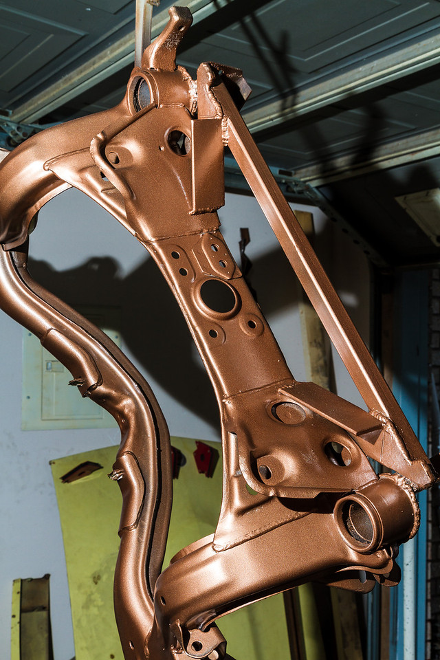

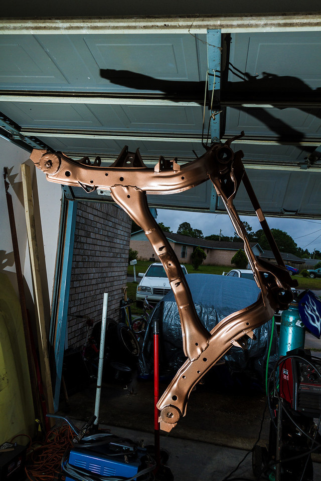

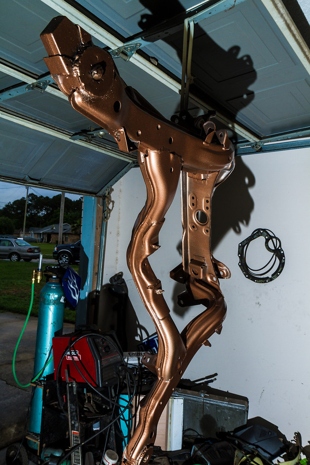

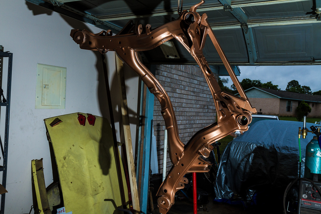

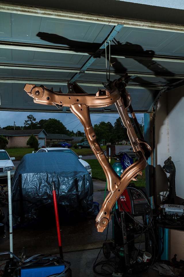

Rustolium Hammered Copper.

That color suits the subframe really well

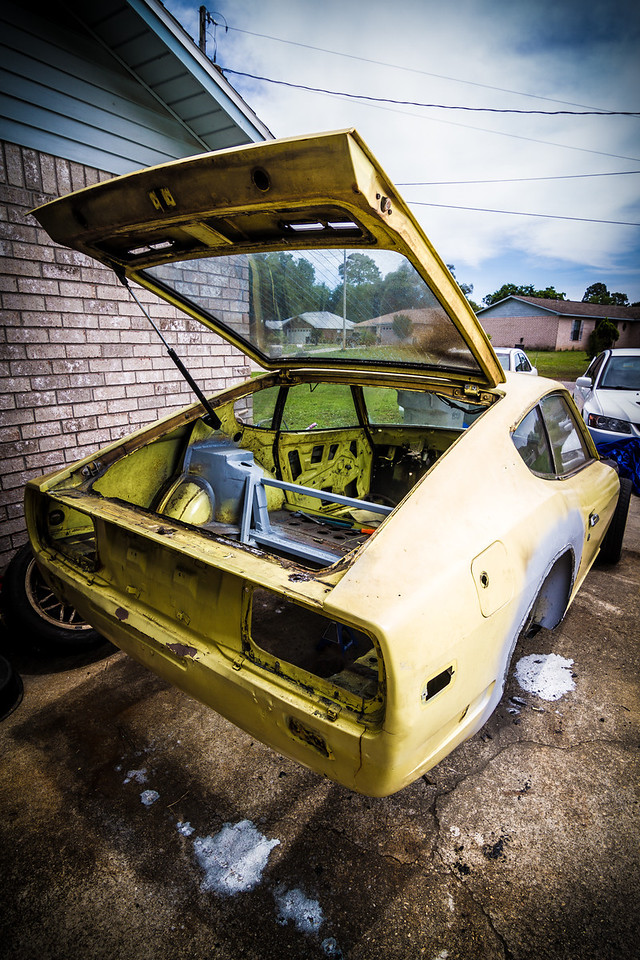

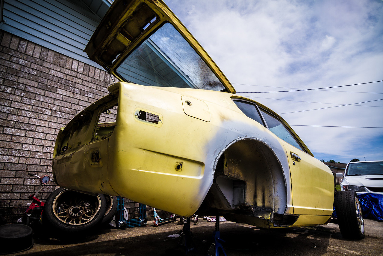

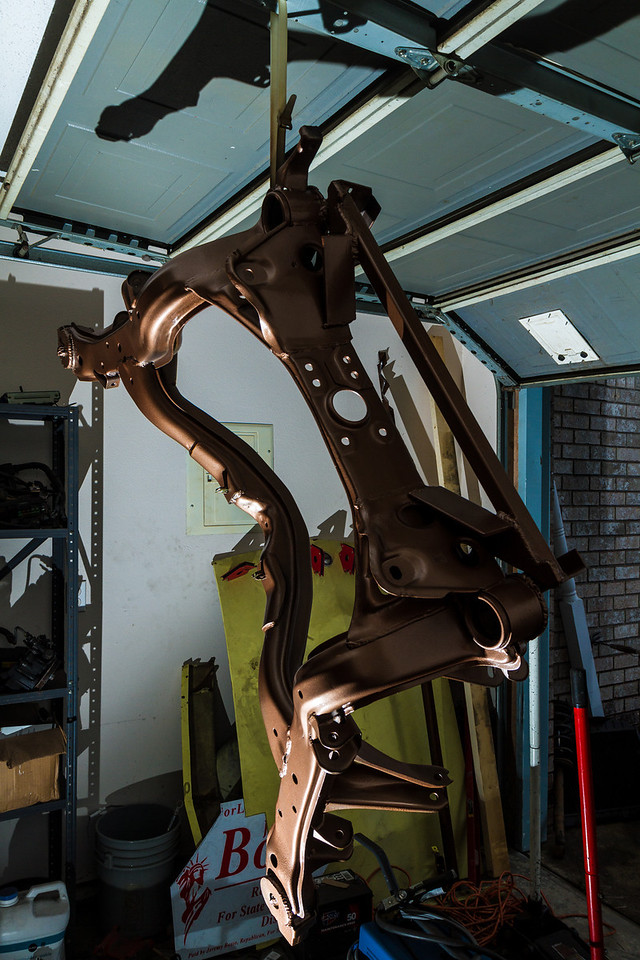

I mostly throw updates on my facebook build page at:
Here are the copy/paste from there:
Over the weekend...
- Welded some things on the subframe
- Wire wheeled the subframe
- Sanded the subframe
- Painted the subframe
- Repaired some more areas under the rear of the Datsun
- Seam sealed the majority of the front end of the Datsun
- Used some rustolium to paint areas on the front end to prevent rust from forming while it sits for a while longer.

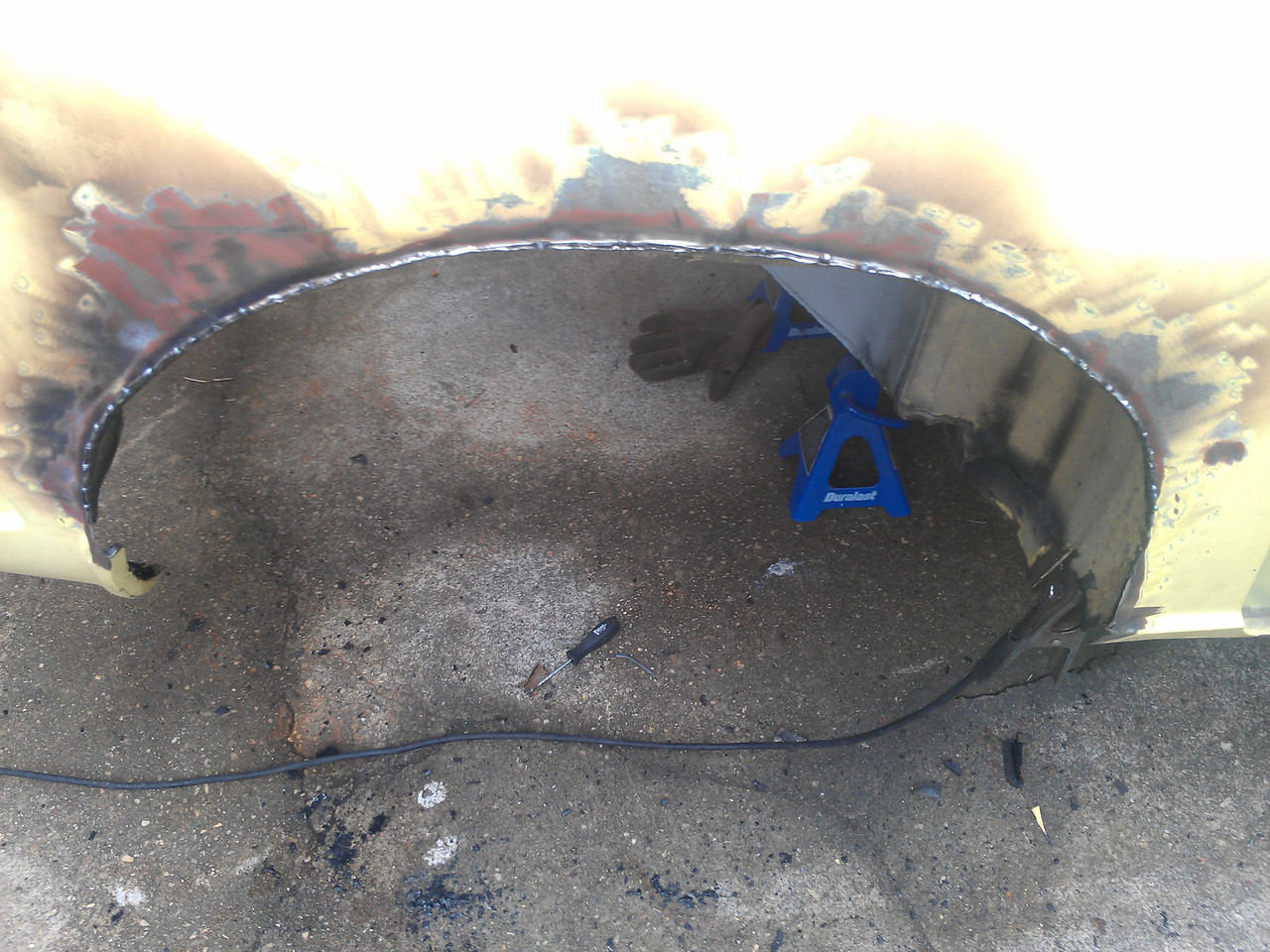

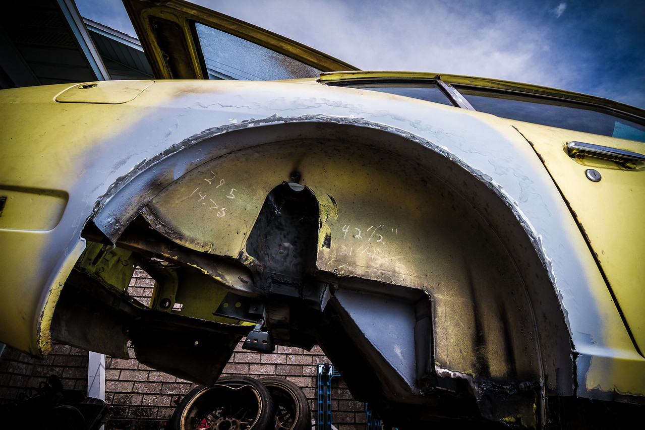

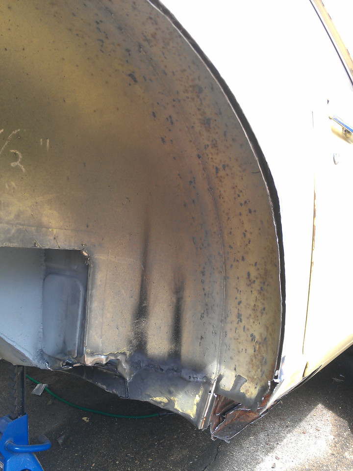

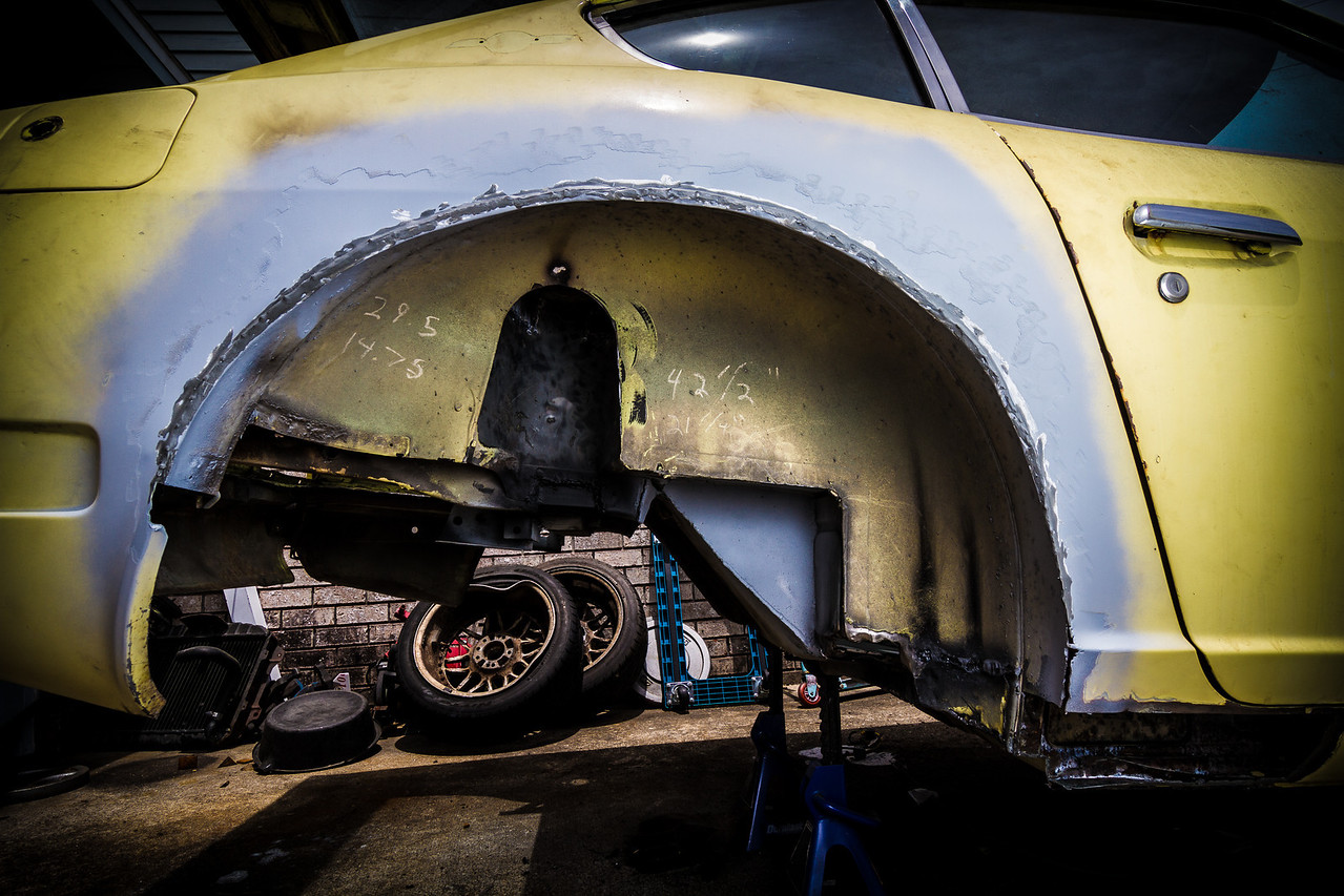

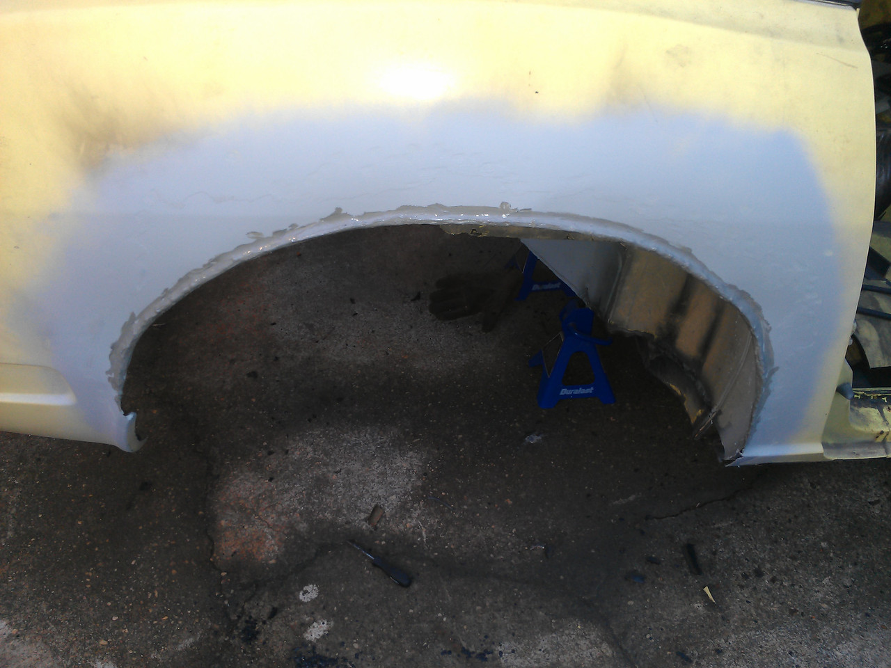

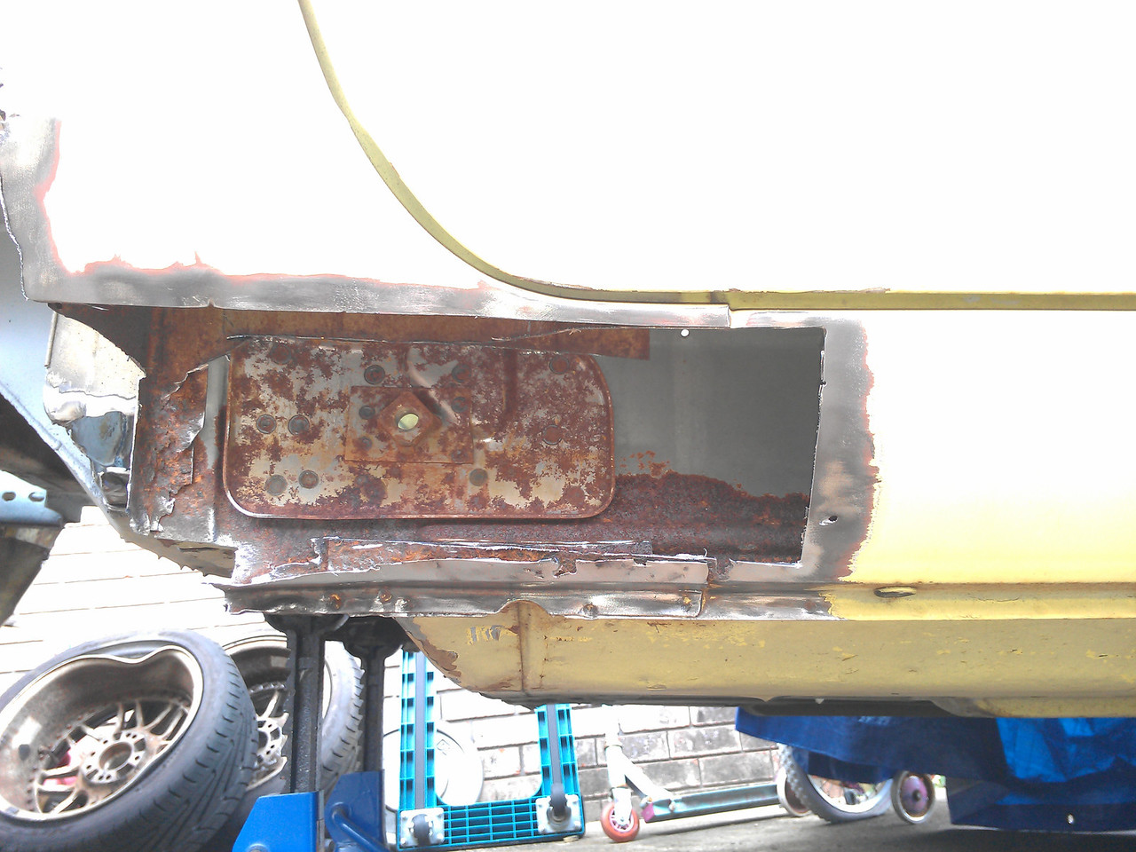

Last night I finally cut out all (or as much as I could) the rust on both rocker panels. That rust location is typical of these Datsun's anyway. Next I'll try and spray some rust prevention on both areas and then weld in some sheet metal. Hopefully it doesn't rain...
Grinding away rust on the cut fenders and the rocker panel...I tried to start tac welding the fender skin together when I noticed this rubber crap melting and contaminating the welds. I tried wire wheeling the stuff out, but that proved ineffective. So, I see my butane torch sitting there and decided I'd try melting it all out. It seemed like it was working and then I noticed a lot more smoke...hmmmm, yeah I started a fire haha. There was an old wire harness (that I don't even need anyway) that had caught on fire. Had to run inside and get a glass of water to put it out--all is well!
I melted as much of that rubber crap that was in between the fender skin as I could. Put a few tac welds all along the seam, then began to hammer it up into a lip all the way around. Once I got the lip where I wanted it, I took an angle grinder and shaped it. Then took some seam sealer and went all the way around it. It's not that important as it will have fender flares, but I wanted it to have a lip just in case.
Now hopefully tomorrow I will get the rocker panel patched up. Though all this work with the fender was only the right side...still have the left side to do too.

Very cool to see an extended wheelbase, that is rare.

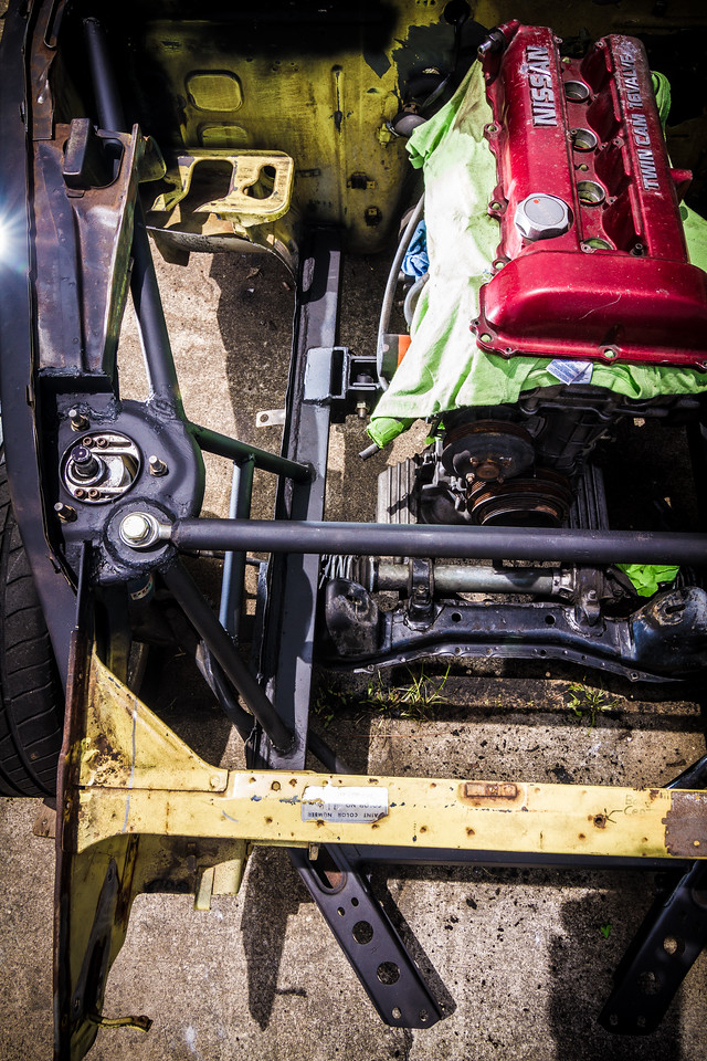

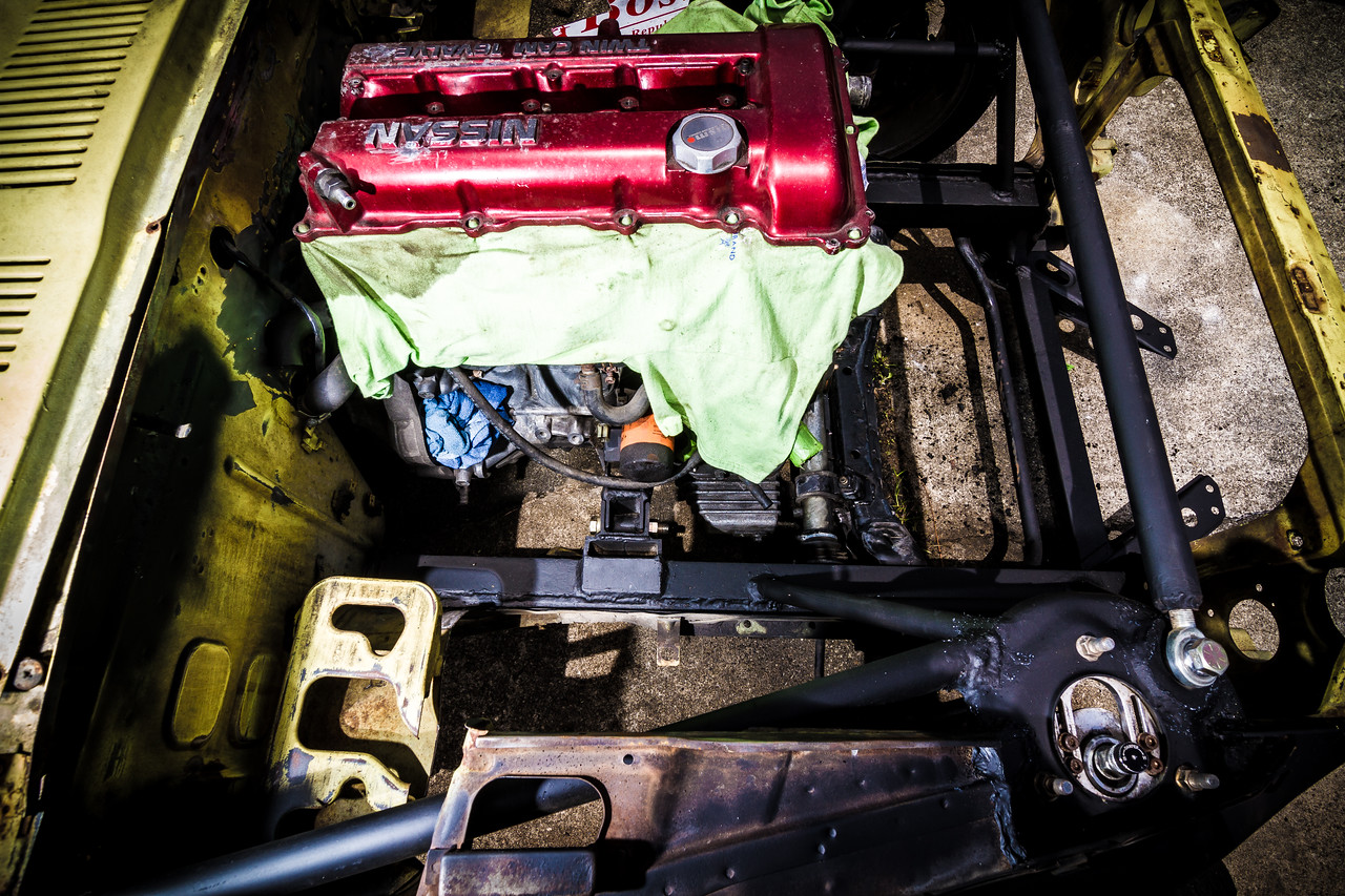

what did you do to those RUCAs? looks like you added bracing to an S14 RUCA
uraznfriend is offline   Reply With Quote
Old 05-16-2013, 10:35 PM   #29
I<3-SR20DET
Join Date: Dec 2009
Location: Toronto Ontario Canada
Posts: 135
I<3-SR20DET is an unknown quantity at this point
It might just be me but is there no caster built in to the front suspension?
The coilover looks to be straight up and down.

Made a transmission mount. Used the stock Datsun S30 transmission crossmember and modified it with some 1/4" steel.
You can always see the latest updates on the build page:
