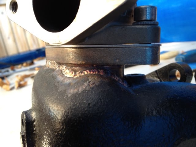

Originally Posted by nissanfreak317 View Post
Do you weld these yourself? Welding cast iron is not easy. I'm pretty sure it needs to be preheated pretty hot and special filler wire used. I'm guessing that you have done your research on this and weld it properly, right? Only asking because I'm interested in getting it done by you but was turned away by several shops when I wanted this done a couple years ago.
Cast iron is easy to weld...this isn't a structural piece, no preheating needed, no special wire needed. I've welded multiple GM cast iron manifolds into Turbo manifolds.
[/IMG]
Dude, I've talked to several seasoned, professional welders, and none of them would go near cast iron, it has a different chemical composition than steel.
Also, It doesn't matter if it's structural or not, if the weld cracks you're leaking exhaust all over the place.
I was just trying to find out what process is being used for this so that I can decide whether or not to give it a try.

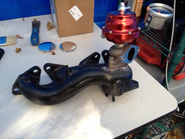

No my friend Jay welds these JPC Fabrication. I've sold about 15 of these so far with no issue, and Jay has welded countless other cast iron items at his shop. If it does break, you can ship it back, repaired and shipping will be covered on our end.
cool story....I've actually welded cast iron a lot, not talked about it....the weld will not break if the welder is good, in Cody's case, he has a great welder, so it will be fine. Cast aluminum is a bitch to weld, maybe you're thinking of that.....
Great, thanks!
Stop being a douche. I was asking a question and was looking for an answer. Not some smart ass responses from someone other than the vendor. I have experience welding, I have taken welding classes, and I know many people who have tried to weld cast iron and failed. I looked into having this exact process done to my own manifold in the past and was turned down by local welding shops. I was curious of the process that they used, not trying to cause trouble, I know it can be done but I also know it's not as easy as you are making it out to be. And also, stop being a douche.

Just for the record, I answered your questions....in a respectful manner, then YOU gave a smartass response...if you already think you know, why ask? I'm done cluttering Cody aces thread. Sorry man.
