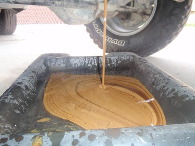

Does this look like blown head gasket?
tristan89 is offline   Reply With Quote
Old 11-30-2014, 10:40 PM   #39
tristan89
Join Date: Jun 2014
Location: Bend Oregon
Age: 24
Posts: 82
tristan89 is an unknown quantity at this point
Blown head gasket? That is 15 minutes after changing oil, drove about 5 miles to drop my girlfriend off
Old 12-01-2014, 10:23 AM   #40
jr_ss
Location: Pa
Posts: 6,052
Trader Rating: (34)
Feedback Score: 34 reviews
You have coolant and oil mixing. Typical culprit is the headgasket, but there are other areas that could cause the contamination. Start with the headgasket, it could probably use a refresh anyway.

how are your pcv and oil catch can set up?
there is nothing wrong with enjoying the build. however, we sometimes have to remind ourselves that the build is only one part of the puzzle, and that ultimately - enjoying and driving the car is the number one priority.
blksylv is offline   Reply With Quote
Old 12-10-2014, 04:13 PM   #43
tristan89
Join Date: Jun 2014
Age: 24
Posts: 82
No oil catch can, and pcv is stock I believe

My pcv it T fitted into the line that runs across the firewall to where the brake fluid is and goes into the intake manifold
Old 12-10-2014, 04:37 PM   #46
tristan89
Join Date: Jun 2014
Age: 24
Posts: 82
Also where the pcv connects to the valve cover is where the milky ness is

pcv is supposed to run to a vac line off of the intake manifold. do you have the stock catch can still plumbed in? reason I'm asking is that I had a friend that put a breather on his pcv valve and had the same issues that you had. he ended up with greenish residue in his aftermarket catch can also. here's a pic of how the stock system is setup.
Old 12-10-2014, 05:47 PM   #48
fufanu180
fufanu180's Avatar
Join Date: Dec 2009
Location: Austin, Tx.
Posts: 481
fufanu180 is an unknown quantity at this point
Yeah that oil cap pic is a solid sign that you are having issues with the head gasket.
I did a napa oil text the one you send in to their lab, it said I have no coolant in my oil but there is milky stuff on parts of the top of my valve cover.... What in the wold could this be from?
Hold up... BULLshit? Your condition is clearly oil and water/coolant mixing. How/where else is your oil going to be contaminated by water than from your cooling system...

Here is what I saw, this guy said his oil was milky. Do not run an engine with milky looking oil, period, I dont care how the water got in there.
What a mess. You cant just replace the headgasket and slap it back together in it, fill it, and run it now. that milky coating will remain on everything inside, its like whipped cream.
You can try the multiple oil change routine but... I have my suspicious thought that engine may spin a bearing if you arn't careful how you proceed. You will need that motor to hit 215*F+ and hold it there to try to force the water to all evaporate. You may need some kind of accessory vacuum pump to assist the pressure drop in the crank case to help the water evaporate. The problem is the oil is emulsified in it, that will be the challenge. Yes the more I think about it, the more I think you need to lower the pressure in your crankcase, even if the engine is off, to get that water out. Perhaps an overnight vacuum pump running at just a few psi with respect to the atmosphere. My best chemistry guess, someone else has any experience with this?

coolant in oil is what your 1 picture appears to be change head gasket. but it seams you are having problems removing rockers off the head i have a hard time believing you will be able to replace the head gasket and install everything correctly to spec. just my 2cents if you don't know what your doing take it to a mechanic or be prepared to pay to teach yourself sometime you dont get it on your first try

I think the reason the HG blew was some of the coolant Chanel's were rusted shut on the HG so it creeped into the cylinders
