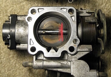

Rad. Now THOROUGHLY inspect the rod that the screws go into. Front and back. That is the part that breaks. On the SR, there isn’t really a stop for the gas pedal, and many throttle cables are not properly adjusted, so the throttle body reaches its max, but the gas pedal still has room to go, so all that stress pushes against that one little rod, then eventually the rod breaks, allowing the screw to fall out.
It’s not so much an issue of the screw just backing out on its own.
I guess I should have done a better job explaining earlier.

The rod breaks where the red line is drawn. That allows the screw to come loose.
Will do, thank you for the tips and picture!
So to avoid possible damage when it break, you tack the screw to that rod from the direction of your picture?
We removed one of the screws and welded the hole so the rod is now welded directly to the plate, then removed the other screw and did the same thing.
I guess that would be safest lol but I only have a mig
