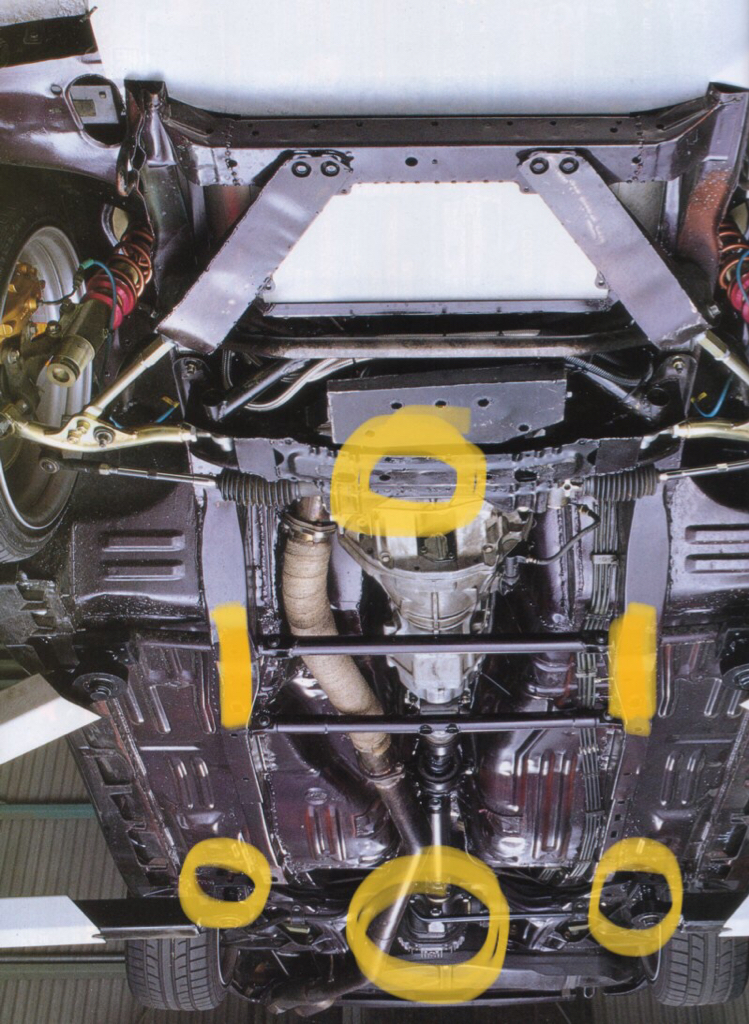

Jack points, rusted through
These are the only points I’ll use to jack my car up (or tow hooks, but my aero is in the way)

Thank you all for the answers!
I probably should have added that I got a S14a. ![]() So if I use my diff for the jack, the widest part of the subframe is probably a good idea for my jack stands? Right where the bushings is at. ![]() |
#11 |
![]() Join Date: Nov 2015
Posts: 887
![]() ![]() Feedback Score: 6 reviews
You could put jackstands onto the subframe bushings closest to where you have circled. For the front, the only safe spots I would say are the safety stand points outlined in the manual in your photo.
