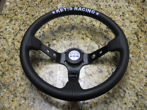

I purchased a new wheel:
KEY!S Racing, 330mm Deep Dish, Suede. It will be here in about 6-8 weeks.
