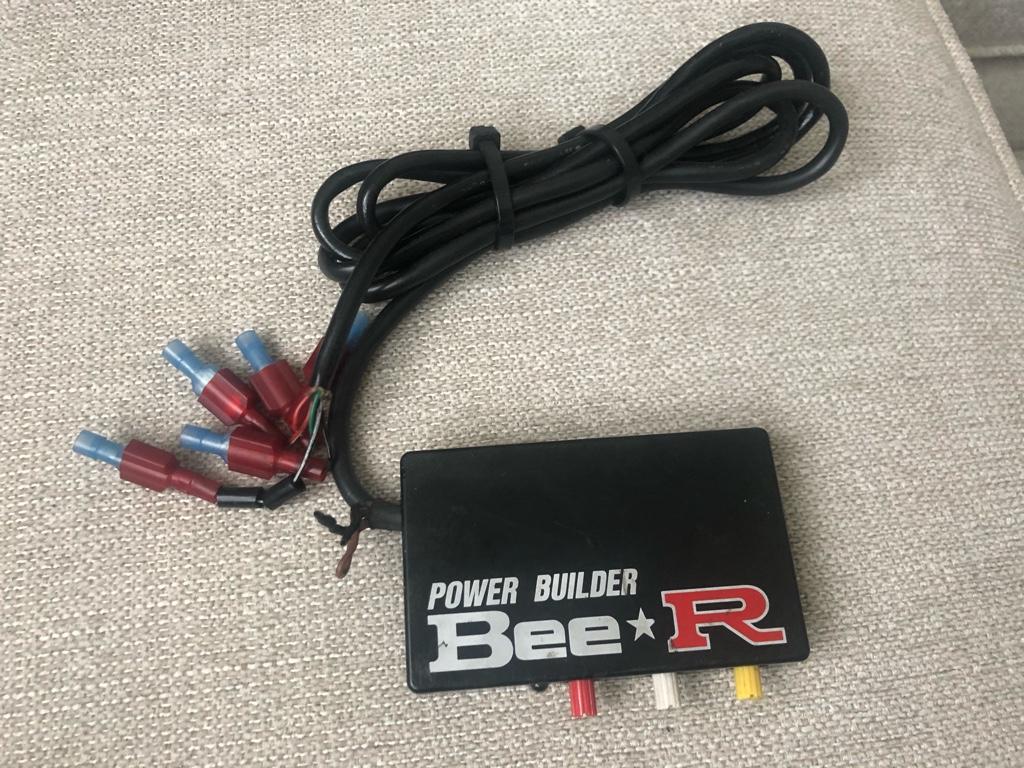

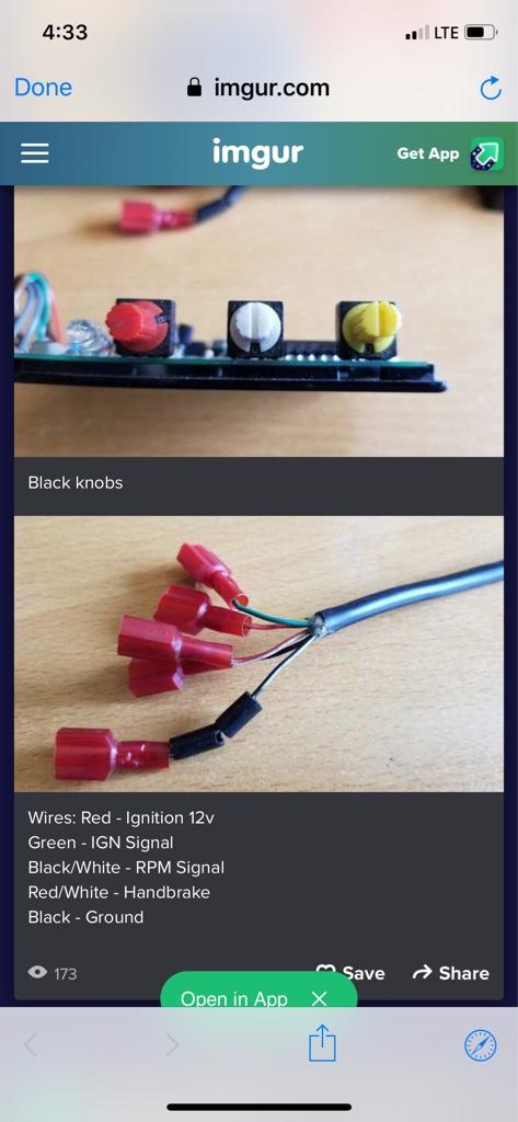

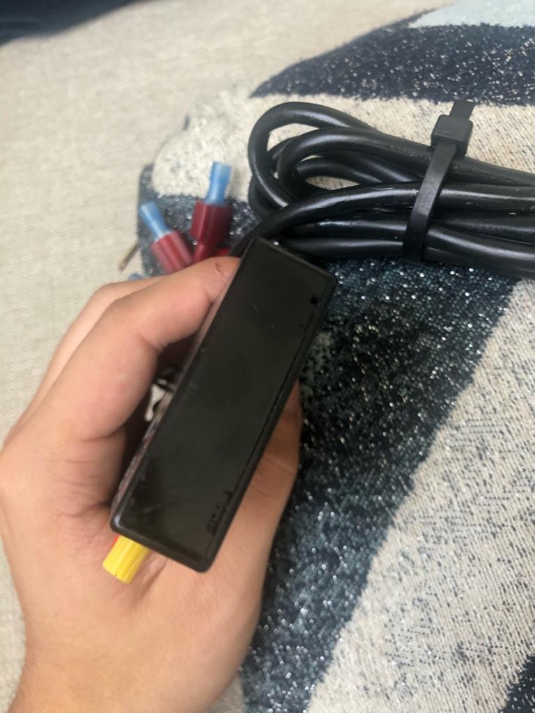

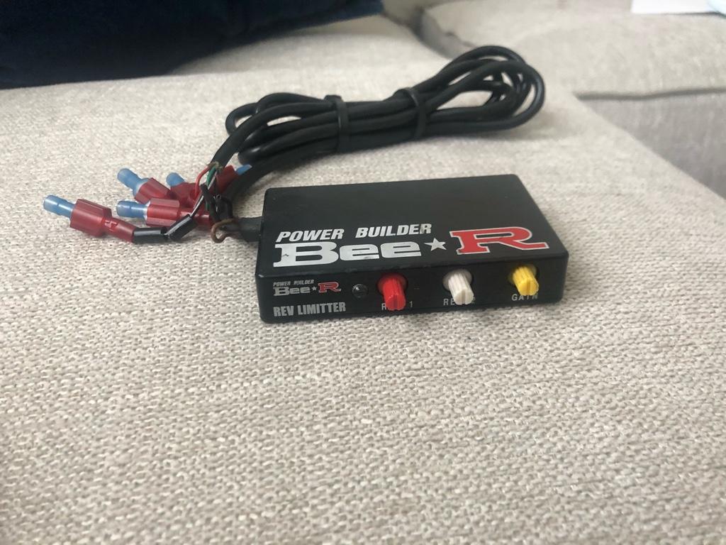

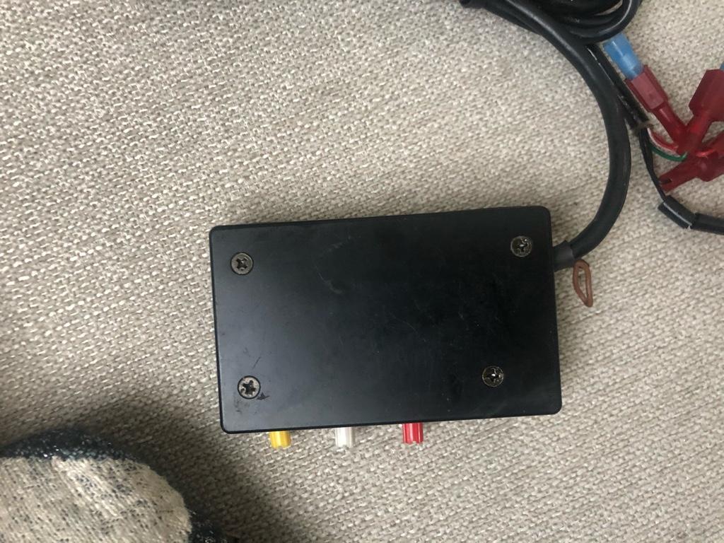

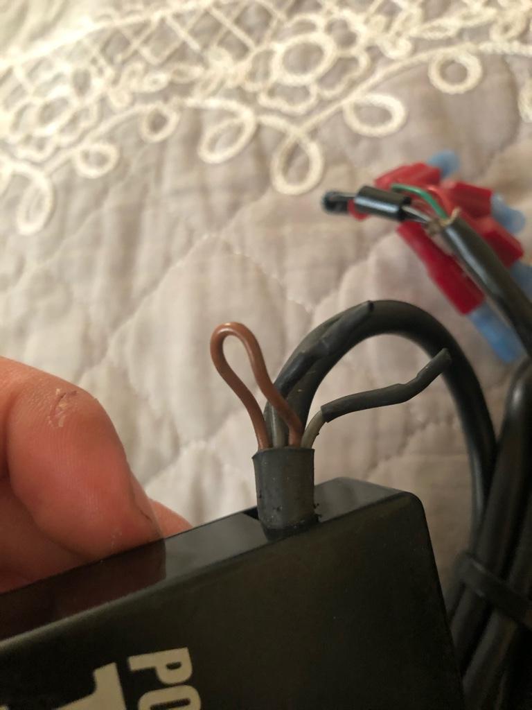

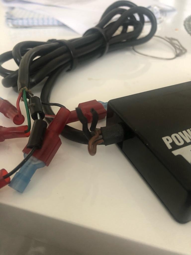

Can anyone verify if this is a legit unit? Everything seems to check out for me (asides from the wiring, prev owner altered) but would like to make sure before selling, thanks.
![]() ![]() ![]() ![]() ![]() ![]() ![]() Sent from my iPhone using Tapatalk Last edited by brokeboi01; 11-14-2020 at 03:16 PM.. |

yeah its fake. you can tell by the wire sheathing. Legit ones use a matt finish and have the information (for temp ratings, and wire gauge, other accreditations) printing in white. That one has shiny black case, and the information is melted into it.
pic for reference. ![]()

Damn that sucks but thanks for the info Sent from my iPhone using Tapatalk |
