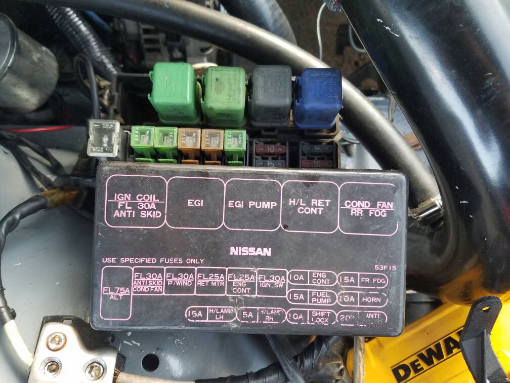

So car turns over fine has plenty of gas flowing to the rail but won't start. Just constantly turns over. Get to looking under the hood to see if there are any connections I missed. Don't see any so look under the engine Fuze box and find that according to the diagram I'm missing either a relay or a 30amp fuse. Idk if it's suppose to be there though cause I don't see any wires or even a plug for a relay or a spot for a fuse. Please anybody

Your fuse box is normal, so check all fuses and test relays.
