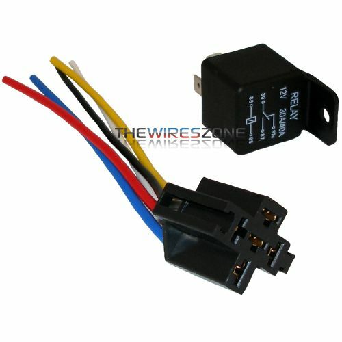

the new relay is wired in all is good but something odd happened a few times today,when turning the key "off" completely the starter engages for a second making the grinding sound then shuts off? I think the few times I started it without the relay a few weeks back did indeed damage the ignition switch why else would random power go to the starter when turning off key and this does not happen every time...Also is this relay sufficient enough for the starter amp draw?its a ebay special 12v dc 30a/40a relay?

Can I ask why you'd buy/use an eBay relay when 4/5 prong 30/40A relays are sold almost everywhere?
Are you aware of how a relay operates with the pole and coil inside?
