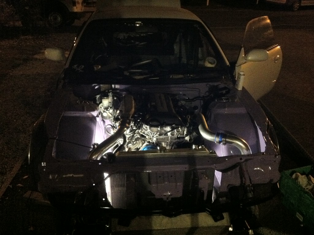

Now that i know the car actually starts/works i am LOVING working on it again, it can actually start going back together and i can start doing the 'fun' bits, shit, i hoovered it out the other day! felt like a milestone! a far cry from cutting the front of the car away.
anyway, over the weekend iv been going over the car tieing up loose ends mainly; sorting the trim out in the boot, routing the battery cable and earth stealthly and securely, tucking bits of the engine loom, tightening up engine mounts etc etc etc
The hockey puck engine mounts feel good too, the car whole car vibrates, i love it, feel solid, feels like a full on race car haha

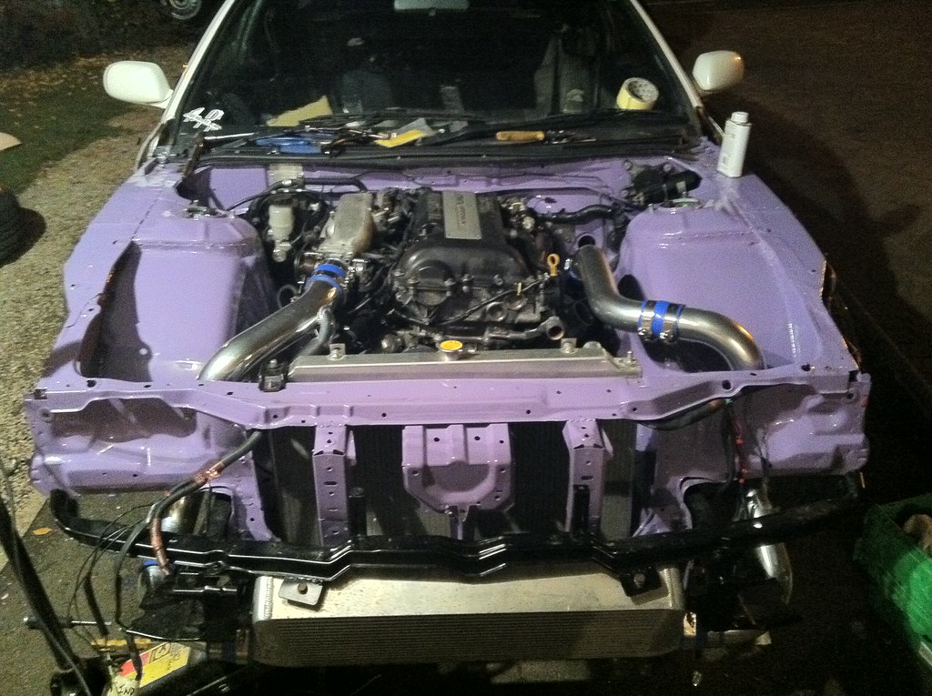

the only 'big' thing i got sorted really was fitting the charge pipes, also figured out where/how im going to mount the washer bottle, probably going to use the rear sprayer as a IC mist spray but all in good time.
a couple pics;

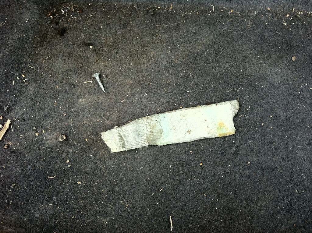

oh yeah, I found a used JDM plaster i found when taking out the rear interior:
Im going to lick it in hope of being more JDM.
pipes:
I was using the lead light while tightening engine mounts, thought it looked cool:
Oh yeah toe arms STILL not here

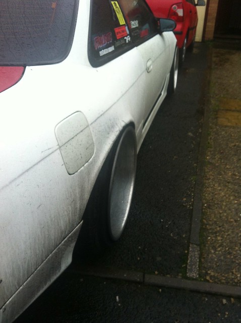

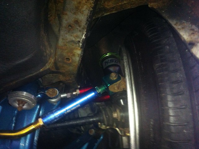

I'm trying to lower my car some more but I'm having trouble making the rear wheels tuck, they are 12.25J, I'm not sure of the offset.
I was running like 4.5 deg camber with a slip on spacer (9mm) then I had the alignment redone, taking the rear down to 0.45deg, I had to take the 9mm slip on off so the tyres would clear the arch, but then the inside of the wheel would rub the coilover when the suspension was loaded, so I put a 5mm slip on to prevent that, but now the tyre rubs the arch like fuck.
In short, is there anyway of moving the coilover further back? I want to tuck but I don't want anymore than like 1.5deg camber on the rear, which I don't think is going to happen unless there is a way of moving the coilovers further inward.
I'd love to hear from anyone that's tucking 12j's

Old 11-20-2012, 11:53 AM   #143
tricky_ab
tricky_ab's Avatar
Oh man...that rust...
Oh and Final Boss posts the realness on Facebook...
*Respek Knuckles*
Old 11-20-2012, 02:32 PM   #144
ezza
ezza's Avatar
Join Date: Aug 2010
Location: UK
Posts: 518
ezza is an unknown quantity at this point
I know, the flash really highlights the rust there, looks like nothing a good wire brush wouldnt get off, then underseal.

Old 11-20-2012, 04:51 PM   #146
ezza
ezza's Avatar
Join Date: Aug 2010
Location: UK
Posts: 518
I thought about that but would the new holes I'd need to drill be too close to the existing holes?
ezza is offline   Reply With Quote
