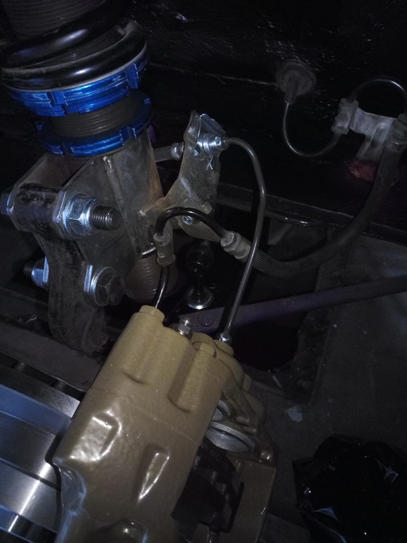

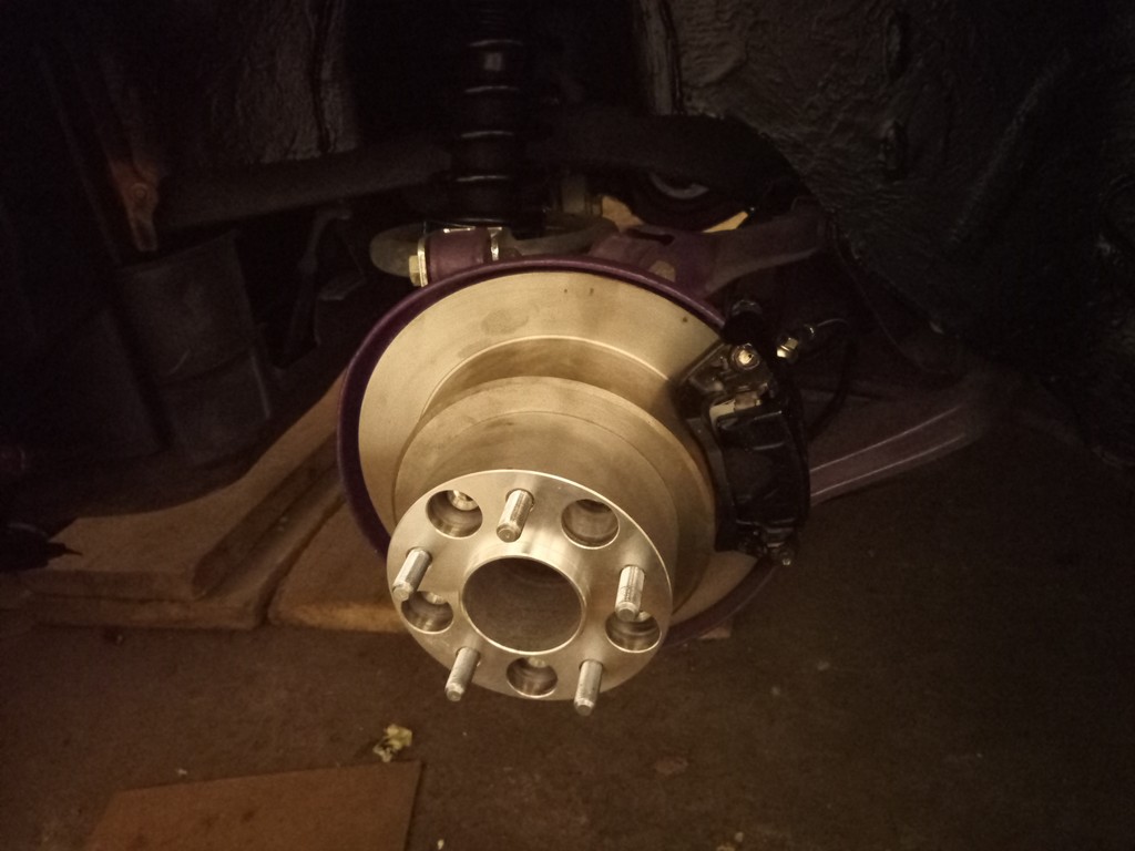

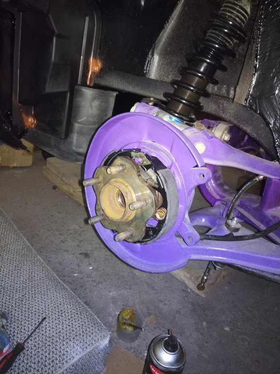

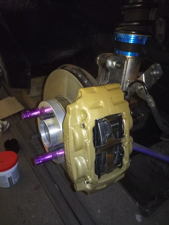

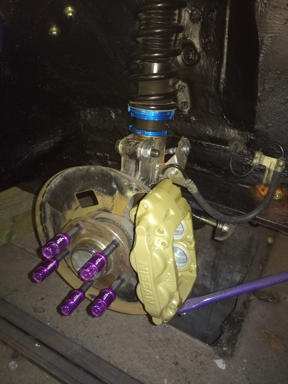

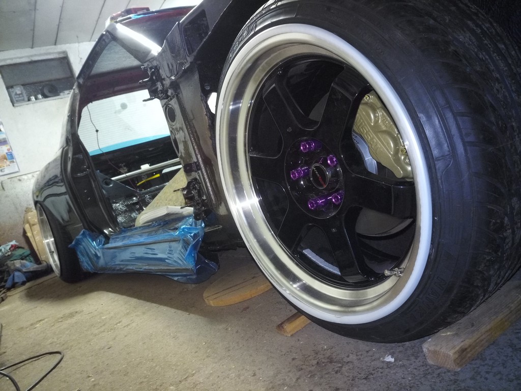

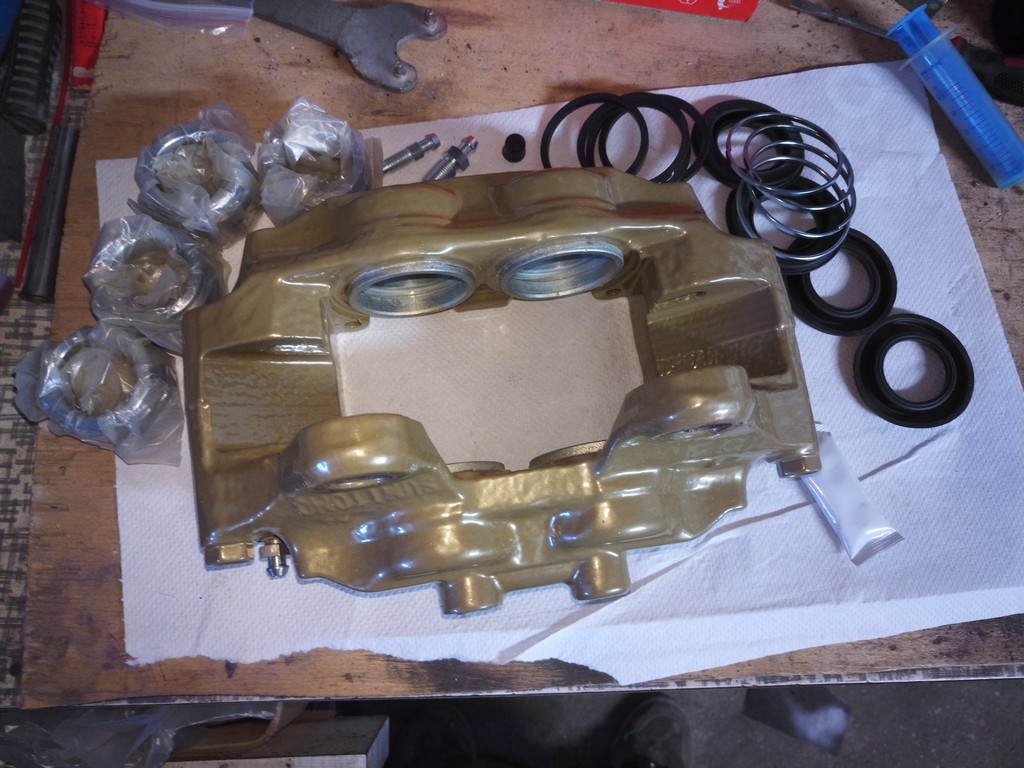

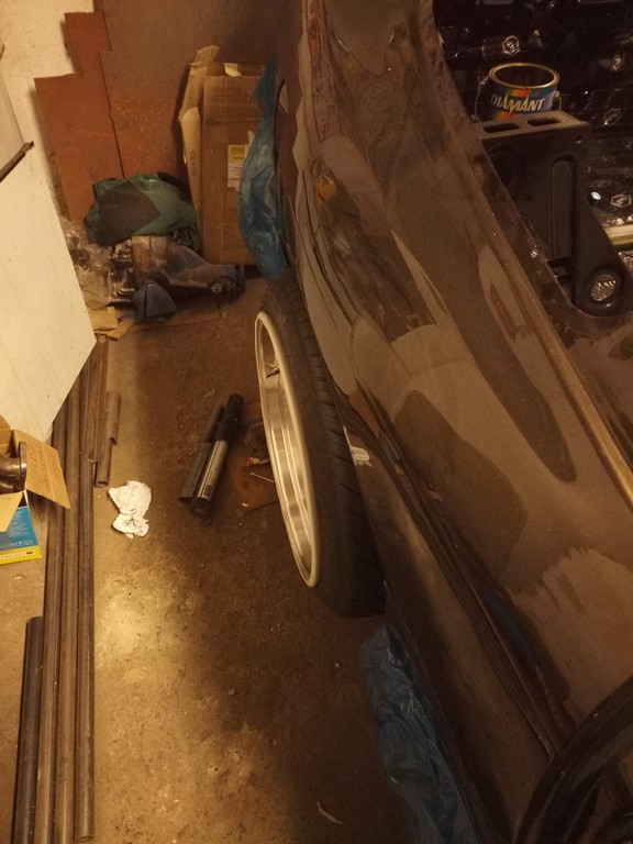

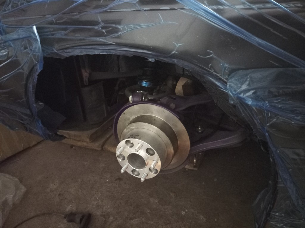

Thanks for the comments, these words are inspiring me. I know I am posting pics occasionally but I don't have too much time for the project, only a day per week. But there is some new pics now, I need to finish the rear brakes on boths sides and i am also working on the custom front arms, to fit 39mm ball joints.

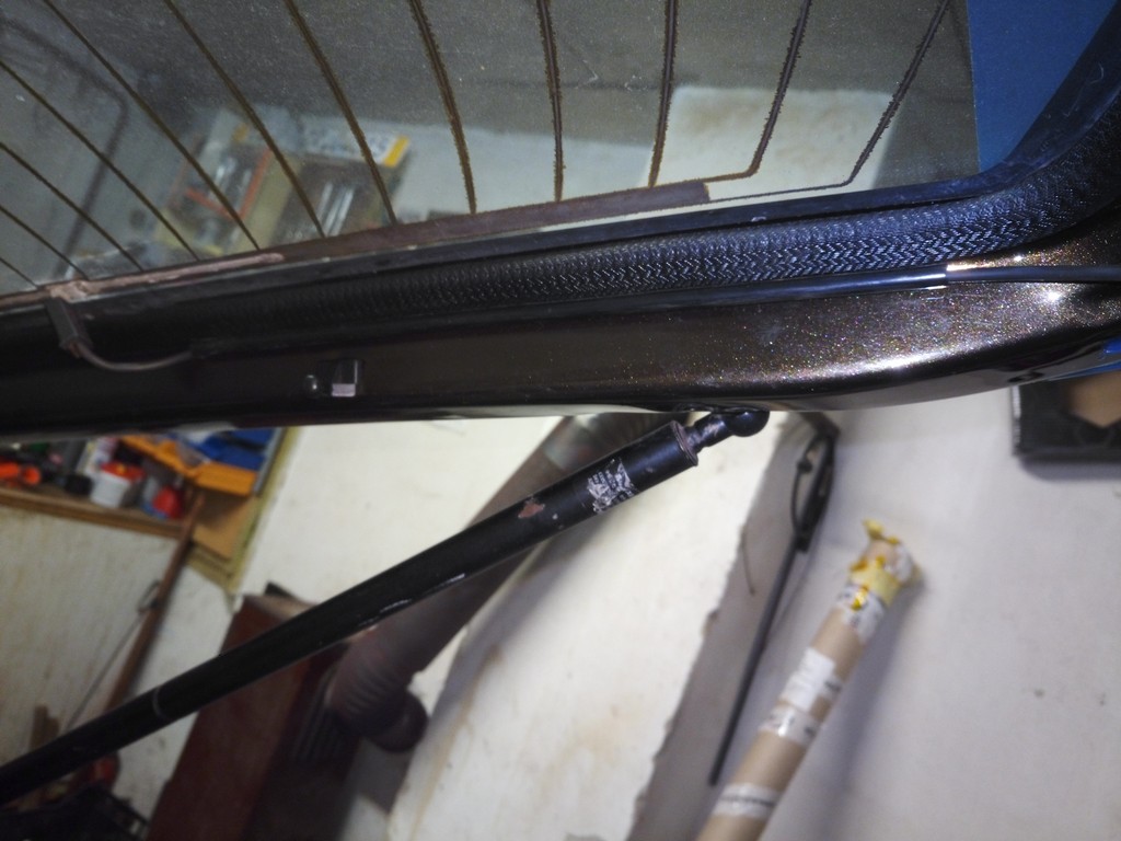

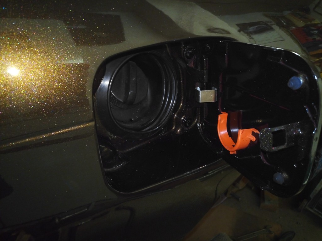

Parking brake is working on this side with refurbished brake shoes ![]() Testing the 60mm spacers ![]() ![]() I think it works perfectly with little more negative camber ![]() Gasdoor on the place ![]() Details... ![]() Diy glass board ![]() |

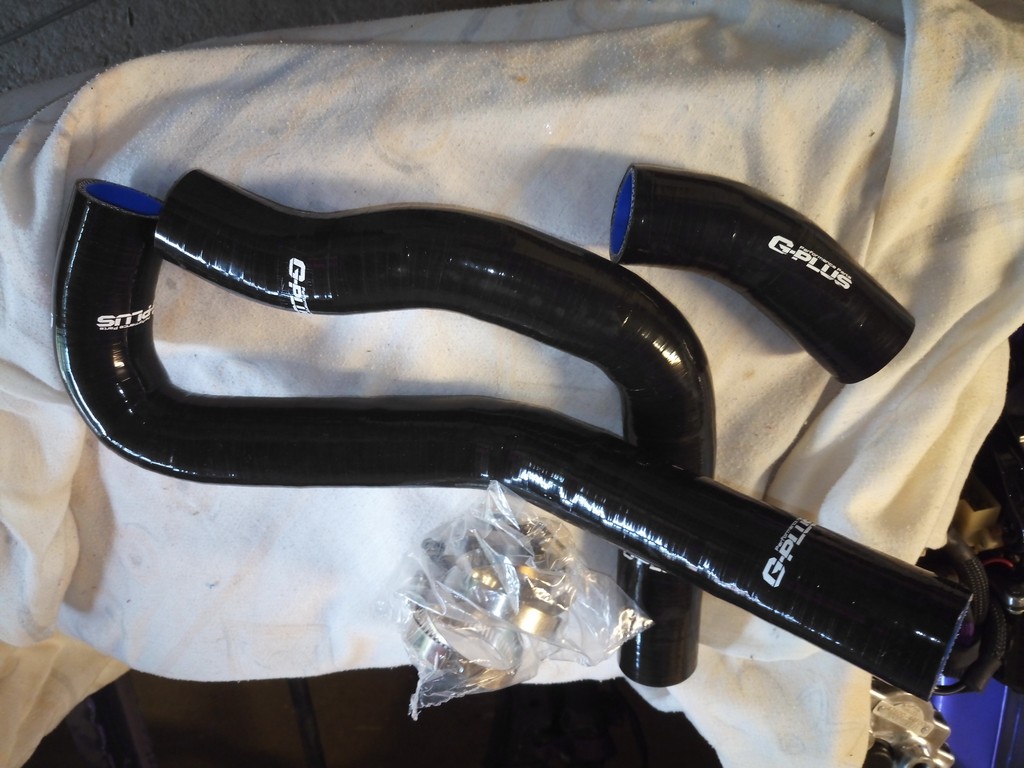

BTW the black water hoses arrived ![]() |

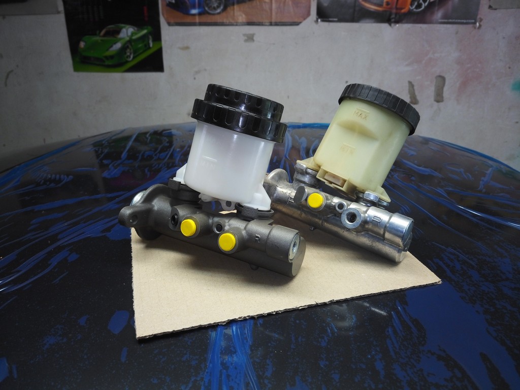

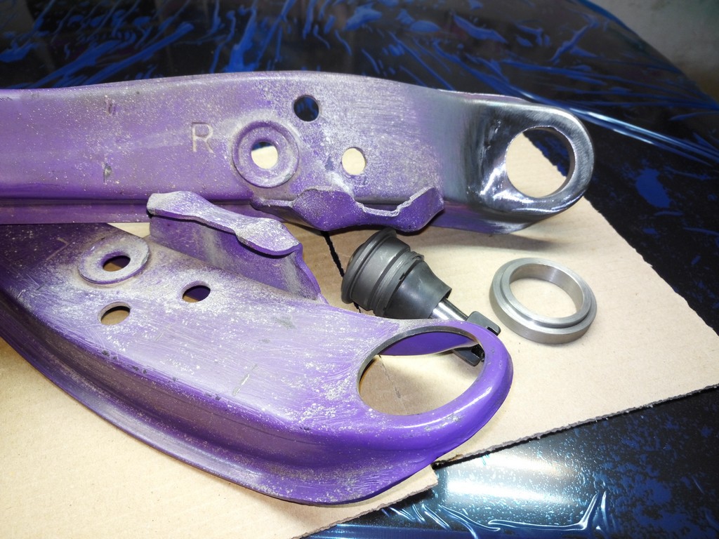

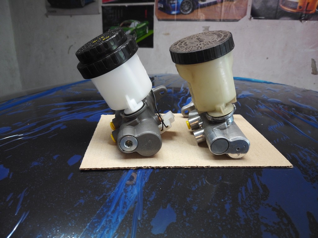

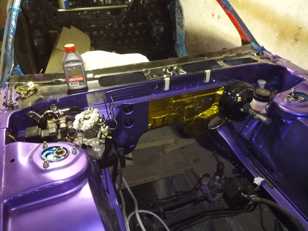

Modified front lower control arms for ball joint with different diameter for s14 hubs. Carpartshops there has bad catalogues but has ball joints for good prices with bad diameters, so I fixed it like this. ![]() And the new 300zx aftermarket brake master cylinder is arrived from USA ![]() ![]() ![]() |

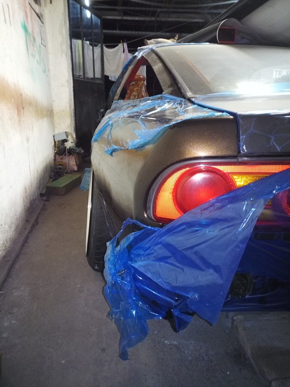

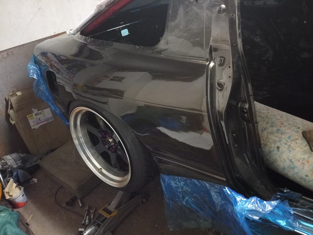

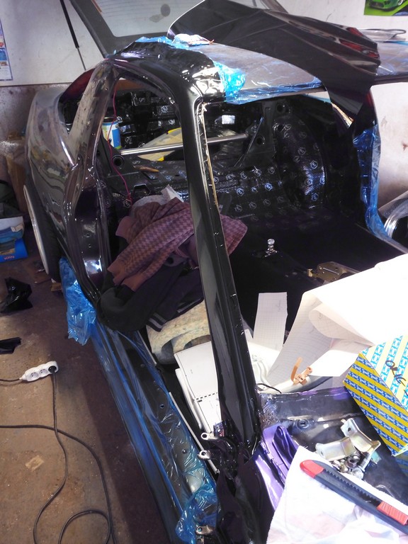

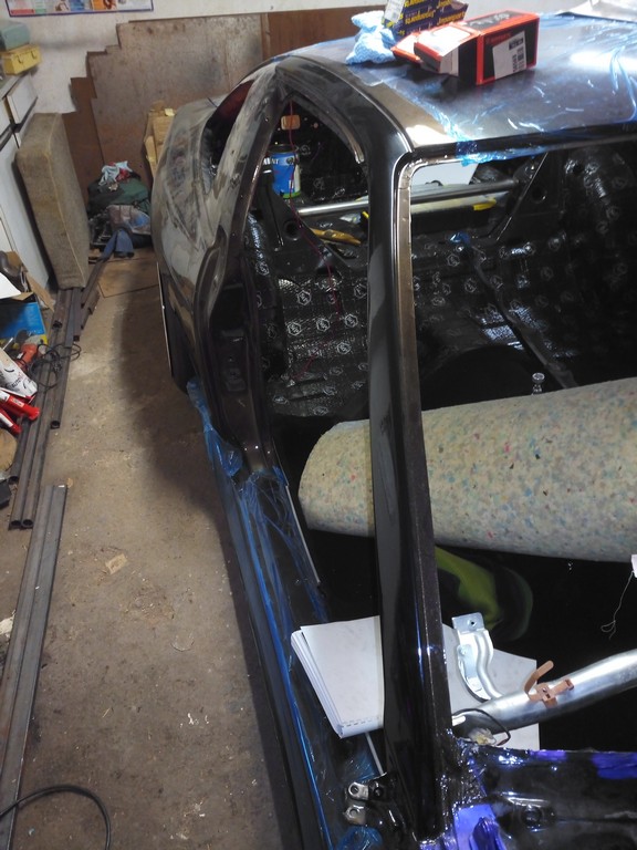

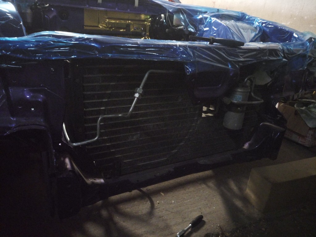

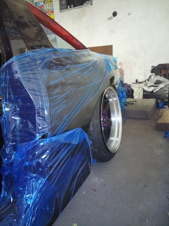

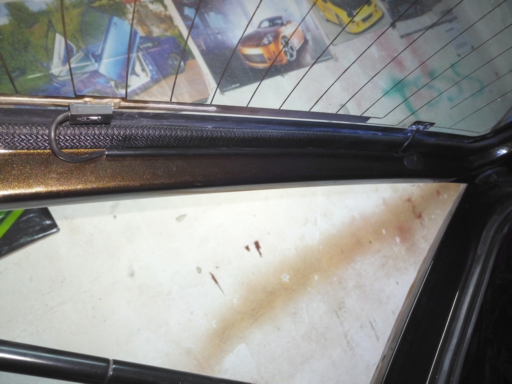

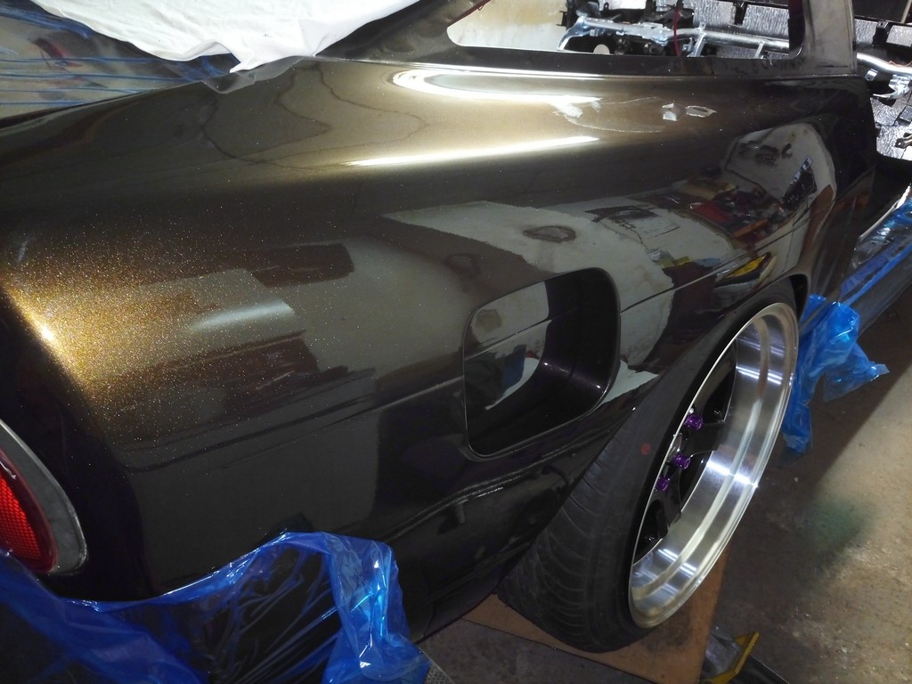

Wrapping the body like oem.
![]() Testing WrapCut https://youtu.be/AWaKXRl3zW0 Last piece of brakelines are finished. ![]() |
#137 | |
Join Date: Feb 2014
Location: Slovakia
Posts: 83
![]() ![]() ![]() ![]() ![]() ![]() Feedback Score: 0 reviews

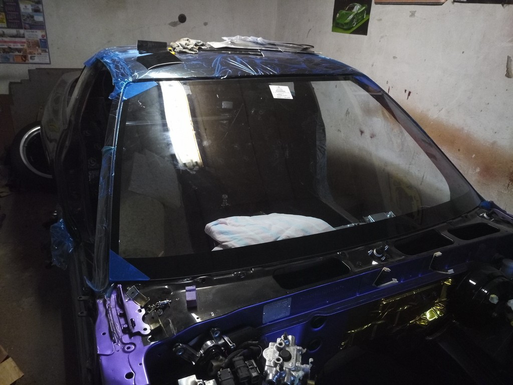

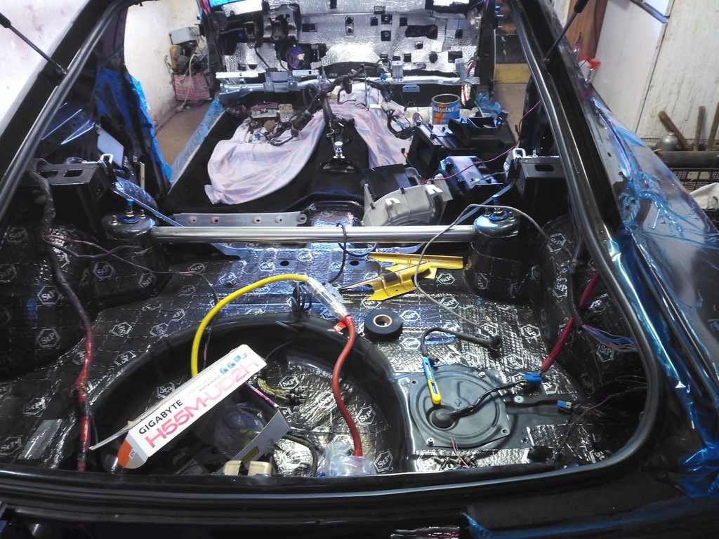

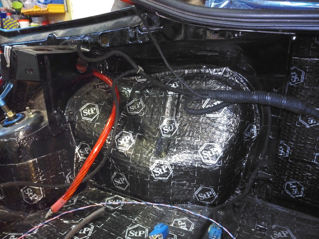

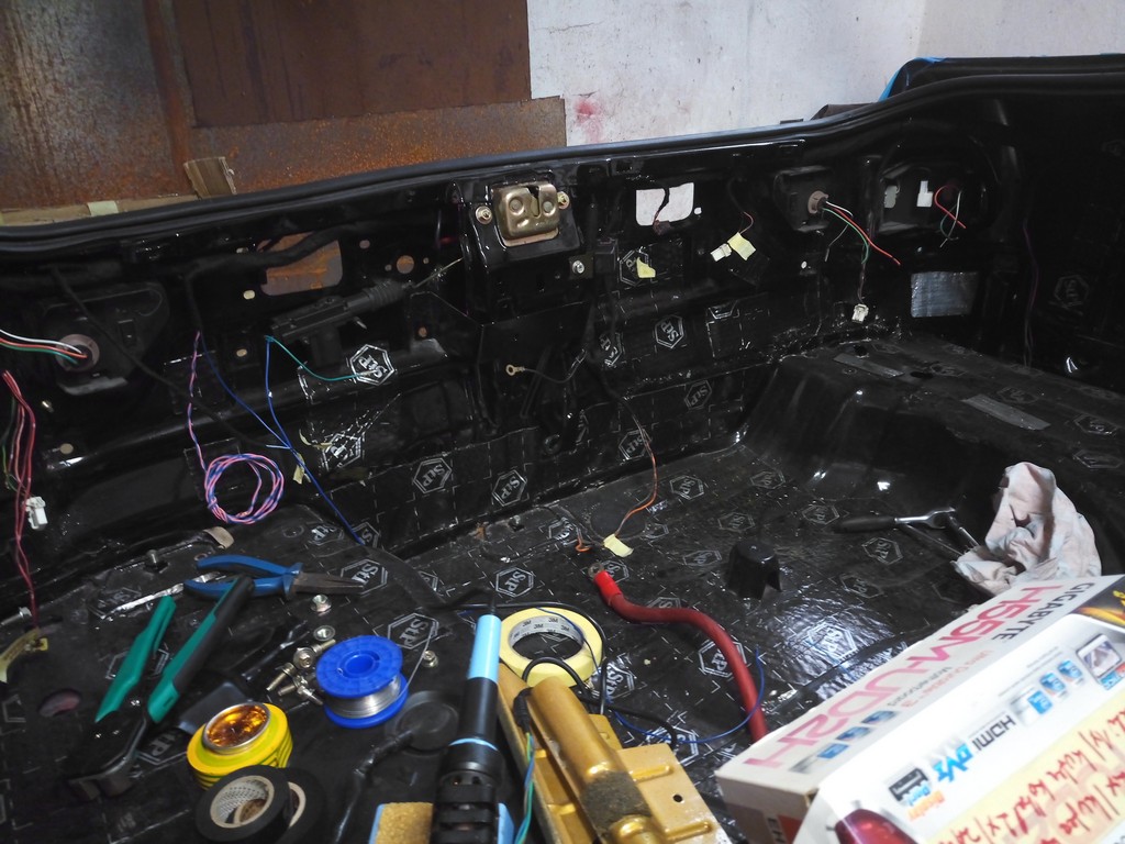

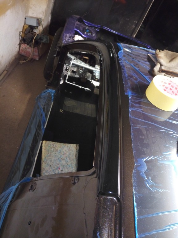

In my look it's not the best, but big thanks. The wrapped parts are looks like oem I think. The quality of the wrap its not the best ![]() ![]() ![]() Details of trunk hood wiring ![]() ![]() Next step: installing rear quarter windows... ![]() |

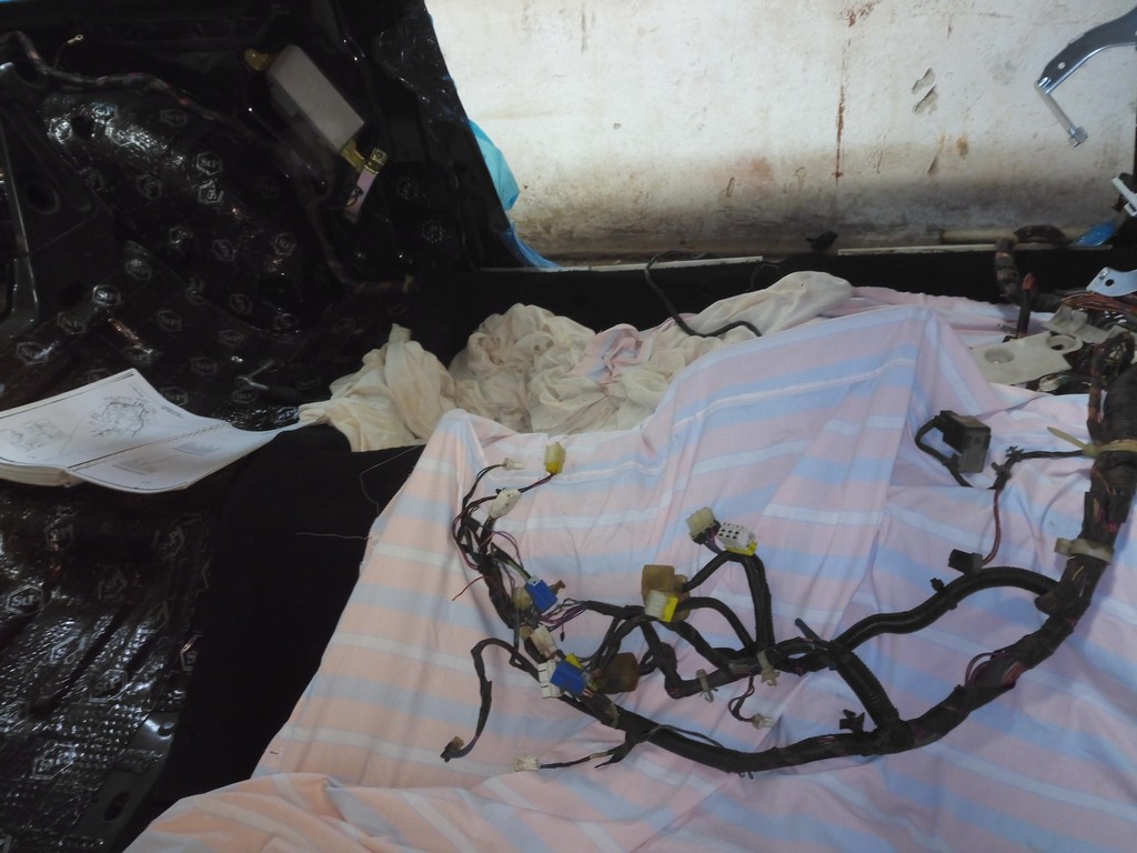

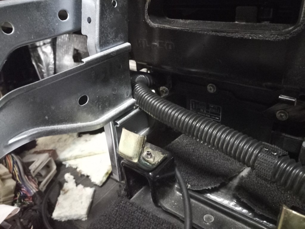

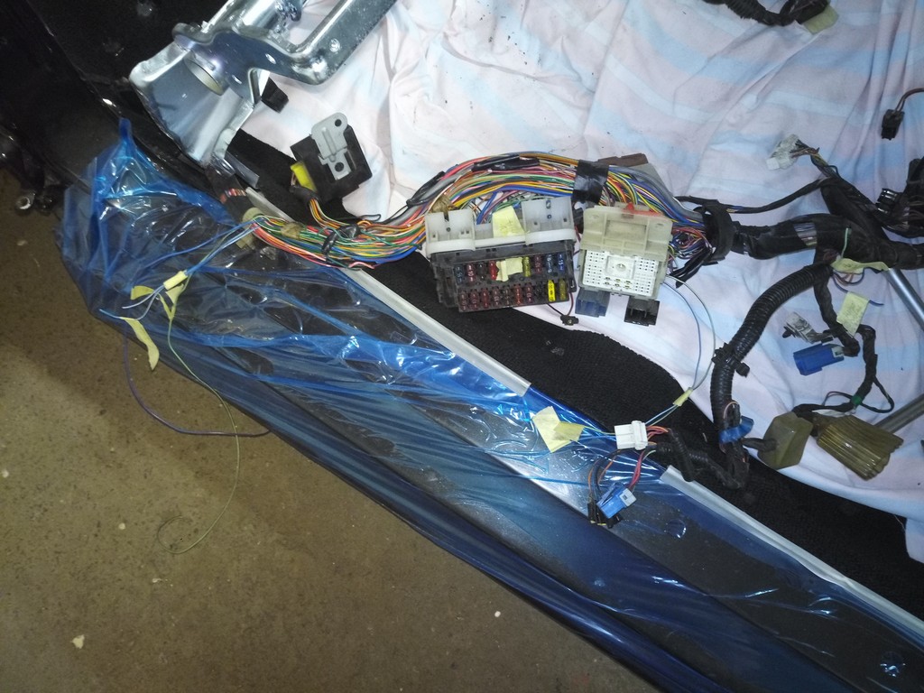

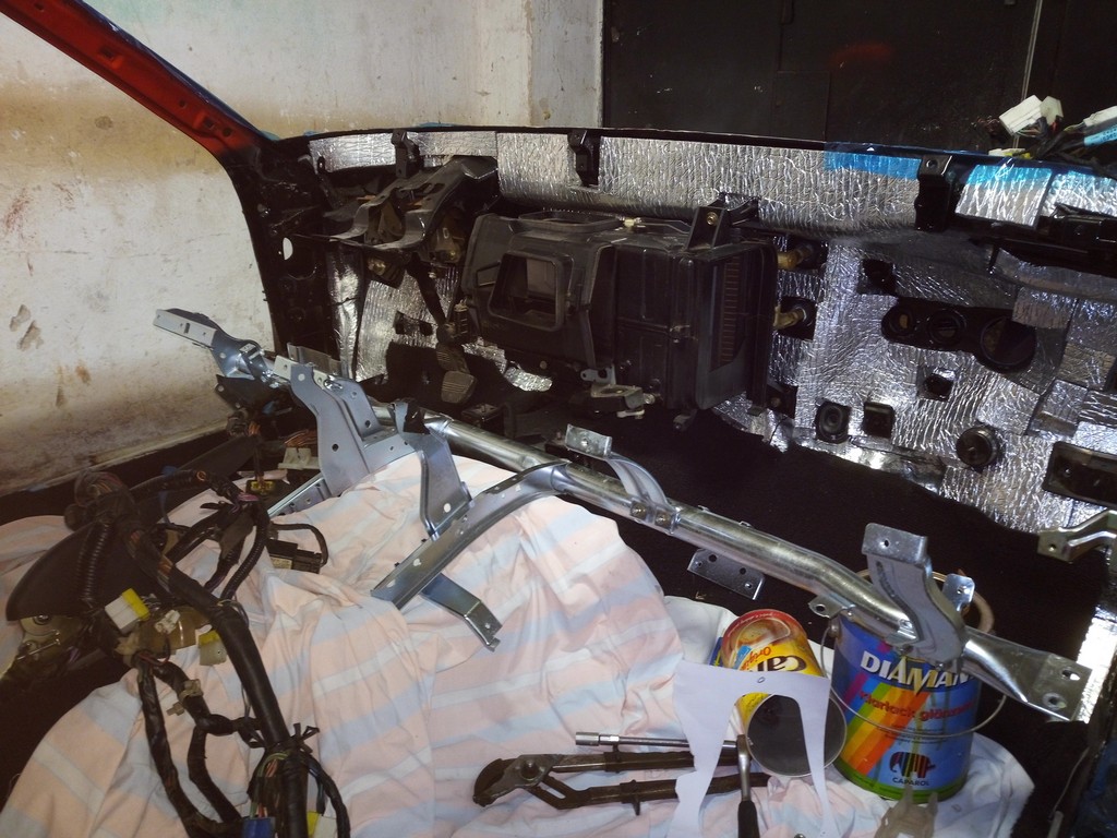

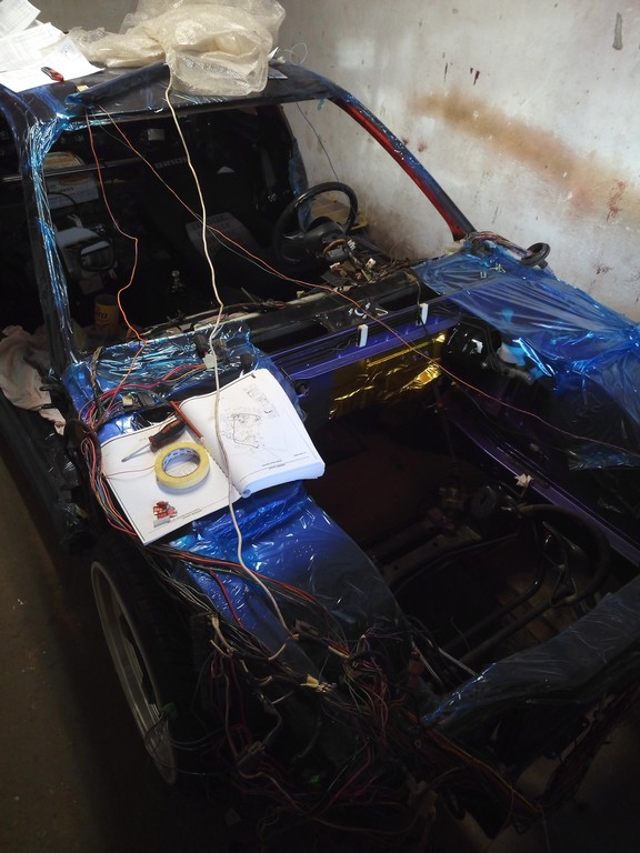

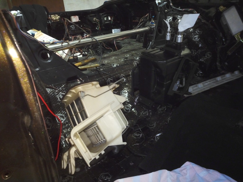

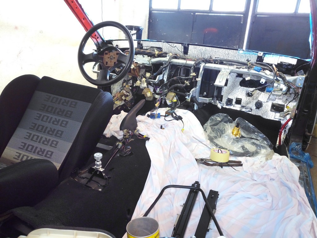

Now I am working on the wire harness instalation. Also next time I start assembling the heater and digital climate control

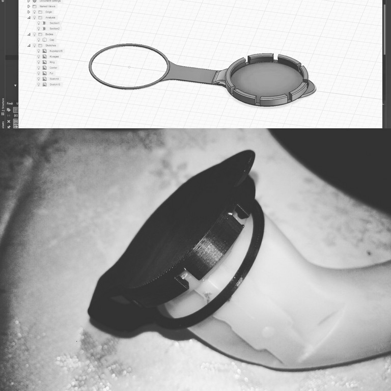

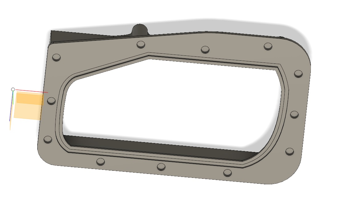

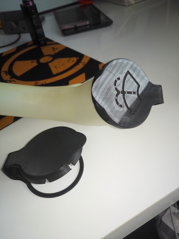

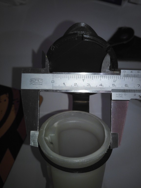

![]() ![]() ![]() I decided to design own washer fluid cap because what I found on Thingiverse, doesnt fit. ![]() ![]() |

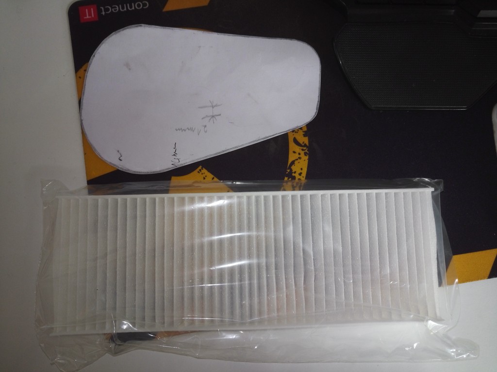

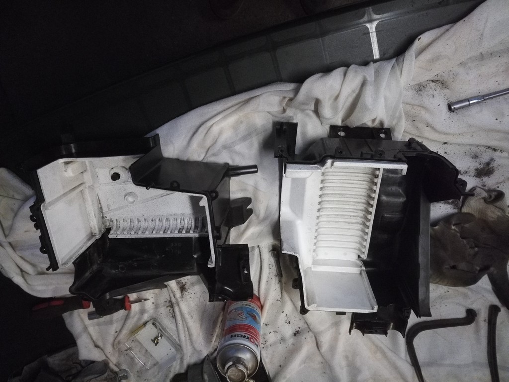

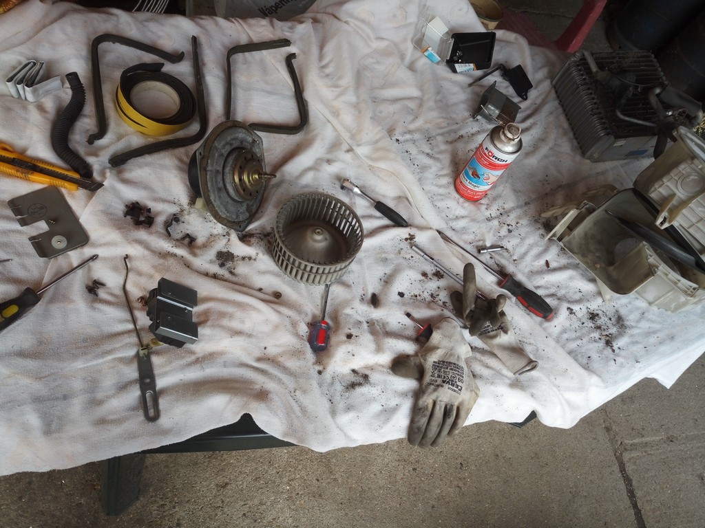

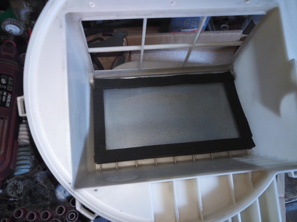

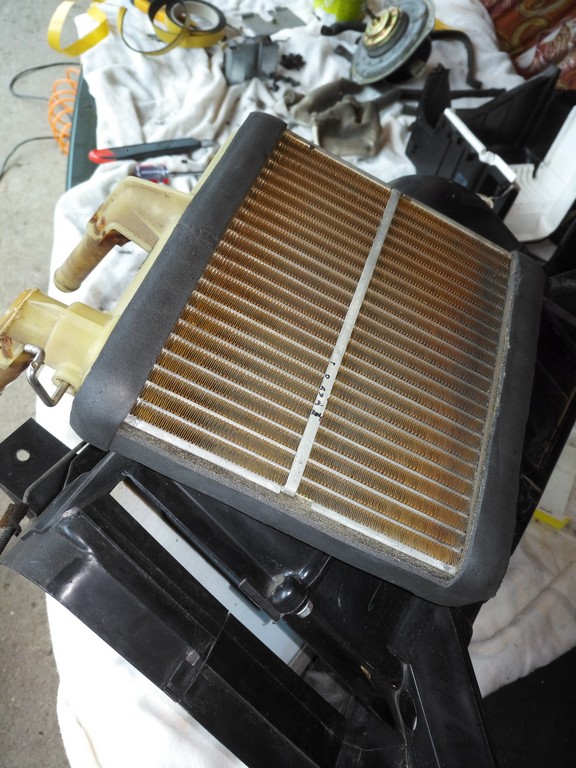

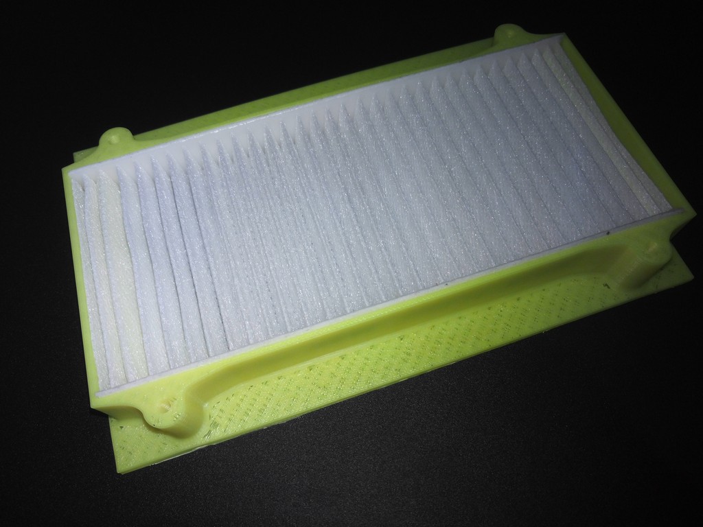

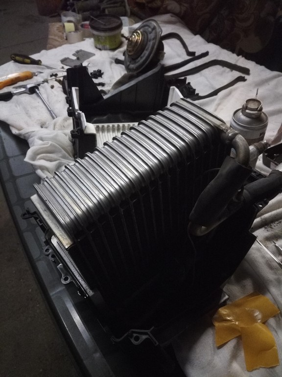

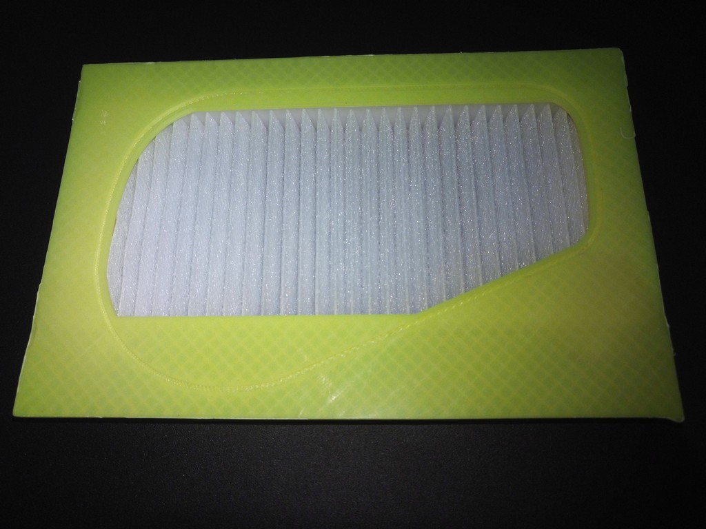

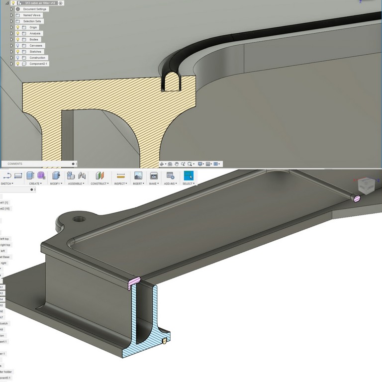

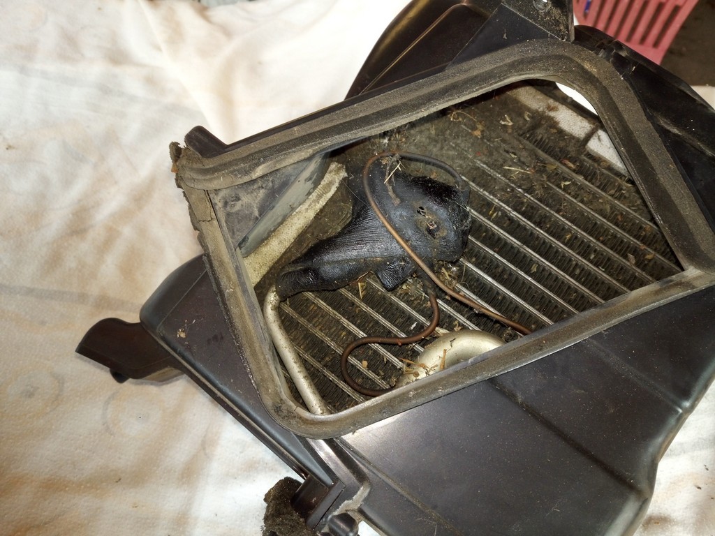

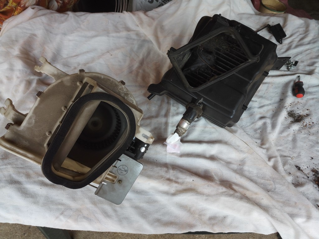

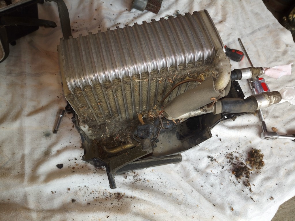

Now I am working on the heater and ac elements. There is a lot of shit inside so I cleaned the whole system, and startd to design the own cabin air filter for S13.
![]() ![]() ![]() ![]() ![]() ![]() ![]() ![]() ![]() ![]() ![]() ![]() Btw I am uploaded the washer fluid cap design to Thingiverse: https://www.thingiverse.com/thing:3364992 If your measurement like on the picture is around 57-57,4mm it gonna be work for you. ![]() |

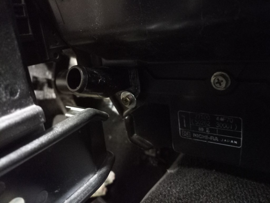

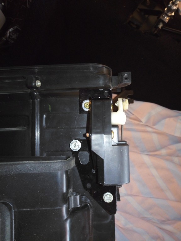

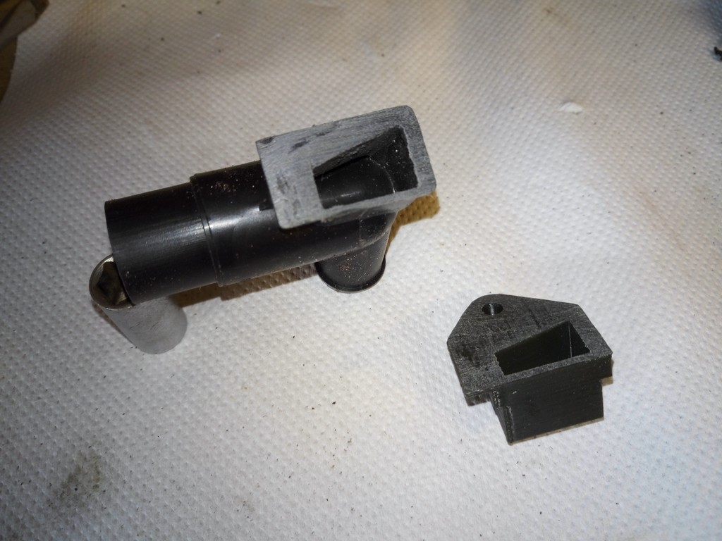

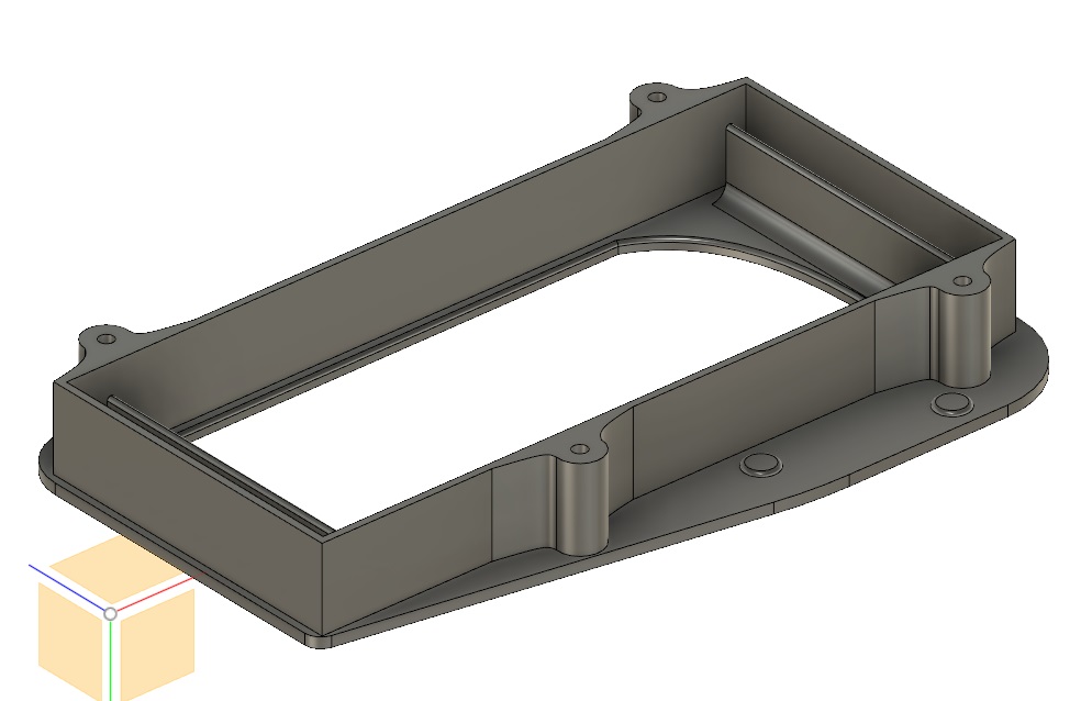

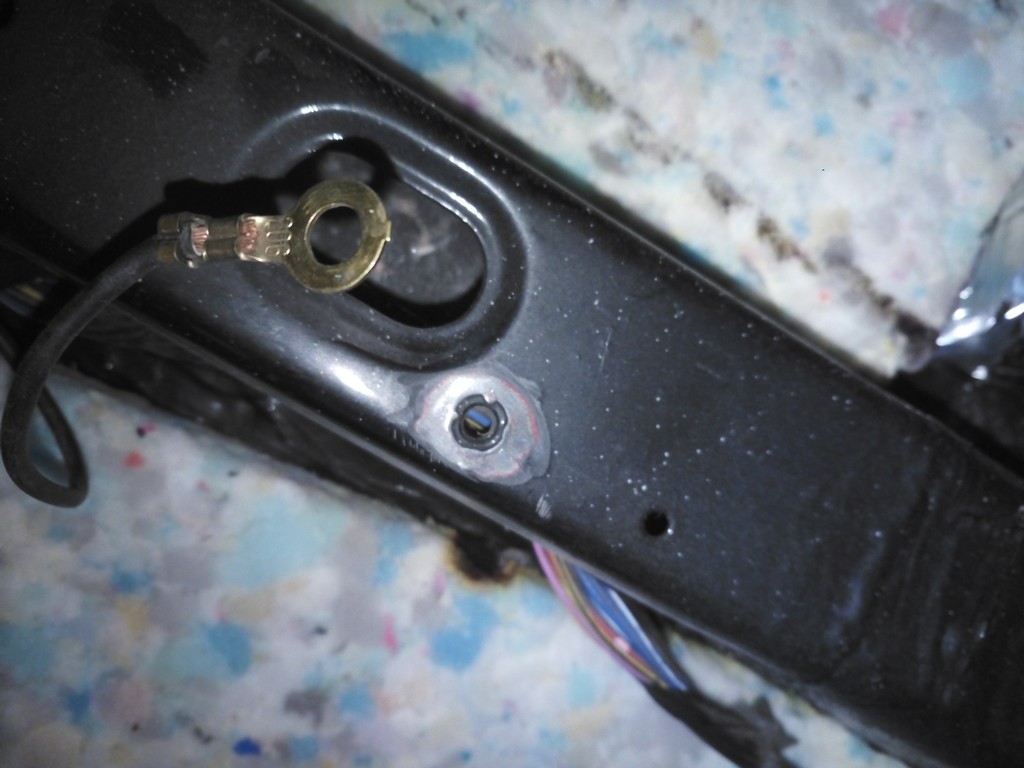

Little update:

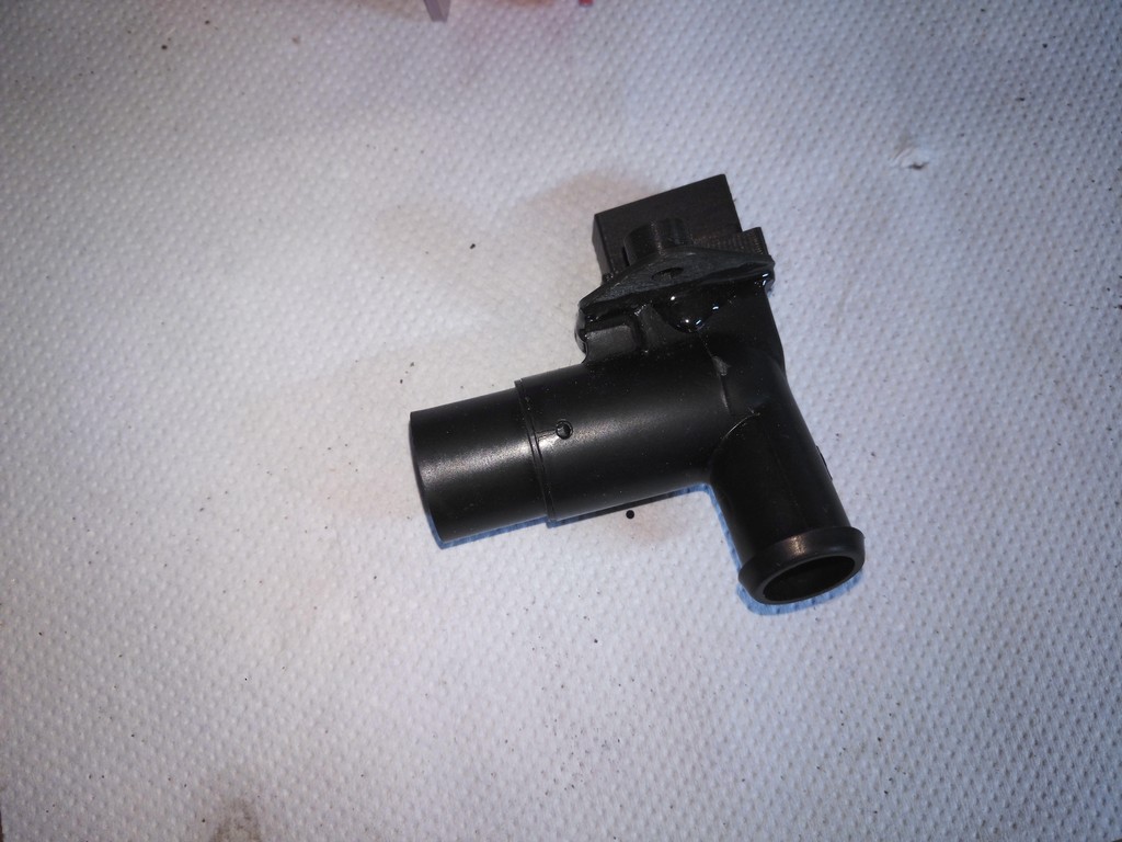

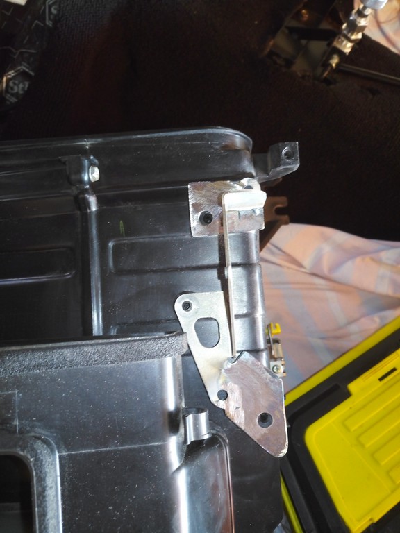

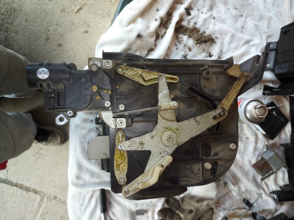

![]() ![]() I am relocating the relays to the interior. ![]() ![]() Modified JDM HVAC motor holder. ![]() ![]() I am designed this aspirator tube adapter from RHD to LHD. Downloadable from Thingiverse: https://www.thingiverse.com/thing:3495836 ![]() I cut the jdm part and glued together with the 3d printed one. ![]() ![]() ![]() Actual progress of the cabin air filter. The upper part is almost finished. There is 3dprintable seal between the 2 parts. ![]() Fast testprint for final tuning of the dimensions. ![]() ![]() |

Hi! I really like your progress especially on the pieces that you design yourself. I was wondering if you could give some more info on your air cabin project. What filters did you use? What was the foam tape around the filter?

what drawing/modeling program are you using? my room mate got a printer, and i have a CAD background. but i dont have access to the programs i used at school. looking for a decent free program, but im starting to realize i may be asking too much.

is that what he is using? I dont think so. i dont want a 3d modeling program. i need something cad specific. ive been using sketchup free but all the features i need require me to pay money.

The current status of the holder is shown on the pictures. The parts are fitted together with small neodymium magnets for easy change, but I am thinking about some mechanical clips for straight and stronger fitting. But it cannot be applied on the place because of the access from outside is so bad, so it need to be printed as onepiece with the holder or some snap in joints or something like this. ![]() ![]() |

The solution with magnets is working I think. https://www.facebook.com/szabolcs.sz...2752972084461/ |
