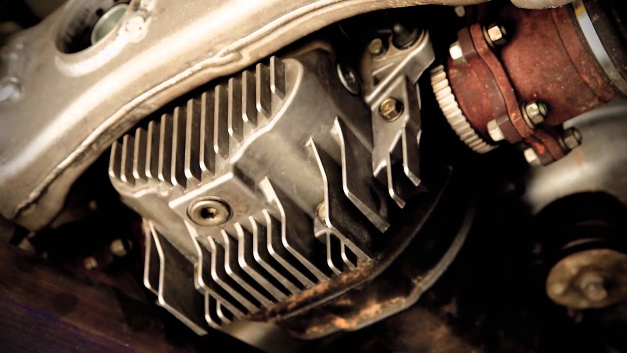

Good thing I've noticed when replacing the passenger axle after accidently botching the threads, is that the plate that retains the grease and limits the axle will stretch a bit. It's normally flat but the axle stub has recess that allows it to stretch maybe 10mm, when I pulled my axle it was stretched about 6mm from just being jacked up to test suspension travel.
not my diff but you can see there is not muck room to play with.
